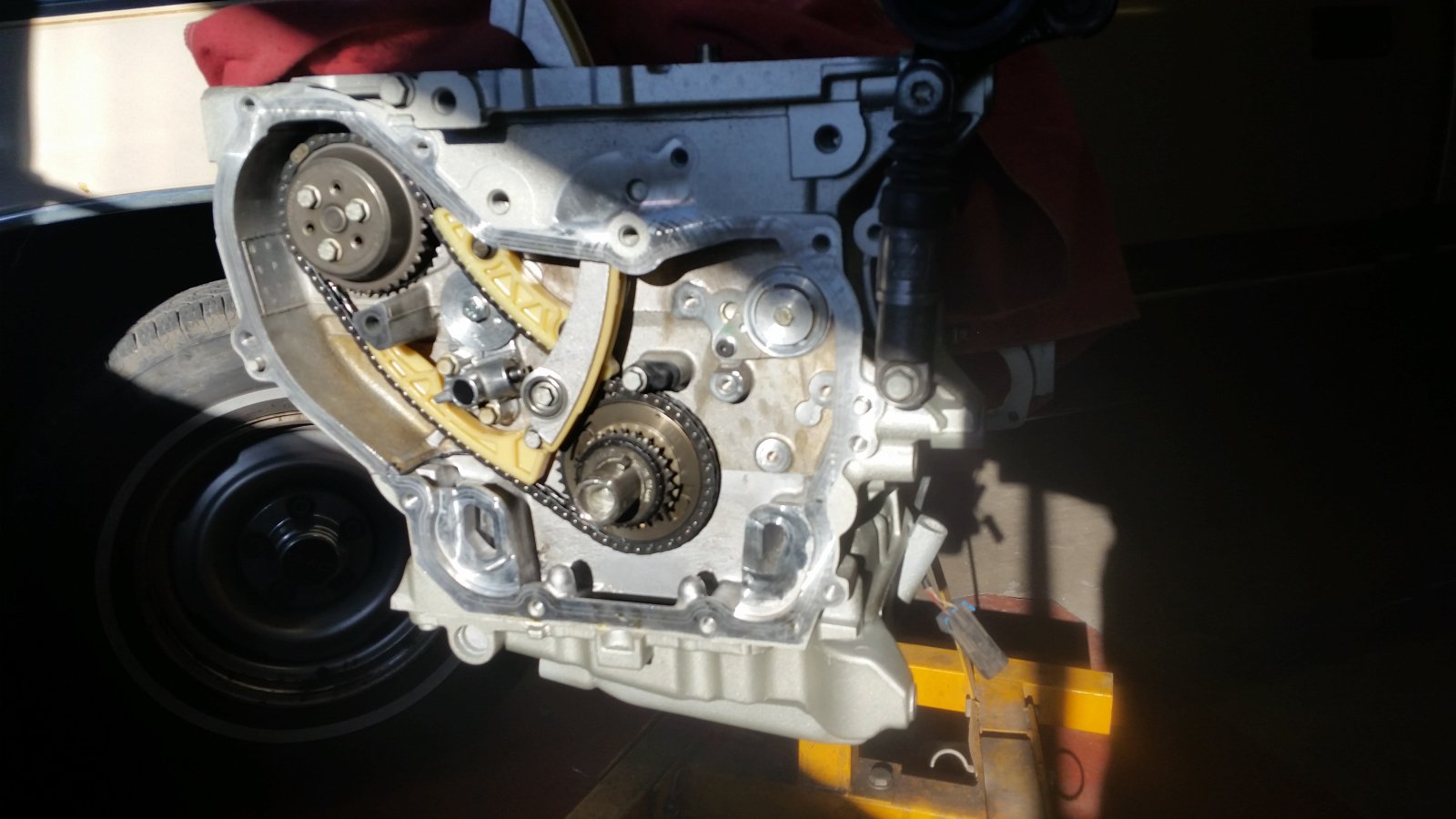

The balance shafts do make the engine smoother at idle and low speed mostly. By installing the neutral balance shaft the engine produces a littLe more hp and acclerats quicker. By totally removing all the shaft altogether and using a shorter chain you will gain more
Note the balance shaft turns twice crank speed.

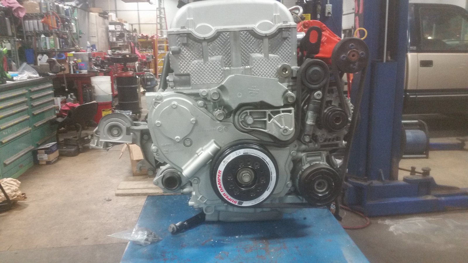

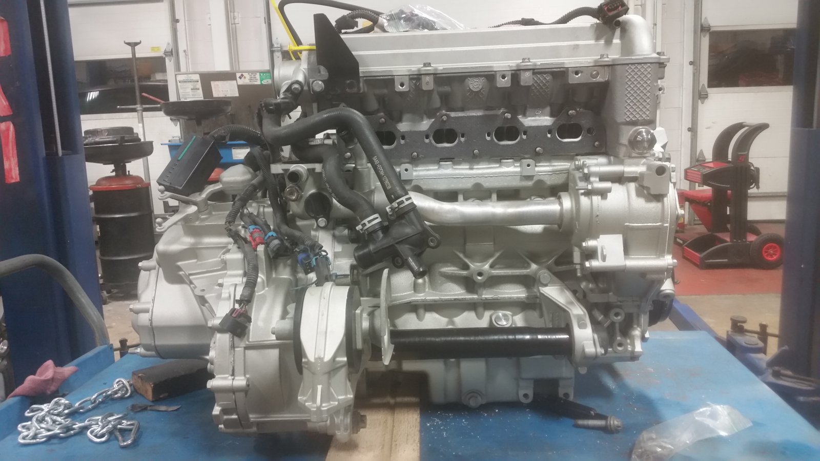

The only bearing area that has a pass through is the one next to the water pump, feeds balance chain tensioner. Made a passage for that one. The engine quicker from any rpm when it does not have to turn the balance shaft twice crank speed. I do have stage 2 cams and upgrade valve spring, the cylinder head is ported, will install 60lb injectors after I get it running. Also went with ATI dampner and aluminum flywheel but not the 7.5" clutch.

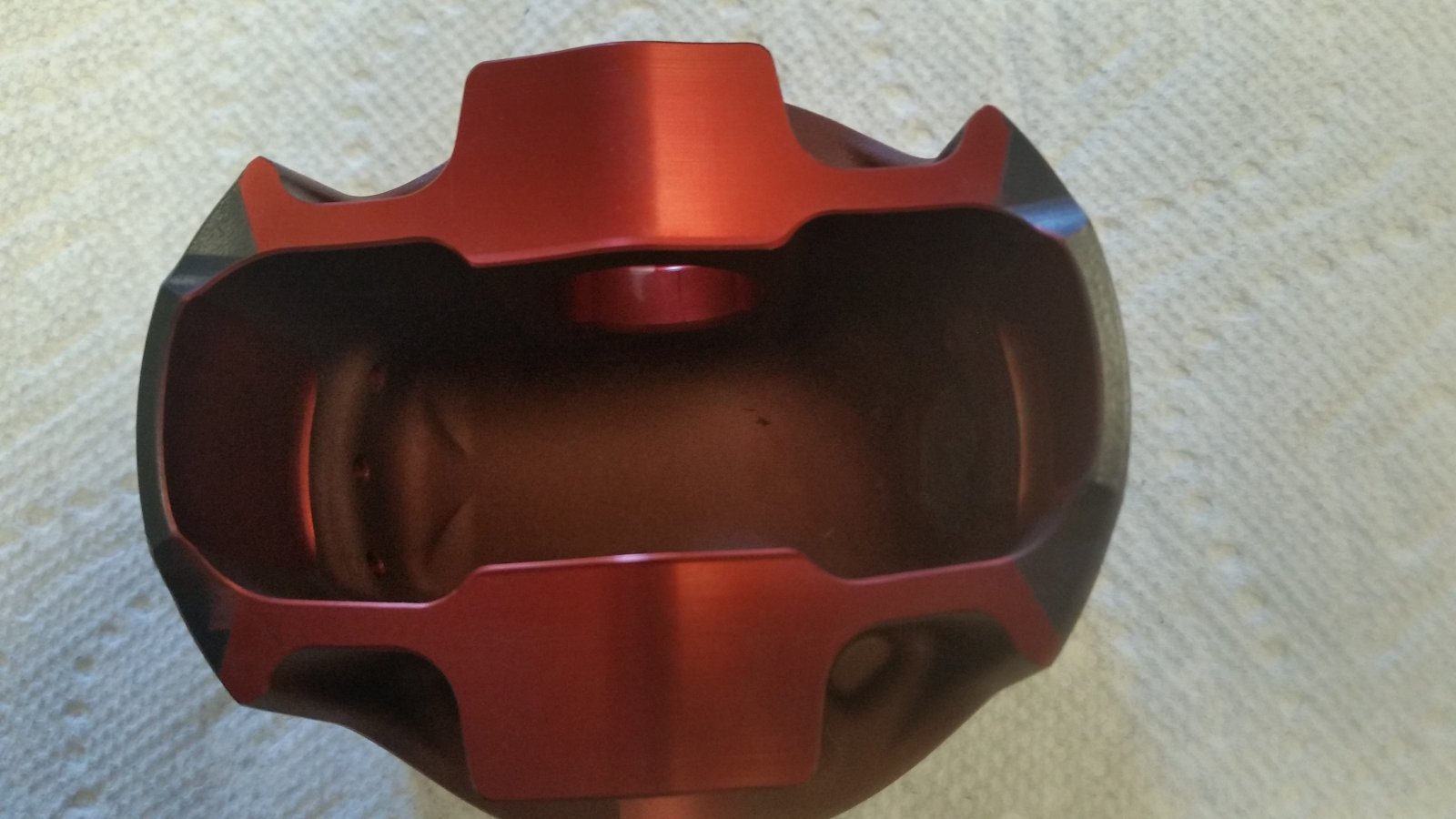

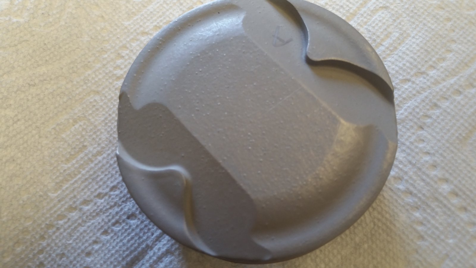

Deleting the balance shaft is not a absolute requirement just something I wanted to do. The lower end is being built to take about any thing I through at it. Need to learn to drive the car before going for MAX power.
Brad
I will running the stock water pump, just not the balance shafts with a shorter chain. So the water pump is stock..
Any downside to an electric water pump?Yes that would work very well. It would make more power at the crank than the way I am doing it.
