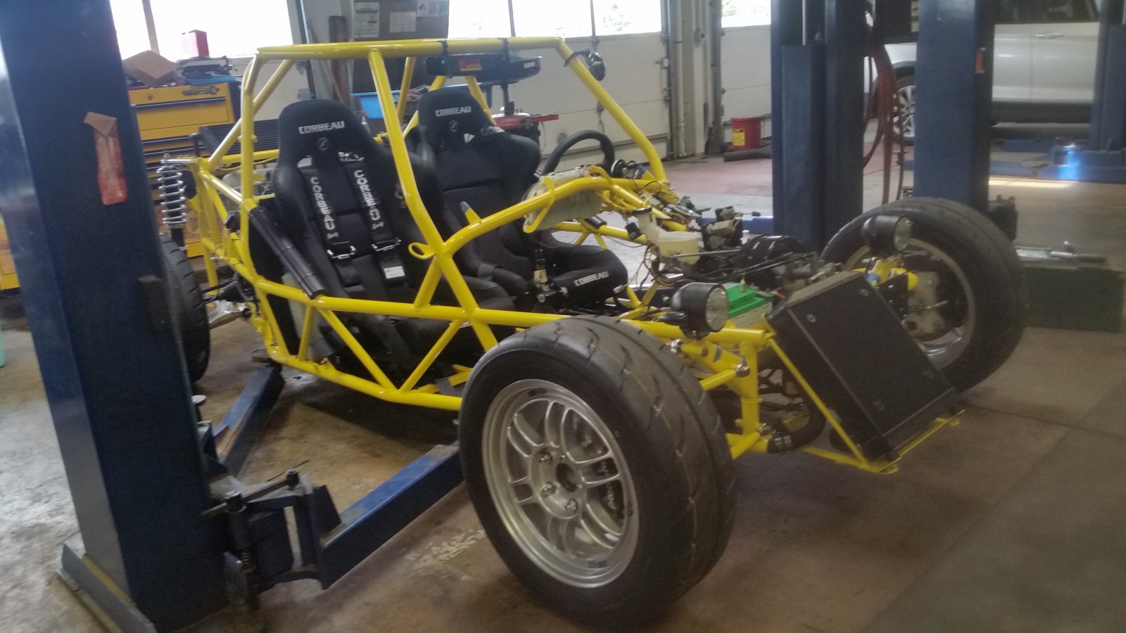

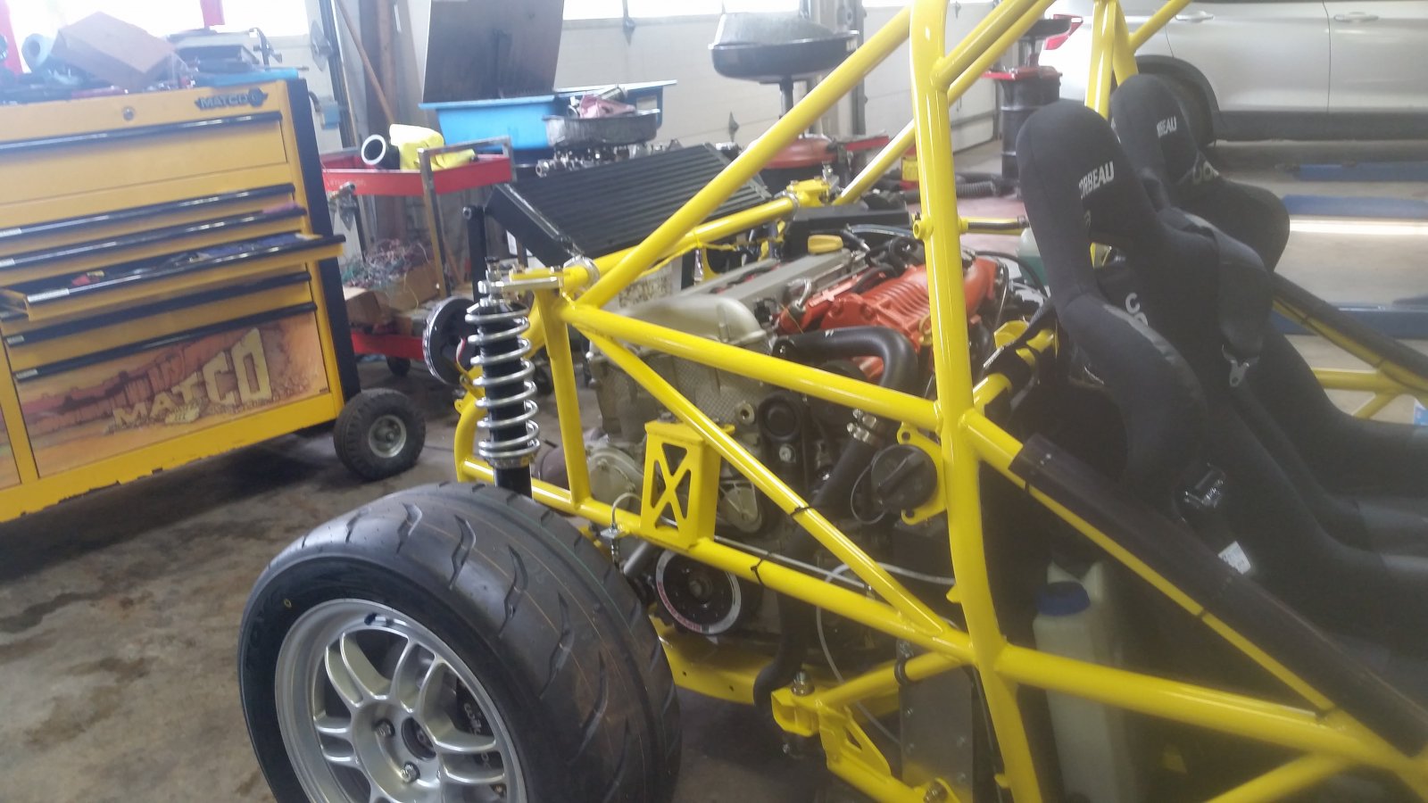

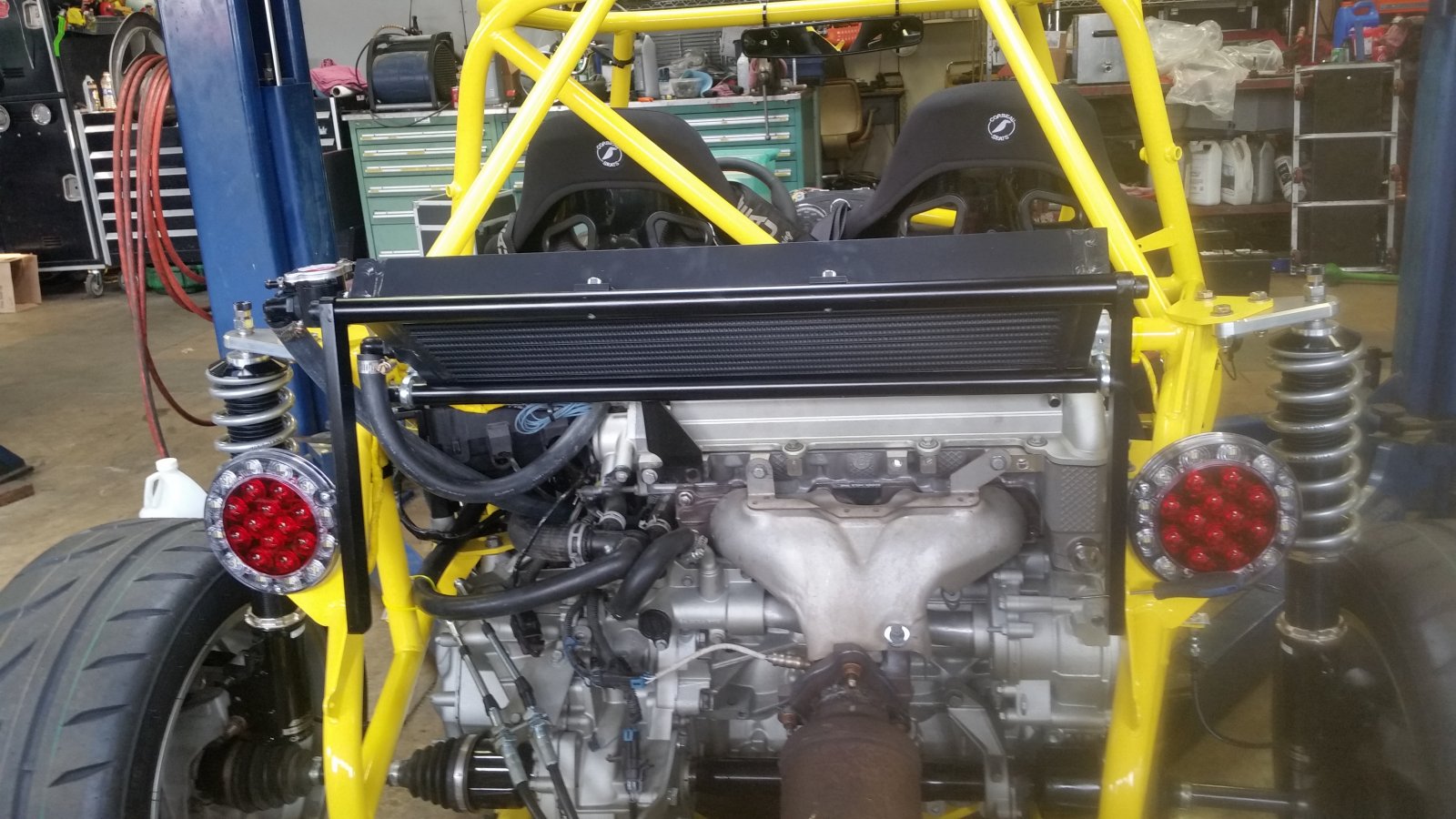

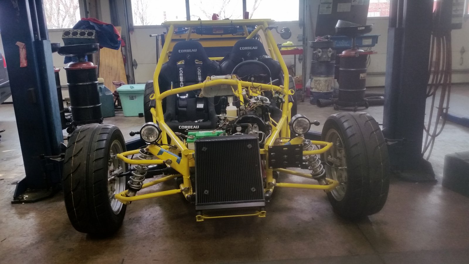

Picked up the radiator and heat exchanger from coating. Installed aND added coolant,wired radiator fan.
Brad
George
The coating is a heat disperant, causing better heat transfer to the air. The efficiency can be increase by as much as 20%.
It is sprayed or dipped and bake at 450F. I wanted the radiator not to be shiny silver. So I did both the radiator and heat exchanger.
