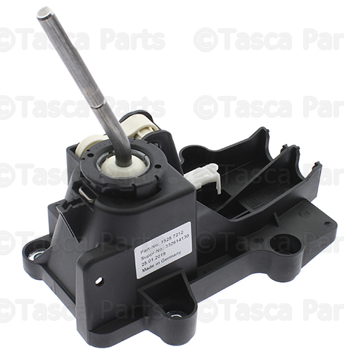

I was researching F23 shifters. I had one that was damaged so I put it under the knife. My goal was to make the cables output backwards. I noted that the side to side motion on the shifter could easily output to the rear, I cut away part of the back of the base for the cable. I believed that mod would get me half way there. More noodling I realized that output would be backwards and still it would need a reverser to operate the trans properly. The side to side output being backwards I figured maybe I could put it's reverser bell crank on the trans? Do-able.
After much thinking I could not come up with a way for the front to rear throw to work in reverse, on the bottom below the pivot ball. 1 would be back, 2 forward, neutral would be unchanged, a viable fix? MAYBE? I realized the fix then was to mount that cable to a pivot point the same distance ABOVE the central shifter pivot ball as the original is below, probably just below the shifter handle. Out in the open, much like the new DF shifter.
(But because I am Building GOB-BALT and not a Goblin the ft to rear throw cable would destroy the console and probably be entangled with the parking brake.
I am resigned to use an original style Goblin shifter and cable reversers under the console. I think I will lose the cup holders and the shifter will sit up an inch or so for cable clearance. BUT it may all fit under the console; I admit, problems you do not have!)
Upon more noodling I may go with the reversed fore-aft pattern with a side to side reverser on the trans. Leaving the fore and aft cable below would result in a different pattern; Start with 1 would be left down, 2 left up; flipping the pattern top to bottom, bottom row odd, top row even.

Message me if you would like to see what I have come up with for F23 shifter. The F23 trans was used in Cavaliers from 00-05. That Cavalier shifter is mostly steel! I have already cut up a stock Cobalt F23 shifter to try to reverse it's function, but I found that plastic is not easy for me to rework. I also found a old 1980's/90's Cavalier pre F23 shifter that shares many parts with the Fiero Shifter. Showing me a shifter that would work backwards on a Goblin but would work!(Backwards shift pattern could be reversed with a bell crank system mounted on the trans, in the engine compartment. I would just have to build cable stops behind this shifter.) It is built of steel, so easily modifiable and sits low in the console.
Then I saw it! I was instantly inspired by the 1990's MR2 shifter.(the 2000 and newer MR2 shifter is mostly plastic.)It works much like the new DF Shifter. The Toyota MR2 shifter, the ball is nearly on the floor. Gear select is f/r and the cable connects in the top side of the stick, above the ball. The rail/row select is side to side with it's lever pointing up.
Modifying the Cavalier shifter, the gear select rod sticking down is removed just below the ball and a cable mount point attached/welded to the shift stick a similar height ABOVE the ball. The "rail/row" lever, I will cut the lever off below the pivot and remake it/weld above the original pivot. I'll cut away the original base to where the ball is only ~2" off the floor, then make/weld new base/feet, bits of angle steel. Then build my new cable stops behind the shifter.(I figure I can always modify it to sit higher!) I have drawn on a old Cavalier shifter I have and have taken multiple pix; though I have not "built it" yet. Message me if you want my pix/ideas. I don't have any claim on this design, if it works for you I'm pleased to have helped!
