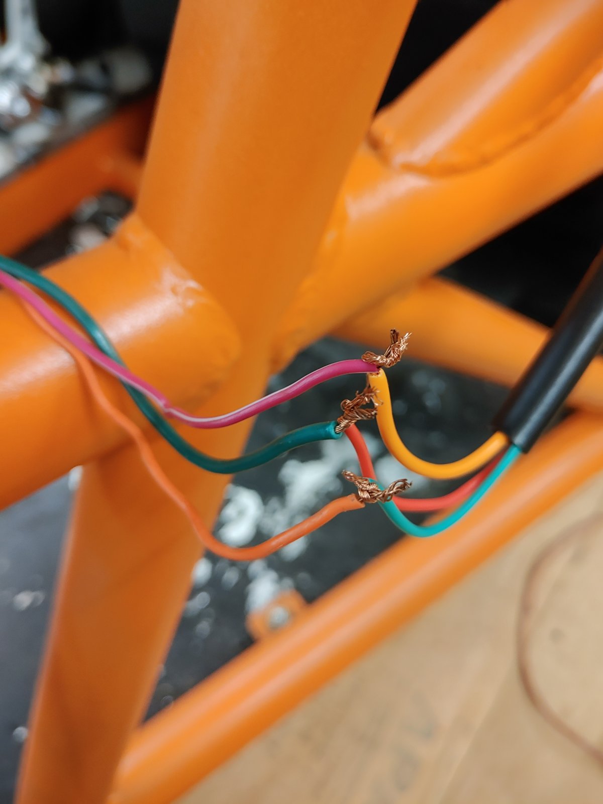

Thanks for the link, I had looked at that post awhile back and had forgotten about it..i changed the wiring on it and got it the way I wanted but not sure I like it now. Here is how it's wired to have the smaller builds be the blinker. But it's a nothing little light. Pic is of the drivers side. And is.
Car harness to mirror harness. Red to orange, green to red, orange to green.

I went back and rewired it so it's set up like yours, I think it looks better that way.
That wiring setup looks like car harness to mirror harness
red to red, orange to green, and green to orange.
