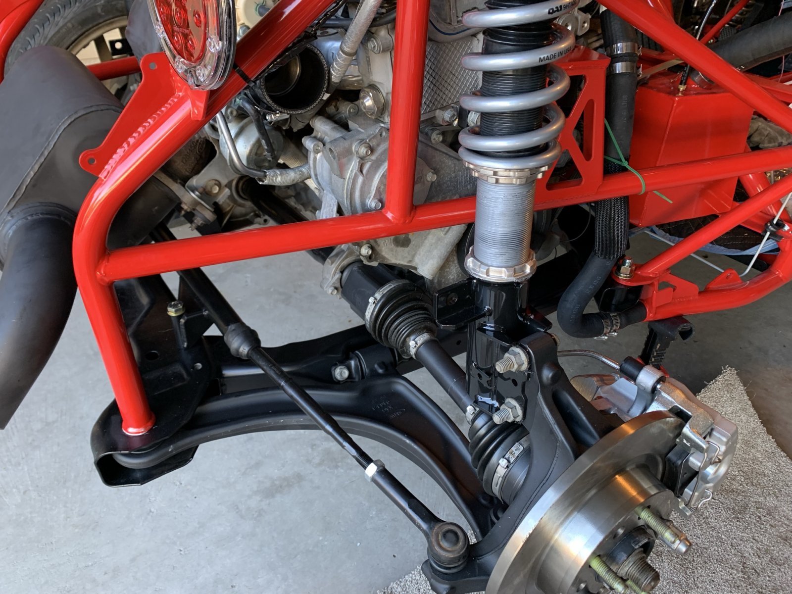

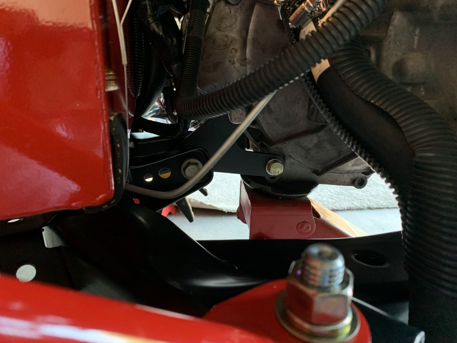

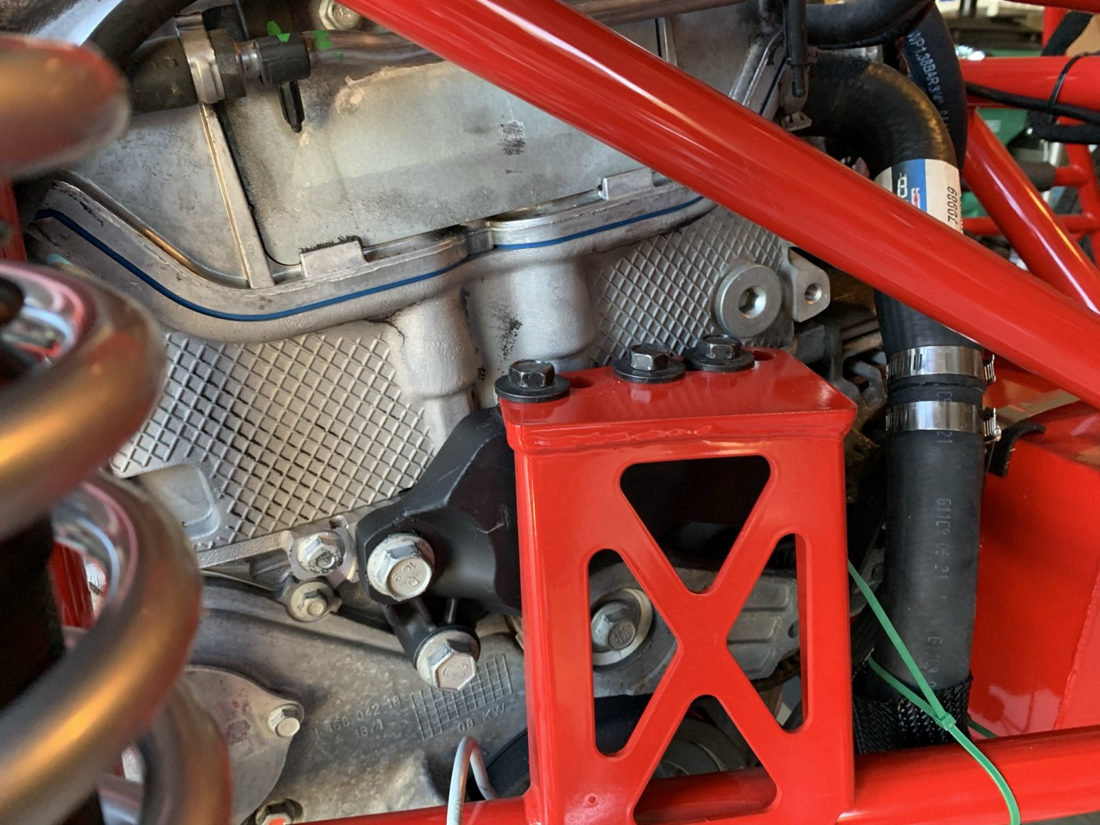

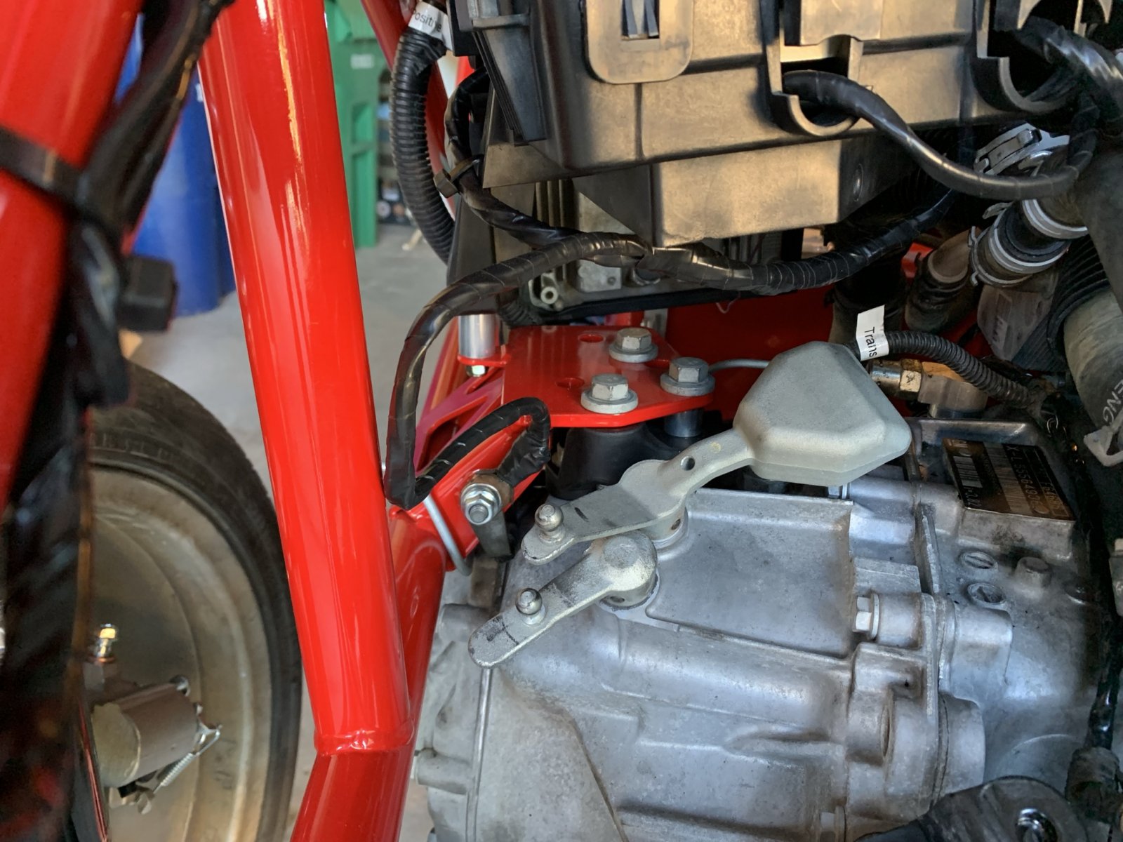

Now for some thoughts on the installation of the solid transmission mounts.
- I wish I had installed the solid transmission mounts before I completely torqued down the subframe connections.
- I placed a floor jack under the transmission, right under the front mount.
- I loosened all 4 subframe connections and the 4 bolts holding the control arms to the subframe
- I loosened the 6 bolts holding the engine to the chassis. These steps maximized the tolerance (slop) between the transmission and the subframe.
- I installed the rear transmission mount, starting (but not torqueing) the three bolts going from it to the transmission.
- I installed the front transmission mount, starting (but not torqueing) the lower bolt going from it to the transmission.
- I used a rubber mallet to force the front transmission mount between the plates in the subframe. Maybe you have enough of a gap that yours went in easily... mine did not. I got the hole in the mount as close to lined up with the holes in the subframe as I possibly could.
At this point, all of the mount holes to the subframe were forward of where the subframe needed them to be.

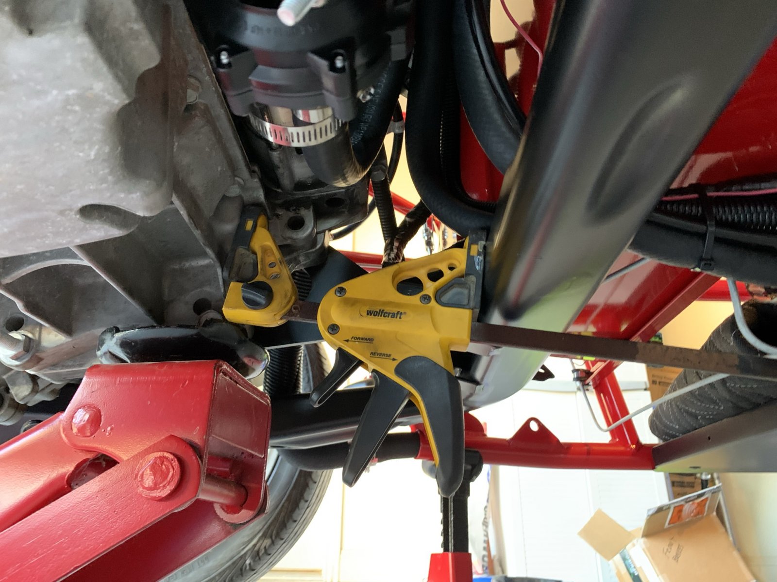

- I got my quick clamp, and reversed it so that it was pushing the ends away rather than clamping them.
- I installed it between the subframe and the transmission/engine, at the front of the subframe.
- I used the clamp to push the engine away from the front of the subframe. I was pretty quickly able to drop the three screws through the rear transmission mount and subframe.
- I had to do more work to get the front transmission mount hole lined up with the subframe holes. There wasn't much around there for me to lever against, so I did end up using the rubber mallet again. Once lined up I installed (but again didn't torque) the bolt down.
- This left the top bolt on the front transmission mount that needed to be installed. This took a combination of lifting the engine with the floor jack (remember it was right under the mount) and prying between the mount and transmission right beside the hole. Eventually the hole lined up and I was able to start the screw.
With all the screws started, I then went to torque down the screws... I went in this order:
- Transmission mount to transmission (5 bolts)
- Transmission to subframe (4 bolts)
- Engine to chassis (6 bolts)
- Front Subframe to chassis (2 bolts)
- Rear subframe to chassis (2 bolts) through the control arms
- control arms to subframe
Not sure if this is the best way, but it worked for me. Sorry I didn't take pics of every step... hopefully you can follow what I did.

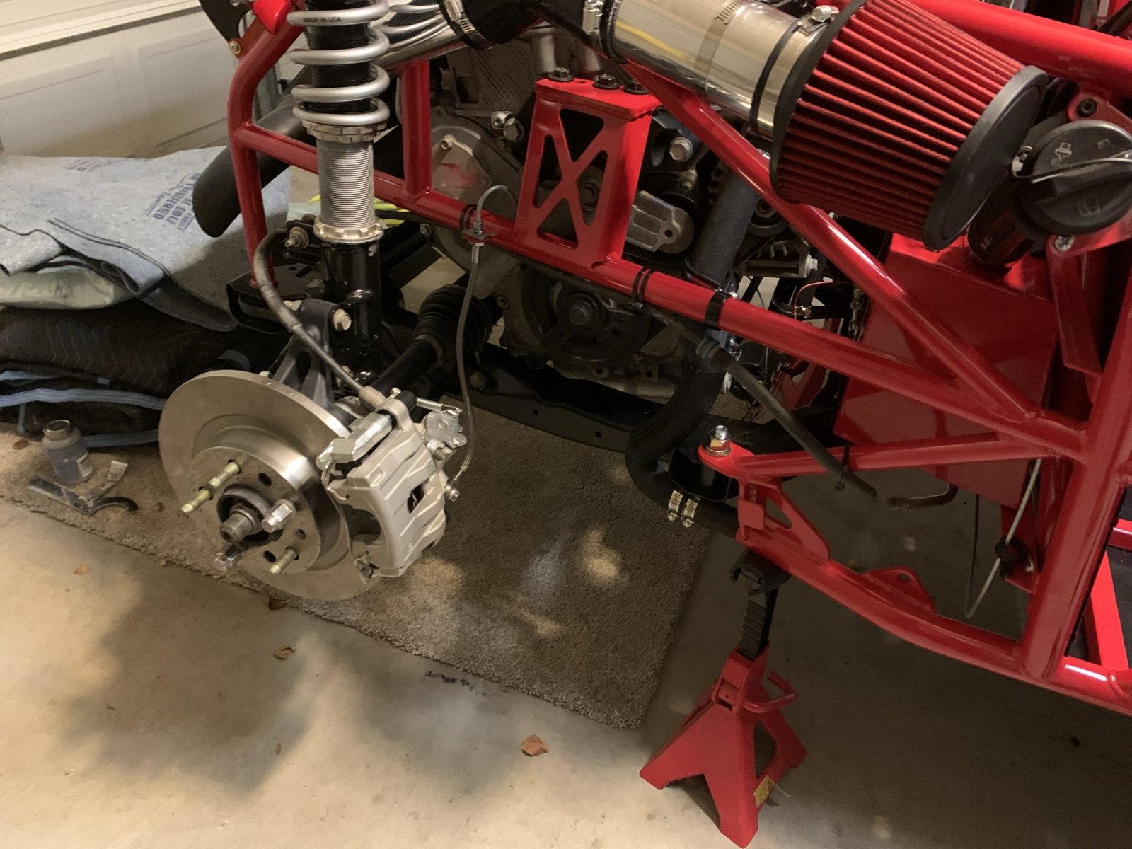

I had said I would get the brakes corrected on Sunday... I didn't get to that. I did fill the intercooler with fluid (and found leaks where the elbows go into the heat exchanger. I see in SmsDetroit's log where he used teflon tape there to seal them up... that will be another project for this week.
I did take some clamps to squeeze the tunnel together, which allowed me to get the tunnel cap started. I was then able to get it on the tunnel. Of course, I need to pull it back off again to finish everything going through the tunnel. But it is progress.
Finally, I did a lot to clean up the garage. Amazing how many empty DF baggies and boxes I have.

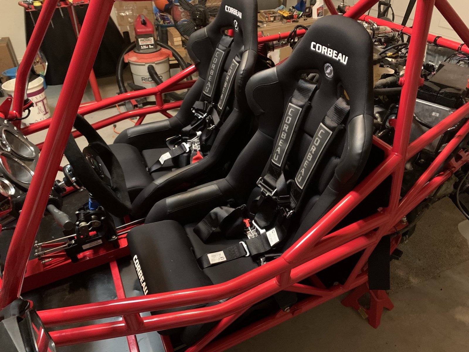

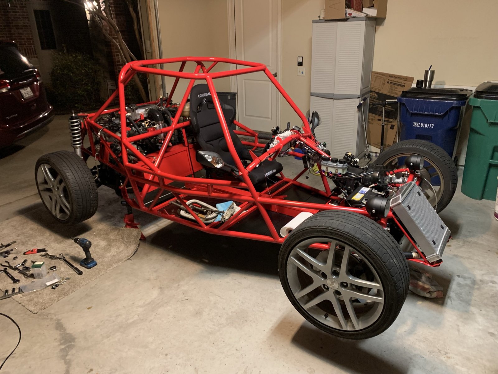

Also, while I agree with what Rttoys said, I got all four wheels on and installed the driver's seat. It was encouraging to my family and I to see it look like a... well, big go-cart. There is still a lot of assembly to do, then the tweaking to make it drivable, then the work to make it run well. But the process continues...

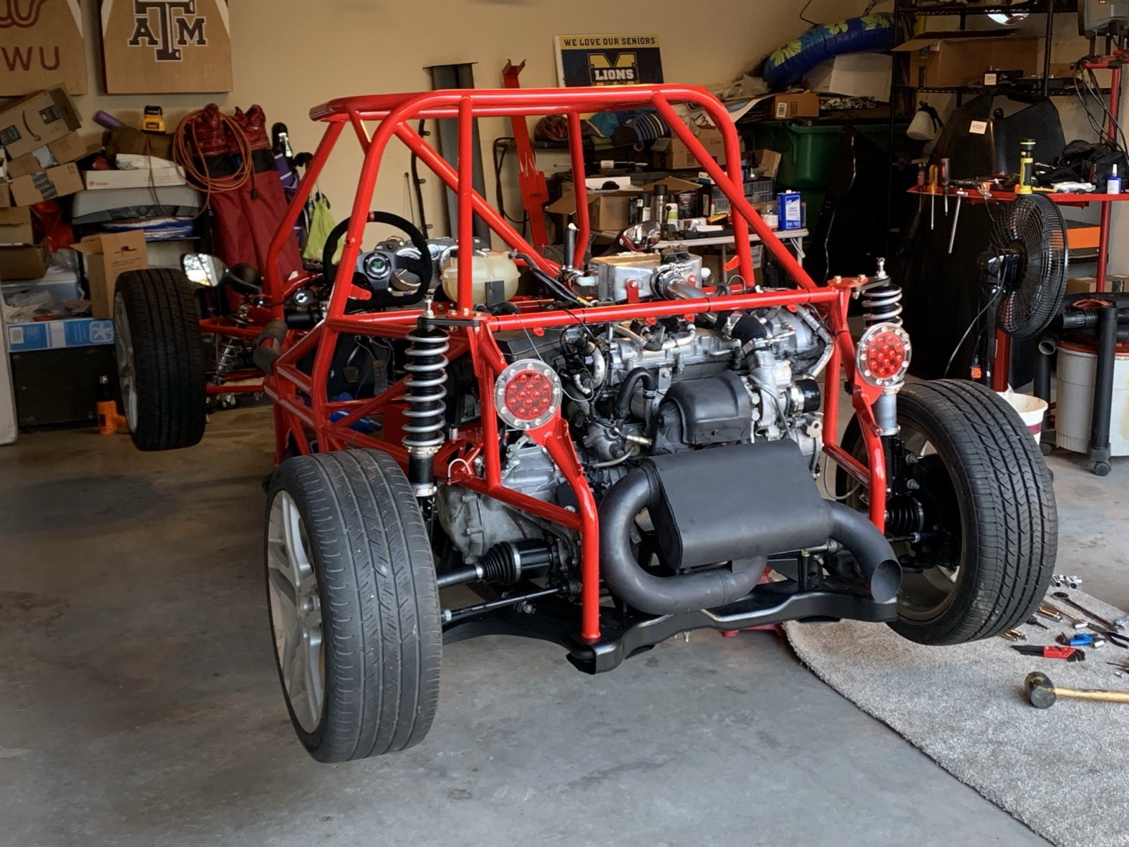

It has been a while since I posted... Life has been busy, and when I've had opportunities to work on the Goblin I didn't do a great job of getting pics and posting. But I'll try to catch up this weekend.
To Rttoys point, I need to figure out the long term tire situation. I haven't investigated at all... wanted to get the car running and driving before I invest in wheels and tires. It will require more rework since I'll either need to get adapters or have the hubs re-drilled... but that is a problem for another day.
Picking up from Nov 8, I added teflon tape to the 90 degree joints going into the heat exchanger. I was able to get the intake installed after some consultation with Lonny and JBINTX, so on 13 Nov we put the wheels back on and decided to push it outside to see if we could get first start. Of course, the battery was dead so I threw it on the charger for a while. Then this happened.
After a few minutes I took a "walk around" video.
Obviously there was another coolant leak, again from the intercooler. This time it was from the back of the car but it was over the tunnel so some of the fluid got into the tunnel and ran out the front of the car making it look like two leaks. Other than that it seemed to work well. After letting it warm up we pushed it back into the garage.
When I was able to troubleshoot the leak at the back of the car I learned that there was still a very small leak at the 90 degree angles into the heat exchanger. So I took it apart again and added more teflon. That got me to around Sunday Nov 14.

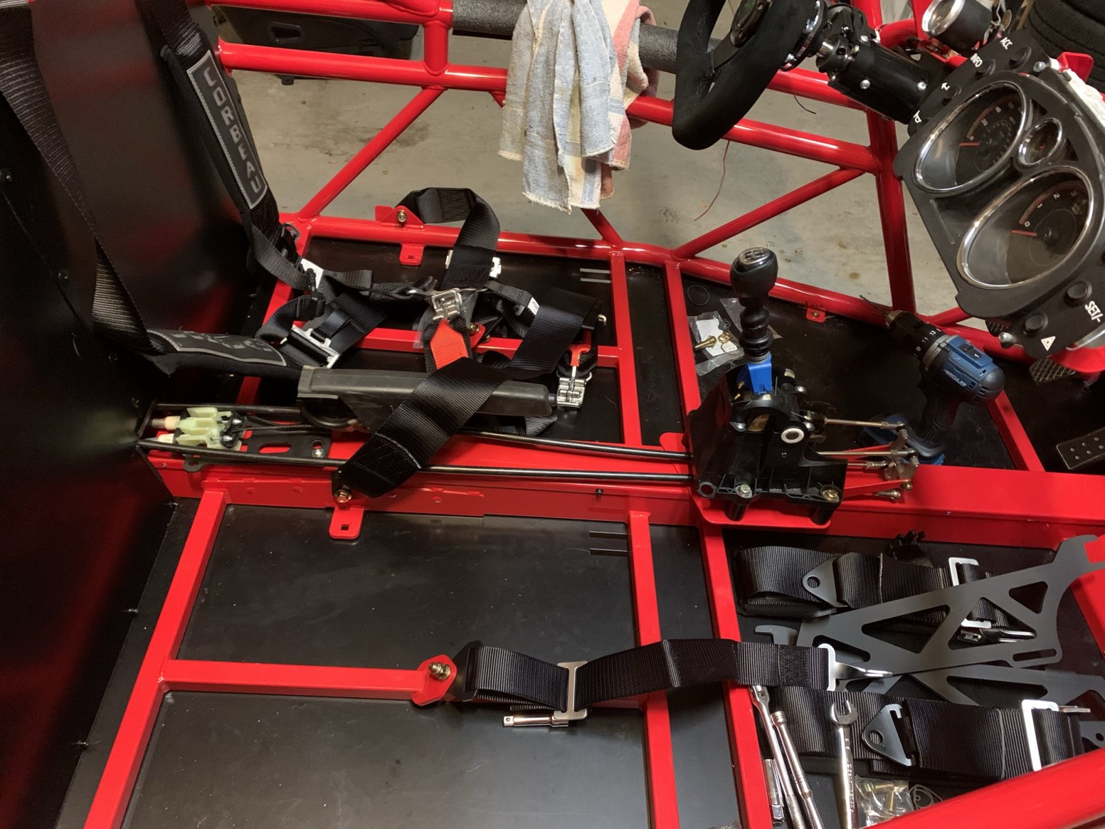

Install the shifter and cables: Not too hard. Followed Lonny's instructions and it worked like a champ. The only deviation I had was that before I realized there were spacers to mount the shifter above the tunnel I thought I had to cut out the area between the two from screw mounts. So my shifter isn't as stiff side to side, and I tried to cut off my finger doing this process with the hacksaw.
Install the parking brake cables: Tried to follow the pictures, but either I mounted the handle too far forward or something was off, because I couldn't get the aluminum guides to go into the holes in the handle and mount to the subframe at the same time. I kept digging through build logs and observed the JBINTX appeared to have the same issue. I followed his lead and zip-tied the cables at several points.

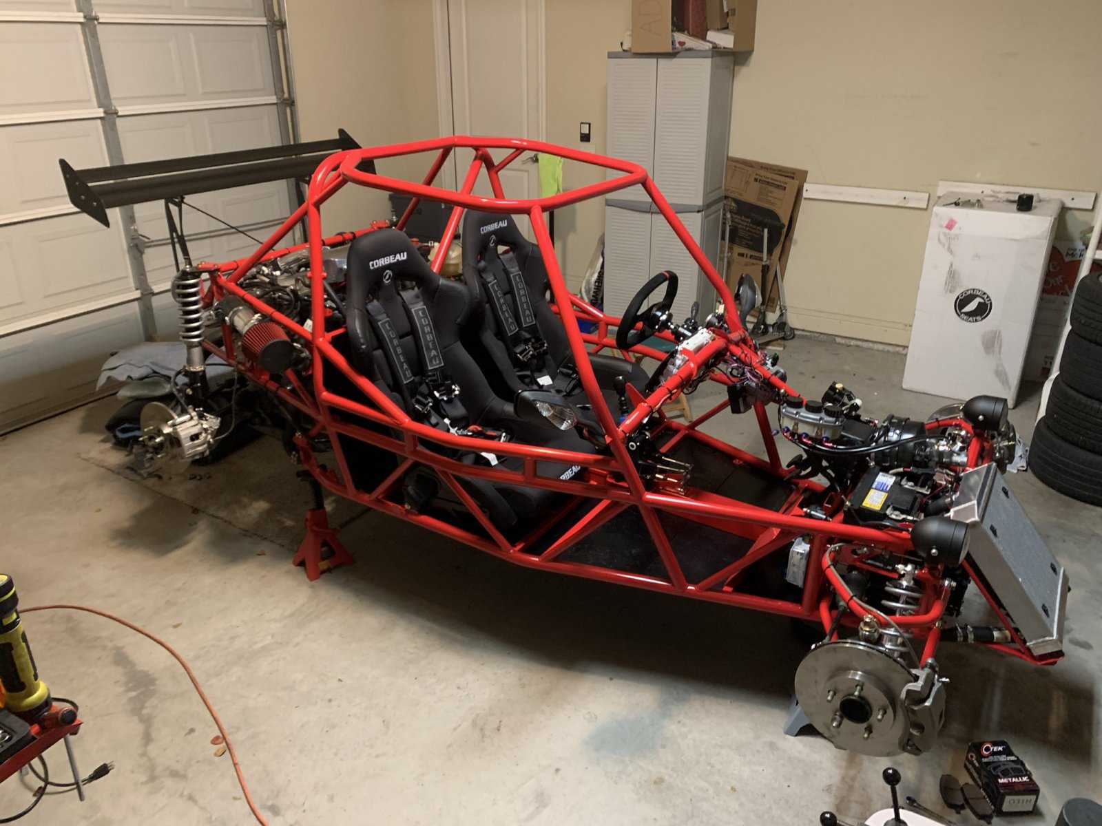

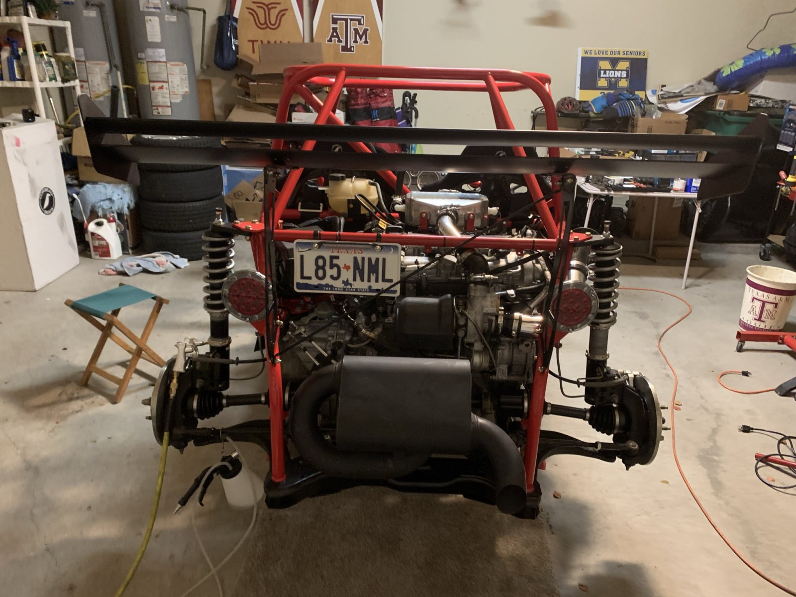

Installed the license plate light (with old plate) and the rear wing: Ok, the rear wing was all about keeping my 8 year old Adam engaged. It was easy enough to do.

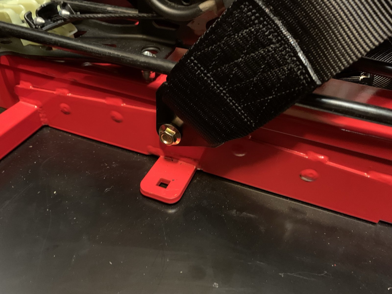

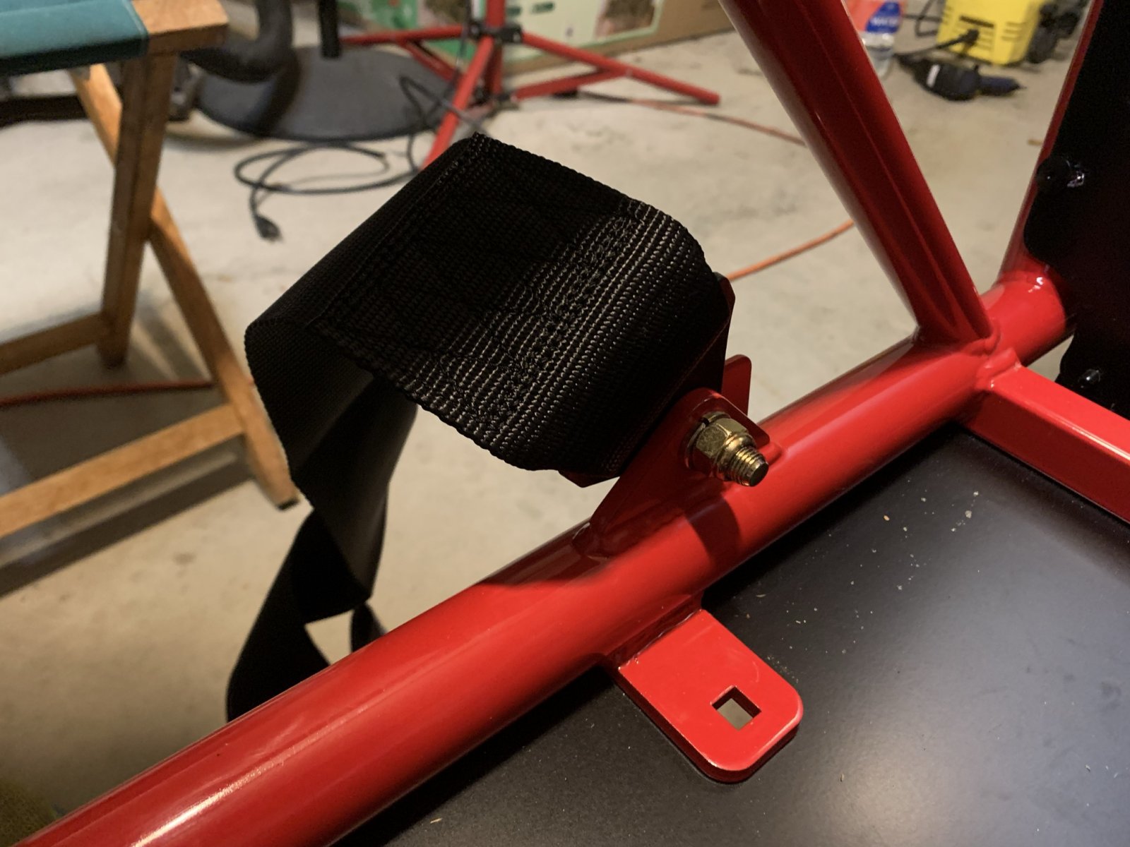

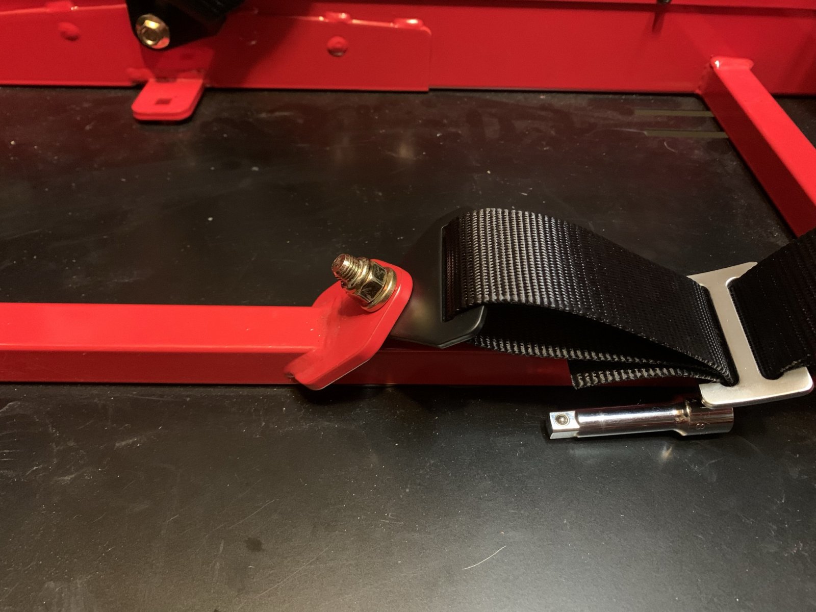

Installed the harness and seats: This was a challenge... not certain I did the harnesses exactly as intended. Would love some feedback here. I still have to get some longer zip ties to capture the loose ends of the harnesses per discussion on other logs.
At that point most of the car was together.
