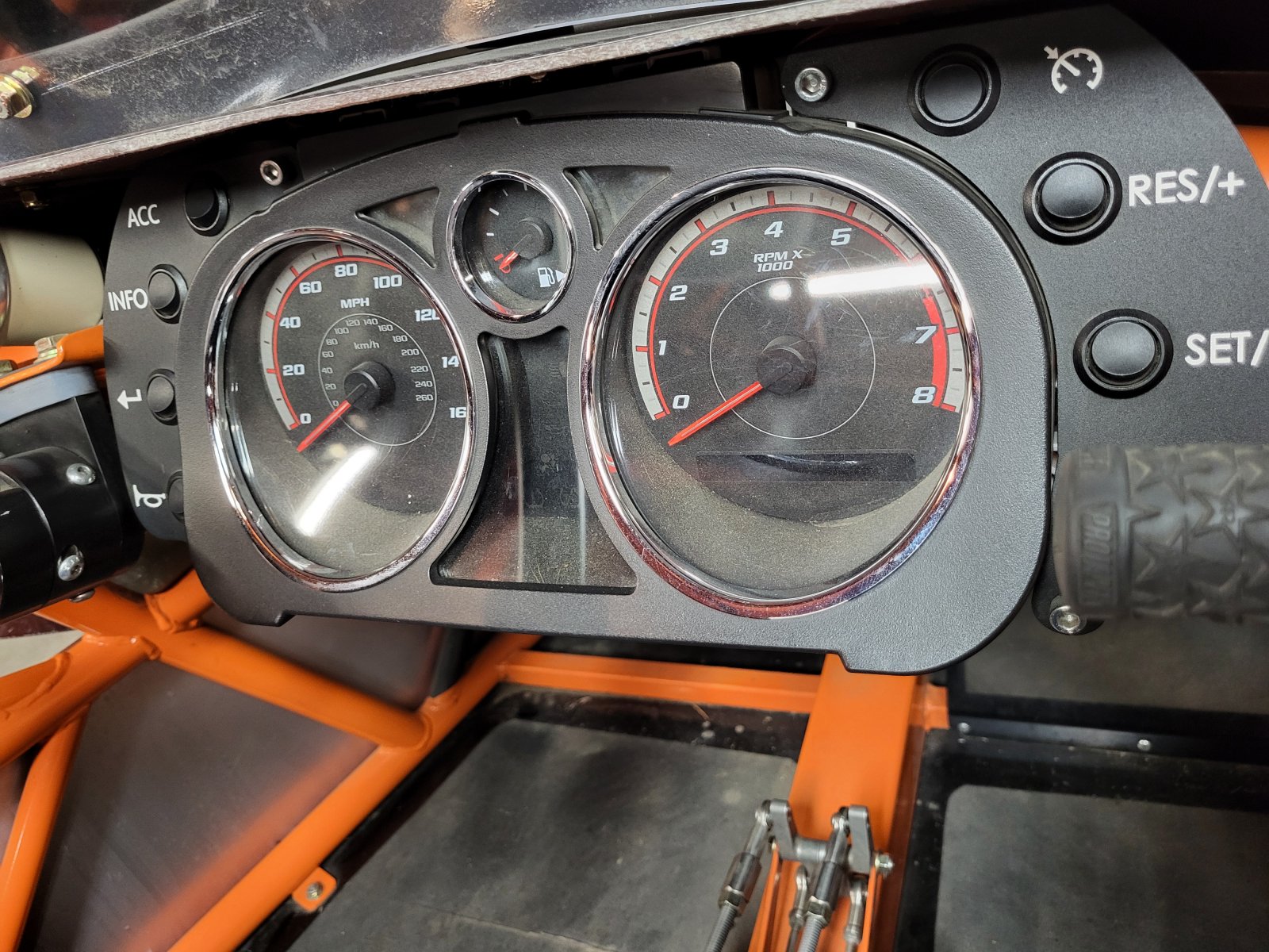

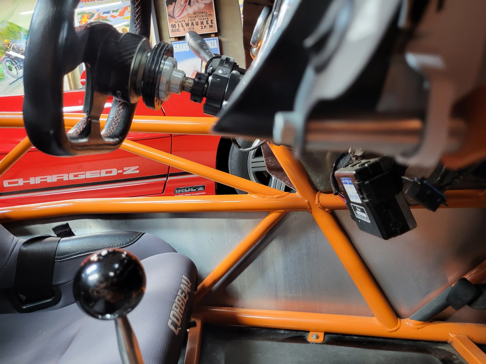

My issue is a little different but I did have that at one point. I put spacers in between the cluster and the bar to get the cluster wires off the bar. It made that particular issue go away. I had to also buy longer bolts to hold the cluster to the frame.

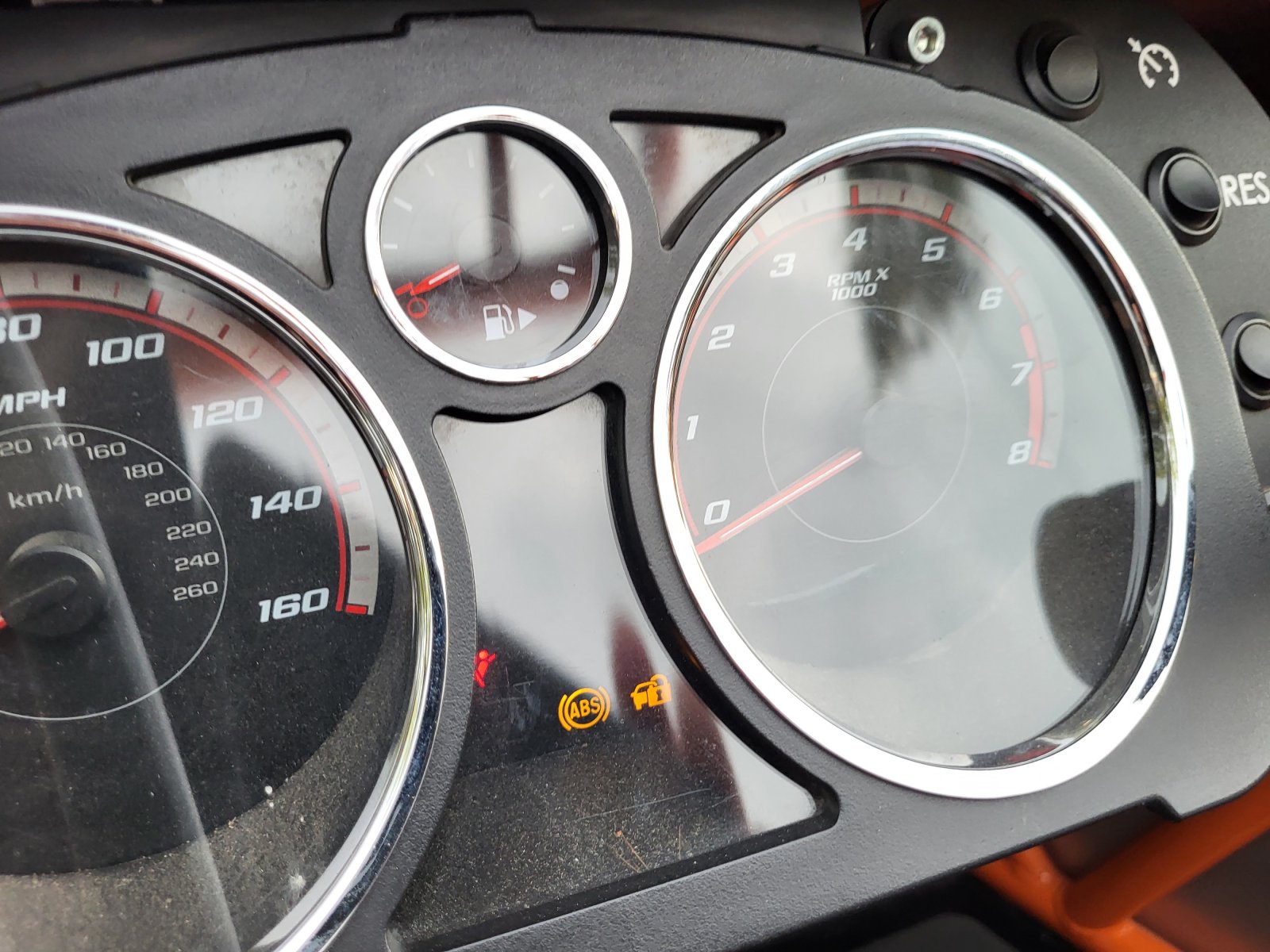

Hey Guys. Just a follow up from my last post. Have not had any issue with my Speedo/Tach/Fuel gauges going off until tonight. I attached a pic of the warning light that came on (bottom right) when I lost the gauges during my drive. Does that mean anything to anybody?

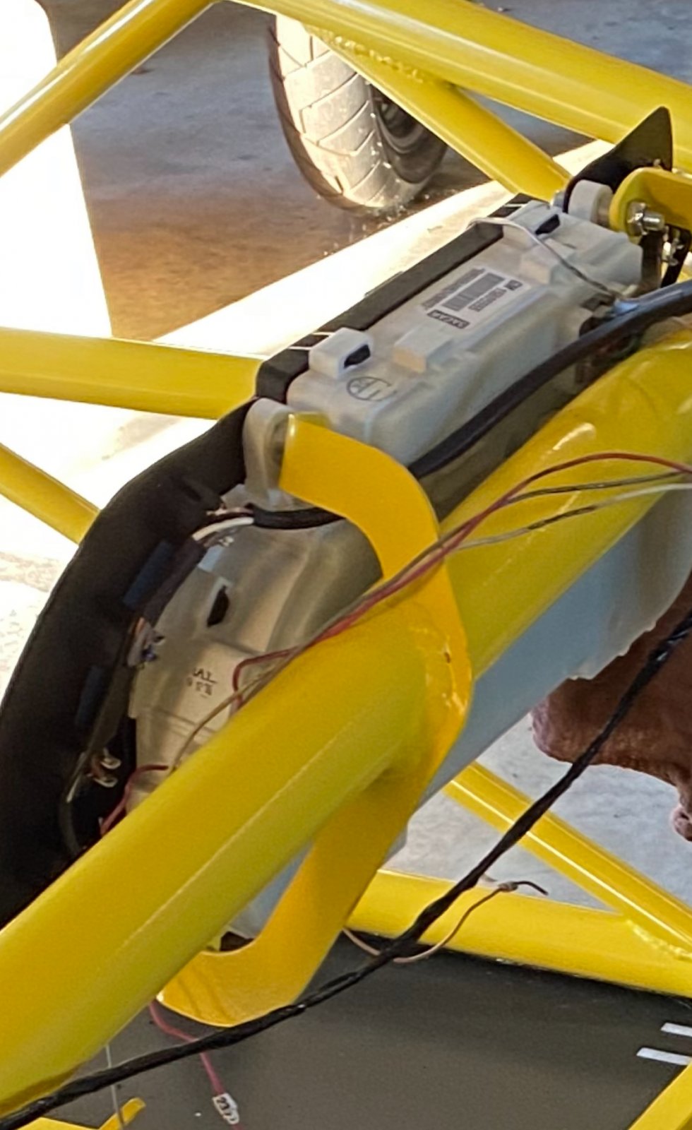

Mine did this and it was because the cluster was too close to the bar behind it and pinched the wires. I got longer shank bolts and spacers to get it off that bar.
There should have been spacers in one of the packages for the buttons. This is the best pic I could crop to show at least the top spacer.
I think I stacked spacers on the bottom of the cluster, but there’s a few long spacers that are for the bcm.

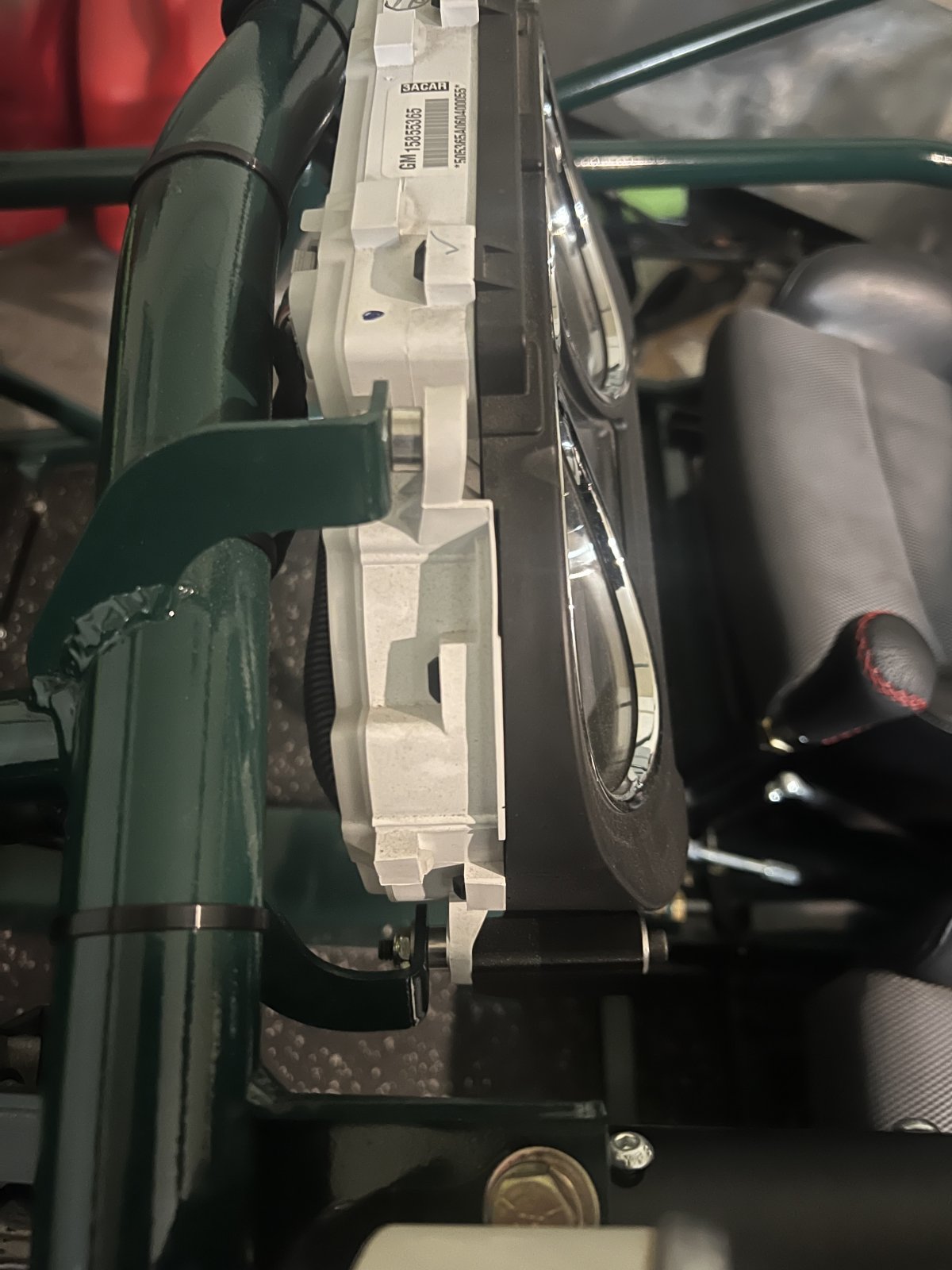

Guys. Another quick question on the spacers. Since I have spacers already on the bottom bolts. I should do the same for the top? I bought Lonnys Goblin, so I'm not sure if he added the bottom
Traé
There should be a small spacer on the top already. The longer one is for the button panel on the bottom. I don’t have DF’s button panel so I could be lying, but this is how mine is installed.
