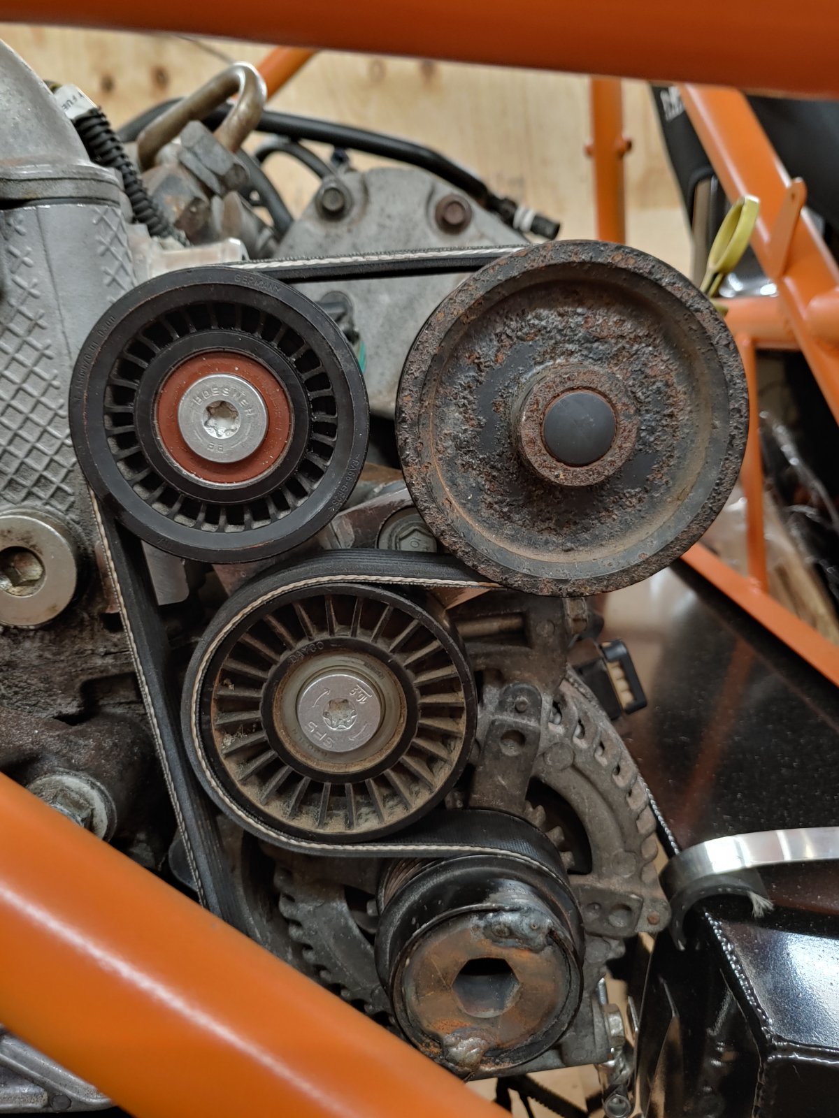

I have the ZZP adjustable tensioner and since the pully mounting bolt is left hand threads. All you have to do is grab the T50 socket from removing the seat belts and use a ratchet to smoothly unload tension without prying on the pully itself.
This also allows you to adjust for different pully sizes without getting new belts.
In my mind it removes the need to find an alternate A/C pulley system as the gutted compressor is light and easy and the stock available belt can handle down to the 2.6 pulley.

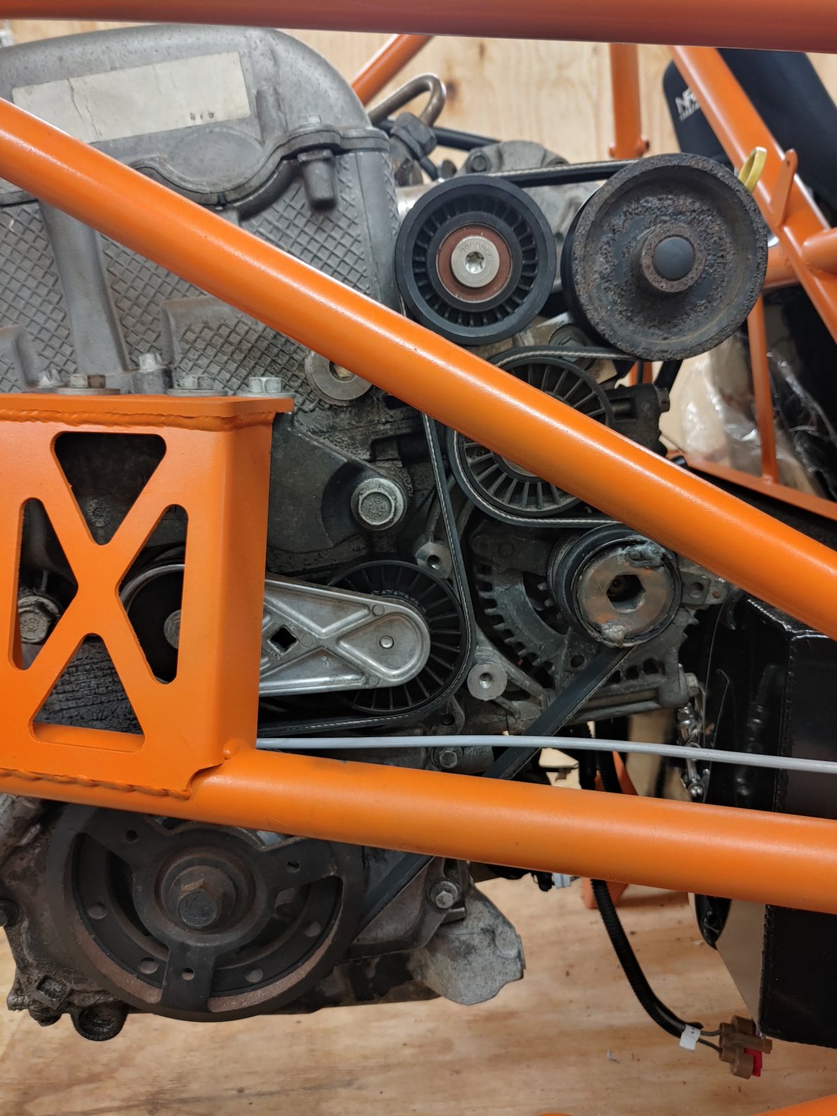

Do you have a picture installed?
Joebob
See below installed above the shock
43764
43765
43766

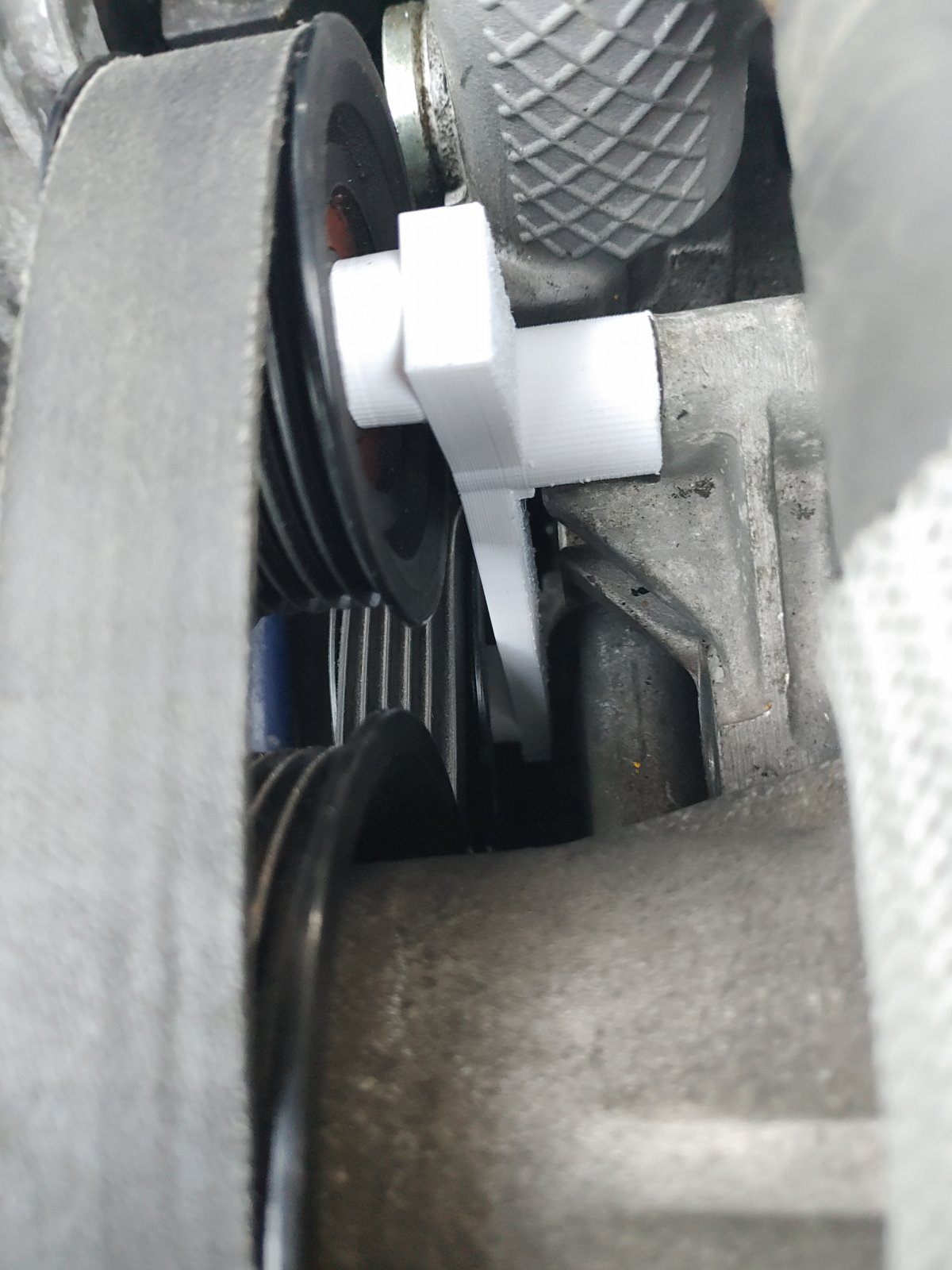

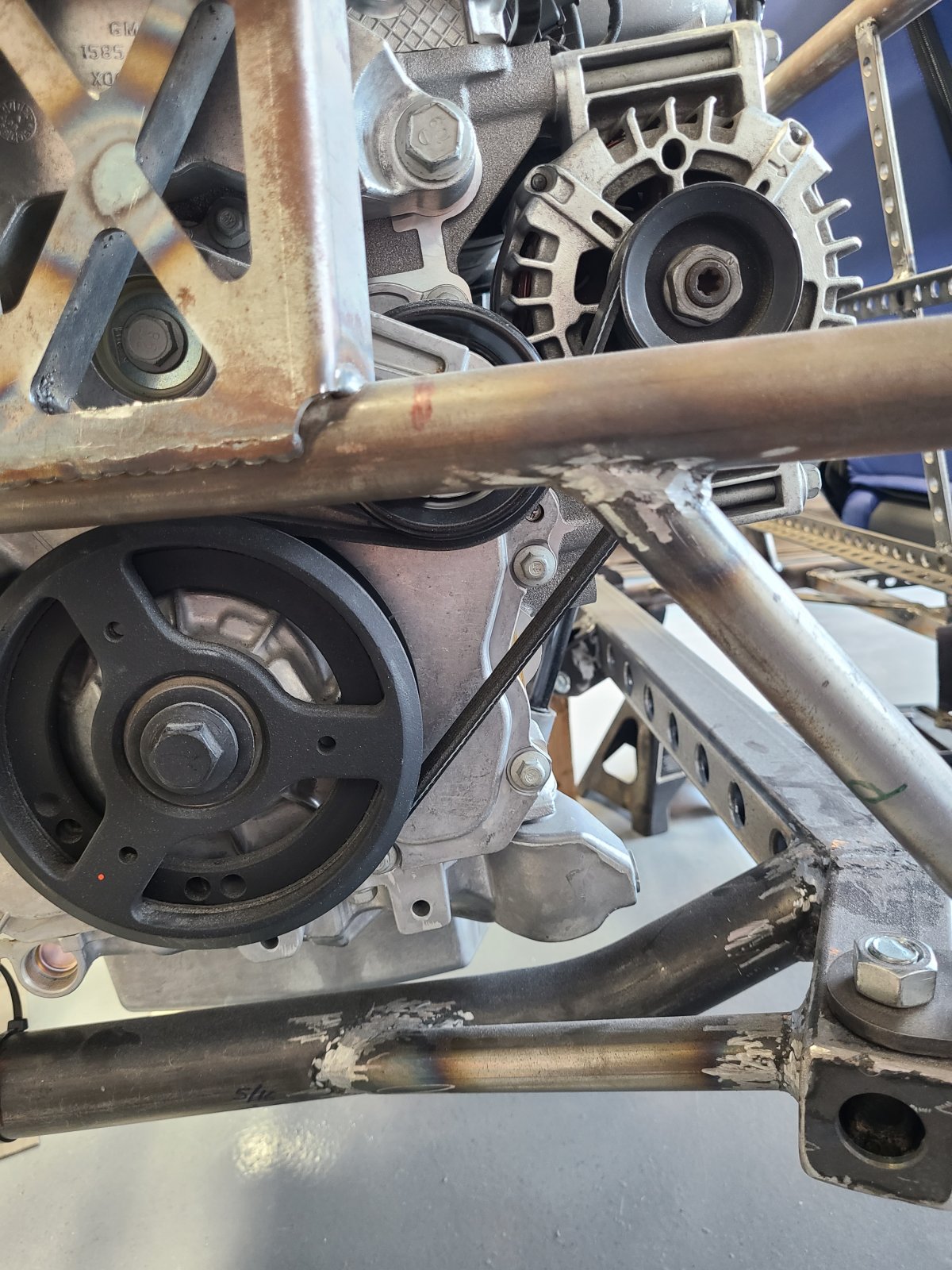

Only one piece needs the slot, one will just need the bolt hole. Other than that looks great.
One slot was my first thought. It would be a lot easier with just one slot and a drilled hole instead of milled slot. But it would not give me enough movement and weak the part unnecessary.
