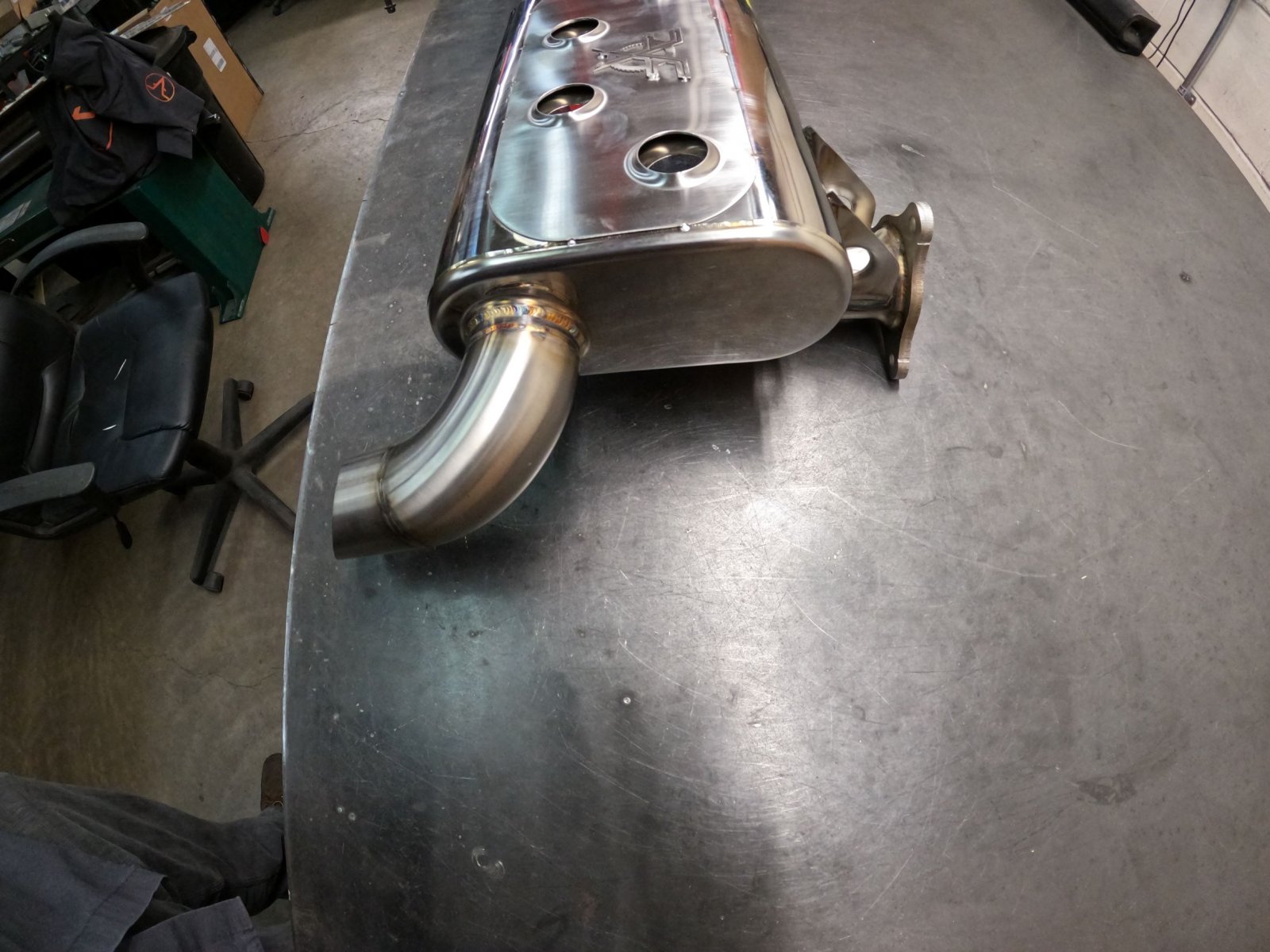

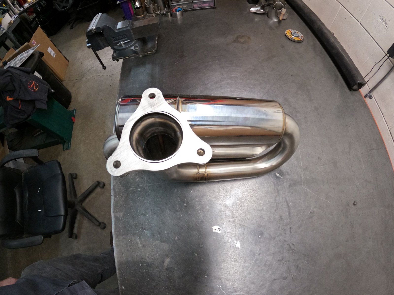

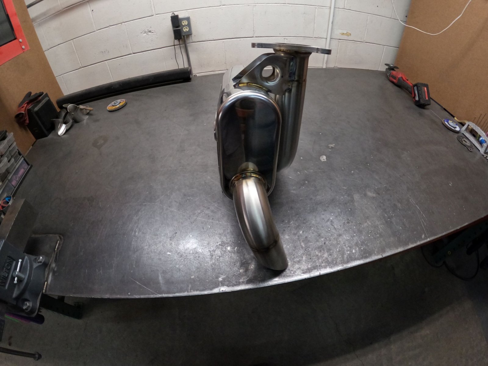

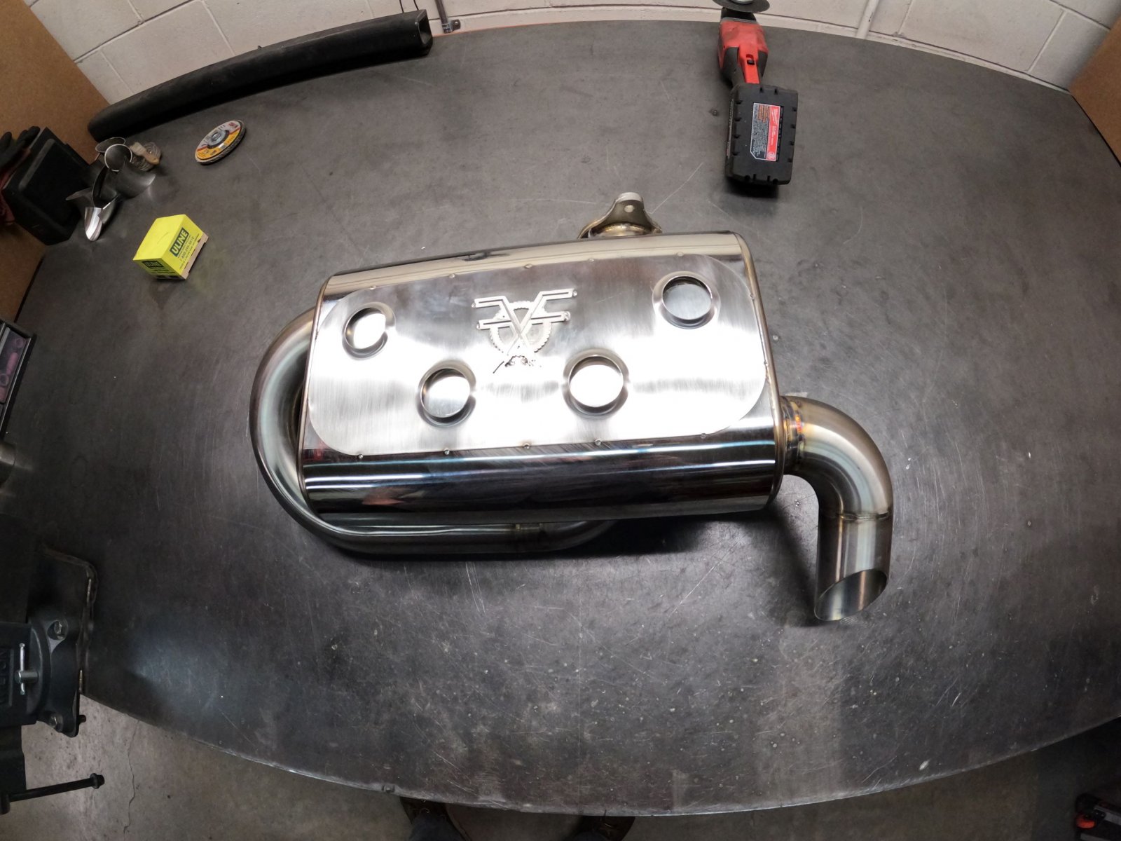

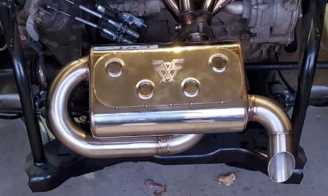

Hey everyone, let me start out by introducing myself. My name is Matt and I am the owner of a fab shop in Minnesota called Forever Fabrication. A few weeks ago an awesome guy by the name of Josh brought by his stock Goblin exhaust and trusted us to make him a stainless steel version of it. Here at Forever Fab we make custom performance exhaust systems all the time and this was no different.
For the build we used 2.5" piping along with a matching muffler, all our favorite parts from our friends at Stainless bros/Ticon Industries. Throw on a 3/8" stainless LSJ Flange and some dimple die gussets and Forever Fab flare and boom there you have it!
We can also make a 3" version too and sorry but we are waiting for a sound clip, Josh just needs to get his Goblin back together and we'll get get that clip!

That's a sharp looking exhaust. It looks like there's a 3" to 2-1/2" transition after the flange; is that correct? I'm curious if the tacked on nameplate is going to rattle.

Yes it is flared out to 3" to fit the flange. Where are you located?

Like Josh said it is a 3"-2.5" but that was jus because of the Flanges we sourced only came in a 3" for our production line we'll be making our own flanges so the 2.5" muffler will have a 2.5" flange.

I can't figure out how to get the video posted here. I put it on FB, but It sounds great! I don't like a loud exhaust. This has a nice idle and a great sound when you hit the gas.
