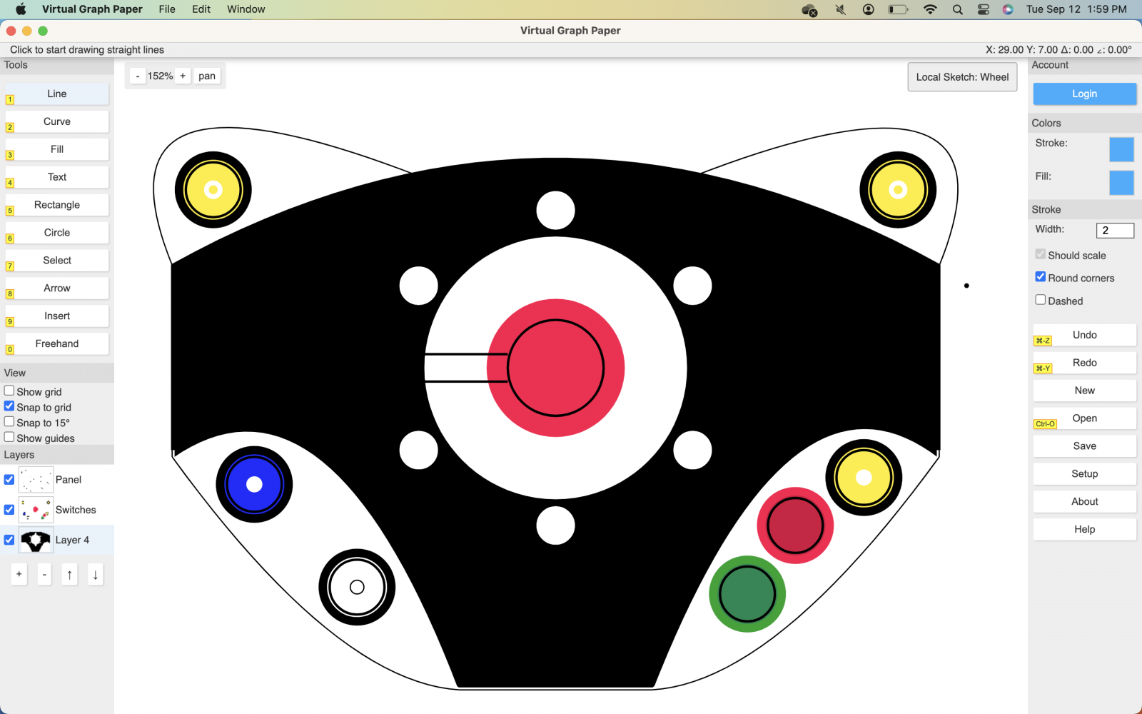

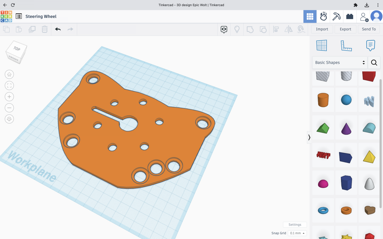

Just finished up the model for this. I'll post pictures once I print it and the switches show up. If all works well, I'll get it made out of carbon fiber. It uses the stock DF steering wheel and will mount in-between the quick connect and the actual wheel with some longer fasteners.
Top two yellow will be latching for the turn signals and will flash to tell you they are on.
Blue is latching and lit for high beams
White is latching and lit for running lights/low beams
Lower right side yellow will be latching and lit for power
Red will be a momentary engine stop
Green will be momentary starter
Center is horn
Thoughts/ideas?
