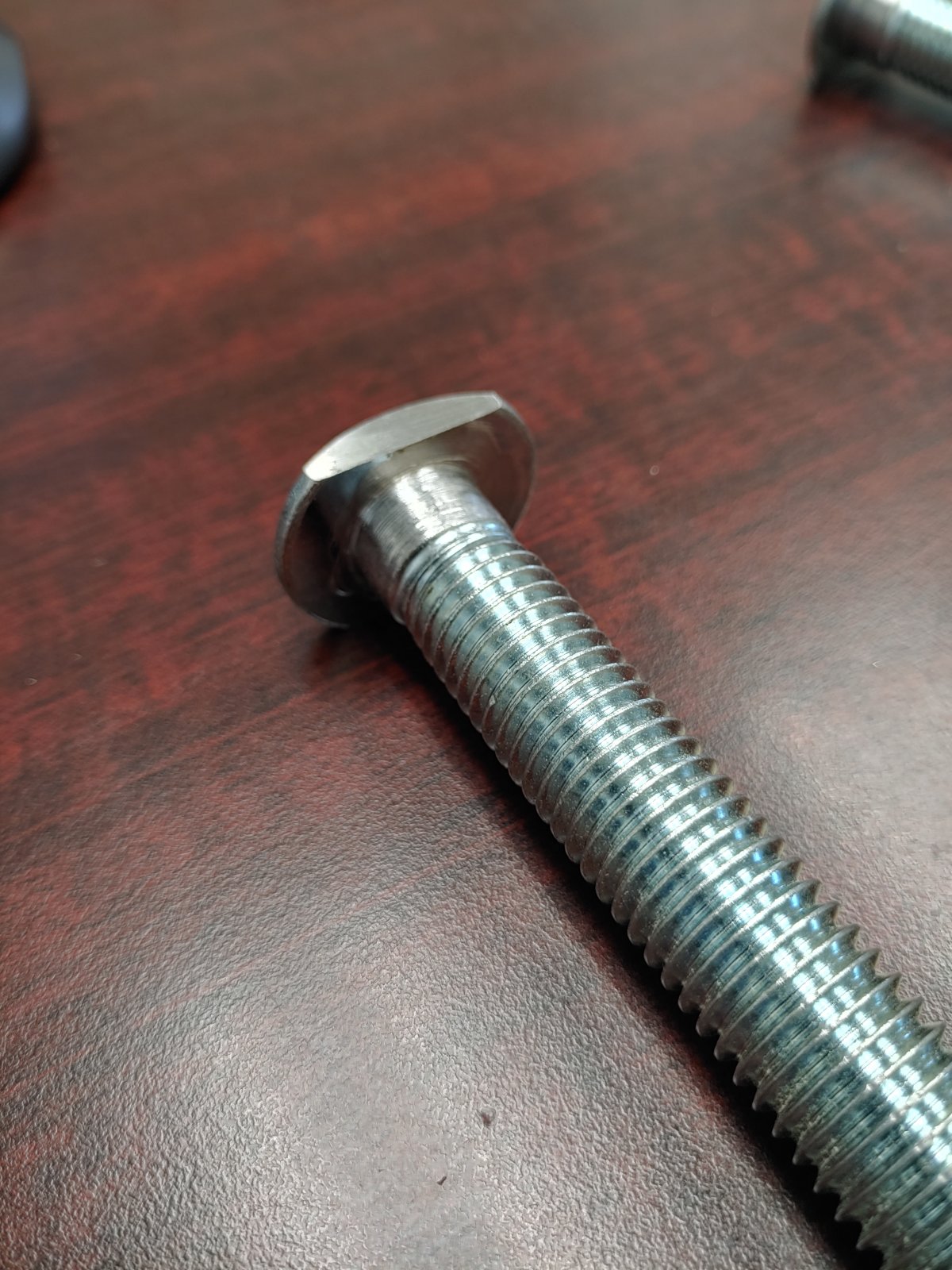

Can someone tell me why, the kit comes with carriage bolts? Neither side of the sub-frame has a spot for the head of the bolt to fit into. What am I missing?

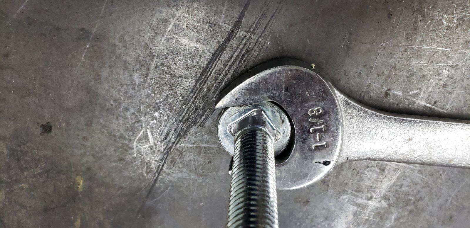

I ground the square to a round and put a flat on each side for a wrench to get it flush w the subframe.
