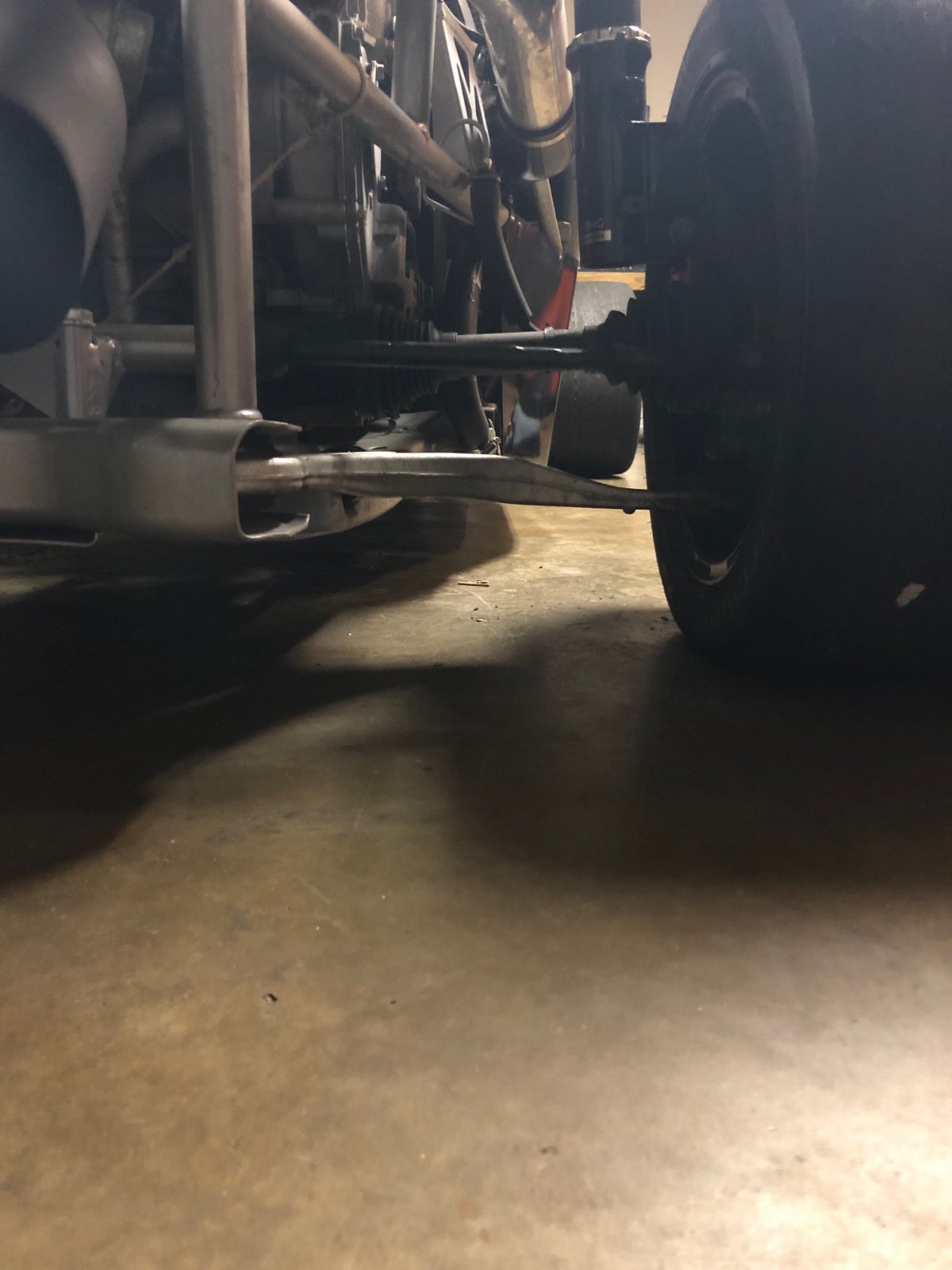

And for the front suspension you need to adjust the height so that the lower control arms are pretty much level with the ground with you and a passenger in it.

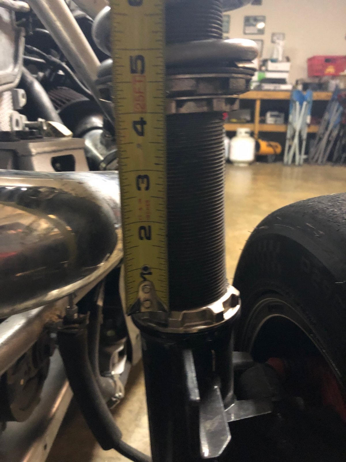

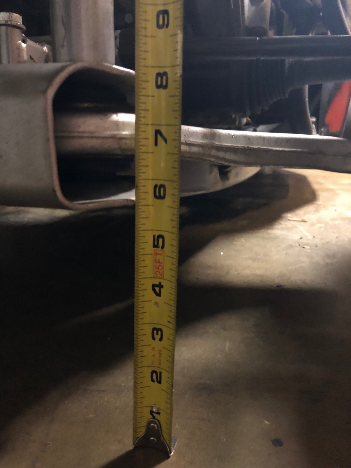

ok so Front
Caster = 8-9%
Camber = 3% neg
tow = 1/8" in (I found a calculator and for my tires this is .155*)
Dampen setting = 6 clicks off of soft
tire pressure 12 lbs
ride height = 3" clearance to bottom of frame tube where hose comes out (bottom arms perfectly level.
Rear
Camber = 3% neg
tire pressure 14 lbs
Ride height = 5 1/2" but I may bring up to 6-7" to get the arms point up towards body more. What do you think?
this will be the base setting for the stock front suspension with the 150 lb rear suspension unless any of you have any other suggestions!
