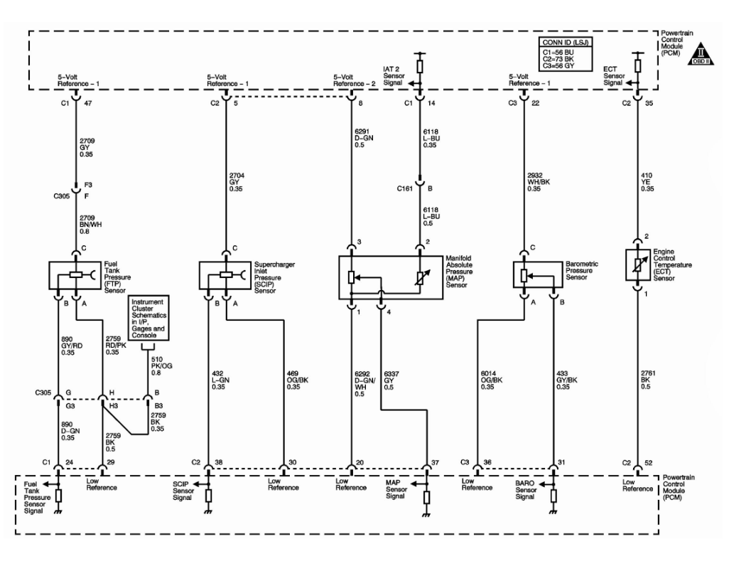

I'm not sure where the wires go to the ECM. I've looked at AllData to try to figure it out. I'll keep searching but these schematics are a bit confusing.

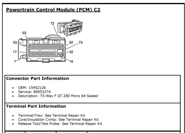

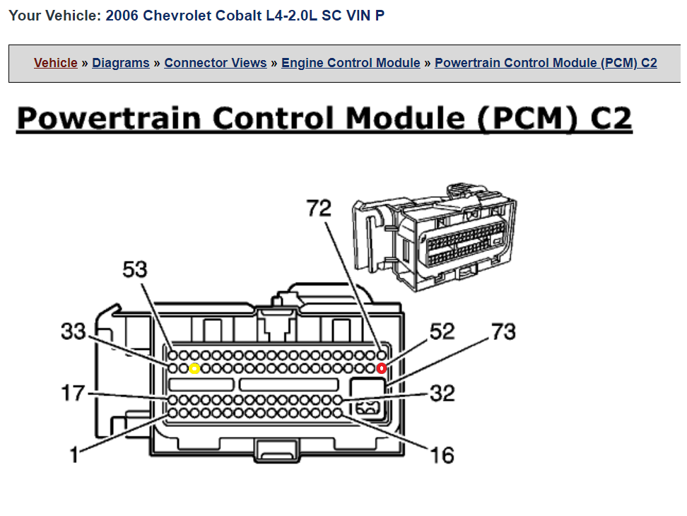

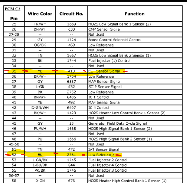

Found this, but I'm not sure what it's telling me.
One is going to PCM C2 - 52
Other is going to PCM C2 - 35
D&dgoblin69
The powertrain control module (PCM) applies 5 volts to the engine coolant temperature (ECT) sensor circuit. The sensor is a thermistor which changes internal resistance as the engine temperature changes. When the sensor is cold, internal resistance high, the PCM senses a high signal voltage and interprets the voltage as a cold engine. As the sensor warms, internal resistance decreases, the voltage signal decreases and the PCM interprets the lower voltage as a warm engine.
D&dgoblin69
35-2 52-1 what that wiring diagram is telling you is the ect engine coolant temp is reporting to the ecm coolant temperature. Your - - - is default ecm doesn’t know temp hence the reduced power. It’s trying to keep you from potentially overheating . rule out the harness with a resistance check ecm to ect . Ecm 35 to ect 2 resistance check should be about .3 ohms and ecm 52 to 1 should be .3 ohms. Becareful probing the ecm and ect terminals you don’t want to push a test lead to big can cause terminal to spread bigger then the pin of the ecm ect. You just need enough drag when pushing test probe in. if you get a open ol in one of the resistance test you can in splice in a new wire or pull on suspect wire. A open resinstance reading is a broken wire when pulling on suspect wire with enough finesse you will feel wire stretch because your only pulling on the plastic aka insulator
D&dgoblin69
i keep saying ecm i forgot it was pcm back then but same thang. On the wiring diagram for reference ye is yellow and bk is black so you can verify your on the right wires
