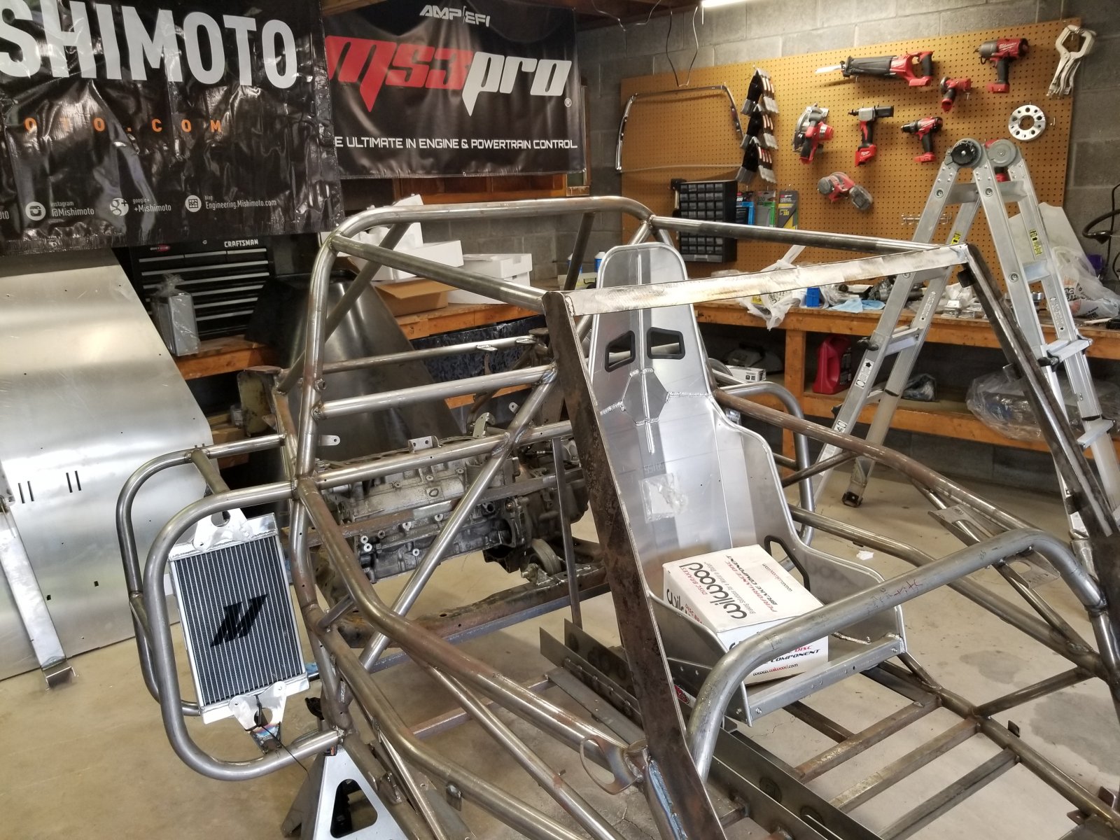

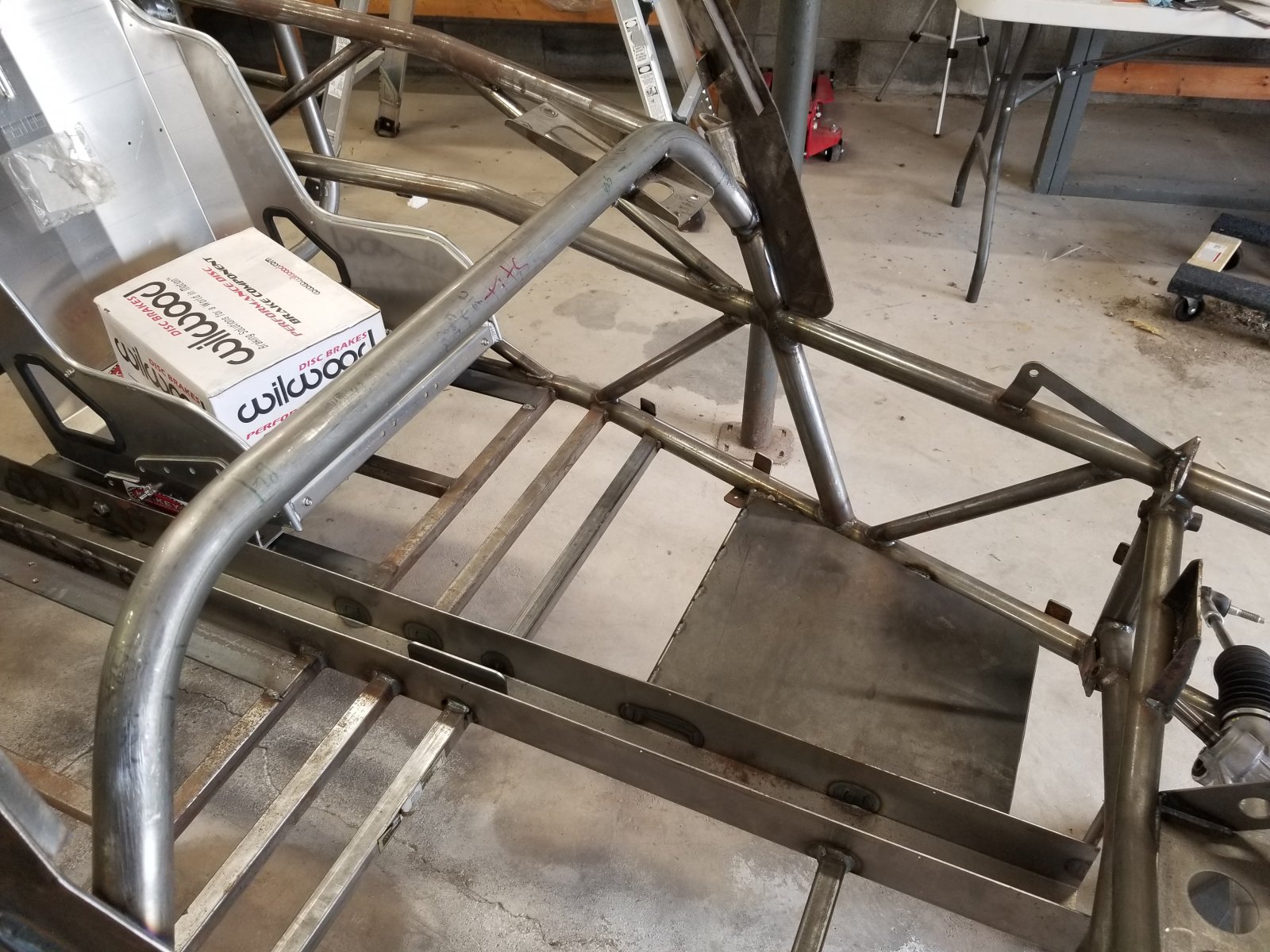

Here you can see a bunch of what was done. Windshield frame, side pods, new dash bar, harness bar, flat stock to mount the Kirkeys, and upsidedown steering column mount(will get fixed later on when they stop by to add mounting tabs for coolant/heat exchanger tanks and other misc stuff.
15089

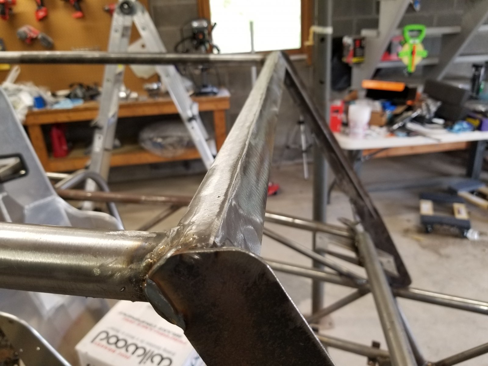

Close up of the top of the windshield frame. Still needs some massaging. It is flat stock welded onto a round tube and filled with weld on top to smooth it out. The mounting lip for the windshield is recessed 1/2" per recommendation of my local glass guy who will be doing the windshield. 1/4" for the glue and another 1/4" for the glass itself and hopefully it'll sit flush.
15091
Bottom view.
15092

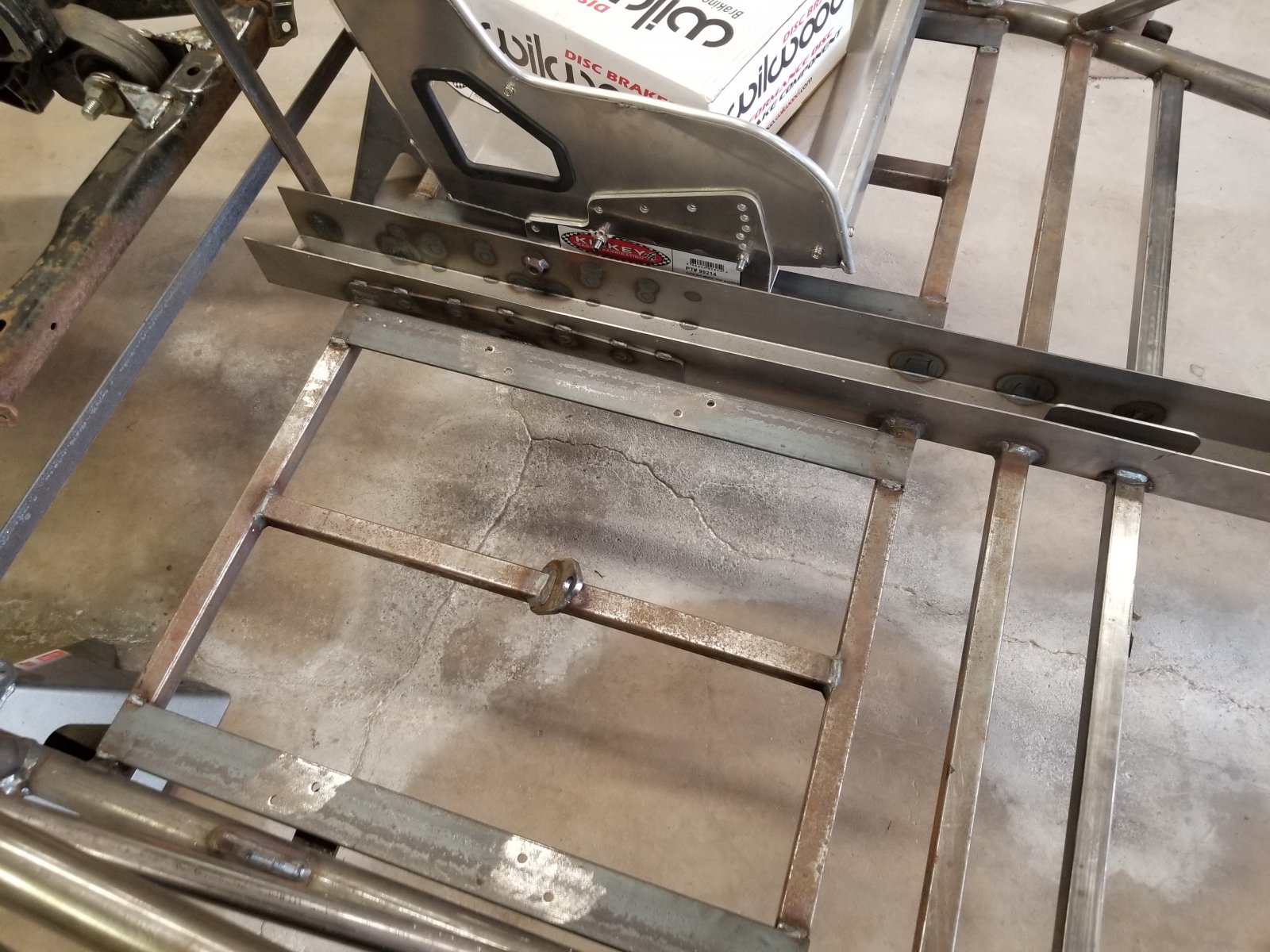

New dash bar just to clean things up and match the contour of the hood better. The hood will have to be cut up to fit with this windshield design. Extra square tubing added to the floor so I am not stepping on the aluminum bottom panel and a big piece of flat steel to mount my Wilwood pedal box to. Yes the bracket for the steering column is on upside down. It'll get fixed when the fab guy stops by to finish up the hood pins and misc. mounting tabs.
15094
Extra square tubing in the floor again and flat stock to mount the Kirkeys to.
15095

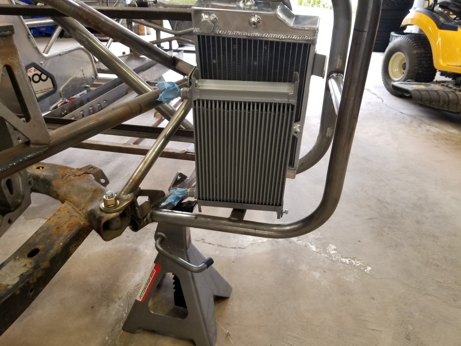

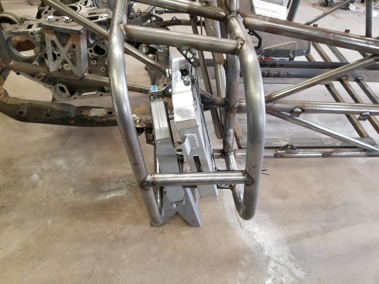

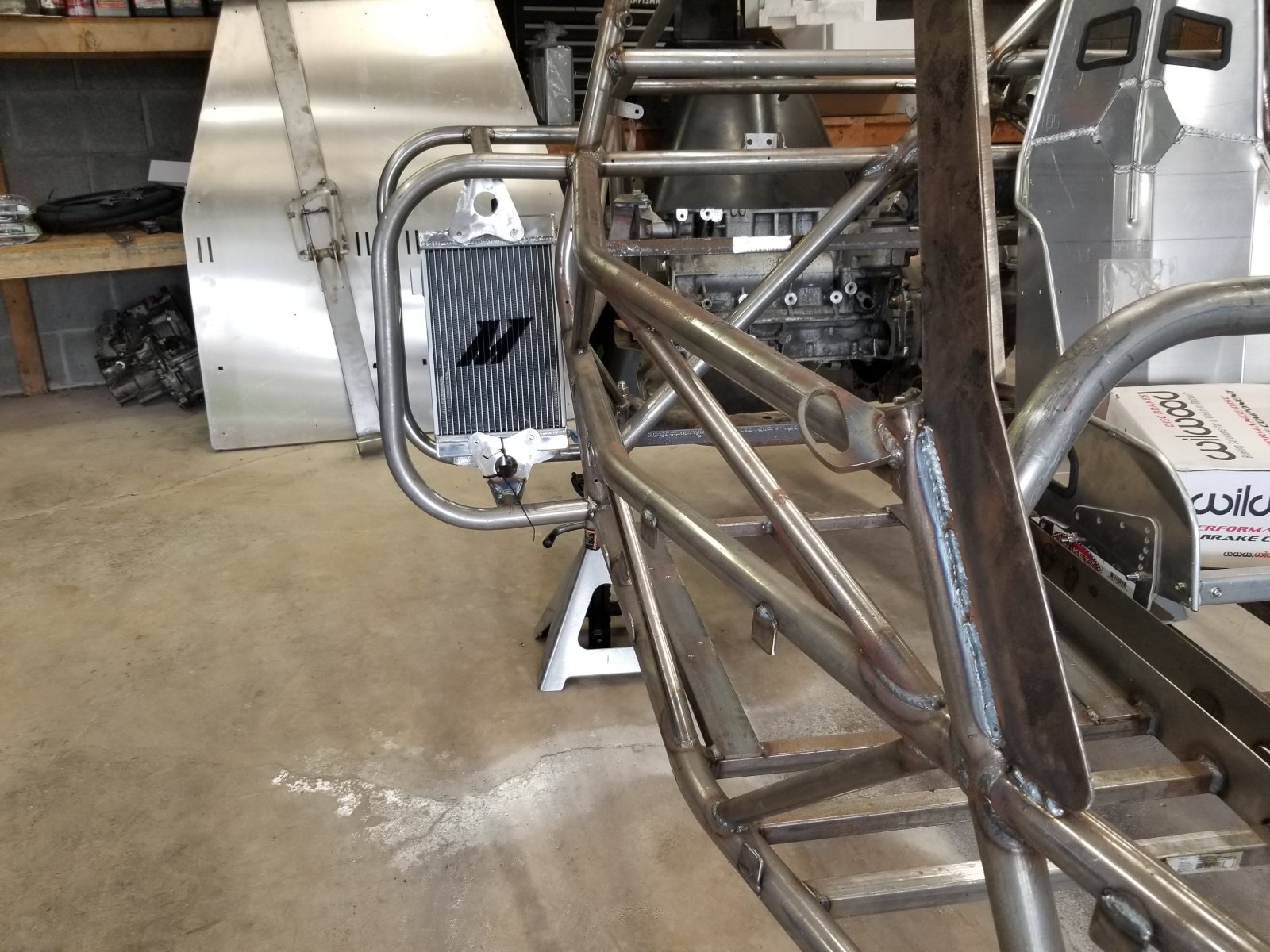

Side pods on both sides and they will be set up the same. Kawasaki KFX700 radiators from Mishimoto to be used as heat exchangers for the supercharger system.
15096
Side view.
15097
And mounting tabs on both to fit a Mishimoto 25 row oil cooler. At the moment I am not planning on running them, but wanted the tabs there in-case I need to run them in the future.
15098

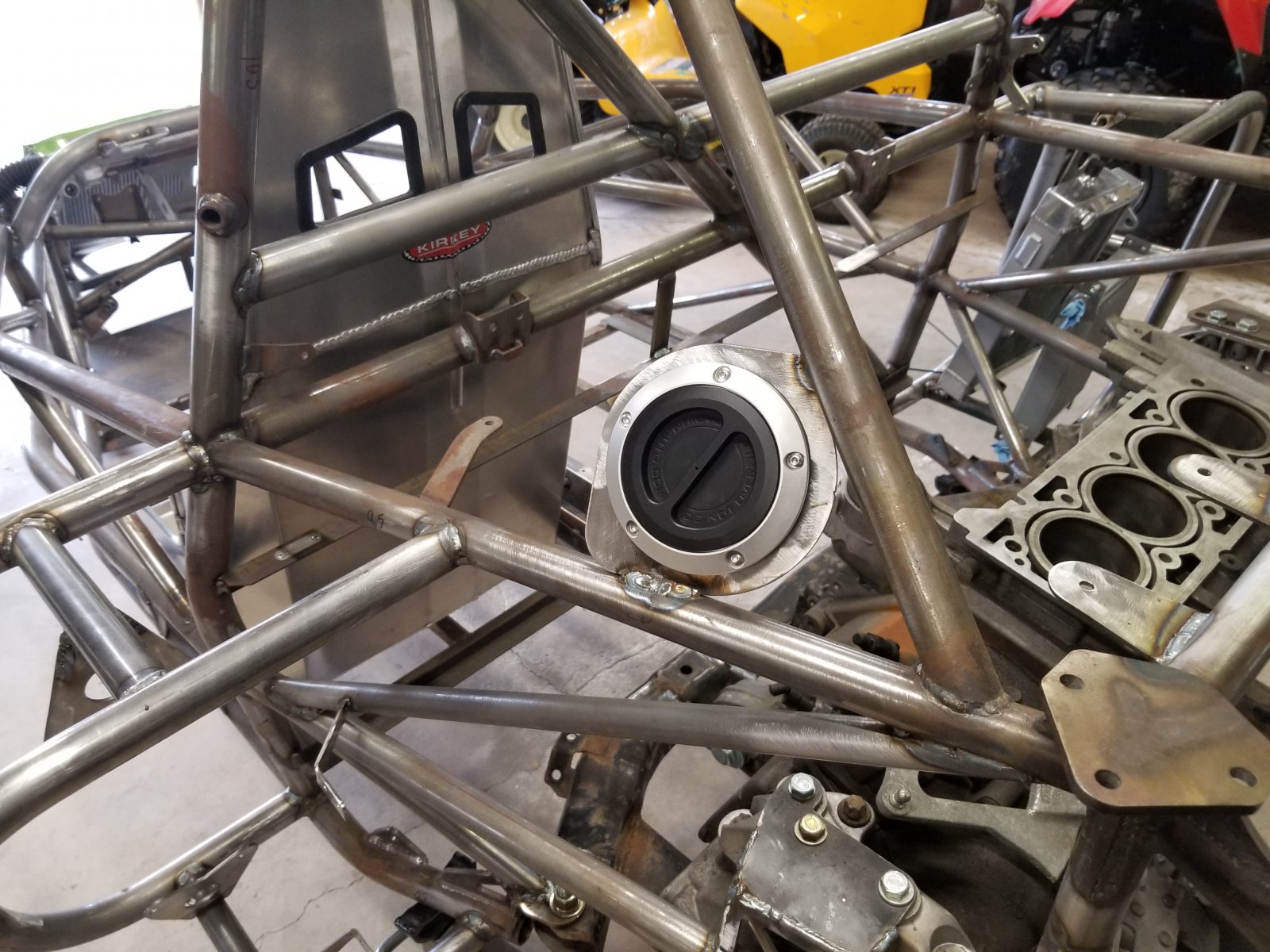

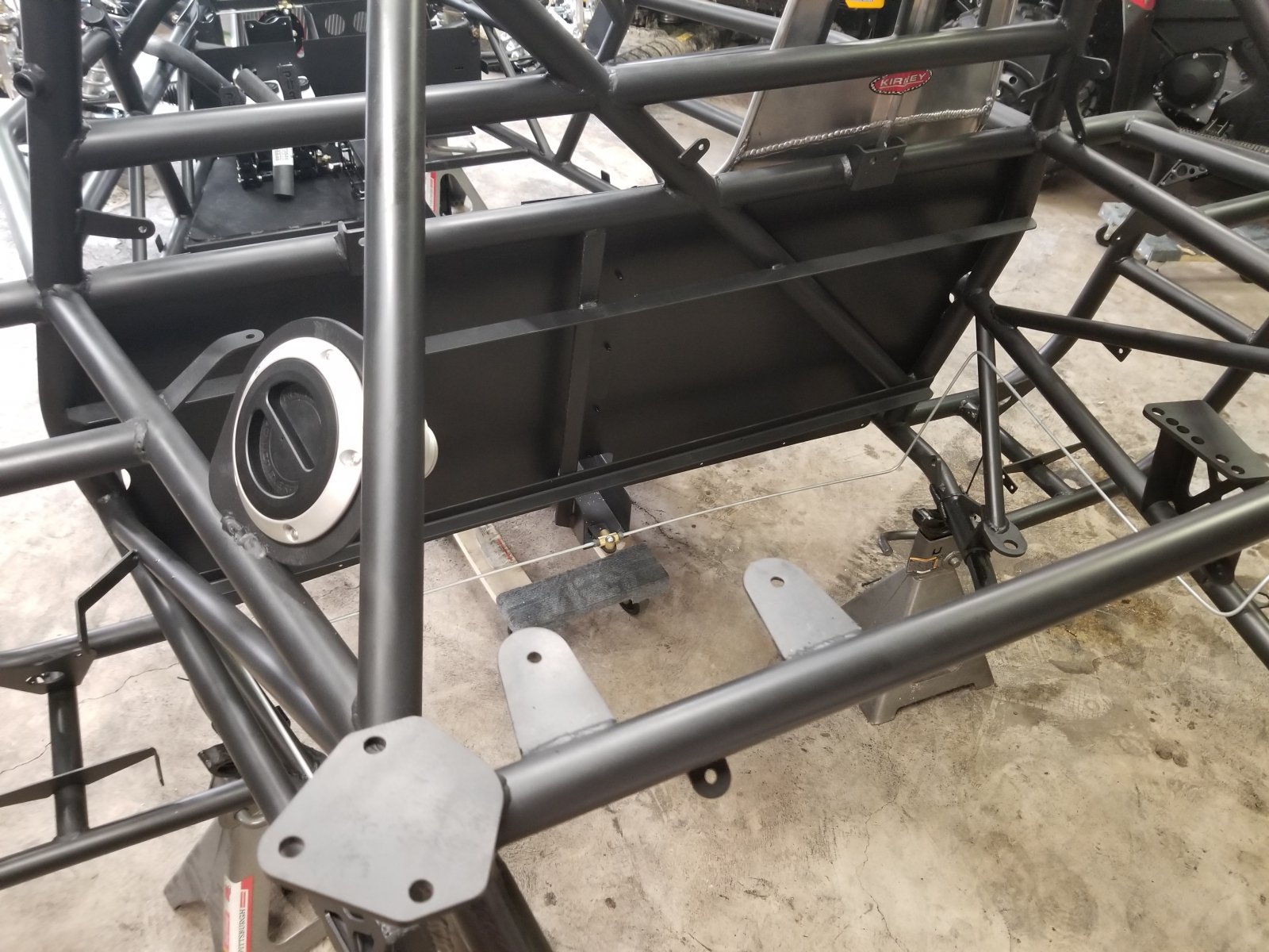

And clearance for the F40 trans, better shot of the harness bar, top mounting bracket for the fuel tank was raised 3"(more on that in a few months hopefully), and for you Desert Sasqwatch, relocated fuel filler. The Radium FCST I have has a fuel fill provision on it so this location gives a pretty straight shot right too it. "But that is where the electronics go!!!!" All of the electronics are going under the hood since I have to build custom harnesses for the MS3 Pro. The only things that are going to be back there is the drivetrain, fuel tank and filter, coolant tank, and heat exchanger tank and...... those tanks are most likely going to be custom built.
15099

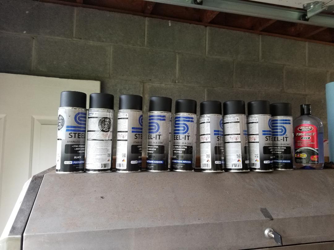

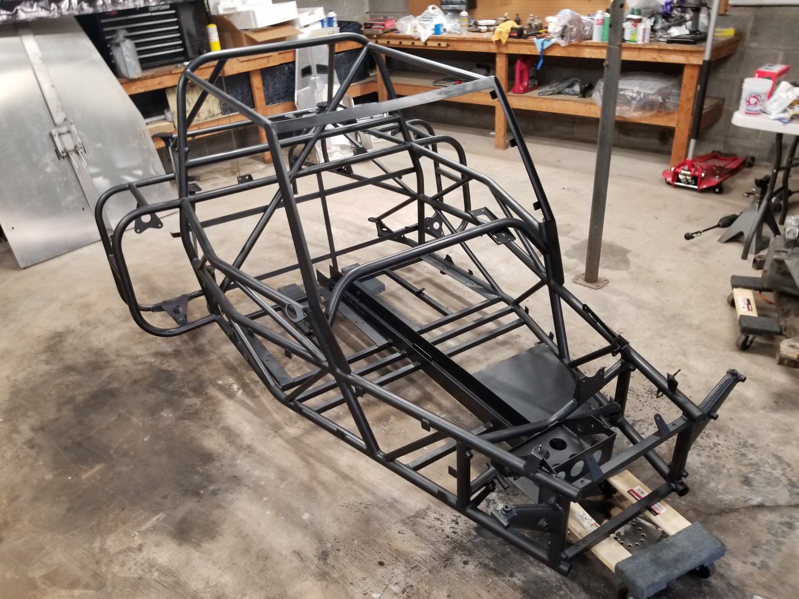

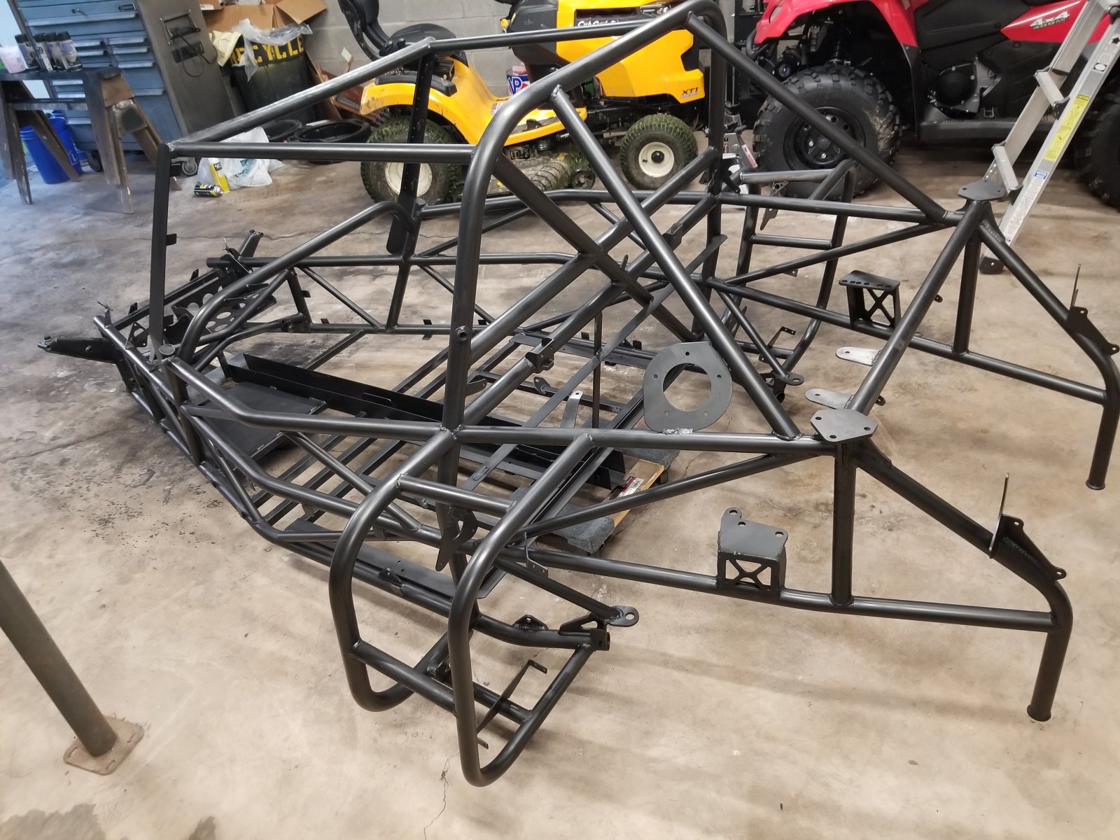

A buddy stopped by today and we got the chassis 90% painted with Steel-it. We have to flip it over to get the underside. I only ordered 4 cans of Steel-it and turns out that 5 cans is the magic number to paint a whole goblin chassis. So far I am happy with the results.

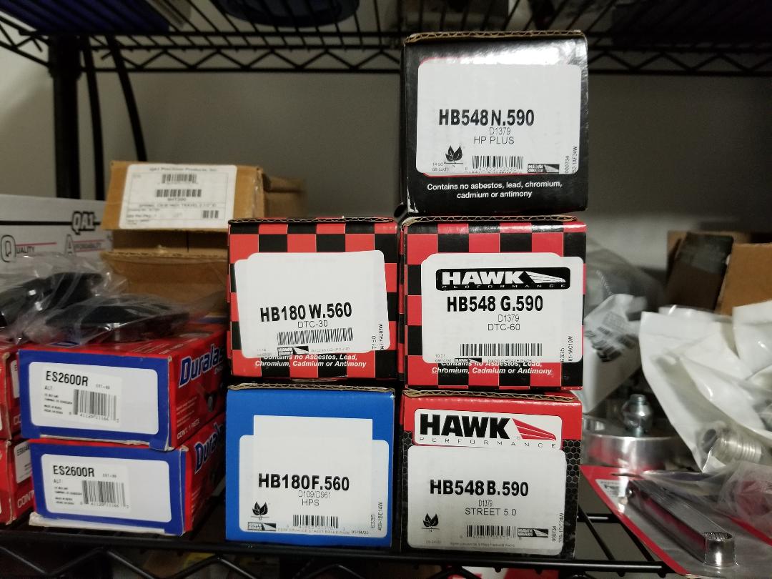

Hawk Performance followed through with their offer.
15921
Street 5.0(F) and HPS(R) for street driving.
HP Plus(F) and HPS(R) for autocrossing.
DTC-60(F) and DTC-30(R) for road racing.
I am running SS/TC front and Evo 9 rear Brembo calipers so the exact part numbers will be no good to anyone else. I told them the car setup and what I planned on doing with it and this is what was sent. The best part beside making a few new contacts that could possibly help promote the car is that all 5 sets were free. I know it is a marketing ploy. Give a long time customer some free stuff and they'll recommend their product to other people. I am not ashamed to say that it worked.

How did you apply the Steel-it?
Rattle cans.

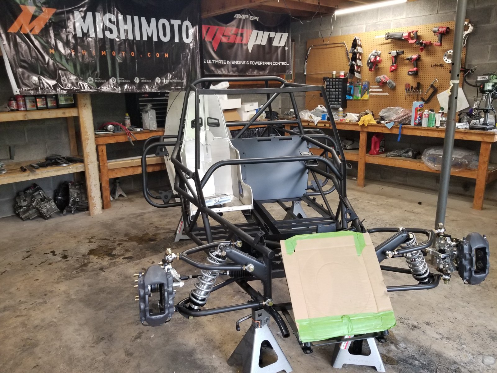

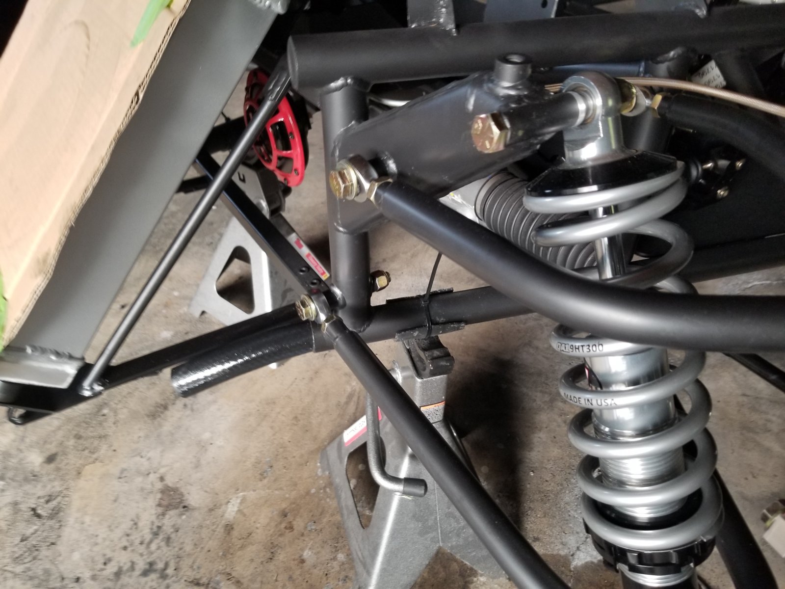

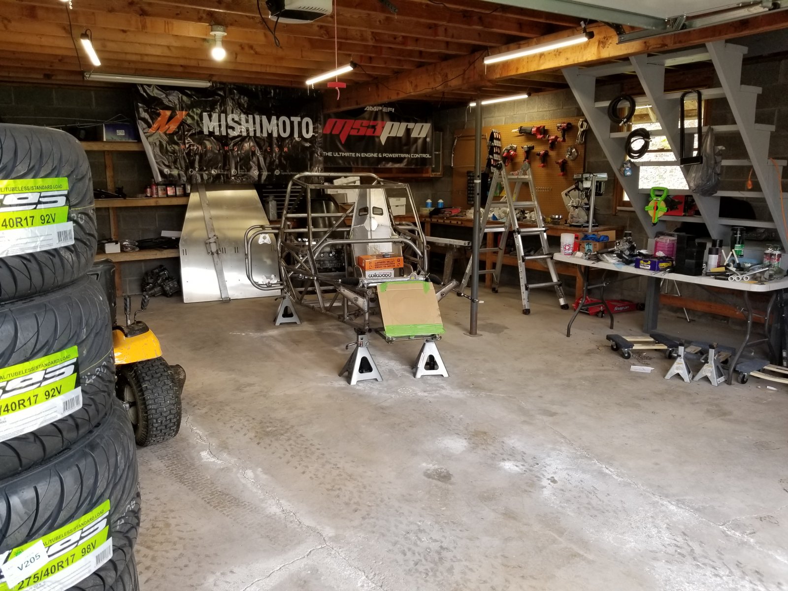

I got the coolant tubes pulled Thursday night. I ended up strapping the chassis to the shelves on the back wall and tying the pull rope to the lawn tractor to pull them. Then I spent a few hours today and yesterday tossing the front suspension together to make it look like I finally have made progress.

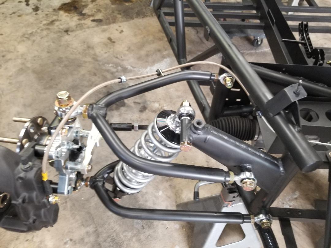

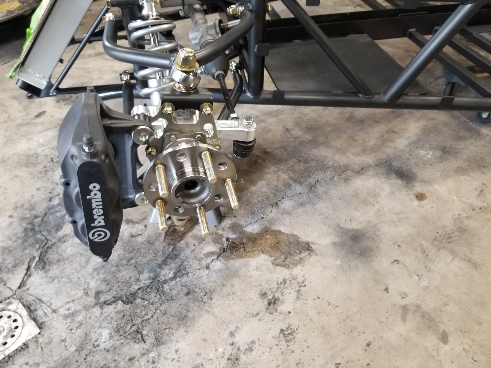

I had to toss the calipers on. This coming week I plan on ordering the front brake rotors. With that I should have everything to button up the front brake system. I just have to sucker a friend in stopping by to help position the Wilwood pedal box to be able to have it plumbed 100%.

Fuel filler is officially in and tossed on the rear brake lines.
