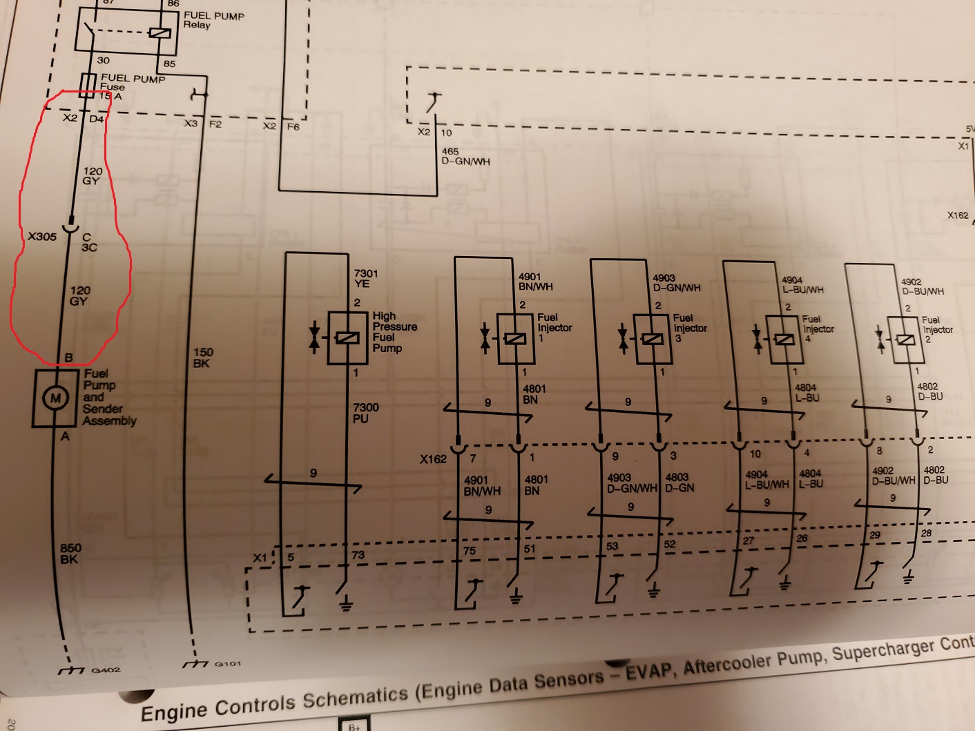

Pin E1 is your rear defroster.
Pin B6 is your horn relay control wire. It was part of the horn switch circuitry on the steering wheel.
Pin D4 is the gray wire that runs to your fuel pump connector.
I have an '09 TC service manual. Let me know if you need any thing else identified.

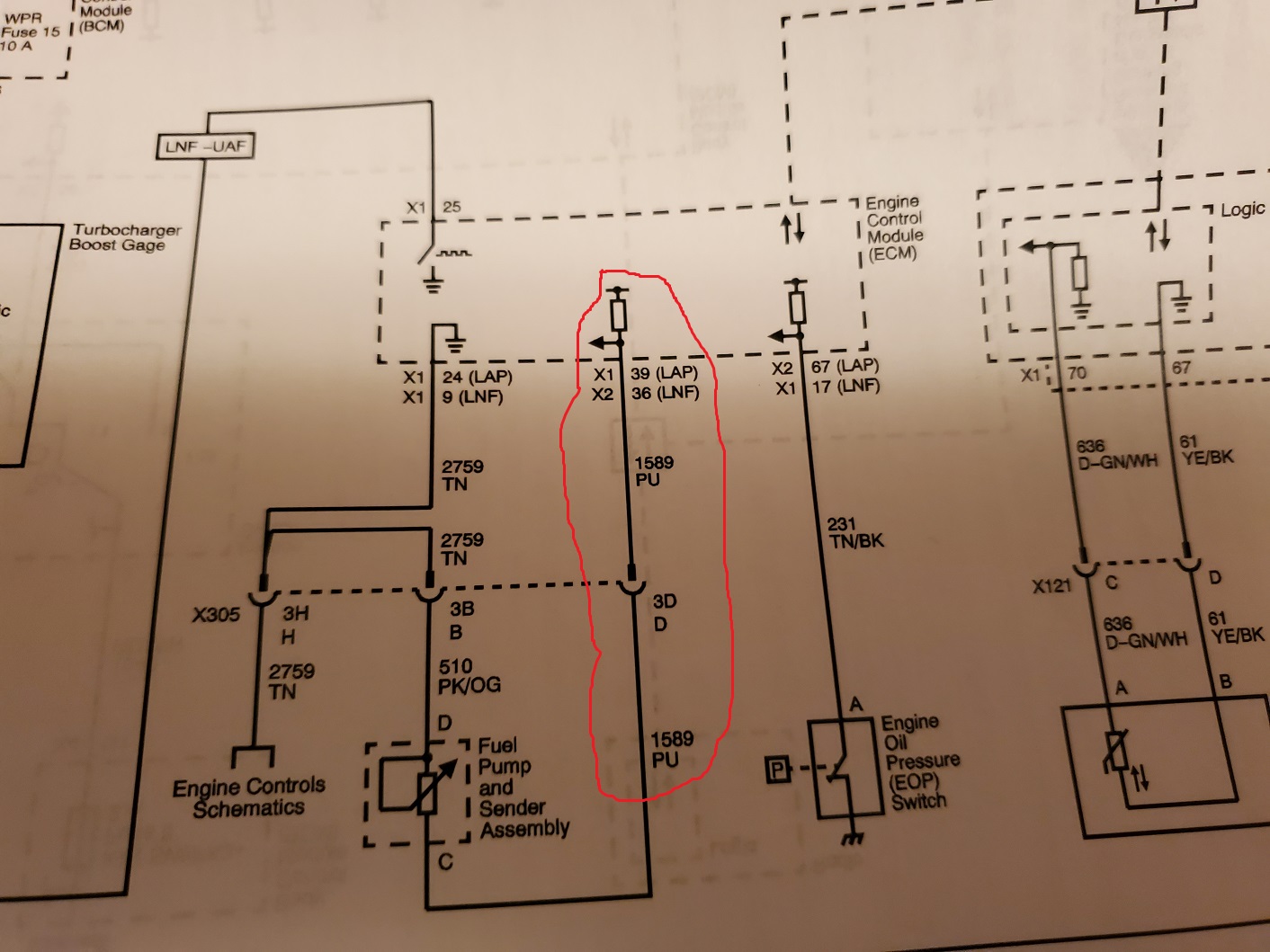

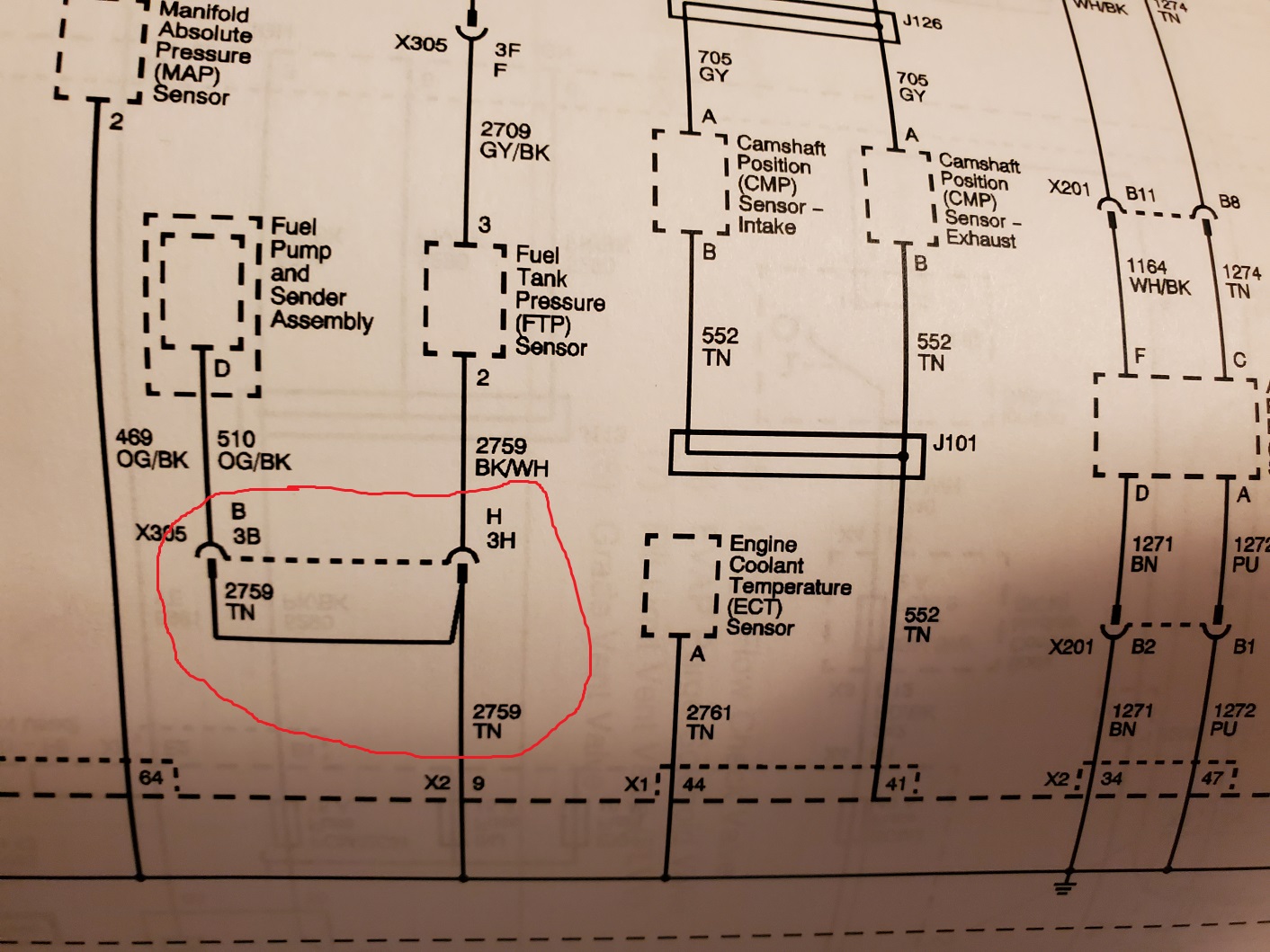

Thank you so much. My next, and I believe final problem with wiring is the fuel pump/level sender it’s quite a bit different from my LAP.
I assume the Fuel Tank Pressure connector is removed?
I don’t have a turbo car, but I would assume so. It’s part of the evap, which is not needed.
