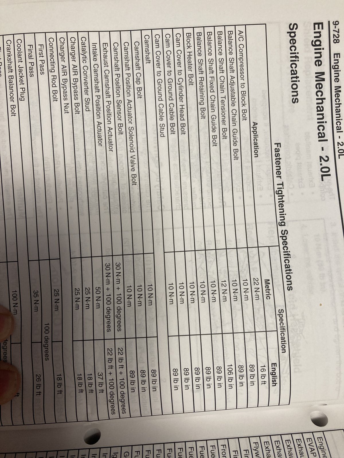

That pdf document has 27 torque specifications, and not one of them is for the balance shaft.
Do you know what engine that pdf is for? TheNuker had a LSJ, now an LDK. Comegetjoe has a LNF.
Page 15 shows it for LNF. I used this doc for my engine but installed the ZZP neutral balance shafts so I never noticed there was no spec in it for the balance shaft drive sprocket bolts.

Not exactly sure which spec you are looking for.
