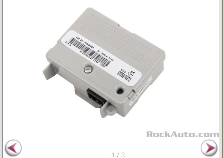

I am missing this box (I have one on order from rock auto)
I have a no crank no start.
No power to starter relay.
No power to purple starter wire.
Before I start checking grounds and GM high speed lan connections does anyone know if not having this box will result in a no crank no start due to some anti theft lockout?

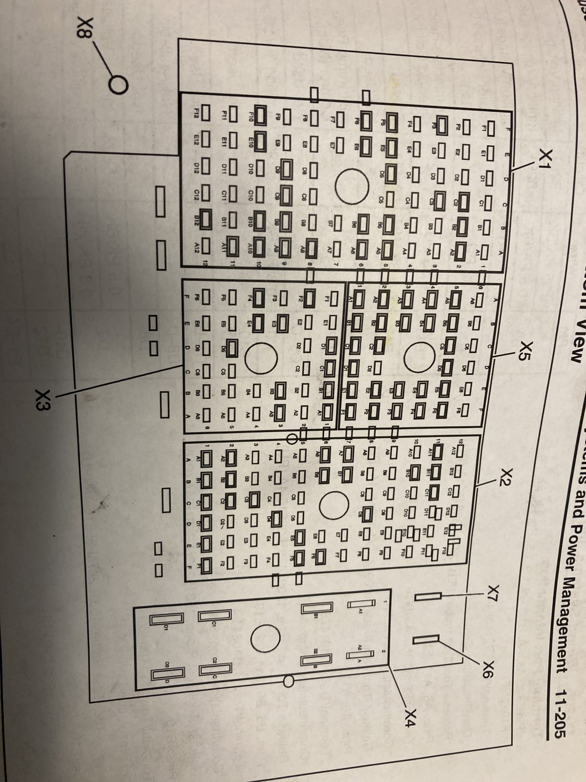

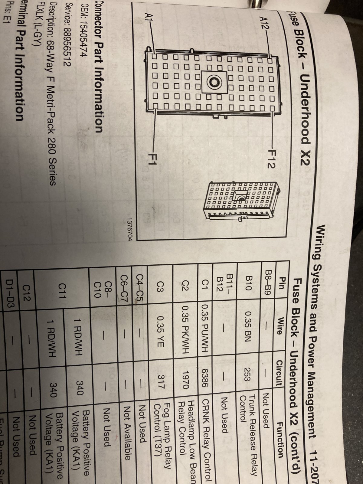

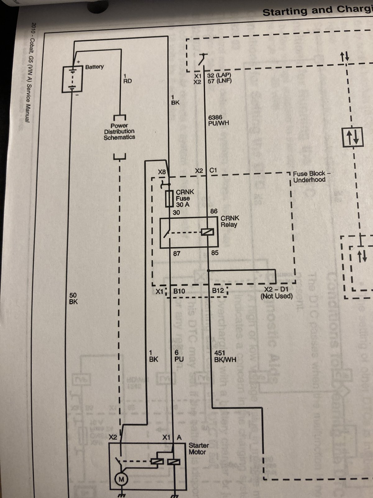

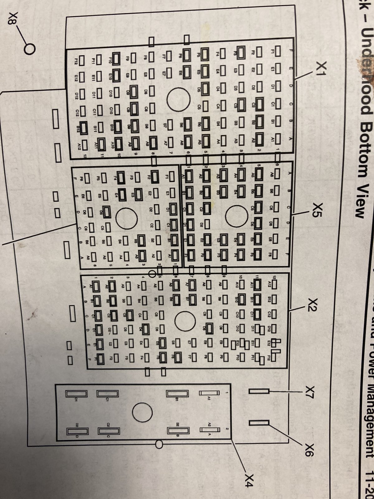

Late model wiring diagrams show crank fuse as hot all the time, tied directly to the X8/B+ post.
There seems to be an error in the wire color tying to X8. It’s shown as red elsewhere.

You can start by checking it at the starter relay. Remove the relay. One pin should be hot all the time. One should have continuity with the purple at the starter solenoid. One should have continuity to ground. The last should have voltage when you try and start it.

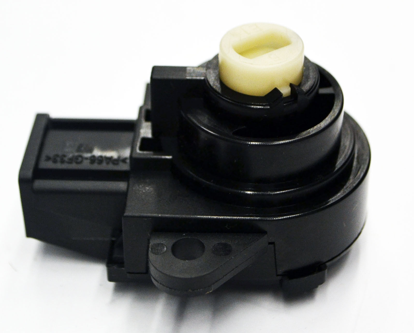

it turns out that the new ignition I bought off of ebay had a bad part on it, part #23215459 I swapped this out for one off of my old ignition and bam. she crank and run now.
