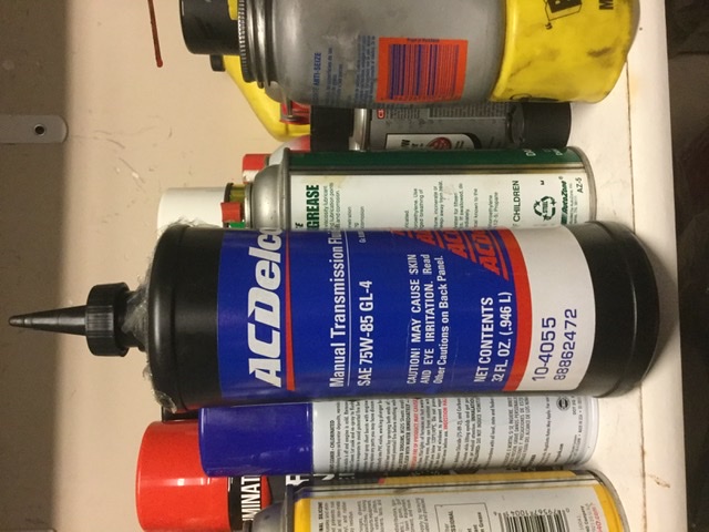

Indy Lonnie
This is OEM...

Thanks ! That helps a bunch looks like this is the current replacement for that part number. http://www.crateenginedepot.com/mob...75W-85-GL4-19351859-P11005.aspx?ItemId=798051
