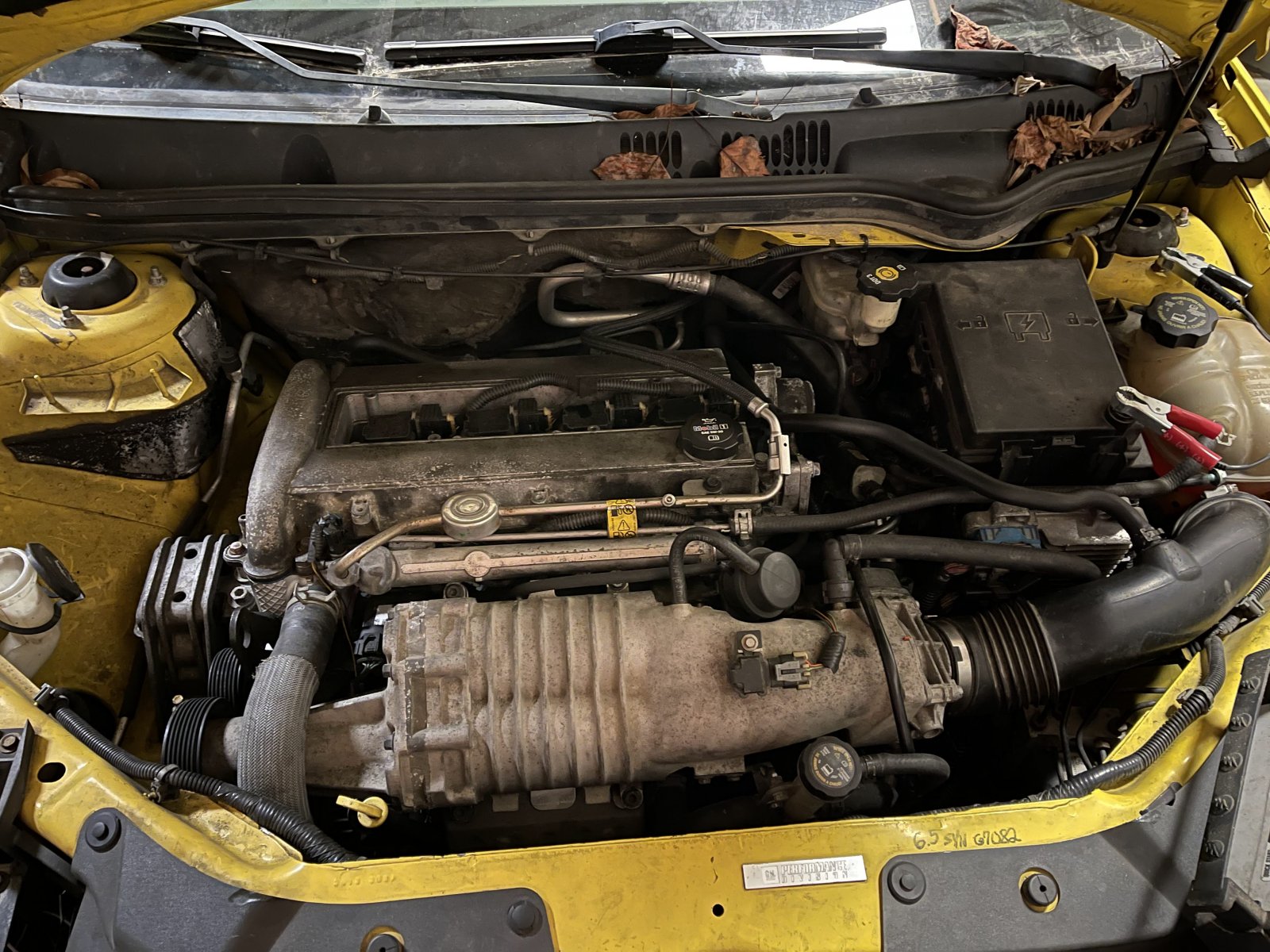

For this build, I have picked up a 2007 Cobalt SS/SC to use as my donor. As far as I can tell, the powertrain is stock and never modded. The car has the factory exhaust with cat intact, factory pulley on the supercharger, no dual pass endplate, and the factory intake.
The odometer reads just over 171k miles, but the engine was reportedly rebuilt by a local speed shop earlier this year. From what I was told, that includes new rod bearings, new main bearings, new piston rings, cometic head gasket, ARP studs, valve job, new timing chain kit, and new sensors. I was told that the reason for the rebuild is the car had sodium-filled valves installed at one time, and late last year one of those valves burned and was no longer sealing. I didn't find a cometic sticker and an ARP document in the car so I have no reason to believe the previous owner lied to me.
After this supposed work, the clutch slave cylinder died and the previous owner parked the car and never drove it any longer. The clutch has very little resistance so something definitely is wrong there, but I'm not sure if I will troubleshoot or attempt to fix, or just start doing the tear down. To start, I am going to spend time cleaning out the car (trash, etc) and removing the Viper alarm/remote start system.

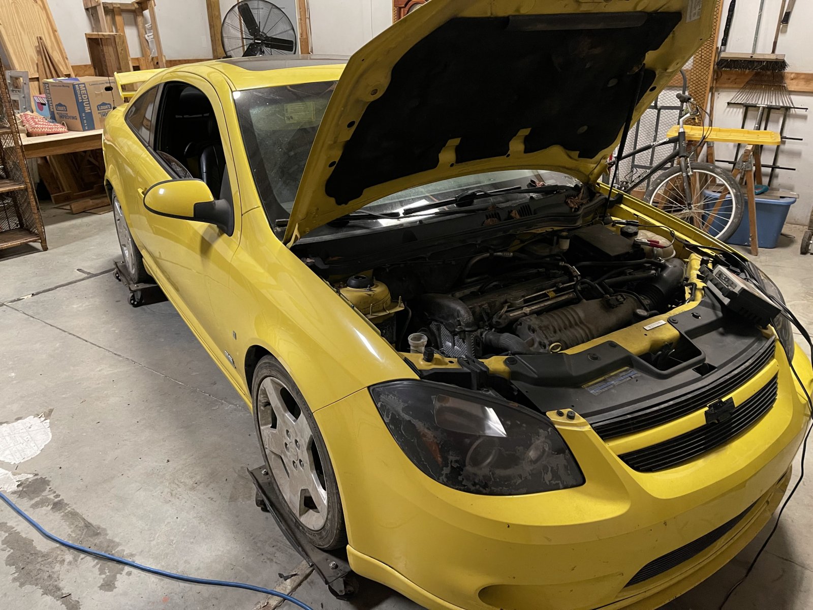

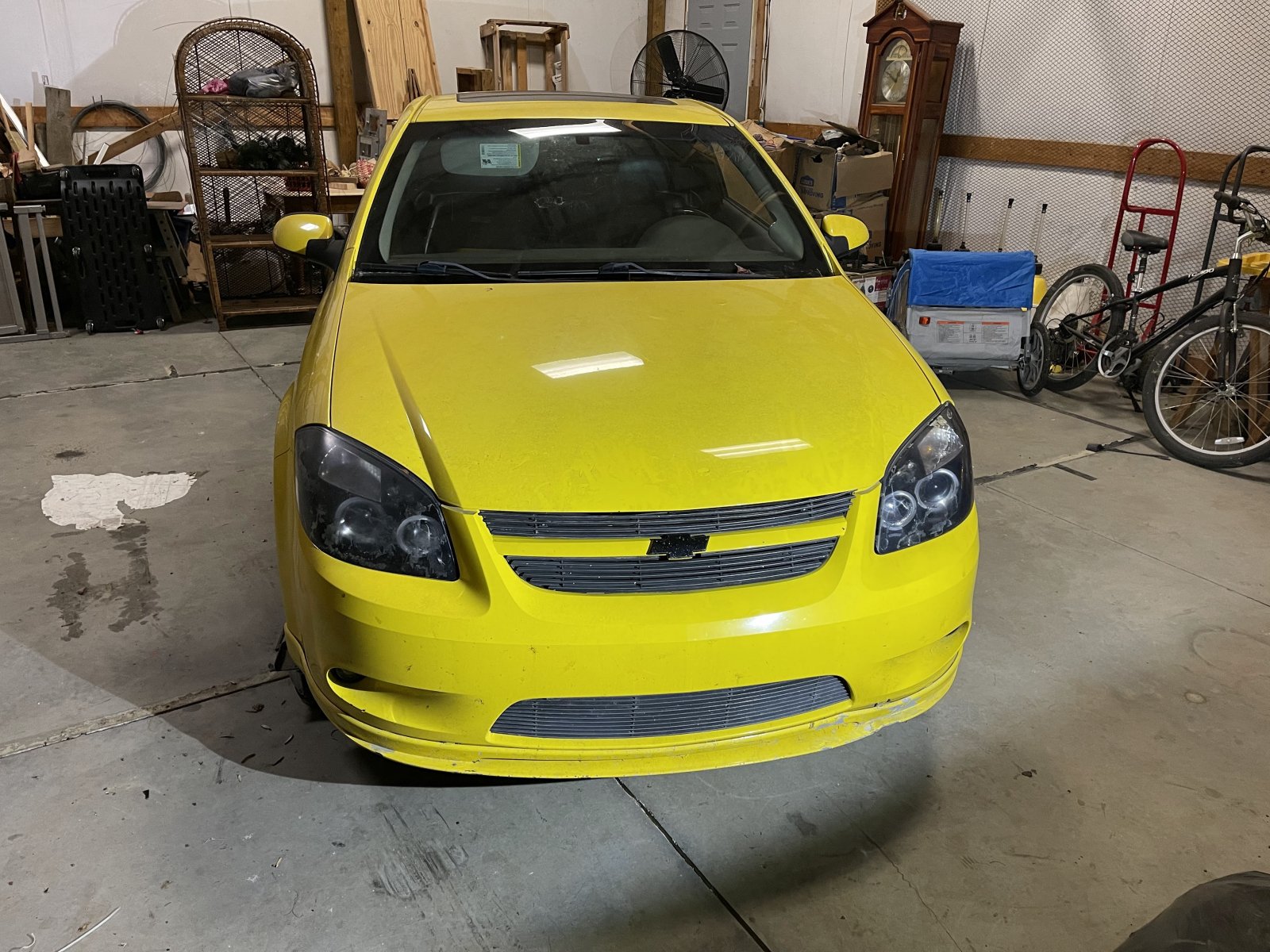

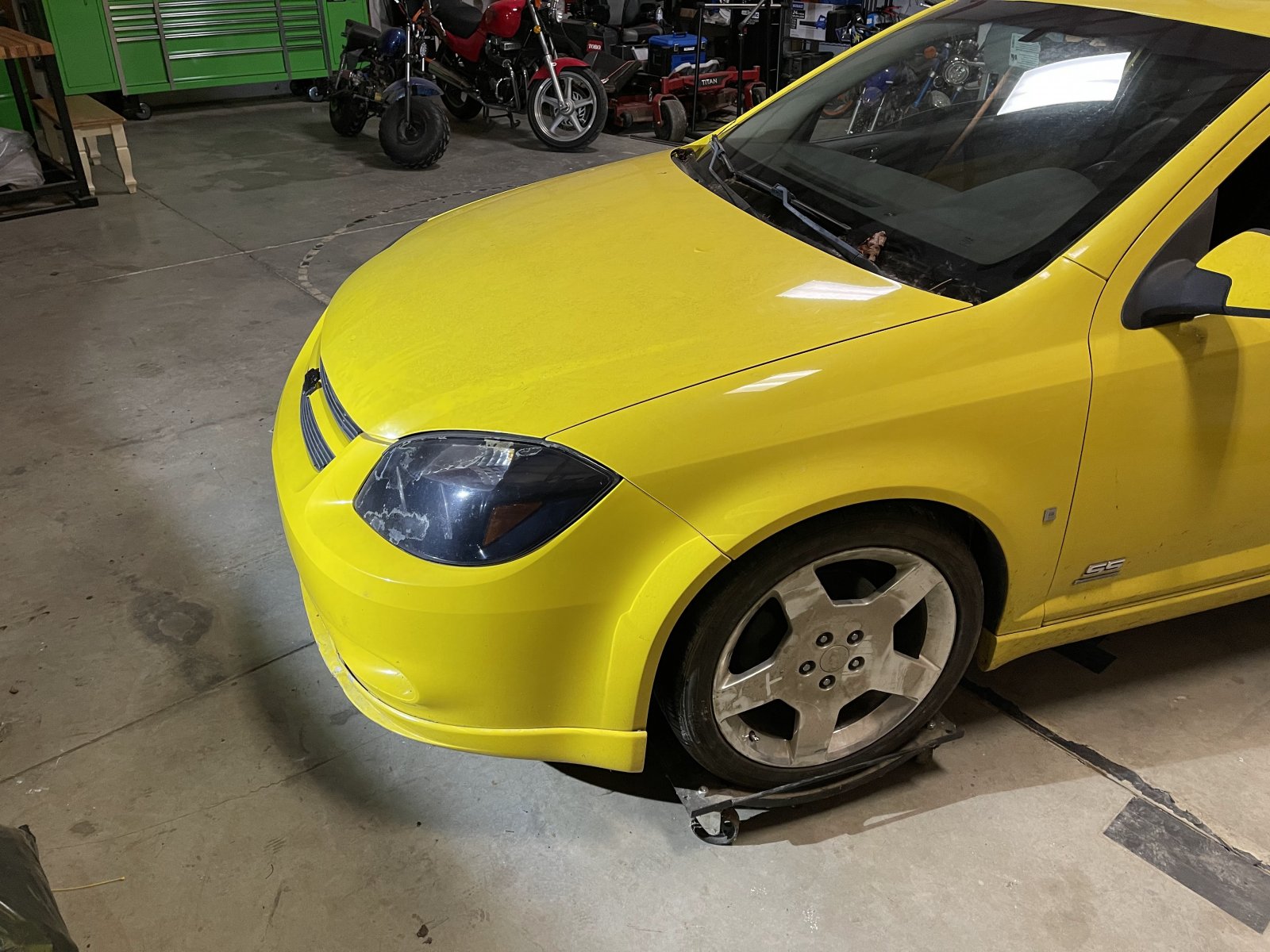

Went to look at a local Cobalt, and bought it. I now had my donor! 2007 Chevy Cobalt SS Supercharged, G85 package. Car has body damage, mostly on the rear. Battery was dead but with some jumper cables it started right up and the engine idled well. The clutch pedal had no resistance, and the previous owner tells me he has bled the slave cylinder but that didn't help. He suspects the slave cylinder needs to be replaced, which is why he hasn't been driving it.
Inspected for as well as I could for the items I cared about, and was satisfied. $1800 cash, a bill of sale, and then I had the title in hand. Got the car on the trailer and headed home. Immediately unloaded into my shop and got the car on my trusty Harbor Freight wheel dollies, and snapped a few photos. She's dirty inside and out, so a good cleanup will be the next task I do. Undecided if I want to investigate the slave cylinder prior to disassembly (if I can fix it, I can at least run it down the road and back for a little shakedown test), or just dive into the disassembly.

Today was my first real day working on the disassembly. I basically made it through the first 2 videos which took me about 75-90 minutes to do. I'm basically committed at this point to leaving the donor where it's at in my shop, up on the QuickJacks, until she's completely tore down. Will use the tractor to get the shell out, but that's probably after the new year.
Before tearing into it, I did (with some help) bleed the clutch slave cylinder, which definitely had air in it. Got it flowing fluid, but the pedal still isn't grabbing. Oh well, not going to let that slow down progress and I'll go over everything once the engine is out (new slave and master cylinders, since I'll already be there; upgraded clutch, hopefully find a LSD to add in, etc).
Already have the hood and front bumper sold for $400, so now I'm only in the donor for $1400. Hoping to see $100 for the fenders, $250 for the doors, and $100 for the spoiler pretty quick. I will probably sell the stock wheels and tires, and maybe the sunroof if I can find a buyer first. Hoping to pay off my donor and have extra cash to put toward new wheels/tires, seats, and steering wheel. Oh, and I'm probably going to make a recining shop couch out of the factory front seats (unless I can sell the seats for decent money). They need to be reupholstered, but I think it would look awesome!

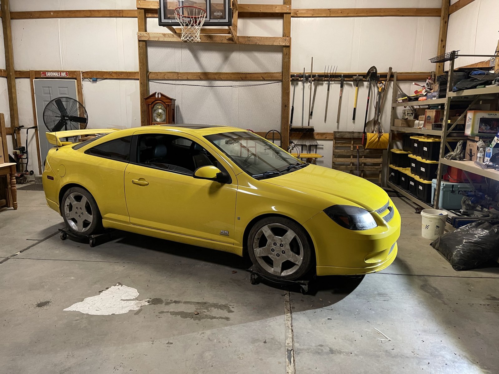

Completed video 8, and got the shell ready to leave the shop. Threw all the things inside the car I don't care about or need, and someone is coming to pick up the shell to get it out of my way. Picked up a sheet of MDF to make a 4x8 table to get ready for wire harness work, but next up will be stripping the dash and taking inventory of all my donor parts (fingers crossed I have everything, or most everything).
Car is off the lift and sitting on a pair of wheel dollies, ready to be pushed to the edge of the shop and winched onto a trailer. Good riddance!

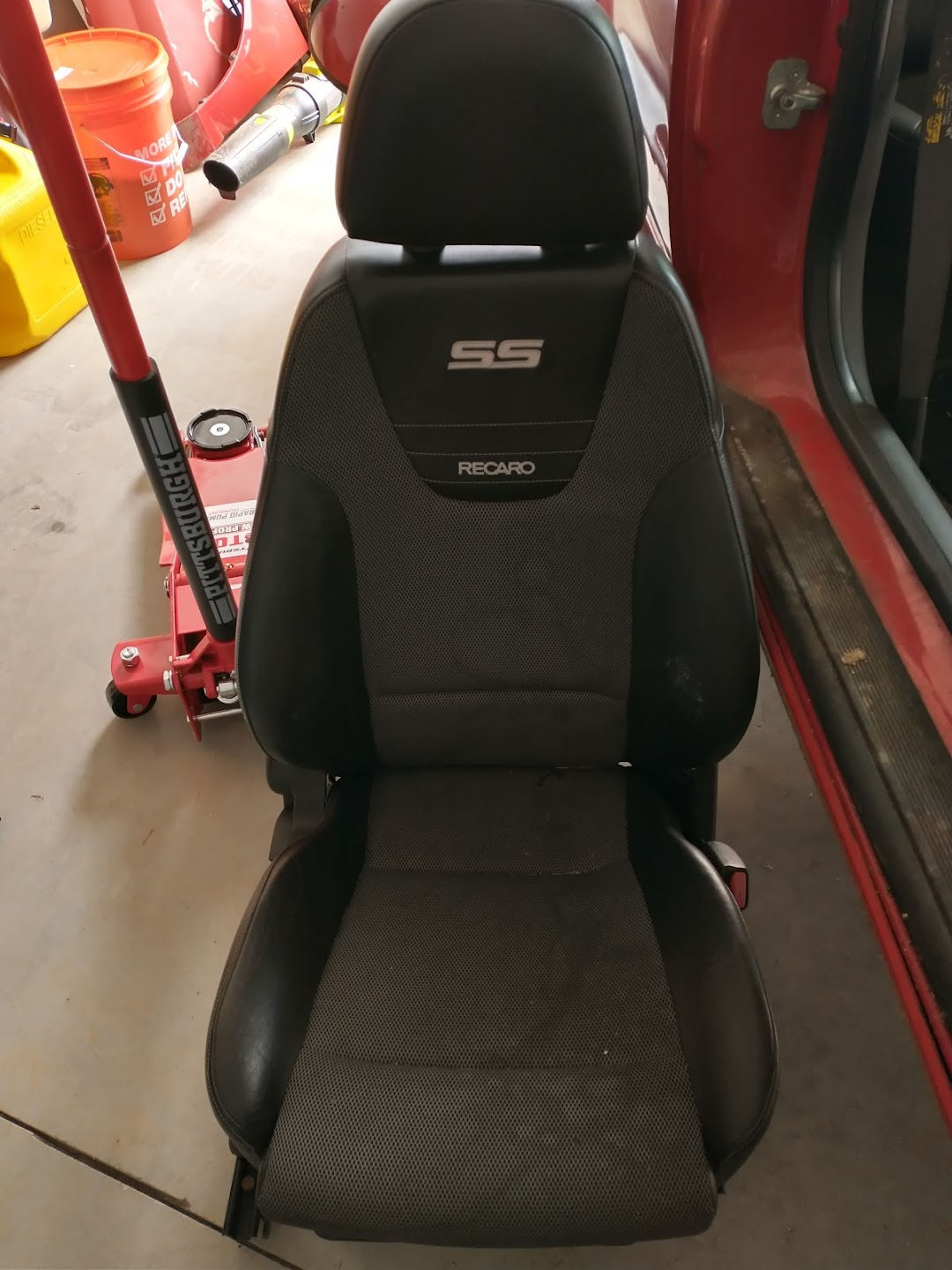

A few quick comments:
To my knowledge, all SS/SC's with the G85 package have Recaro seats and an LSD, unless they've been swapped. It's easy and not uncommon to swap the seats, so make sure you're looking at the RPO codes in the trunk or at the actual tag on the transmission to confirm it's an LSD.
275-300whp might be a little ambitious on a stock M62 supercharger. E85 would definitely help, but also keep in mind you're looking at a ~9 gallon tank and mid 20's on fuel economy on 93, so realistically low 100s in fuel range on E. Sounds like you've got a good handle on things, so I'll be watching your build!
Thanks! Given that the engine doesn't appear to be modded, I'm doubtful that the seats were swapped (they are matching yellow, and pretty worn). I haven't figured out how to confirm if it's LSD, but I'd love to do that. What do you mean by RPO code? Where is the tag on the trans (viewable from top of engine bay, or from underneath)?
275 is definitely ambitious, I know that. I had a TVS 1320 ready to go for my 06 original donor, but never got it together and running. I was aiming for 300 with that setup though. I like to aim high and figure out how to get there, so we'll see. I had not thought about the lower capacity tank in the Goblin, but if I can get ~150 miles on a tank, I'll be fine. Will have to get familiar with all the E85 stations in my area, haha.

If it's really a G85 SS/SC, it'll have an LSD trans and these seats.
Thanks for that. Definitely different seats, plus I checked the RPO tag a little bit ago and confirmed I do not have the LSD. Not the end of the world, though.
