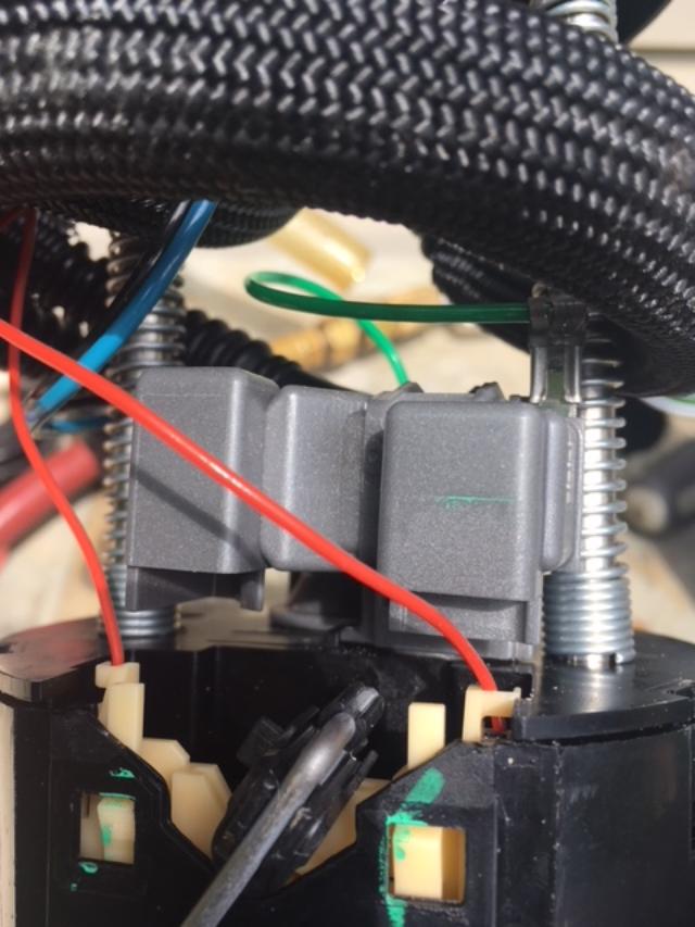

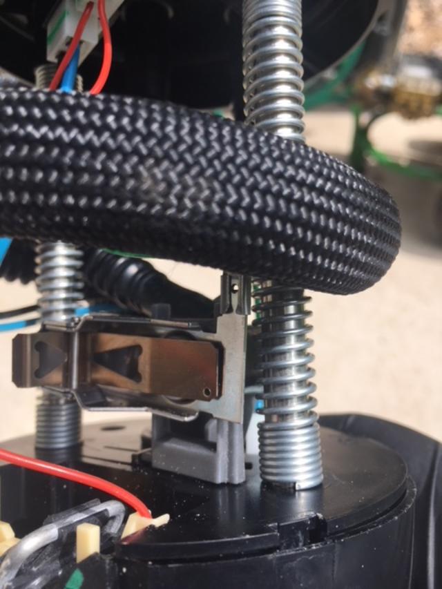

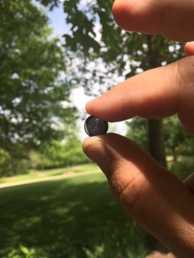

This is what I found inside the fuel pump. The return comes in on this gray plastic housing which holds the original ball and spring regulator (the ball was remove previously to omit the pump regulator). Inside this housing is a small filter screen to filter the fuel returning to the pump. It was 90% clogged! I can only assume this was debris left over from the manufacturing of the new fuel lines, regulator, fittings, etc. I cleaned the screen and put it all back and it's working great again and I'm getting much better tuning results.

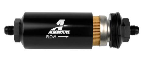

Well, one tank of gas and the filter is clogged again! Not really sure where the debris is coming from. I may have made a mistake and installed a 40 micron fuel filter inline instead of something that would filter smaller particles. I'm looking into using a 10 micron filter now. If that doesn't do it, it has to be coming from the lines or fuel pump.

I'm going to investigate that on my old injectors. I will feel much more comfortable with this new 10 micron filter. I don't know what the OEM filter is, but I could not find anything better than 10 micons.
