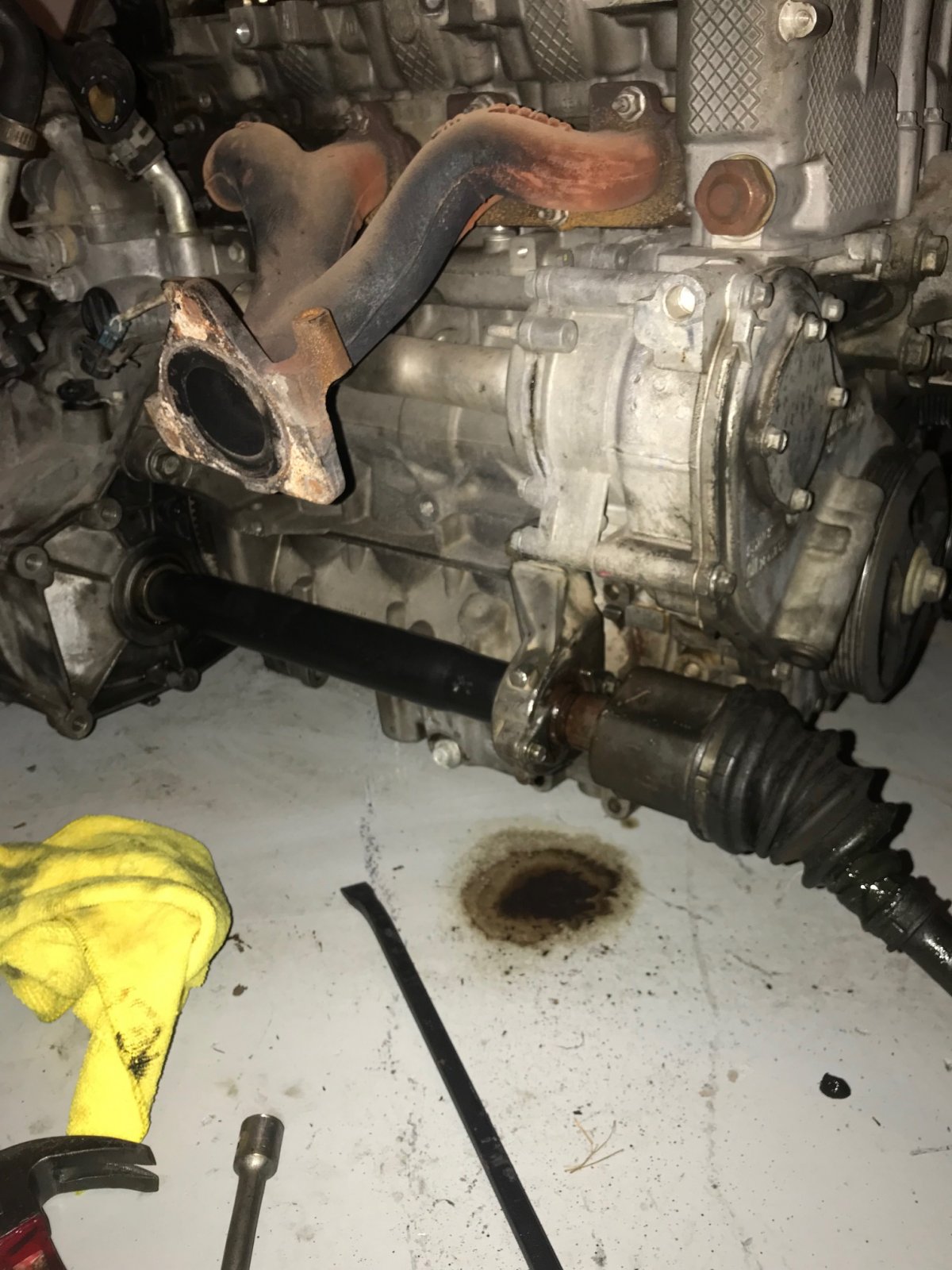

Hey guys! No matter what I have tried, I cannot get the axle off of the intermediate axle that bolts to the block of the engine. I have whacked the CRAPOLA out of it, and still nada. It is frustrating. Have any of you had this same issue? If so, what did you do? I would like to replace the whole axle with a new one, but if I need to I suppose I will just rebuild this one with the intermediate shaft on it. HELP!! Thanks!!

Take the two bolts out of the two keepers. Should come right out. I cleaned our up and replaced the bearing in there.
That retainer is just for the bearing. It doesn’t hold the axle in. I took it off and it was no different. No matter, I will just rebuild the axle in place and call it a day.
I spent about two hours hammering on an axle to get it out of a intermediate shaft. The axle I had to remove was broke so it had to come apart. When I finally got it free I found that it was dry and rusted. That area has no oil being introduced to the splines so over time they rust together.
I would suggest pulling the intermediate shaft from the engine and transmission then stand it up against a wall with the axle pointing up. For several days or weeks spray some penetrating oil into where the splines go into the intermediate shaft and let it soak while you tackle other parts of the donor.
After I got it to move a little I had to spray some more penetrating oil on the splines and hammer it back together. Each time it would move a little farther as it work the oil in.
Ah yes! You are right, that only holds the bearing. I do remember it being dry and rusty, but ours was not stuck that I remember. It seems much like the steering shaft where it too gets stuck over time.
I used reasonable amount of heat on the steering shaft after soaking it with penetrating oil. This was is hope to get it to expand some. You don't want it cherry red with the oil. Does make for a stinky mess when heating it.

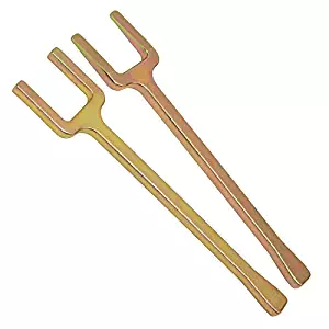

It may be worth going finding something like this (advance auto parts may rent it)....I have pretty long pry bars from harbor freight that I likely used. if you could put something like the picture, or even two regular pry bars on one side then put some type of wood on the other side of the pry bar you might get enough leverage to slide it out. If you could somehow use two (one at top and bottom) that would likely help with sliding it out.

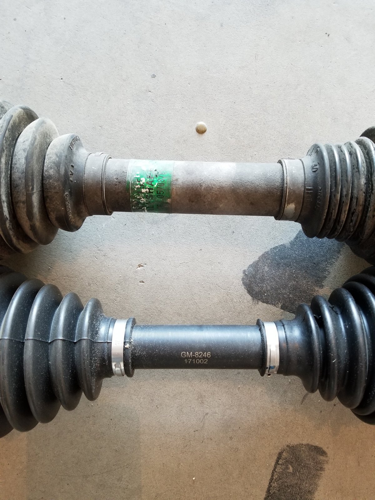

Photo comparison. The top axle is the turbo axle, it is approx. 1 5/16 inches in diameter. The bottom is the Sport/supercharged axle, it is approx. 1 1/16 inches in diameter. You are correct the SC axles are stout, but when you put the 2 next to each other the size difference becomes pretty obvious.
Every place I have tried, who 'confirms' they are selling the Sport/SC axles as turbo axles - nope. If I eventually find some place that still has the turbo axles I will post for everyone. But in the meantime, I have to get my original axles separated.
