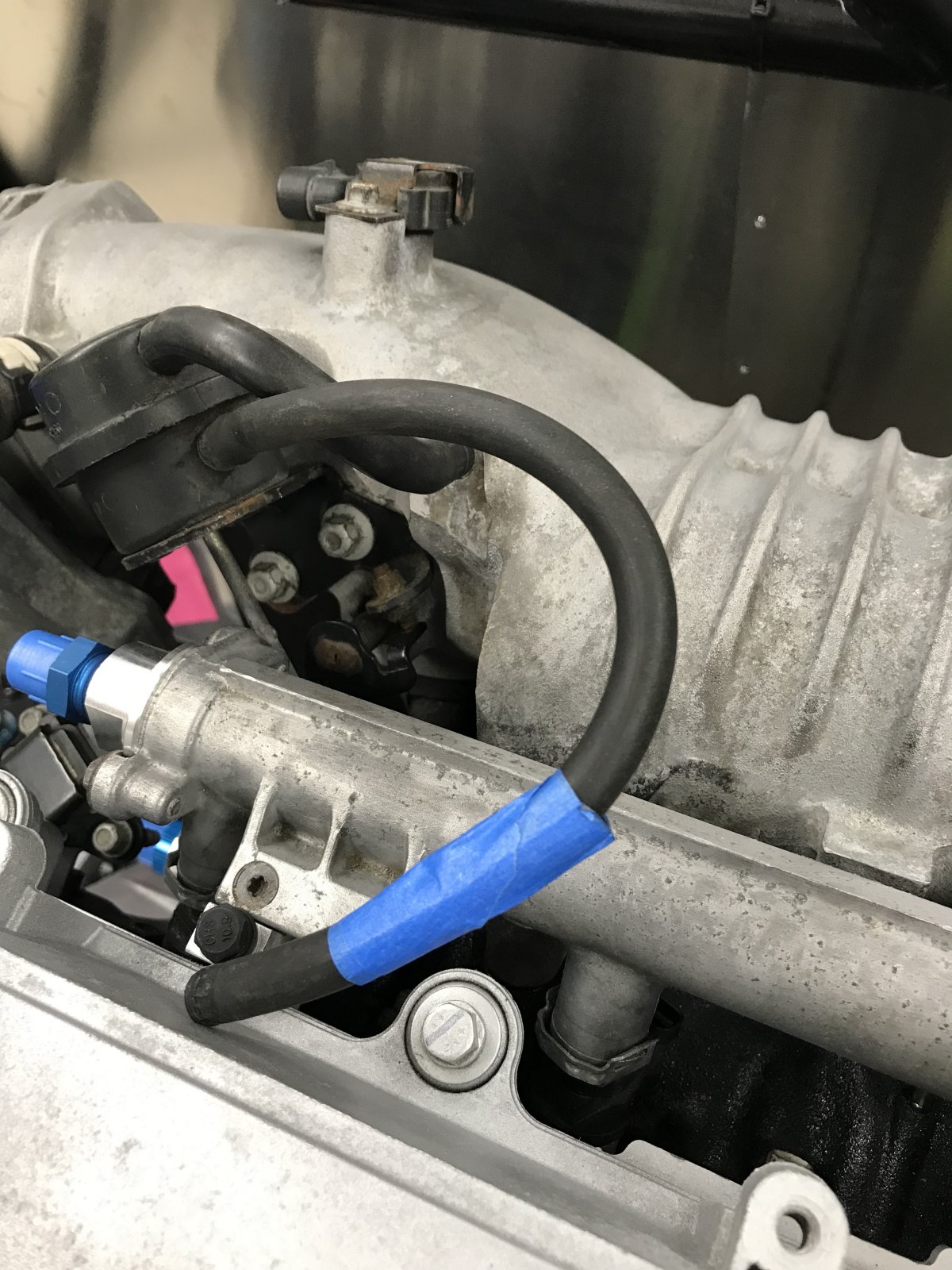

Awesome, thanks!! Another quick question...I’m not running any of the EVAP on my engine (using stand alone engine wiring harness)...know where the bottom vacuum hose on the SC By Pass would be connected to? I would assume off the intake?

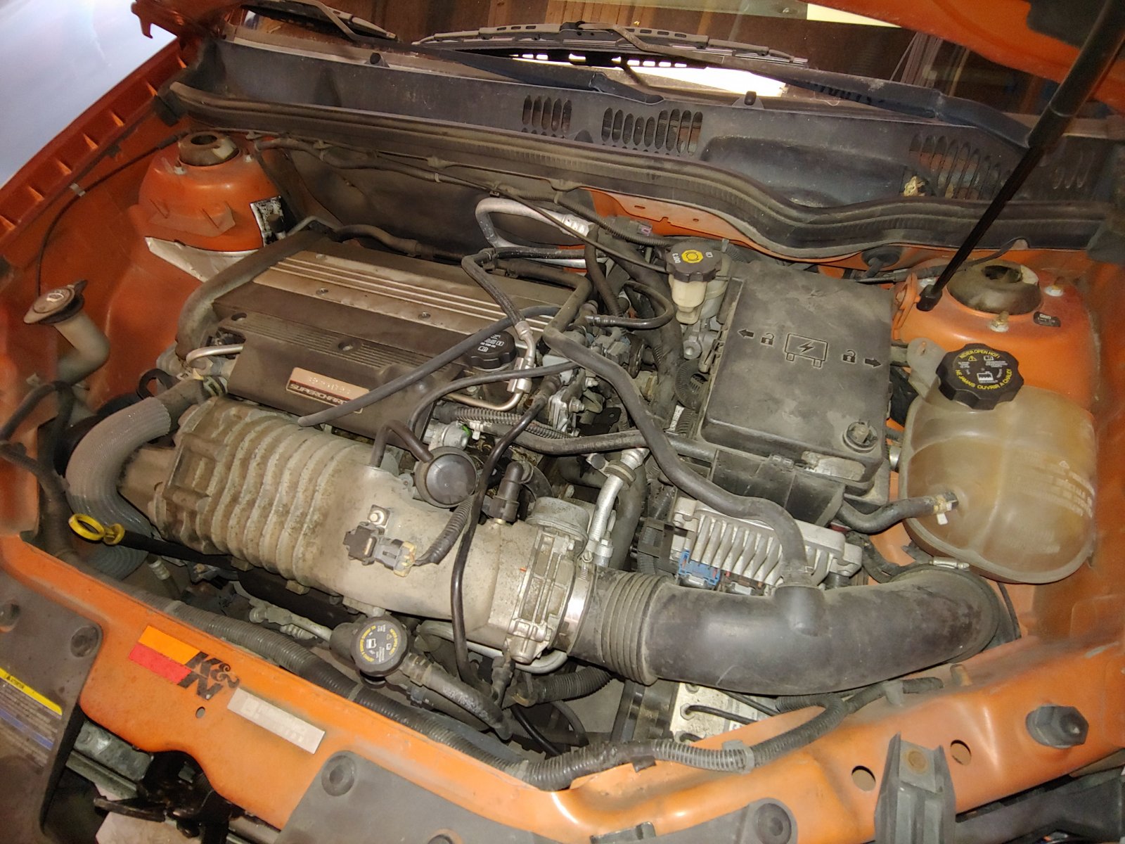

here's what the stock Cobalt setup was for me:
10148
If I'm understanding the parts correctly, the evap solenoid is mounted on a bracket with the boost controller solenoid just to the driver's side (names are probably slightly off). In this image you can see the route the line you're asking about runs to the boost controller. The evap system has a harder vinyl or plastic line that runs to the front side of the supercharger. Not sure what happens if you remove the boost controller but I'm starting with just the evap solenoid gone.
Thanks!!View attachment 10142
It goes to the little boost controller electrical module thinga-ma-jiggy, to the driver's side of the valve cover. It was next to the evap stuff. You still need that to control the boost.

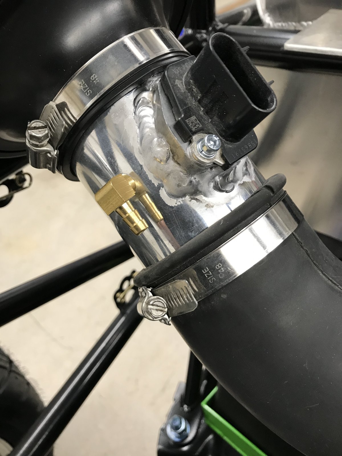

The MAF sensor needs laminar airflow, so reducing the rubber to aluminum overlap will allow a longer intake, and help.
The intake is near the limit of being too short.
Also those hose clamps need to be tighter than I thought, as mine failed the intake leak smoke test.
Easy fix, but it didn't idle right until i fixed it.

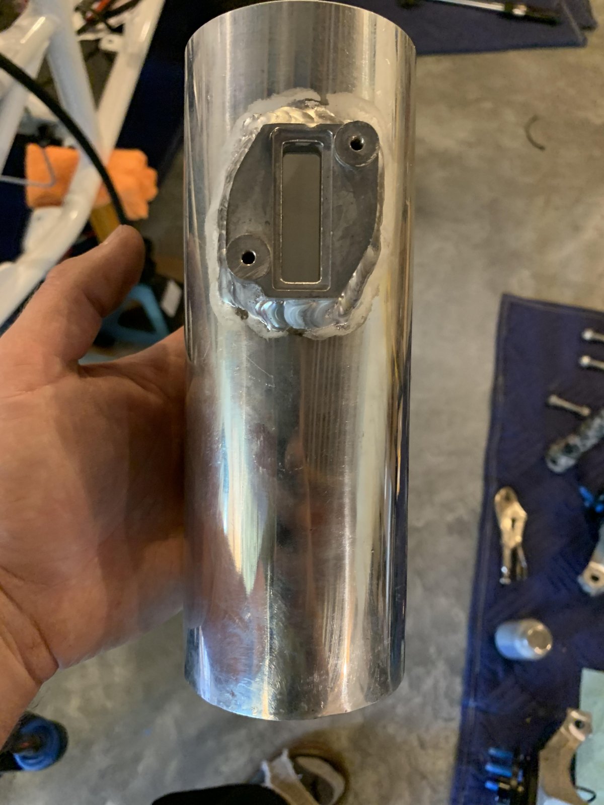

Hey all, my intake pipe doesn't have a bung for the connection to the valve cover. Do i need to drill? Sidewall seems thin for that to be stable. The charge pipe has more of a bung.

I ordered a drill and tap to add the port, but then decided to do what most do and exclude crank case breather line all together and install a breather filter on the valve cover.
It really cleans up the rear of the valve cover visually and I saw no adverse performance.
Will probably swap out the filter every season, but when I had the valve cover baffles out the two before the breather were pretty clean.

I would suggest you keep the port and connect it to the intake. The line is part of the vacuum system designed to keep vacuum in the valve cover. A filter will vent, but will not help with the vacuum.
Many have indeed deleted it - maybe without major negative effects. If you have a turbo, the vacuum problem in the valve cover gets more complex.

My kit included the pipe without the port as well. DF replaced it free of charge.
