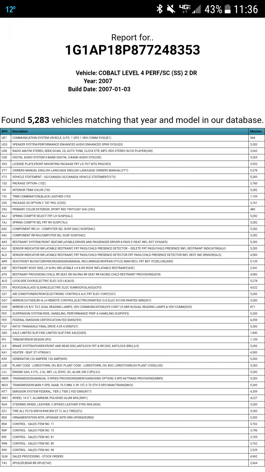

I did a 5 for $5 at compnine.com. I have four left if anybody is interested. Post your VIN, and I'll post your build sheet.
or as another web site posted:the MM5 RPO is for manual 5-spd equipment, like pedals,master cyl., slave cyl. etc.
MM5
Merchandised Transmission - Manual 5 Speed Provisions
MU3
Transmission - Manual 5 Speed, Saab, 76.5 MM, 3.38 1st, 0.70 5th
