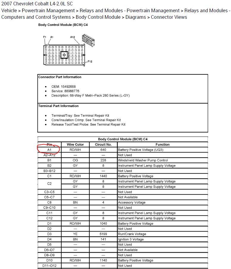

Thinking about electrical hookups... where is the best place to get power for a Bluetooth speaker setup? Can pin A1 be used on the BCM C4 or is that used for something else? I have that wire labeled extra power... ... or should I use one of the other pins labeled "Ignition 1 Voltage"?
14796
I'd use a volt meter and test C4. If it's hot while the ignition is on, but not otherwise, it would be perfect.
I'm planning on adding a small aftermarket amp that includes Bluetooth connectivity, and a nice pair (or pairs) of speakers, later on, once my wife's ire at the Goblin's expense has simmered down. To power that, I am planning to run my own fused power wire, with a relay on it that's triggered by an ignition-toggled 12v wire actually scratch the relay, I forgot that amp is a 12v remote lead input. This one: https://www.amazon.com/gp/product/B00UTXQL74/ref=ox_sc_saved_title_4?smid=A1GIKH3L785S8V&psc=1
