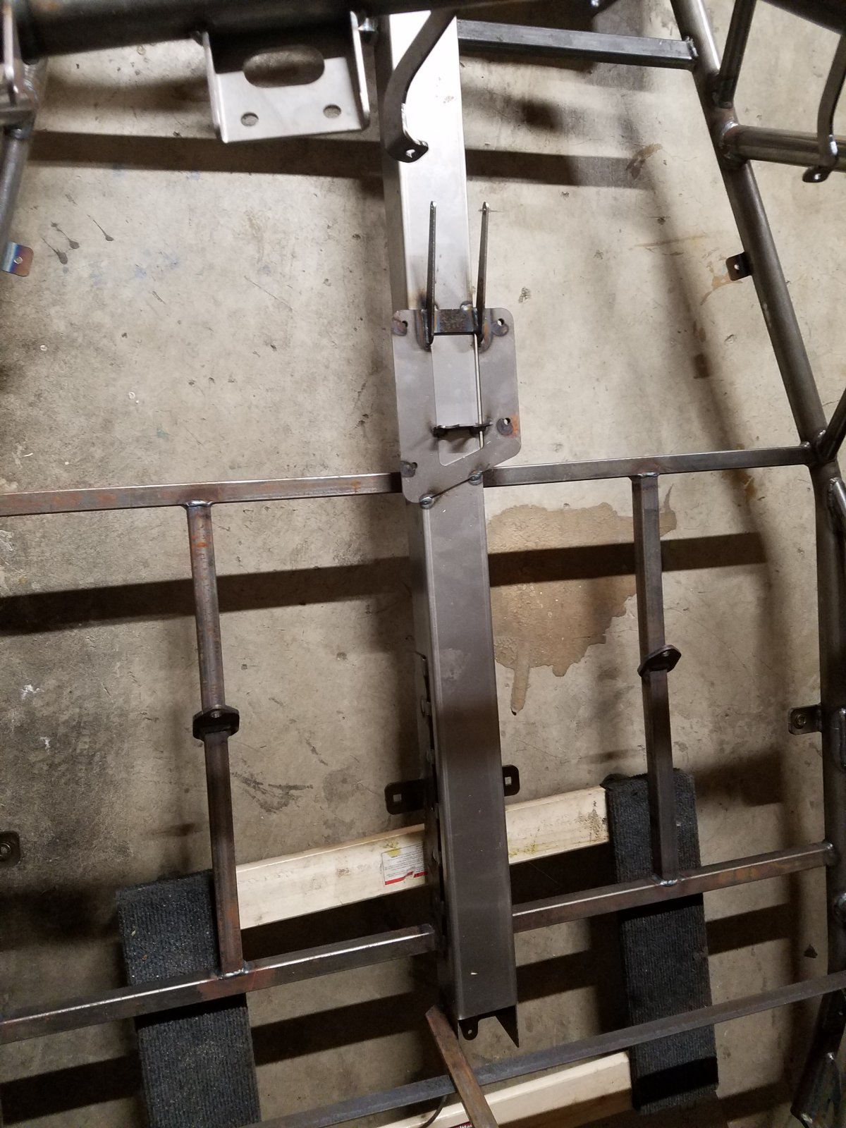

I did not keep the EVAP canister, and I had my parts and frame coated by Superior Powder Coating in Arlington [360-386-7150]. $80 for the sheetmetal and some donor parts and $350 for the frame, subframe, control arms, and tunnel cover.
When you are referring to tunnel cover are you referring to the middle portion that travels the length of the vehicle in the photo attached?
