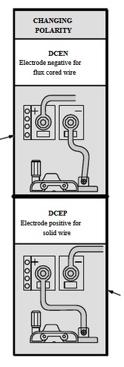

I picked up my Hobart 210 2nd hand and it welded like crap. The previous owner had the polarity reversed. Now if the welds are bad it's my fault.
CaptFrank2001
This is for the Hobart 210.

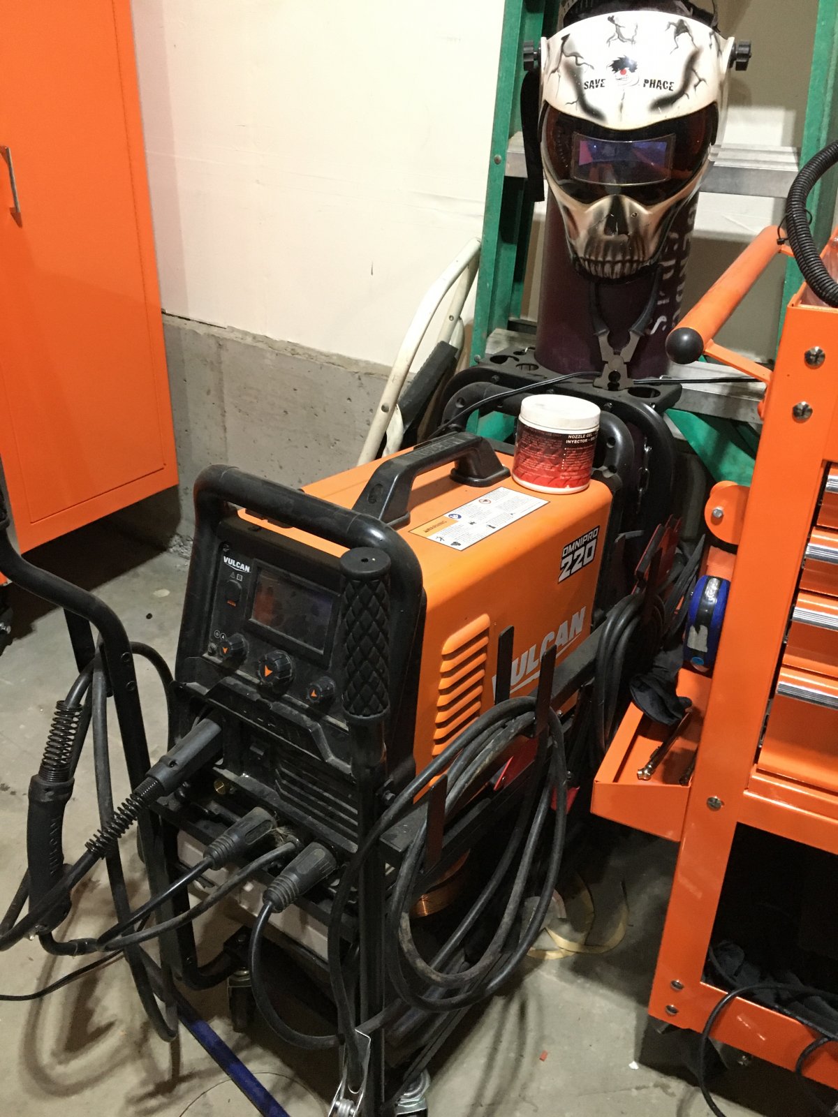

If you want one welder to do it all Including AC TIG and you can afford it go with an ESAB Rebel EMP 205 ic. If you want something cheap that’ll throw down go grab a Vulcan Omni Pro from Harbor Freight. I picked this one up from a buddy of mine for $700 cuz I needed a welder to weld some 3/8” plate. I’ve been welding over 15 years and this is a great MIG machine. Just set what shielding gas, wire thickness, and material thickness your working with and go to town.
Make sure you buy a good welding helmet. I use a Save Phace Gen X and can’t say enough good things about it. They fit a lot tighter around your face than most and have a HUGE viewing area to make it easy to see where you’re going.
I also prefer to wear a pair of TIG gloves over MIG gloves unless I’m burning in 1/4” or better. As a beginner you might find that helpful since TIG gloves aren’t as bulky. They will give you a much better feel for the torch.
You’ll always find a tub of nozzle gel on my machines too. It’s a cheap way to increase your consumable life.
