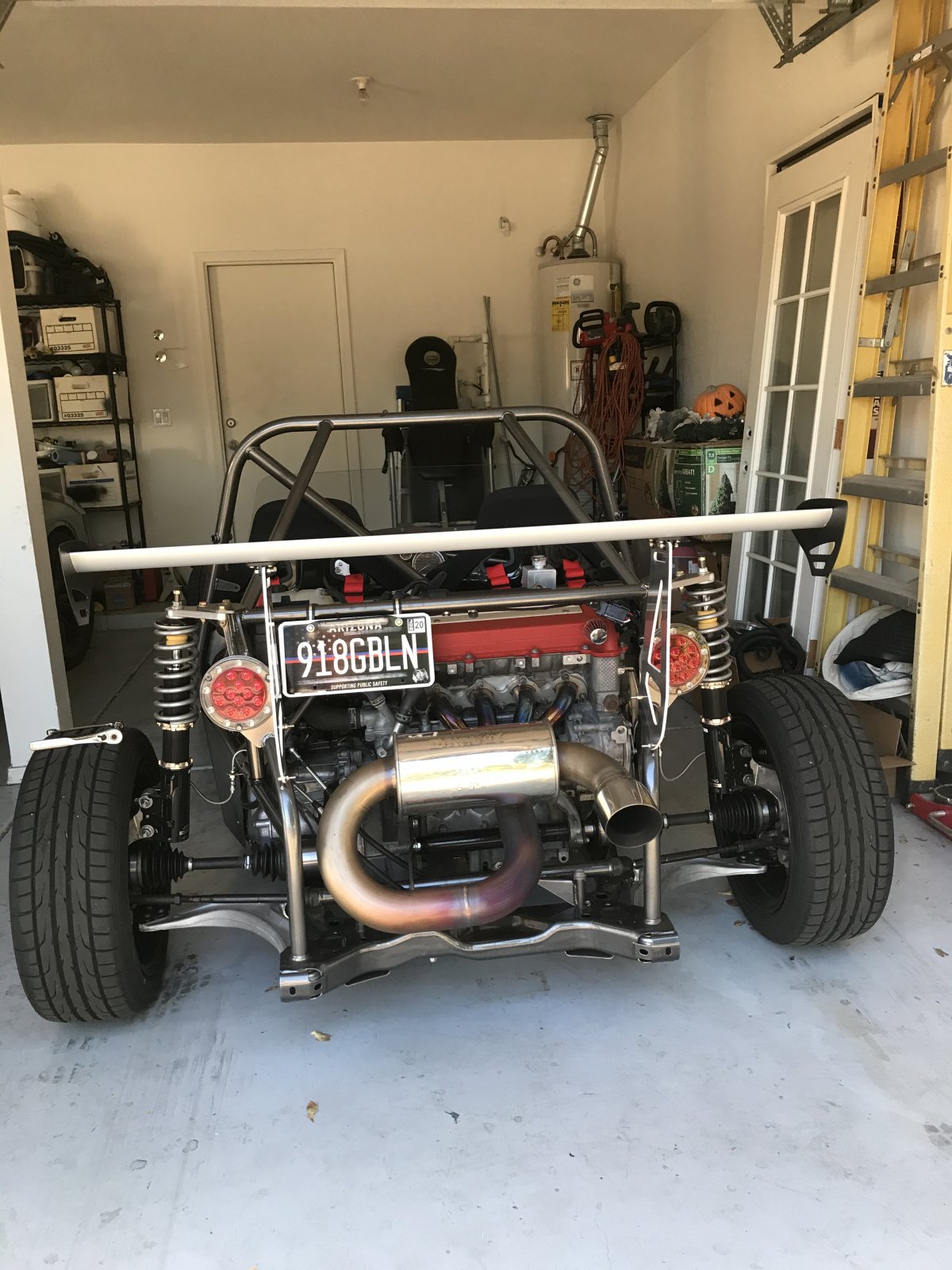

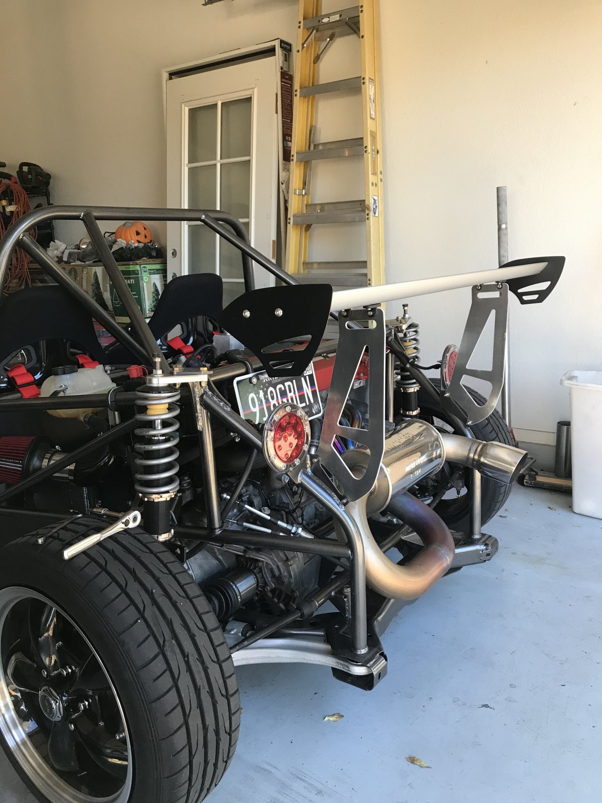

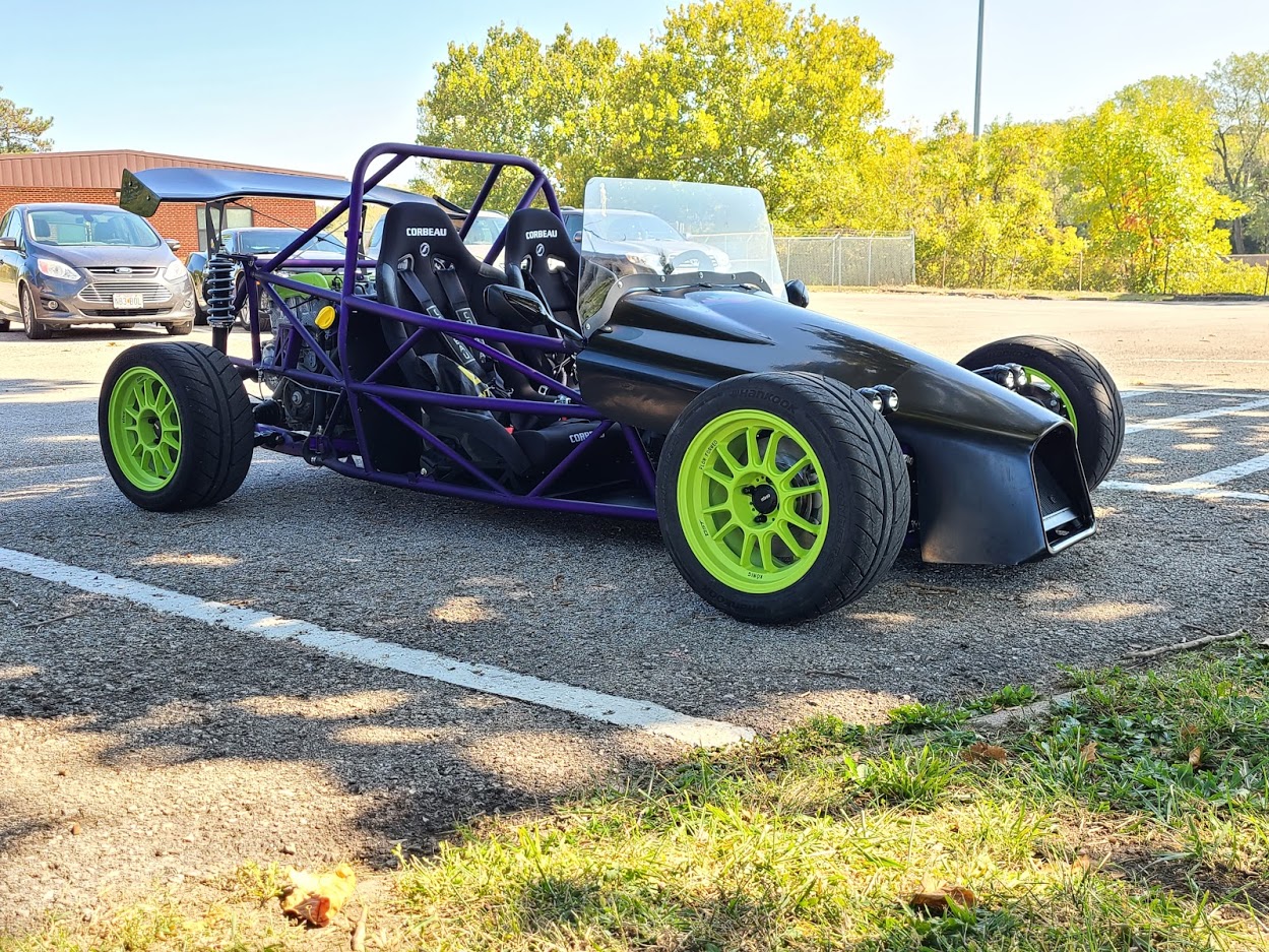

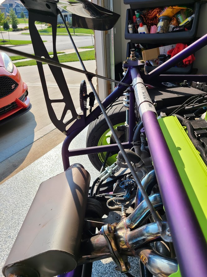

I bought an inexpensive extruded aluminum spoiler, and then custom designed some brackets and had them cut from 3/16" aluminum plate. I like the look.

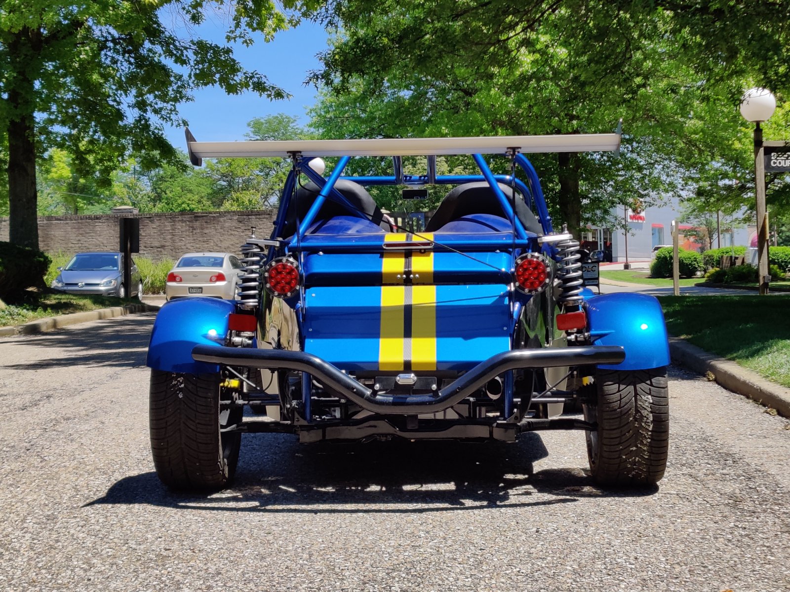

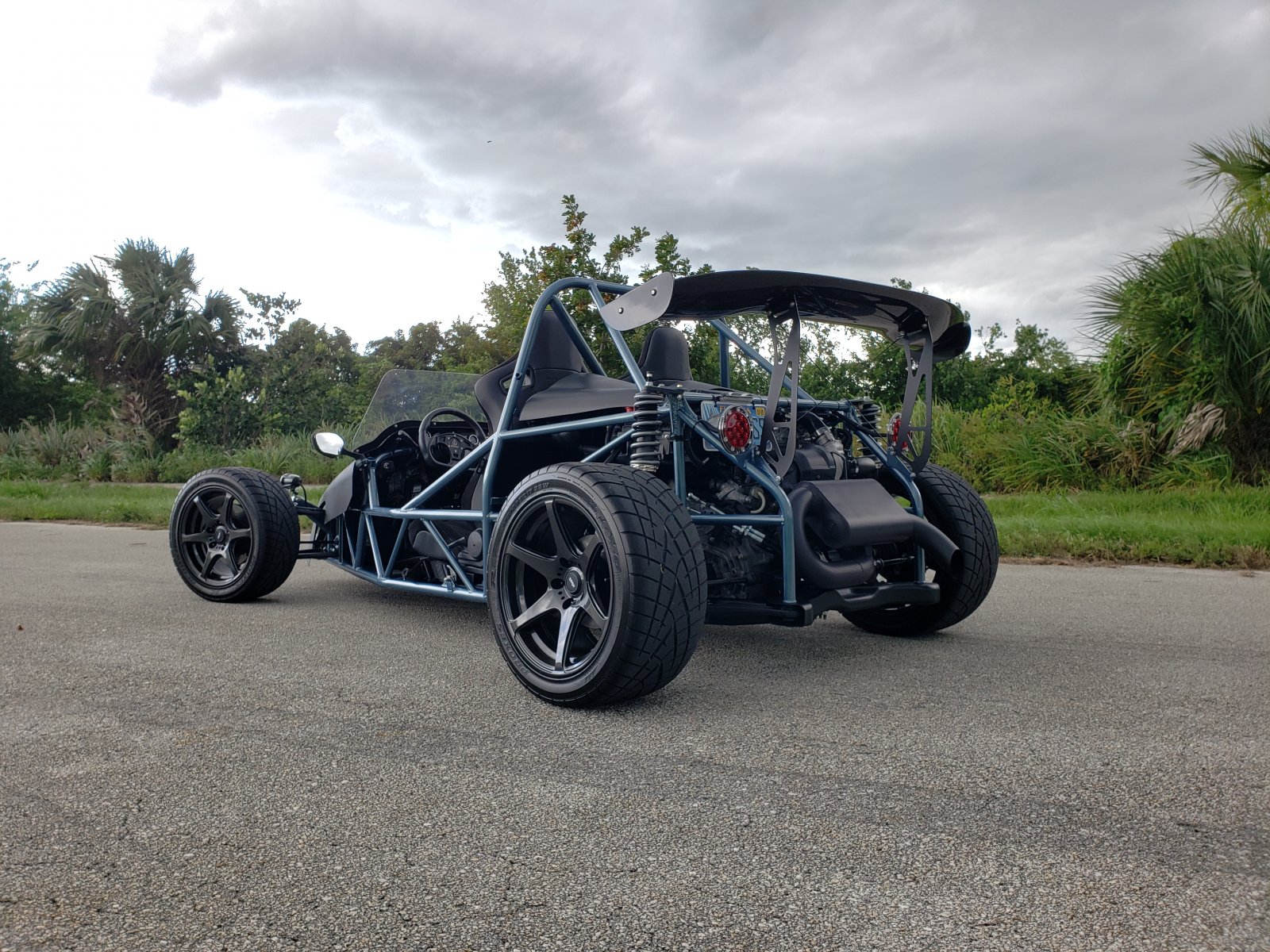

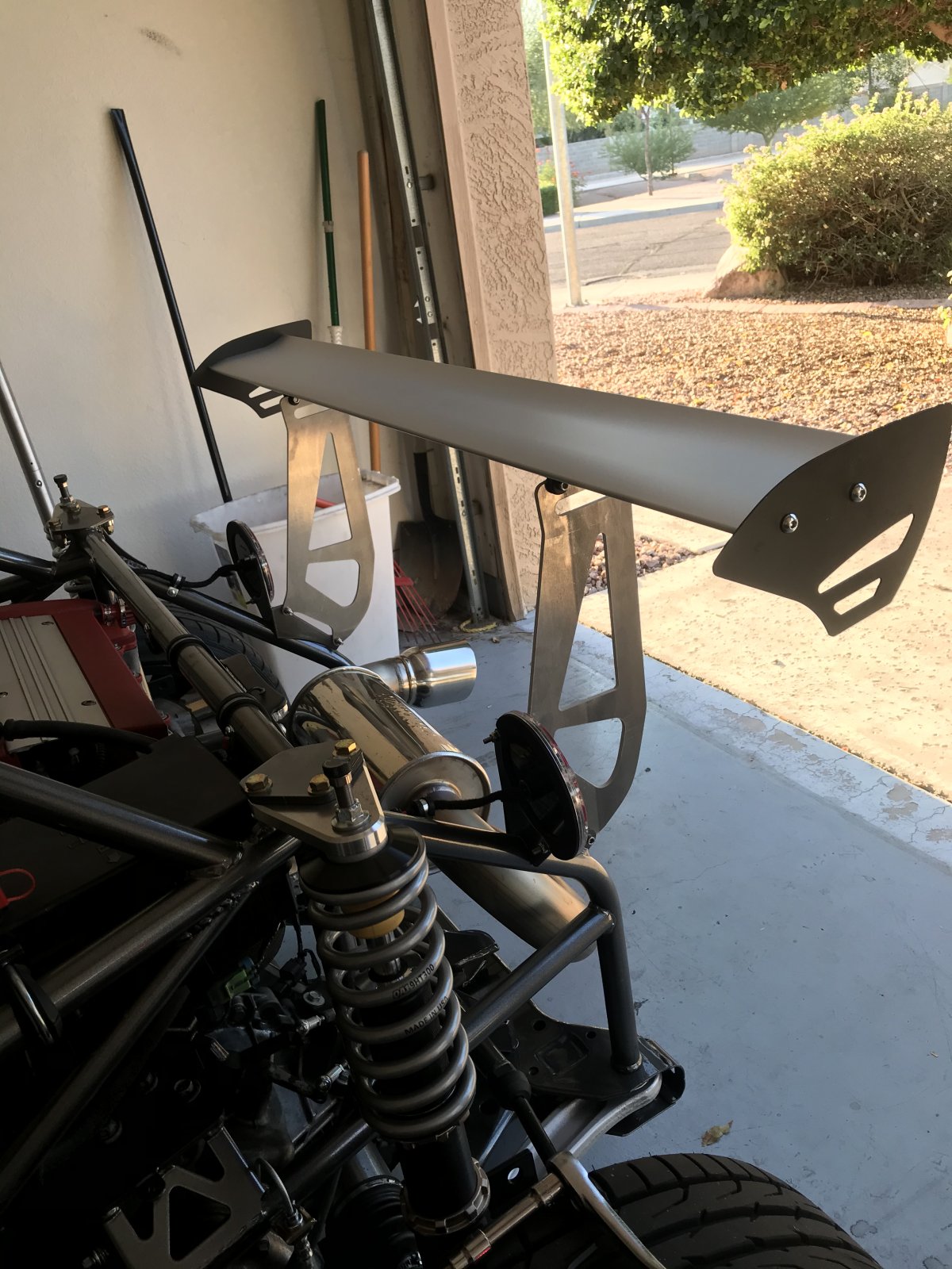

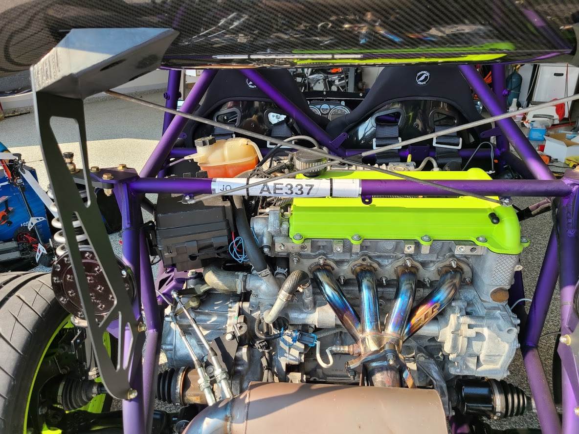

I found a local almost brand new Seibon wing from a BRZ for a good price after the universal one started having a large delay. I though the mounting holes where the same but they where not so I had to end up making custom brackets. Was more work but in the end it turned out good.

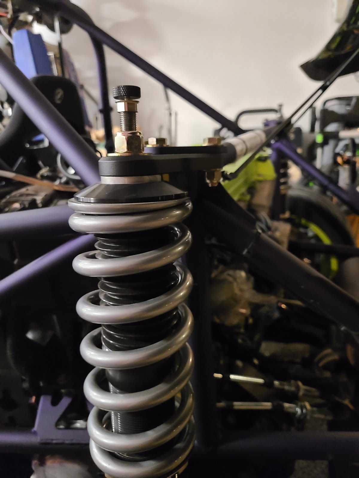

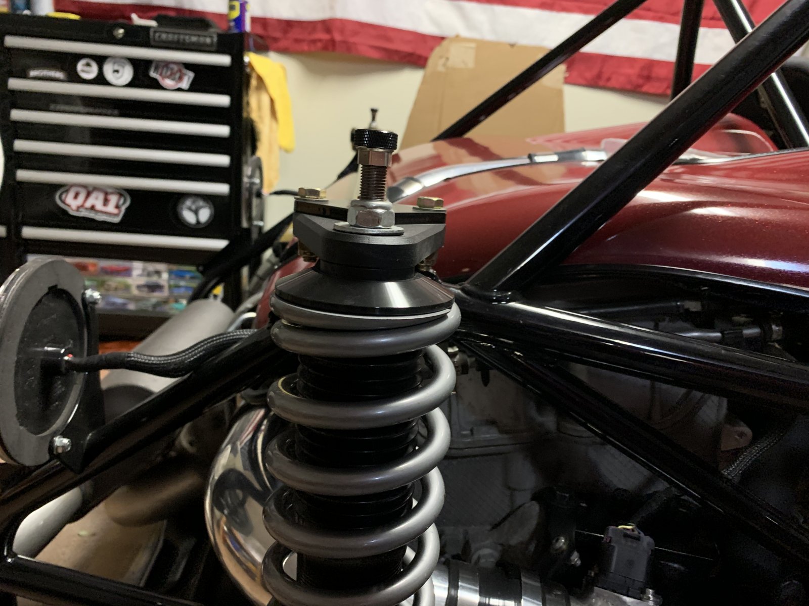

You may want to inspect the rear coil overs to make sure they are seated all the way to the shoulder on the rod on the top connection.
