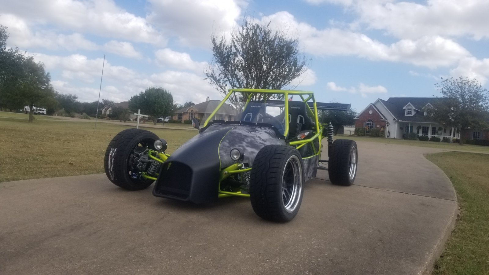

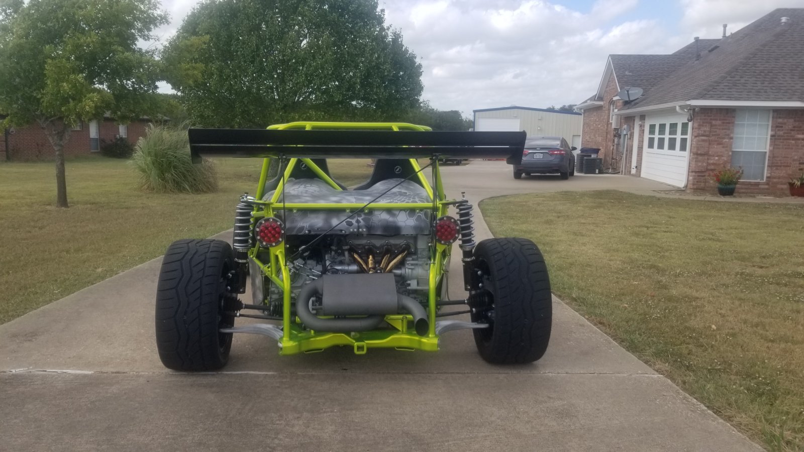

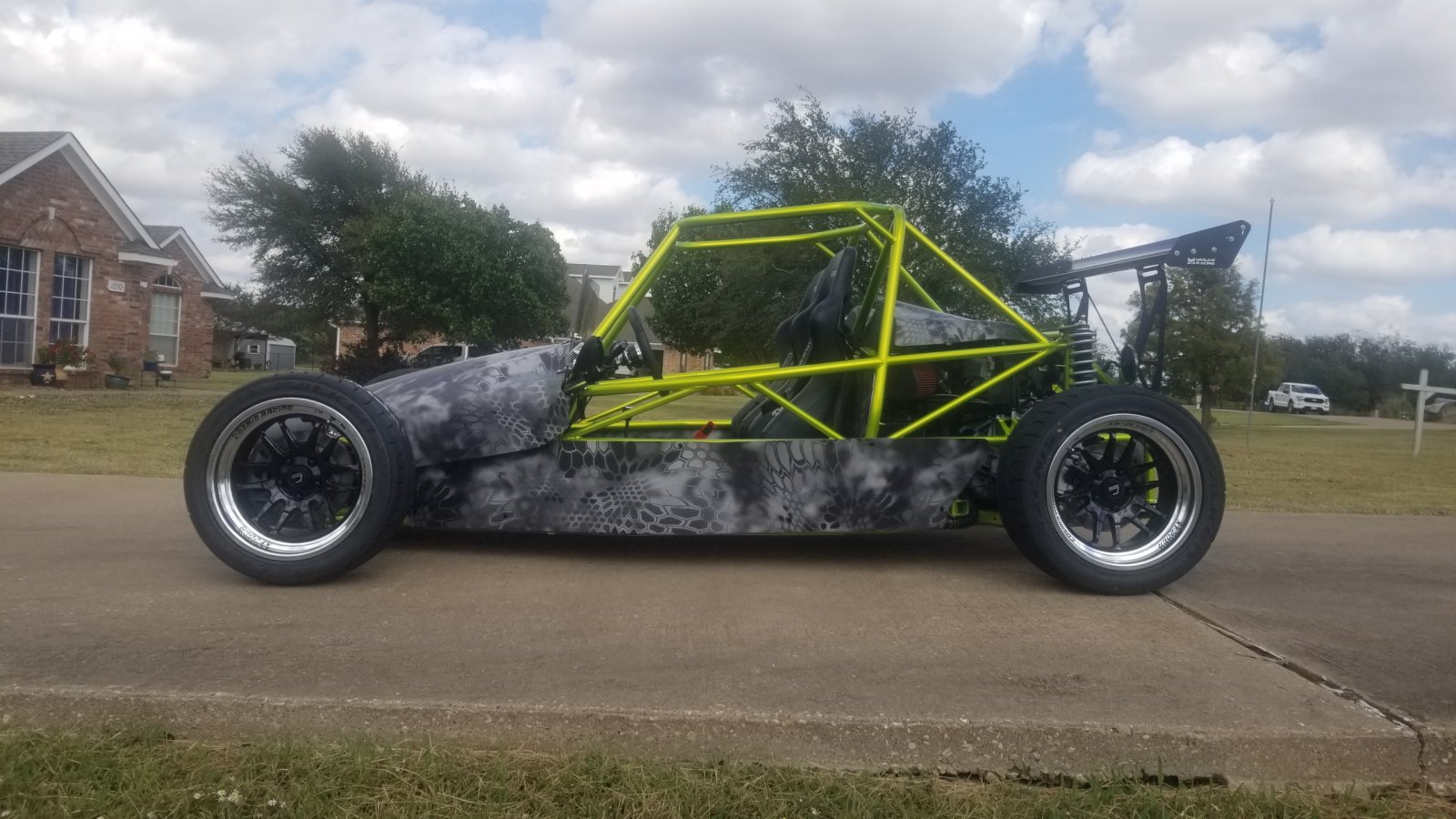

So I had mine out today running around town doing a shake down run and decided to stop and weigh it. With about a 1/3 tank of fuel and no one in the car
1,560 pounds!
So here are the details
Extended track chassis
Full body kit
2.4 supercharged
Manual trans
Aluminum rear wing
Cosmos 17x9.5 wheels
Corbeau seats

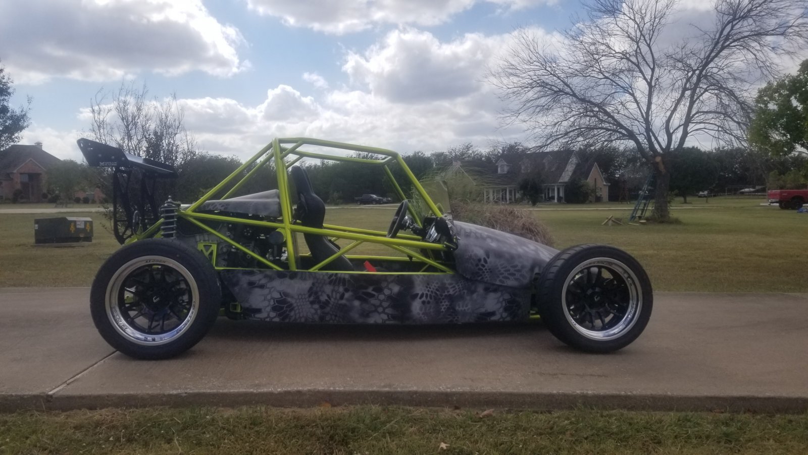

Mine was 1460 lbs with a half tank of fuel.
Standard length track frame
Aluminum side panels are the only bodywork
NA 2.2L (Gen. 2 L61) and 4T45e automatic
15x7.5 König Hypergram wheels
Maxxis Victra VR-1 205/50R15 tires
Kirkey 47 series road race seats
I'll have to scale it again after I add the rest of the bodywork/aero.
