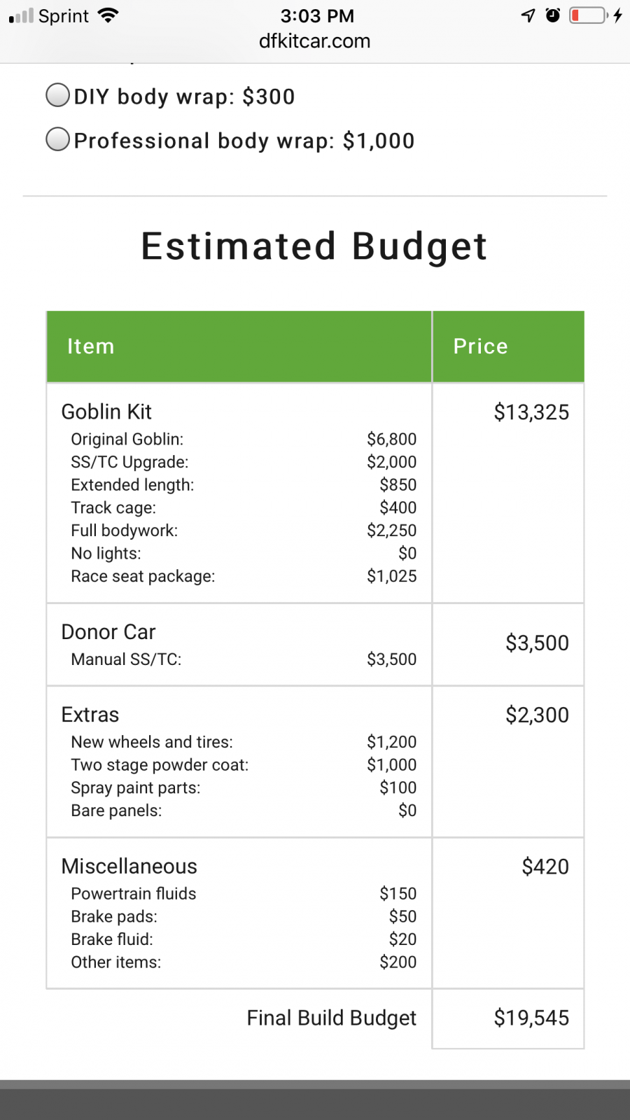

I used the budget estimator and choosing a SS/SC, extended, track frame it's coming up at about $14,900. I'm sure the price varies from that, but by how much? What did you guys pay for shipping/ frame coating? How much extra work/ modifying is needed, vs personal preference? I'd be going fairly stock, using as many parts as possible from a donor. Donors cars shouldn't be too hard to find since there's 2 coparts fairly close to me.

I'm expecting to be no more than $10k into mine. I've been lucky/smart/stingy/patient in a few aspects, and I'm building a 2.2 automatic...
As far as how I picked the Goblin, it is really low on superfluous junk like bodywork, and it's cheap. I was comparing notes with an Exocet owner the other day and it really seems I got a higher quality product and paid about 30-40% less for the privilege.
I will have probably a little over $30k in mine. Don't let that number scare you. I have about $5k worth of custom work and aftermarket parts, and I paid about $3k more for my donor than I should have.
For an SC/TC build, I would say that $20-$25k is about average.
And depends upon how many used parts get replaced (axle hub bearings, seals, etc.) and/or new parts being purchased (engine, transmission, etc.). The nice thing is you can make the car your own and go from basic (and still have a really nice and quick car) up to full custom everything.

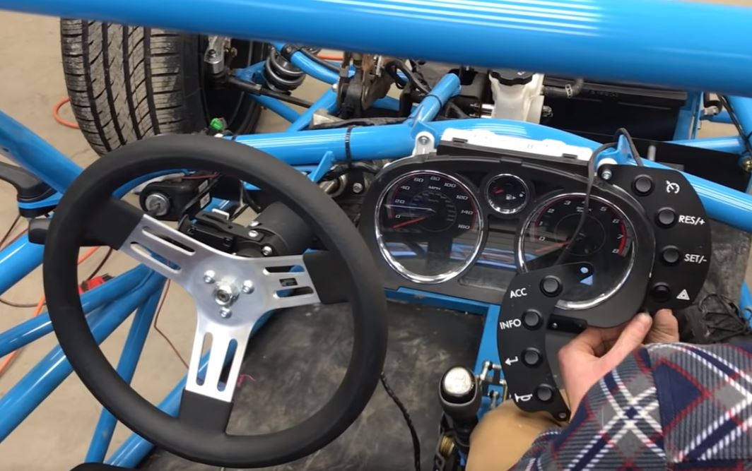

You'll have the option to upgrade the stainless brake hoses $165, rear BC coils/mounts $698 naca ducts $225 button cluster $175, mirrors $75, lights $200,wing and brackets?, parking brakes $250, bumpers$200, hard mounts for front and back of SSTC$125
I'm pretty much right on budget after buying my own seats and brackets for 950.00 some new 17" rims for 575.00 and a cheap turbo donor for 1600.00.
What button clusters are you talking about? I was looking for something other than the gauges on the cobalt.
Gsd autos mn
DF has a set for you they are $175.00
Wiring the buttons requires some specific transistors and I believe a seat plug. You can do your own if you want. The ones they make are extra options after purchase.
You still use the odometer cluster these are just the buttons and mounts im referring to.

I saw those and want those so bad. Im barely getting a donor so i can strip it then order the 1st and second stage. I saw that other gauge lcd panel that looks nice too, just costs about 1200 for it.
