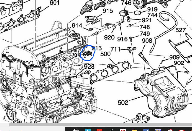

Hard to tell. Closest thing I can see on the Alldatadiy diagrams would be the Barometric Sensor. #711 (assuming you got this diagram from alldatadiy) would be the Map Sensor.
it dubs also as the barometric pressure sensor. On ”key on” it detects barometric pressure, then when started, it’s you MAP, which is also a boost sensor.

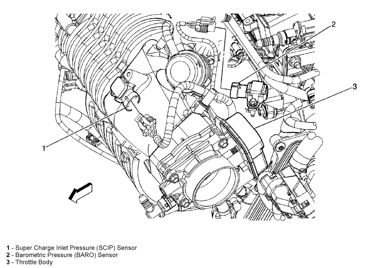

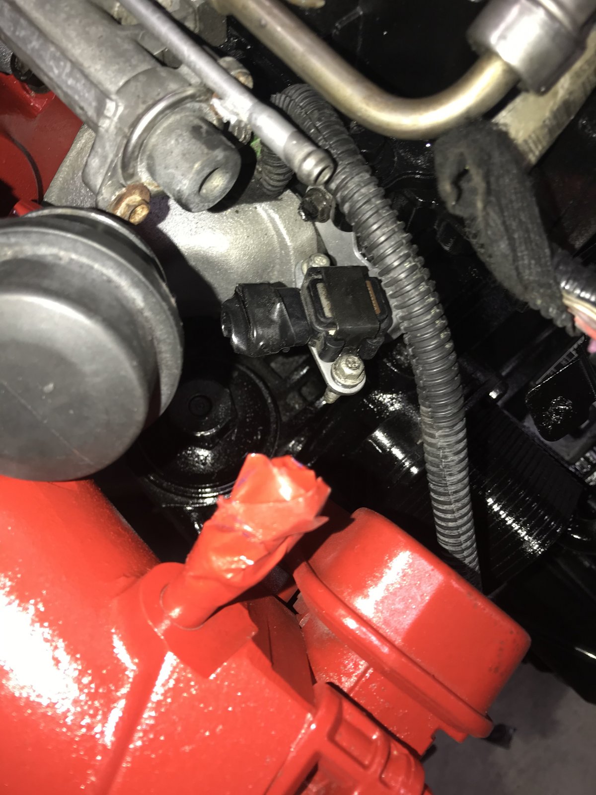

This has me terribly confused. My #2 MAP was never connected to anything hose-wise and is the baro sensor. This is the exact same sensor (make/model) as #1 in your photo, which should be the supercharger inlet sensor.

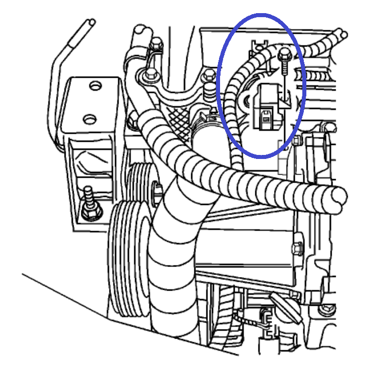

The TMAP (blue circle) is where the IAT2 temps come from, which I don't understand the thought process of the placement of the sensor because it's so high and out of the flow of air and stuck up in a corner. I think it tends to measure stagnant air that is heat-soaked from the placement.
