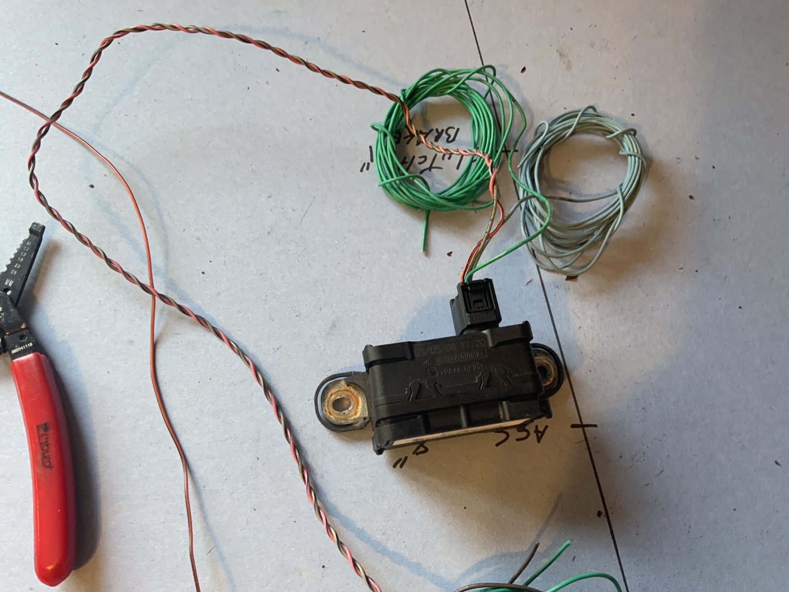

Anyone know what this is and if I cut it out. It from it has twisted pink and grey wires that run the the main dash harness connector

Usually anything that had twisted pair were date wires of some sort. The airbag system had a lot of twisted wires but most of the connectors were yellow. I believe this must has something to do with OnStar, it also has twisted wires. The only twisted wires you will keep are the tan and tan/black wires.

I think that is the Yaw sensor if it was under the passenger front seat and near the airbag computer on the center hump behind the shifter. You do mot keep it for the Goblin.
