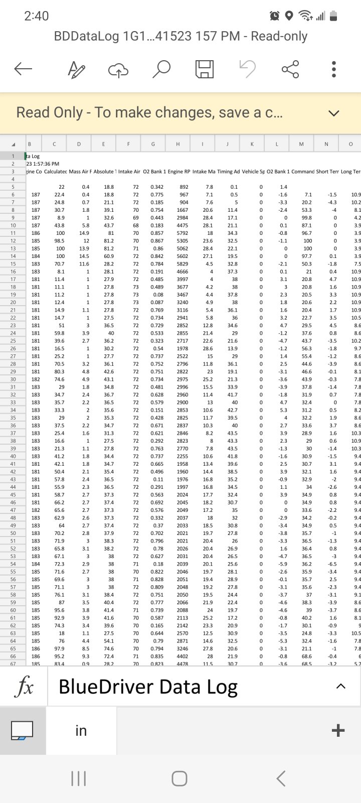

This doesn't appear to be a stock 2007 2.2L tune. Was this tune changed before or after everything worked normally in the Cobalt?
I would generally agree with:
there should be no reason for the ECU to be limiting the throttle on the tune side
Granted I don't have a lot of E37 experience but I can already see there's some significant differences from the stock '07 L61 tune from the HPT repository, particularly in the dynamic airflow section. I can't say they're bad changes or the culprit, but still, not sure why were chasing other avenues with this question mark still up in the air.
A lot is changed and I'm like Rauq, I don't know anything about the E37. But there are a lot of things changed that look questionable to me. Have you chased this problem by turning off everything that looks like a limiter? This can sometimes have unintended consequences. If this is mostly a stock vehicle reload a stock tune and see what happens. Remember that there are things that can't be seen in a tune file and sometime changes have unintended consequences.
Have you changed any sensors?
Otherwise, we will mostly just have to throw out wild guesses without any real information. If not a tuning issue, likely a wiring issue or maybe a fuel issue.
In particular, the dynamic airflow is set to disable at 2000 rpm. Is that correct?
On the P12 at least, that makes it MAF only, but I don't have the VE correction factor table. The spreadsheet datalog doesn't make it look like it's running poorly, just without throttle, so yeah, I wouldn't think that's the problem, but my vote currently remains to flash the last known good Cobalt tune and try that out.
Anything that looks like a torque limiter looks disabled to me, but again, I don't know E37's that well, but still seems like it could potentially be causing a problem rather than solving it.

Update post!!! SHES ALIVE!!!! I spoke with ZZP yesterday and I believe someone else on the forum post or Facebook post mentioned it. It was a bad speed sensor. I unplugged it and she runs wide open in all gears now. I have an order out for a new one which should be here next week.

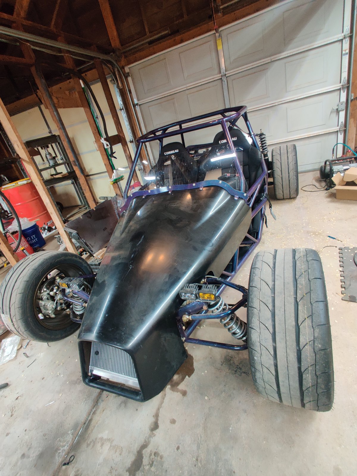

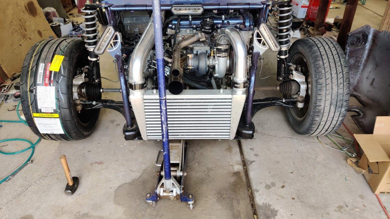

Ross, Mine is significantly less than 17 seconds, I haven't tested it out again since swapping the 4.41 Saturn Vue gearset and going from a 205 highway compound to the 555RII 275 setup, Ill have to grab my dragy and check it out this week.
39733
39734
Ross, Mine is significantly less than 17 seconds, I haven't tested it out again since swapping the 4.41 Saturn Vue gearset and going from a 205 highway compound to the 555RII 275 setup, Ill have to grab my dragy and check it out this week.View attachment 39733View attachment 39734
Yeah, I realize now I was thinking of Robf's build, he had the 17 second 0-60 run in limp mode.
Your turbo build looks nasty fast. Love it :)
