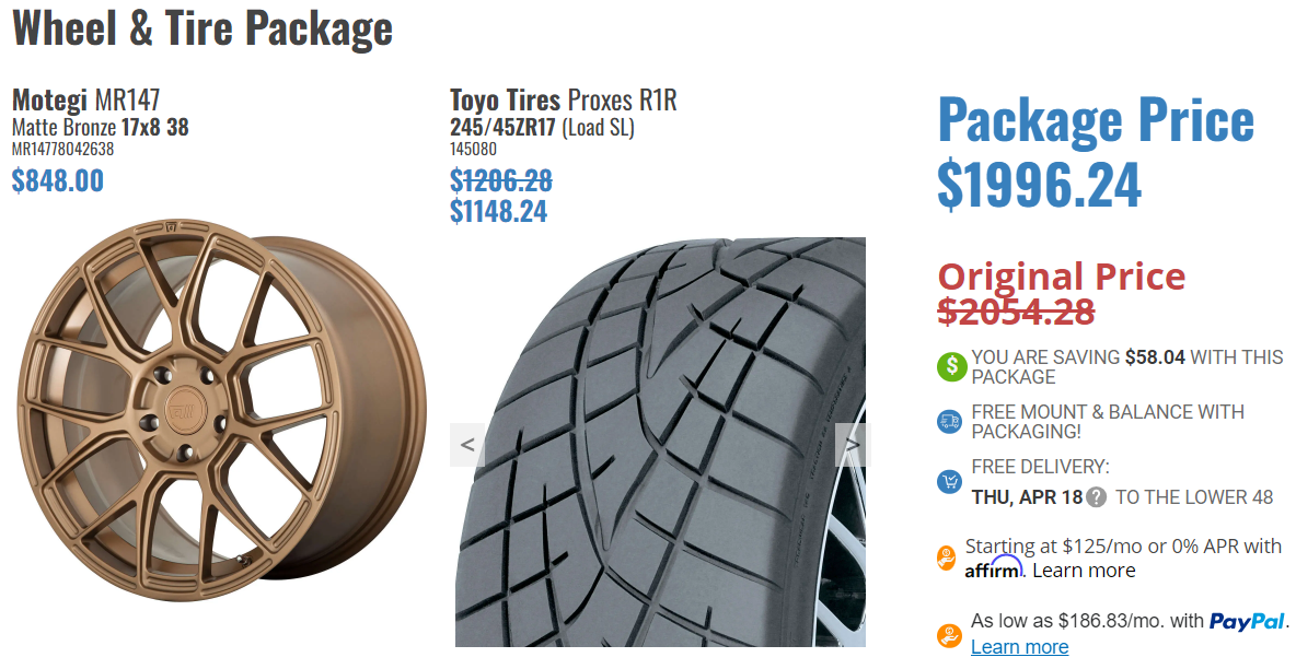

If you're set on R1R's, this would be my pick (screengrab from Fitment Industries). But R1R's being directional means you can only rotate front to back. If you were to go with an RT615K+, V730, or R888R you could rotate all the way around. The MR147 in 17x8 is 18.6lb as well, but 245 is about as wide as you can go on an 8" wheel. I still think a 245 is plenty though.
