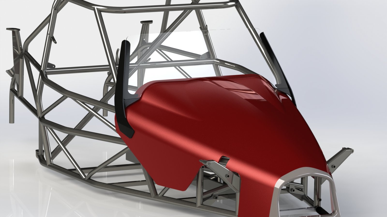

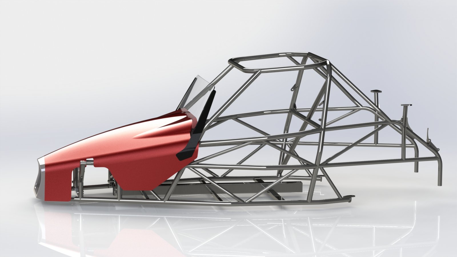

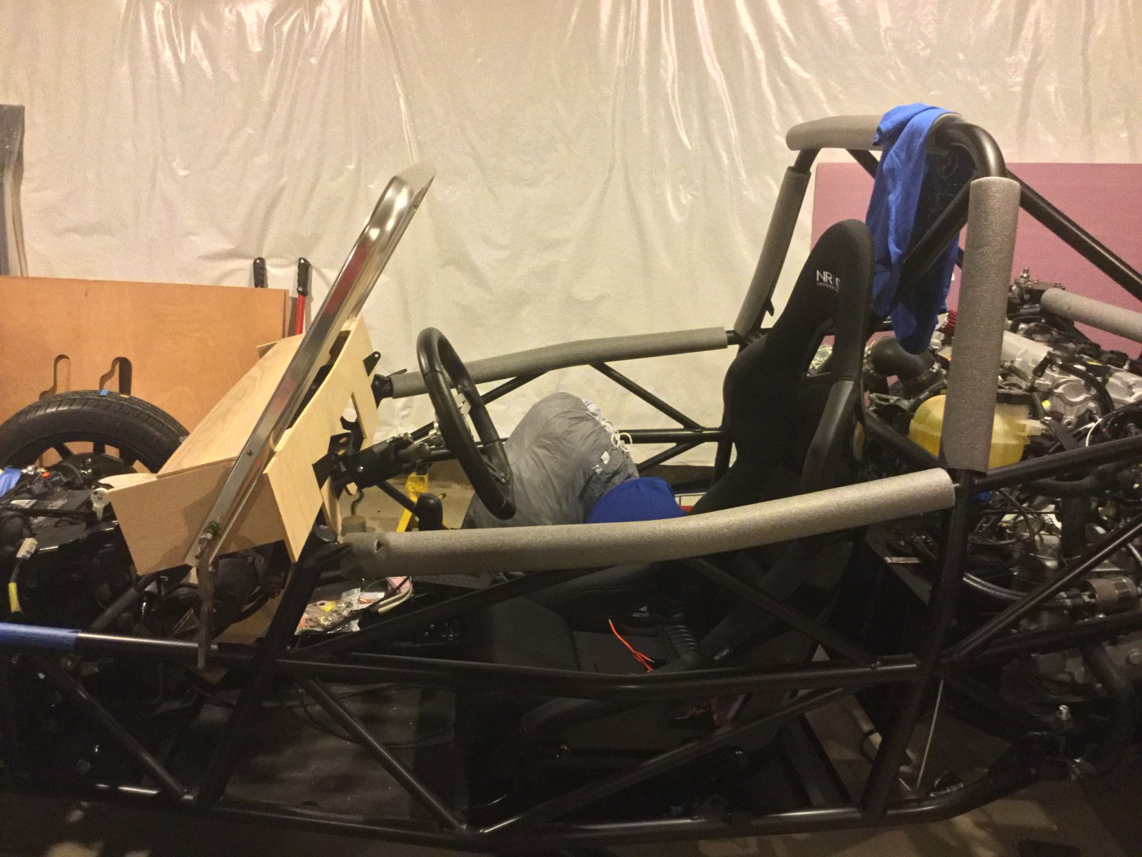

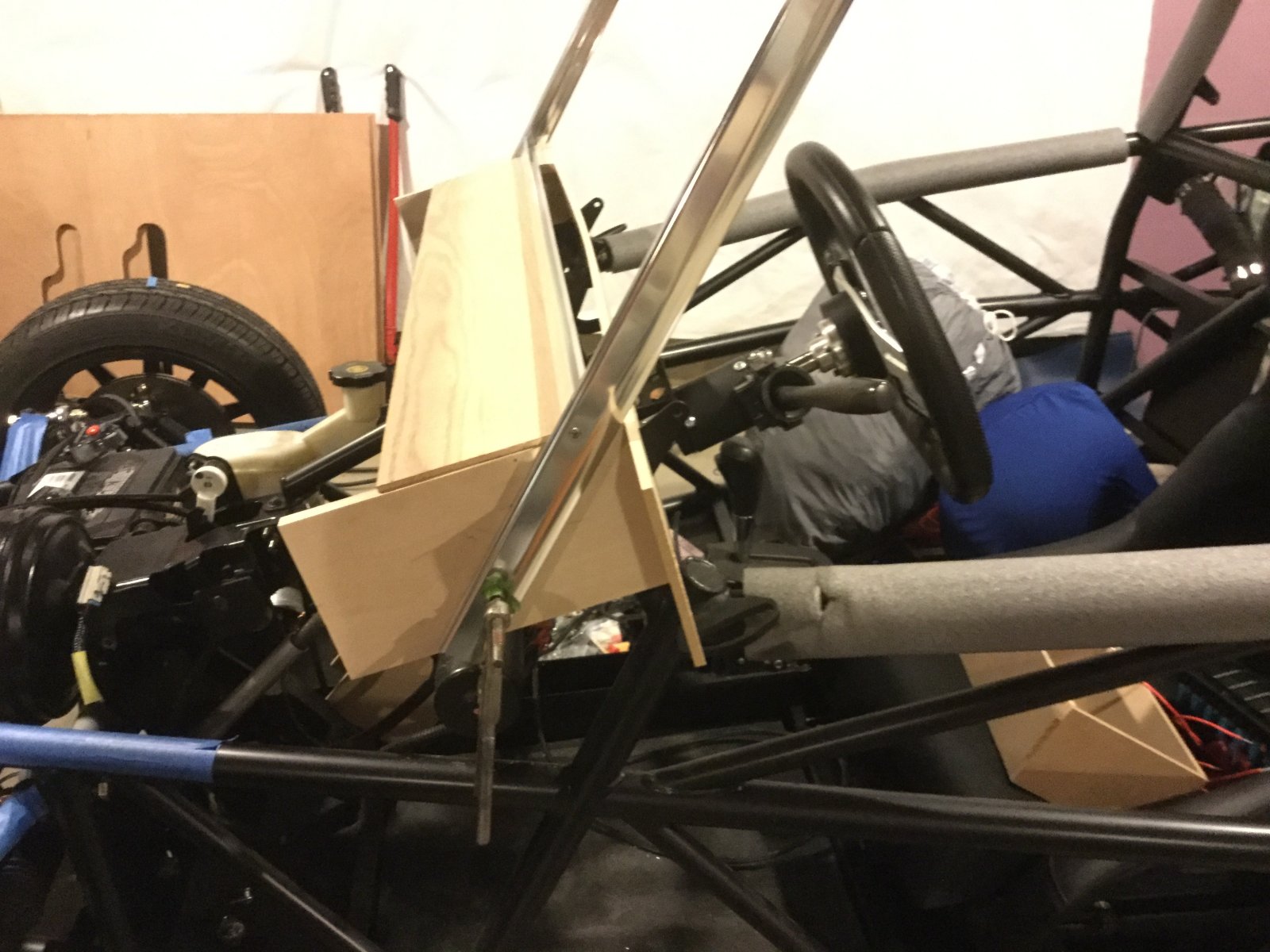

We are working on a safety glass windshields and frames for the Goblin.
The windshield blank comes from a 2000 Chevy Impala. We have built a fixture that supports and locates the glass in a water jet cutting machine. Once the glass is cut to size we will use windshield adhesive to mount it to the two supports.
We were able to keep the original mirror mount that GM uses on the Impala. This will allow us to use a large selection of mirrors from different types of GM vehicles.
The windshield is curved which will give it more strength.
The windshield and side supports are spaced a half of inch off of the nose to allow for a formed rubber seal.

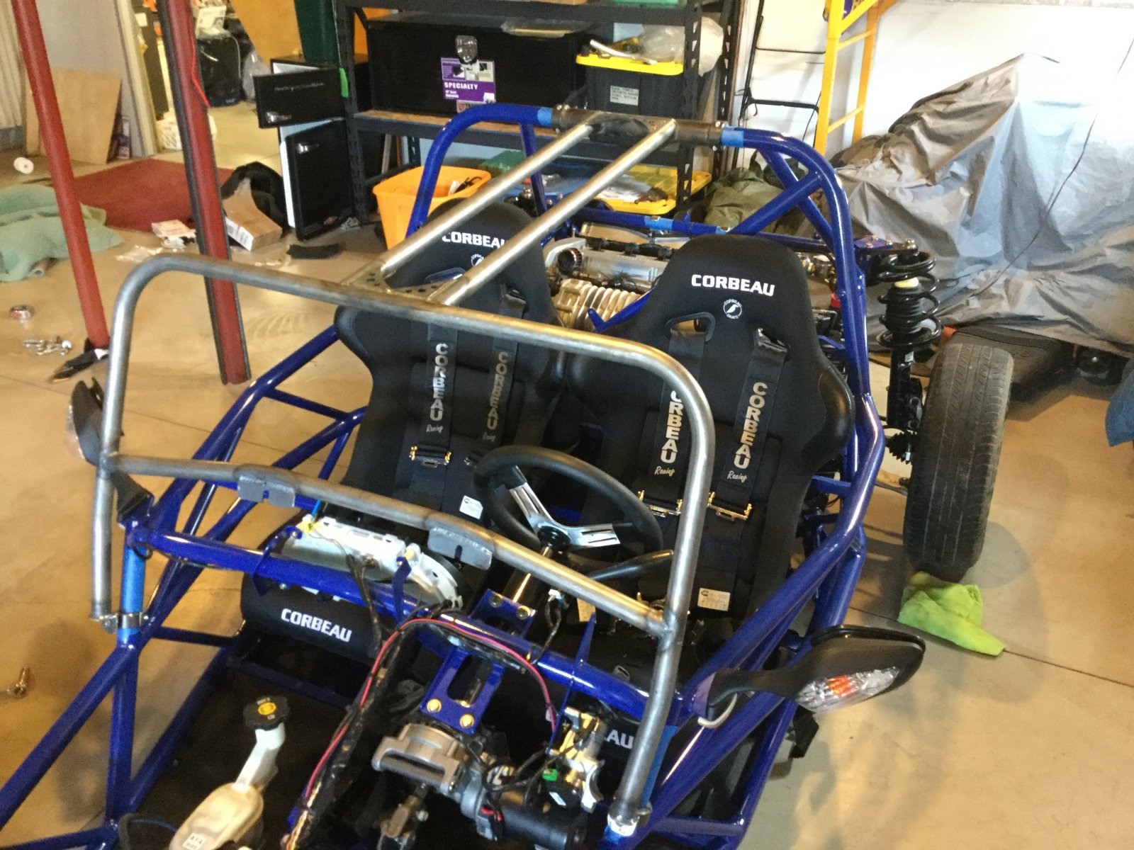

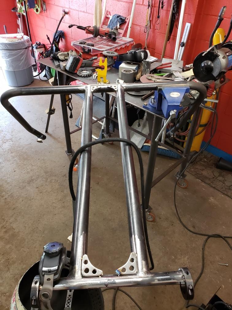

Here is the build up of the upper roll cage/windshield frame for the “BLUE” Goblin. It is made up of 1 1/4” mild steel tube. It is completely removable as a single unit. The windshield is a flat piece of laminated glass cut to fit the frame and has been glued into place. The 2 tabs at the bottom of the frame are for the windshield wipers.

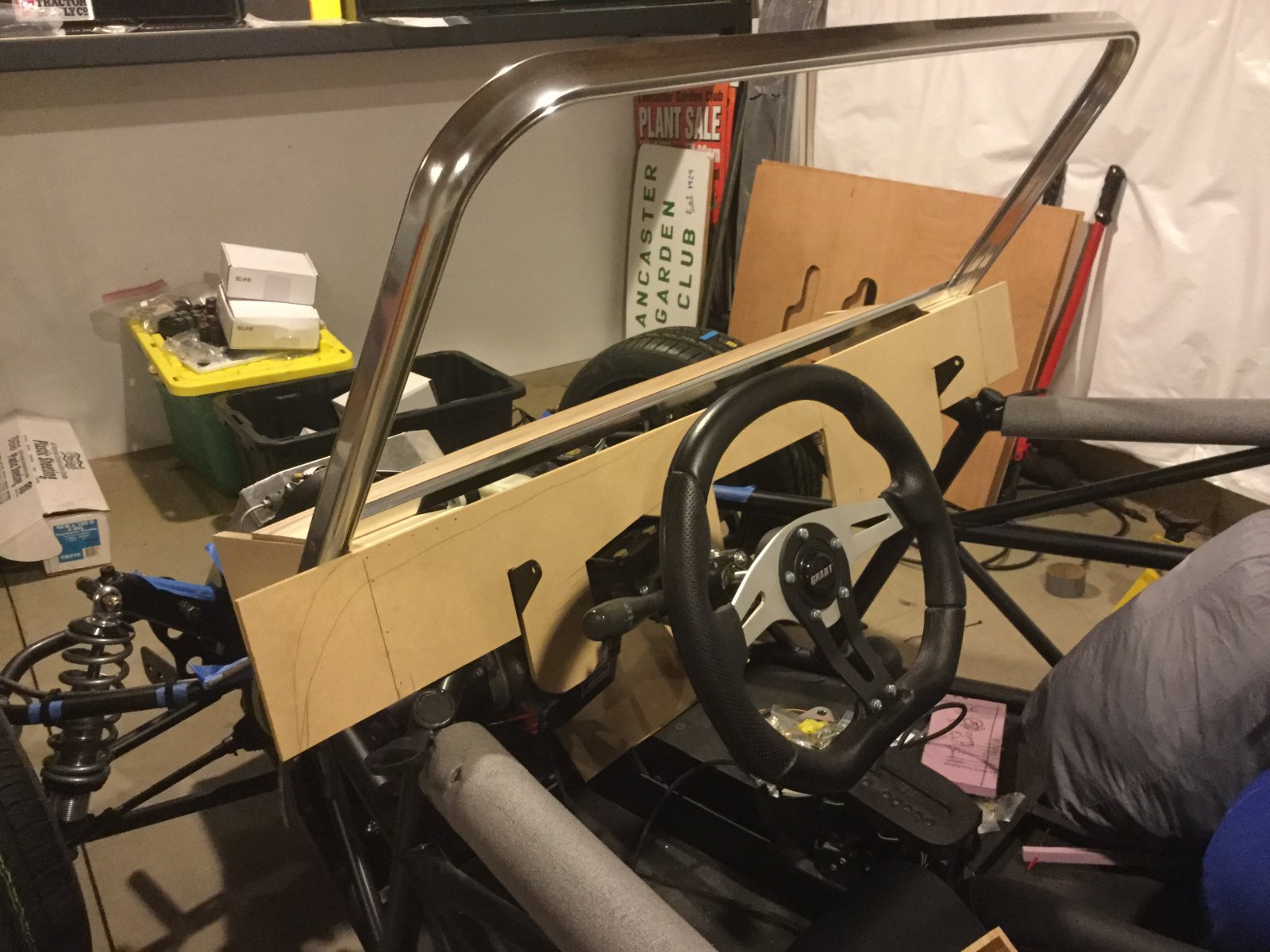

Nate’s car I’m look to use a complete windshield and frame from a VW dune buggy (one of the Meyers or Berrien dune buggies) they come in widths from 41” to 43” stock. Problem I have had in the past with these and the Lotus 7 style frames is that everyone uses the frame to get in and out of the car bending the frame (cracking the fiberglass hood and eventually cracking the windshield itself).

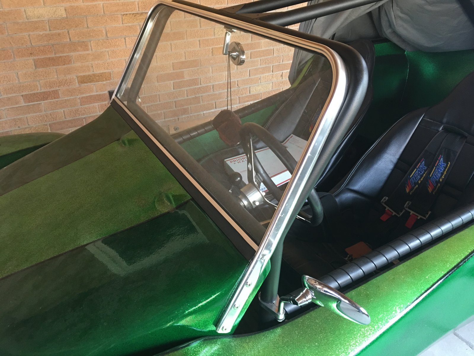

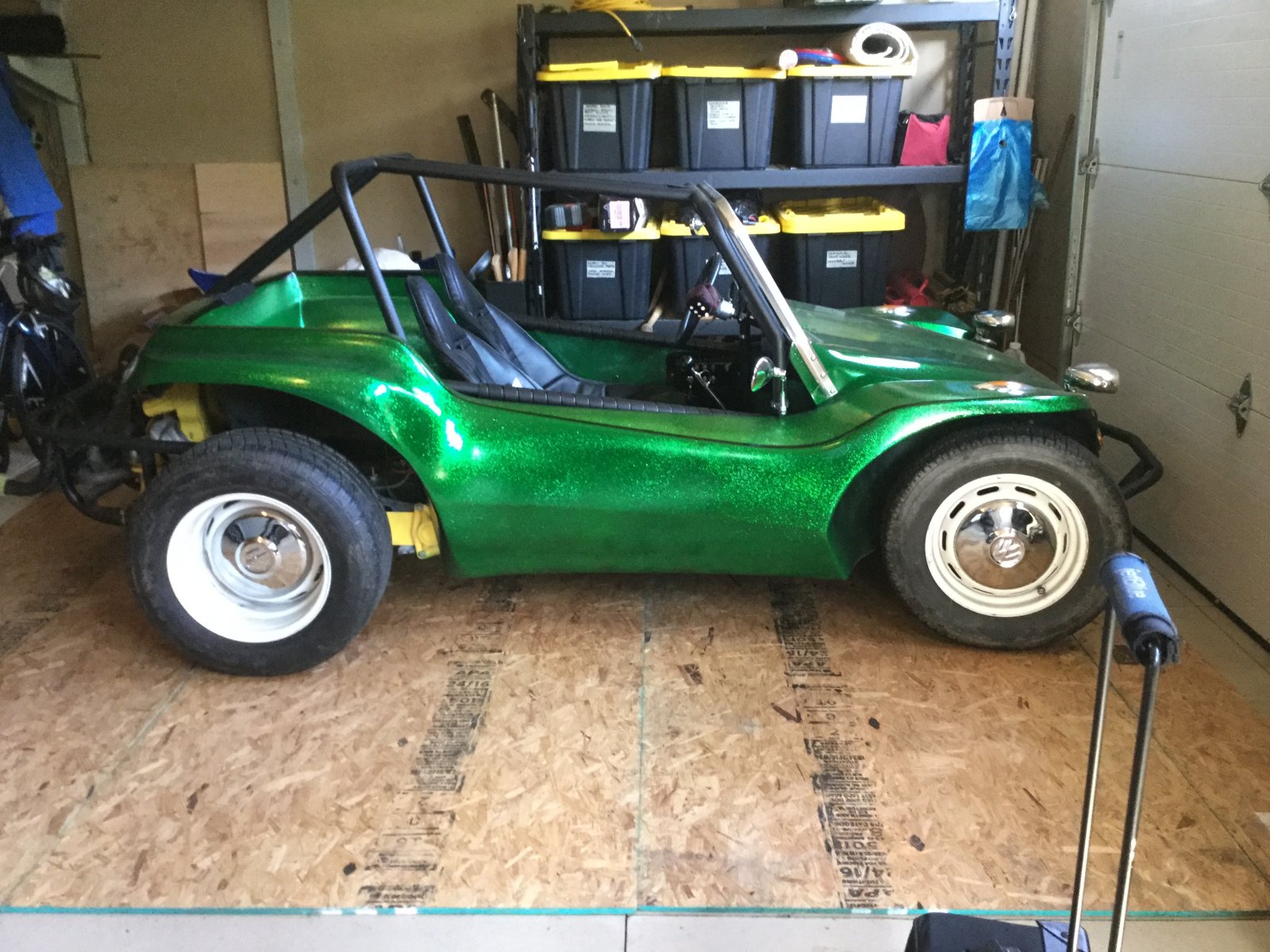

Here is our Berrien dune buggy with the stock windshield frame (We actually made the roll cage to mirror the frame for extra support). With the 41” wide frame should be able to make a relatively simple support to bolt right into the Goblins frame.
Just a side note: (dune buggy I built couple of years ago). The wheel base is almost identical to the Goblin frame, a brand new body is about $3000.00 curious if you could mount it to the Goblin frame mating the new with the old. The performance of the Goblin with the old school look (definitely surprise everyone off the line).

Here is the build up of the upper roll cage/windshield frame for the “BLUE” Goblin. It is made up of 1 1/4” mild steel tube. It is completely removable as a single unit. The windshield is a flat piece of laminated glass cut to fit the frame and has been glued into place. The 2 tabs at the bottom of the frame are for the windshield wipers.View attachment 3207

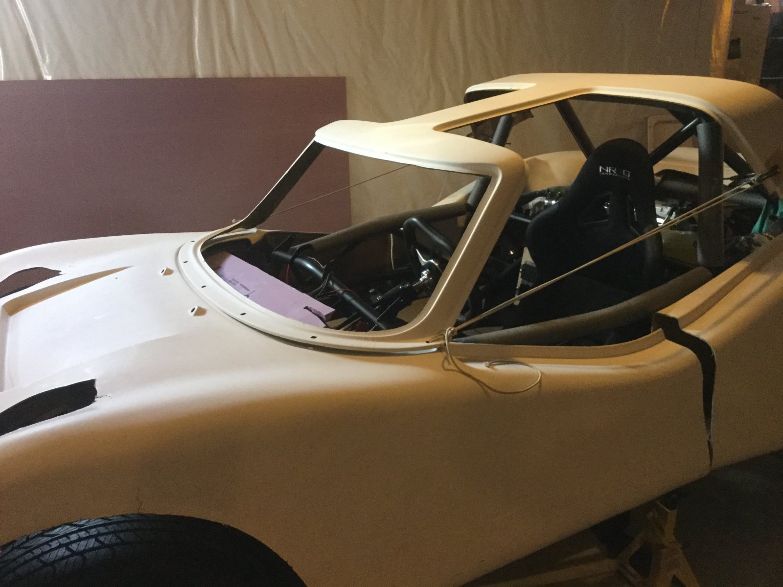

Just a thought working with that Bradley GT body which the original cars use the windshield out of a 63’ thru 67’ corvette readily available less then $300.00. The frame is nothing more than fiberglass (granted people re enforce them when they use it as a stand-alone without the roof section). Is there a way to use an MG, Super Beetle or ??? And make a similar style fiberglass frame to fit a smaller cheaper laminated glass windshield?
