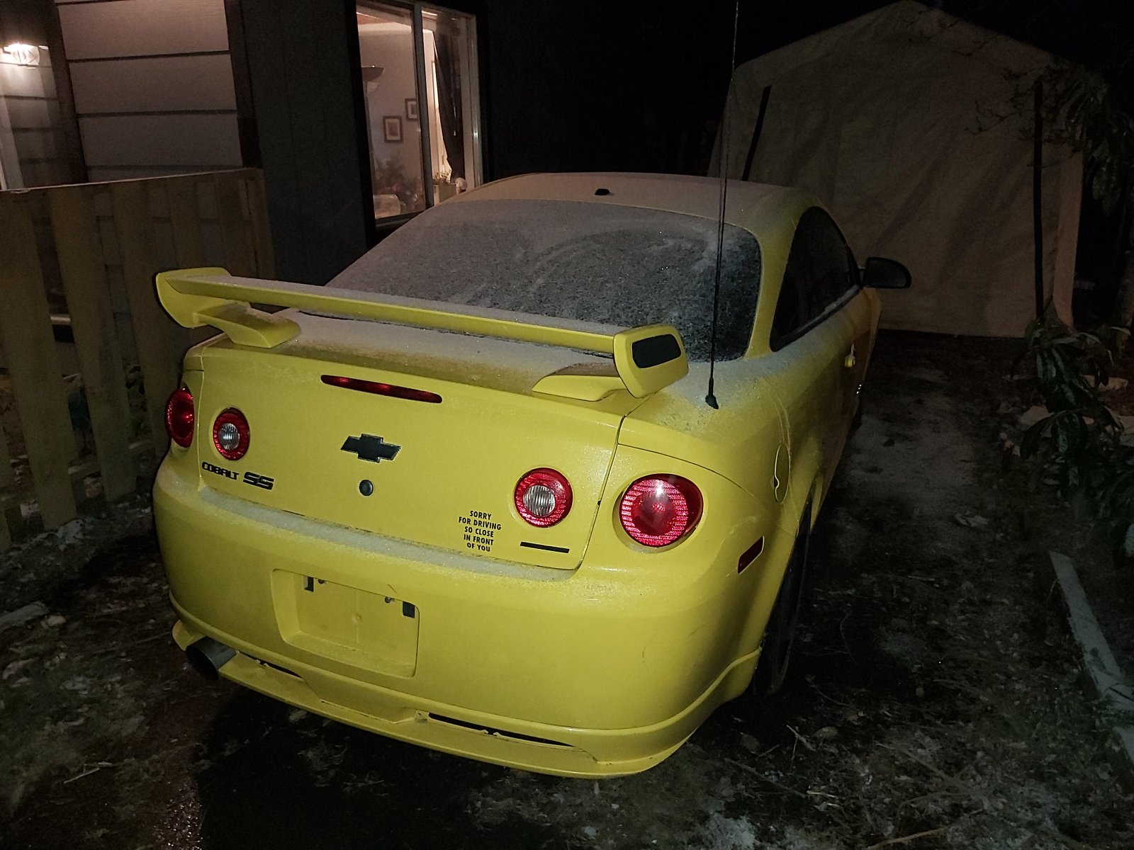

I picked up the donor tonight.

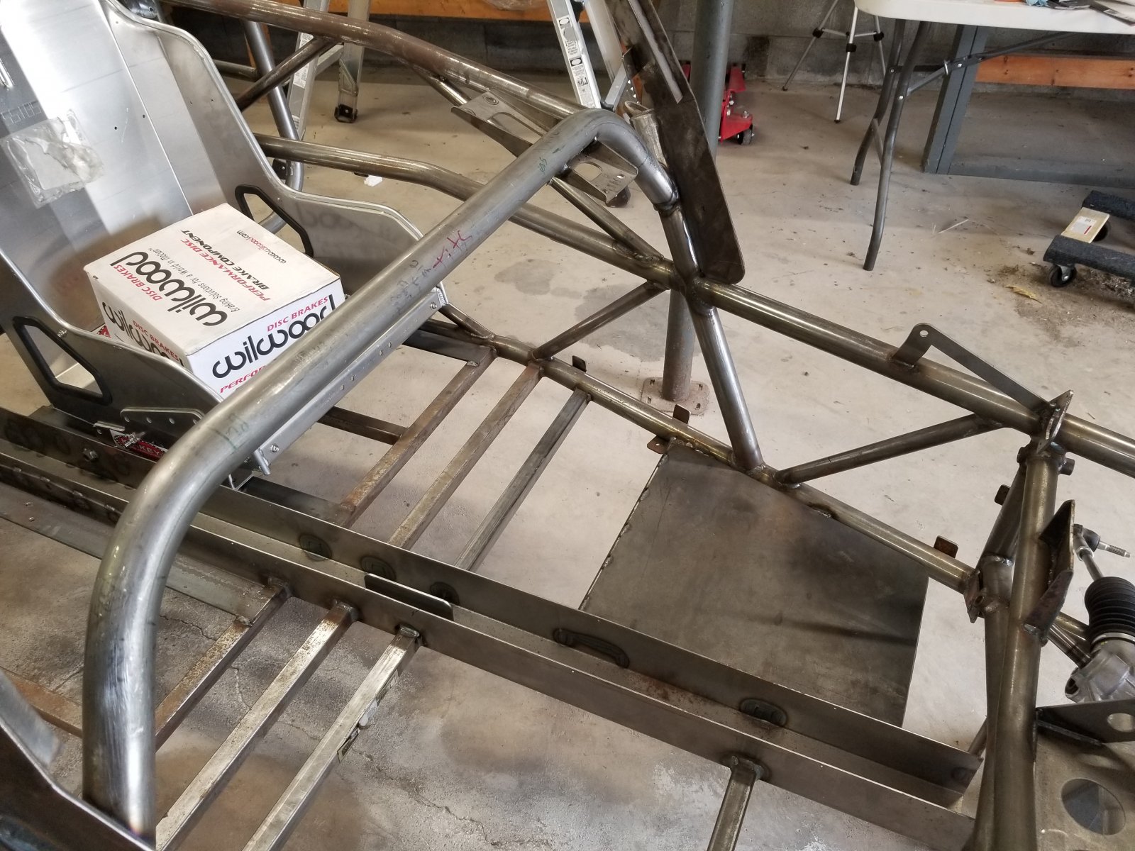

Moving the pedal box is a difficult option and would require a lot welding and fabrication - you should check out the build logs for photos. Moving the steering wheel location is far easier and there are at least 2 builders who have moved the steering wheel location forward.
It should also be noted the 4 inch added into the frame is right at the front edge of the seats - the extended frame has a double crossbar welded in versus a single crossbar for the standard chassis. The steering wheel and pedal locations do not change between the two.
Thanks, going to look into that. My initial assumption was the pedal box would be easier to move.
Tinkles
Steel plate and a Wilwood floor mount pedal box is the route I am going. All of the changes I made were personal preference.
