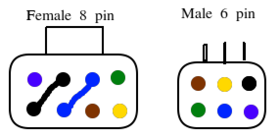

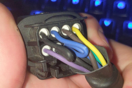

Its strange. Its not exactly pin to pin. There are some splits and whatnot. I'll do my best.

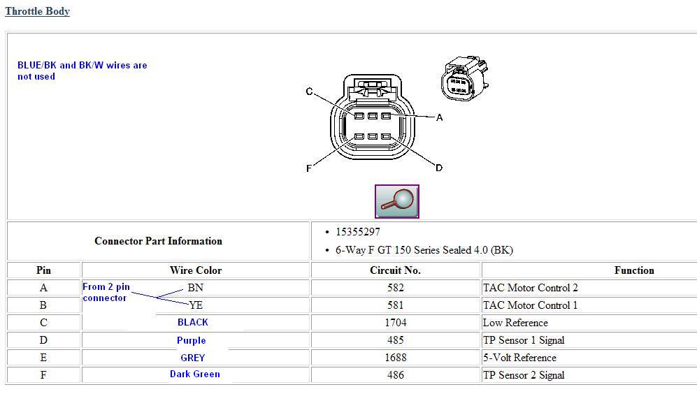

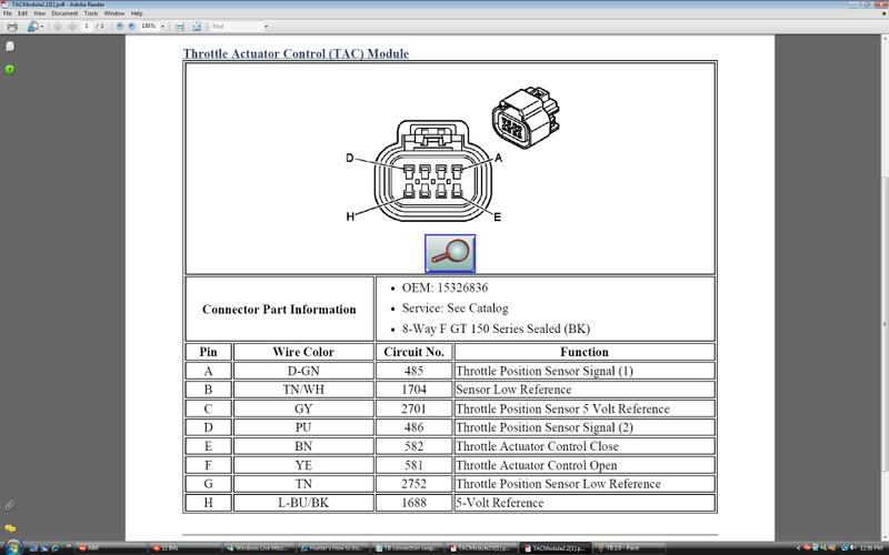

Did you need to reprogram any computers? I’ve rewired mine and when I turn the key it responds with a small open close sequence. However when the car is off it does not open or close when throttle is applied like the old one does. I have been using your images plus these from the OEM manual
