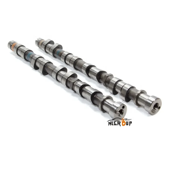

Guys. Anybody out there install ZZP Stage 2 cams for there Turbo or Supercharged Goblin? If yes, are you happy or any driveability issues?
Guys, do you think you had a 30hp gain? Also, did you install ATI Damper and a Nuetral Balance Shaft?.. Also, did the streetability change at all?
I managed to get my hands on a ported stock supercharger and while I didn't want to send the extra $ I finally broke down and bought a few extras to add to it while I had the motor out (LSJ). I added the ATI damper, ported head, stage 2 cams, 80lb valve springs, ls4 throttle body, balance shaft delete, and a 2.8" pulley. I'm currently finishing up the tune with Tyler at ZZP and the gains are very noticeable. I'm also running meth injection to aid with the AIT2 temps. The cams Def give it a bit of a chop at idle and it can idle low coming to a stop (likely due to the ls4 throttle body) and it will occasionally stall when not downshifting until the tune is finished. Tip in on throttle from first and second takes a gentle foot bit it is likely due to the telhrottle body as they are well known to exacerbate the issue on goblins (mine was sensitive before the throttle body change). I'm happy with the power increase and everyone's tolerance for nhv and quirkiness differes but for me it was worth the tradeoff. I did add a new lsd transmission, df subframe and the floating brake kit wheb everything was apart so all of the changes at once make just the cam addition hard to single out.Guys. Anybody out there install ZZP Stage 2 cams for there Turbo or Supercharged Goblin? If yes, are you happy or any driveability issues?

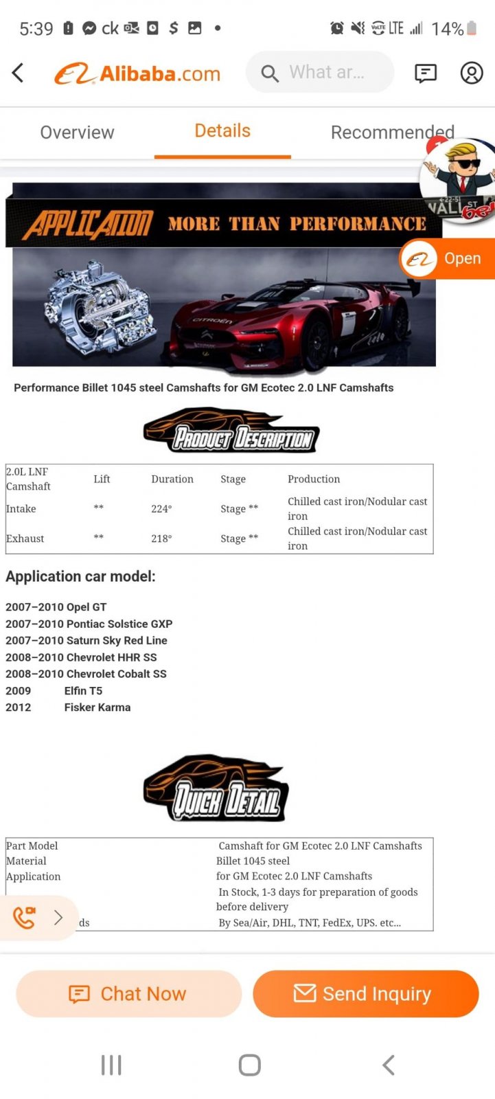

Still doesn't tie it down exactly, although it mostly answers my question. I don't think the cams for the turbo car will work in the SS/SC or SS/NA engine since the SS/T uses a cam lobe to drive the HP fuel pump. Although it's possible they will swap and the extra lobe doesn't do anything.SS car changed to Turbo
