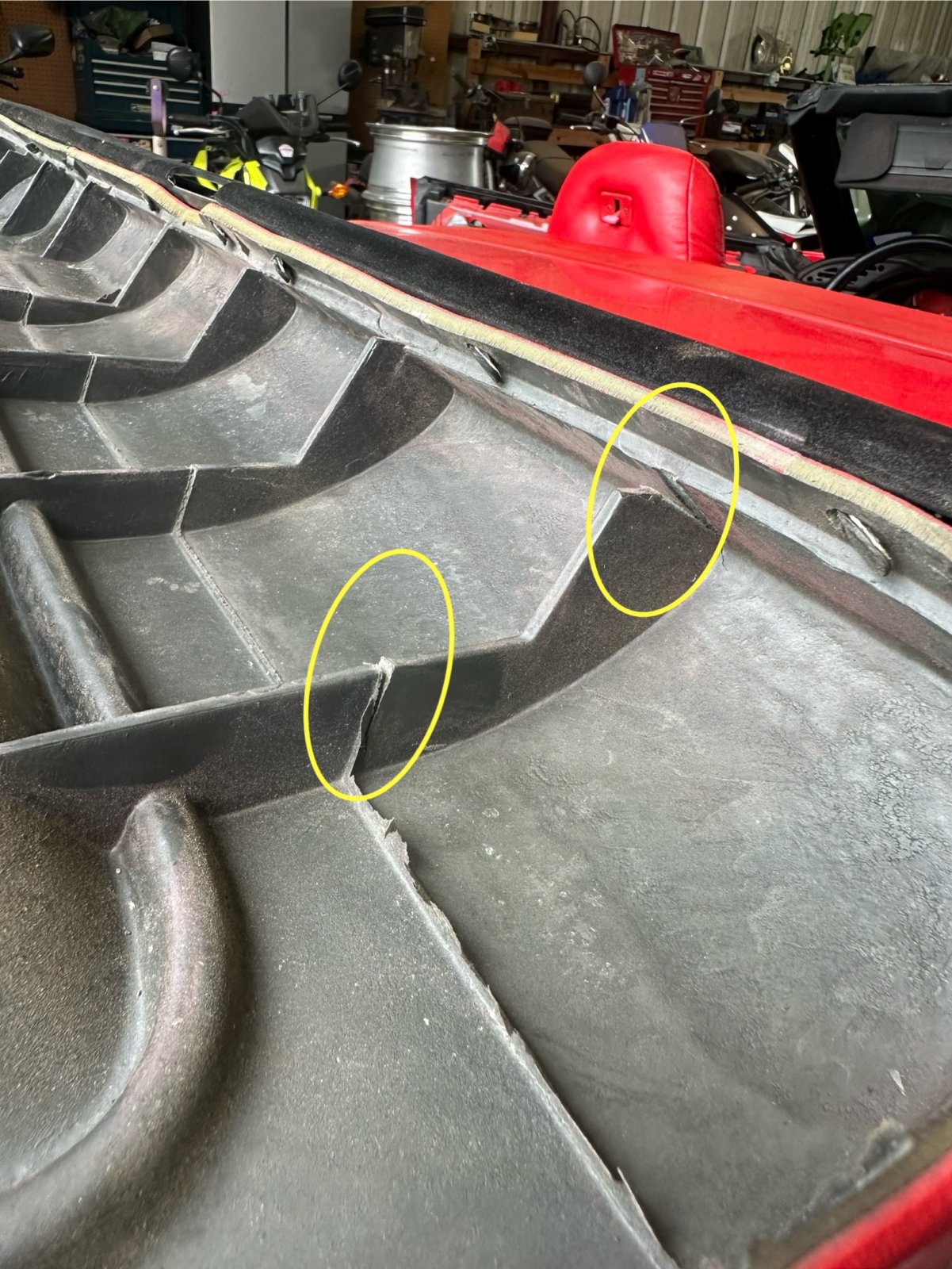

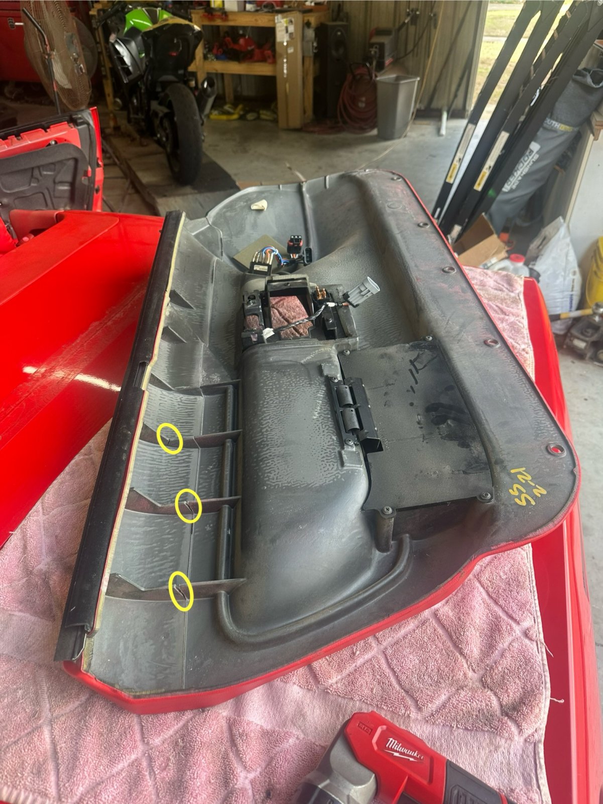

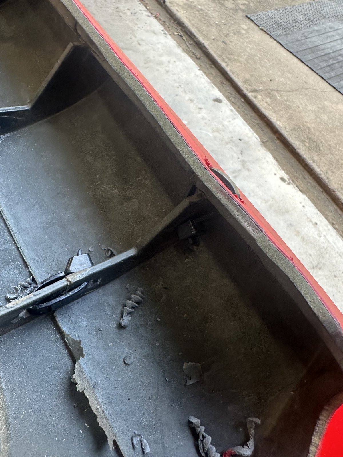

@Desert Sasqwatch is fuming at this post. He could have drilled so many speed holes with these.I have been doing stuff here and there as time permits.

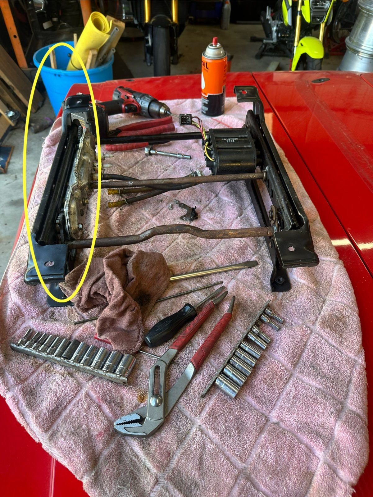

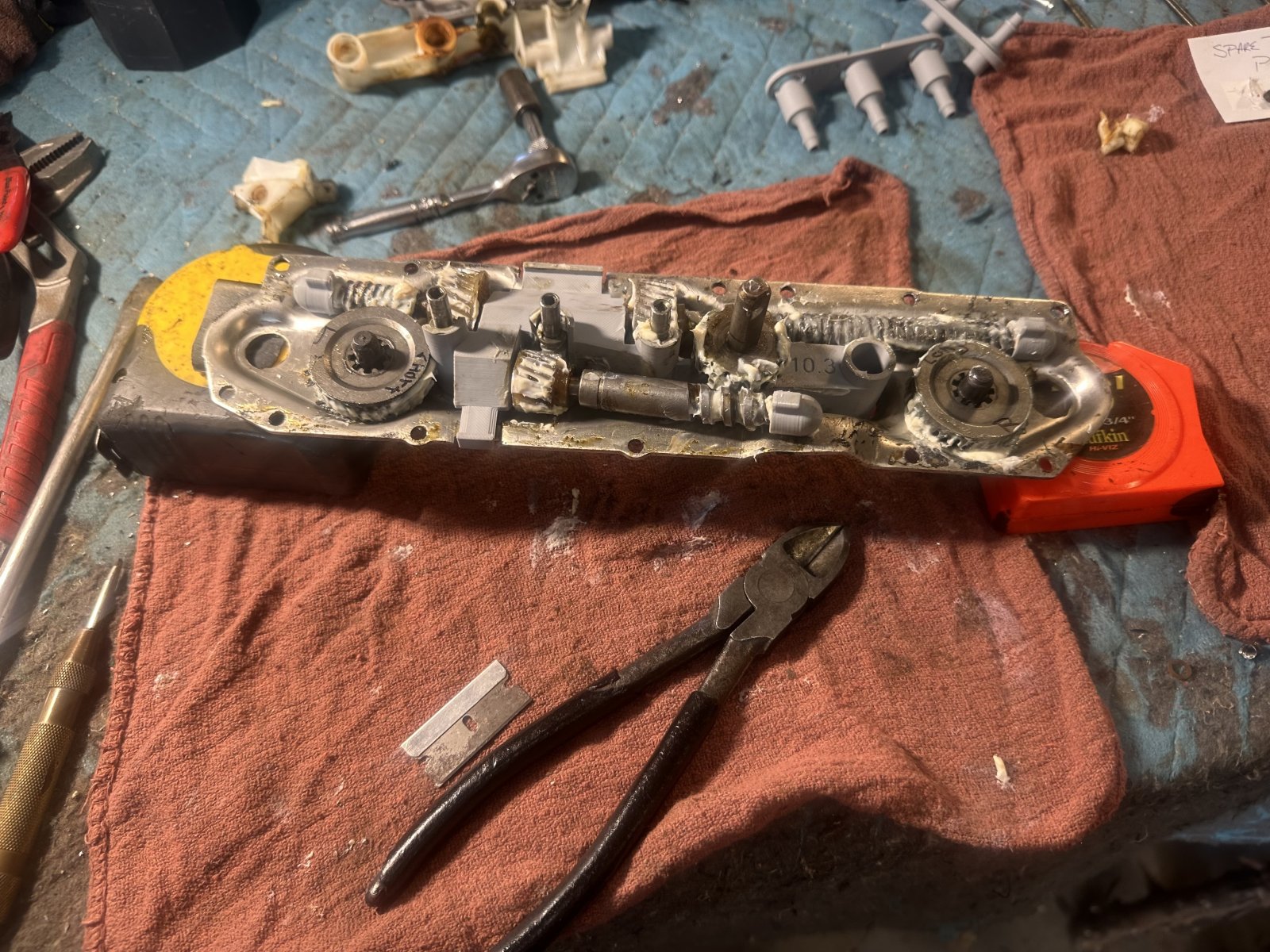

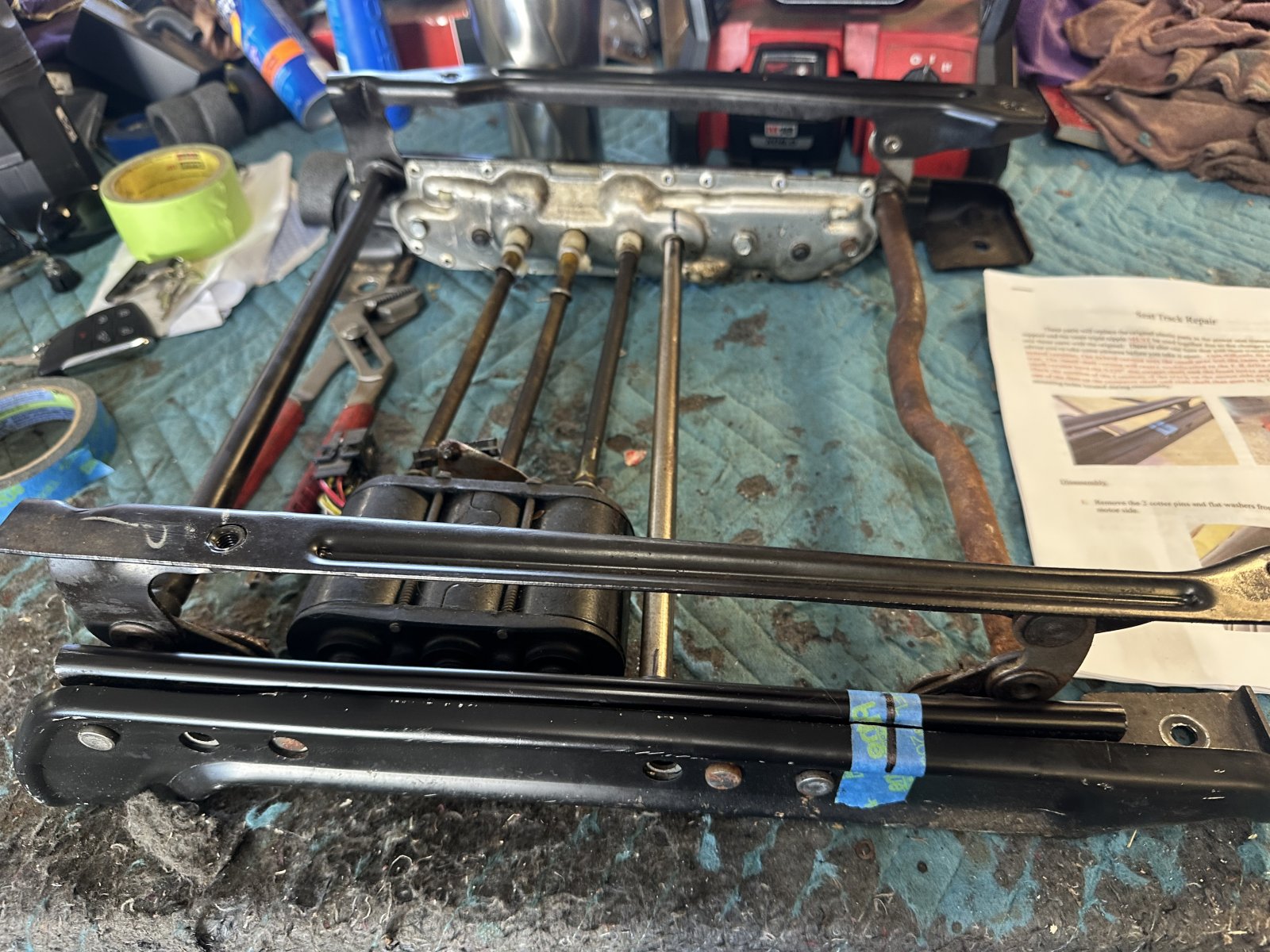

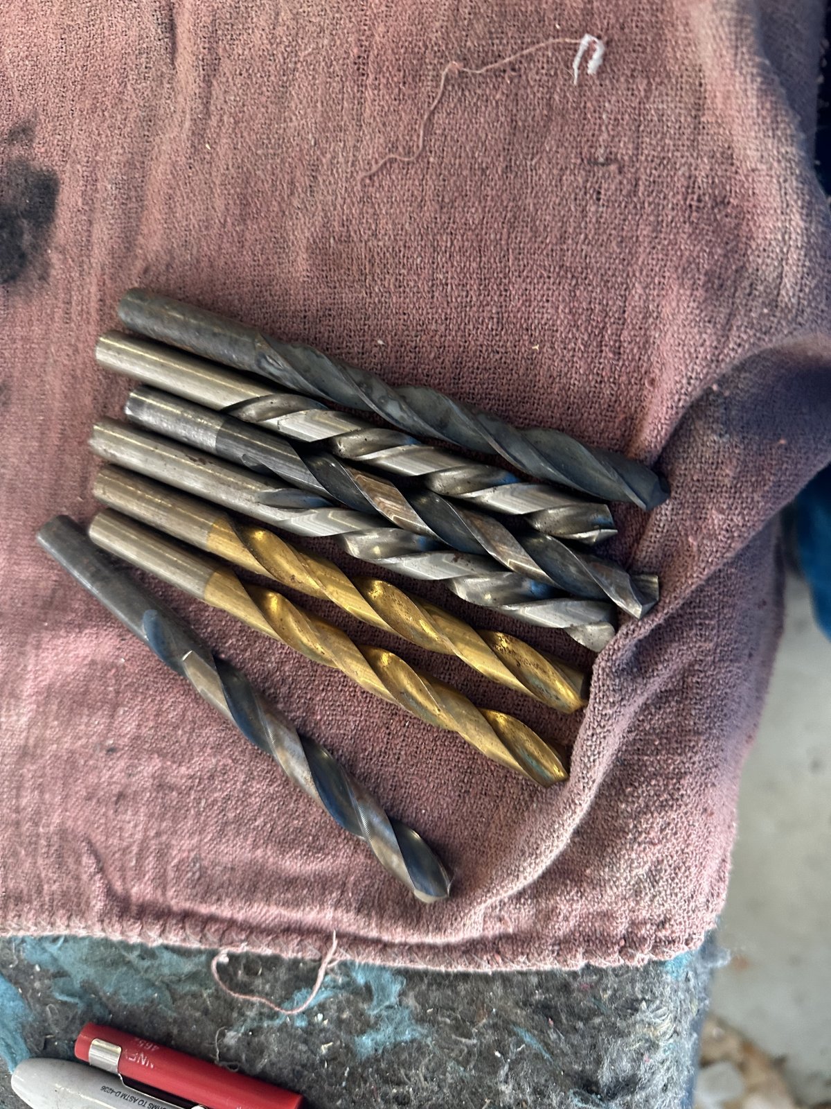

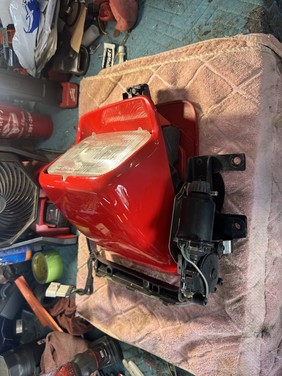

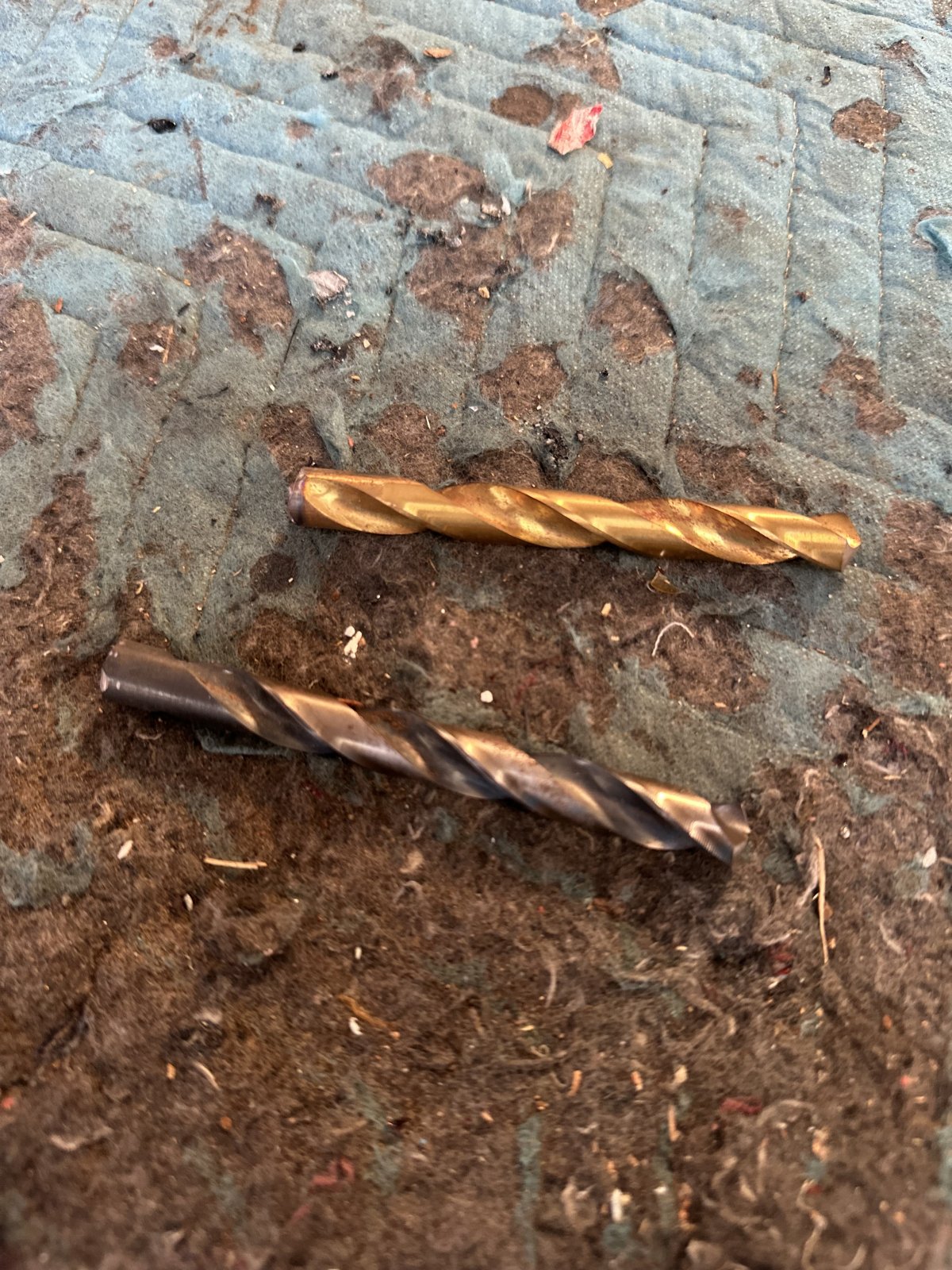

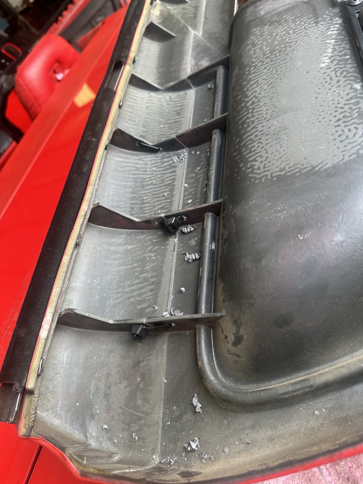

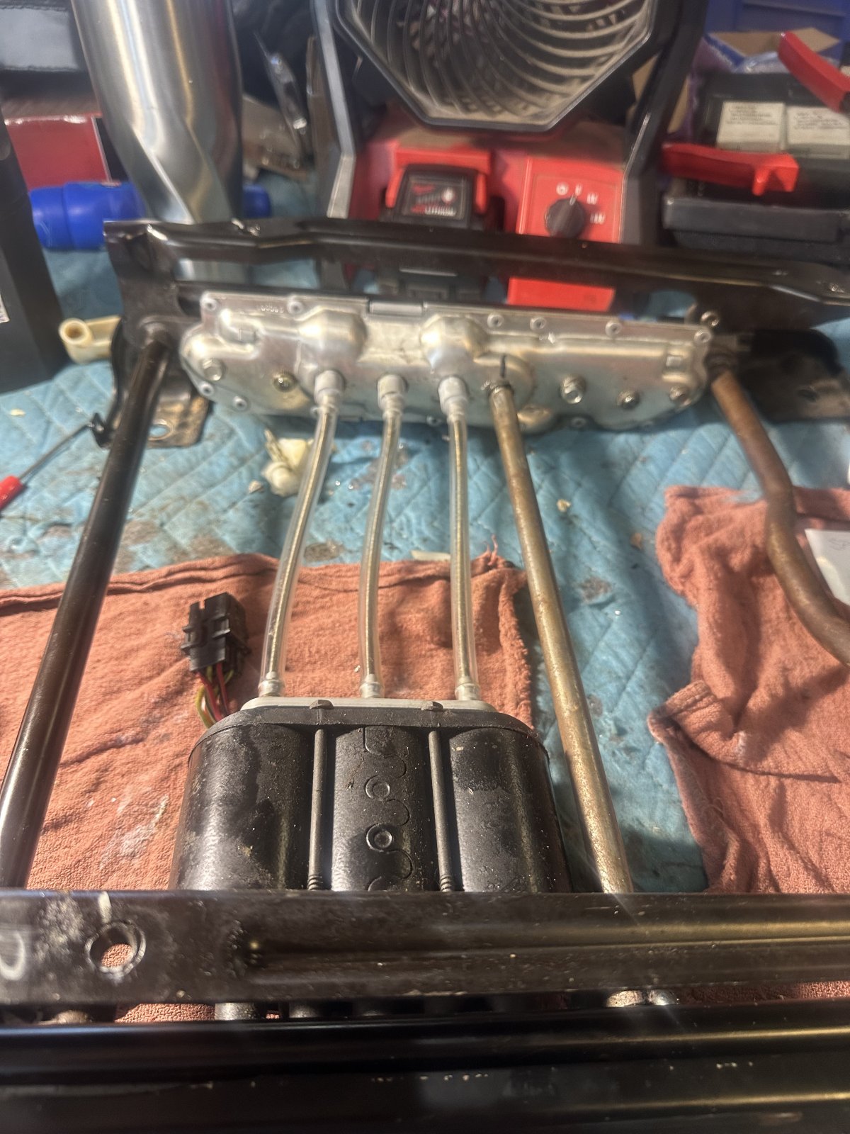

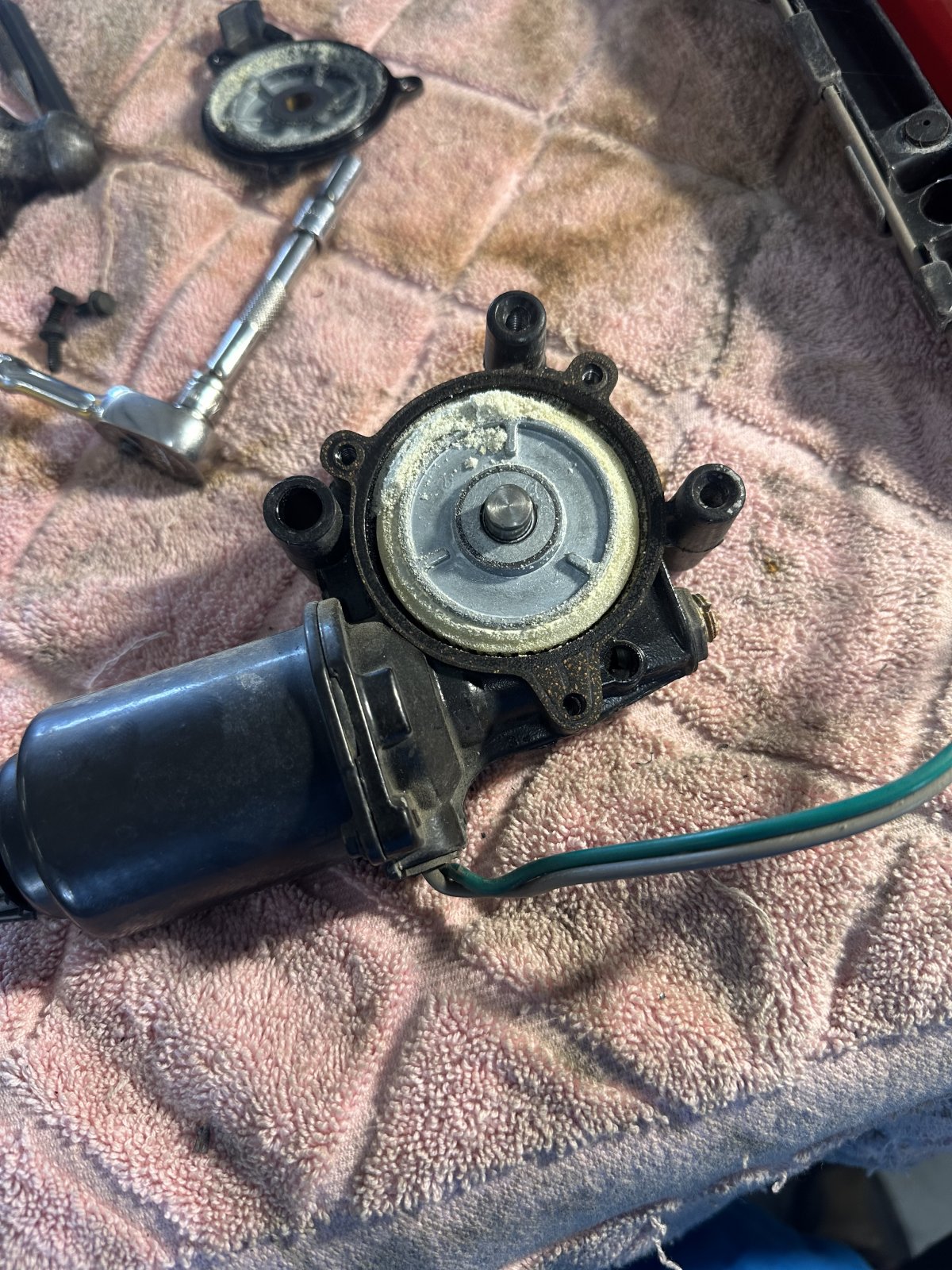

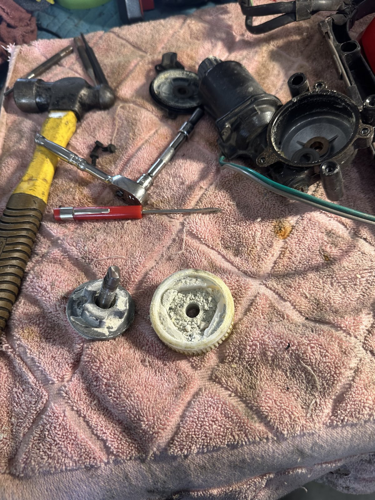

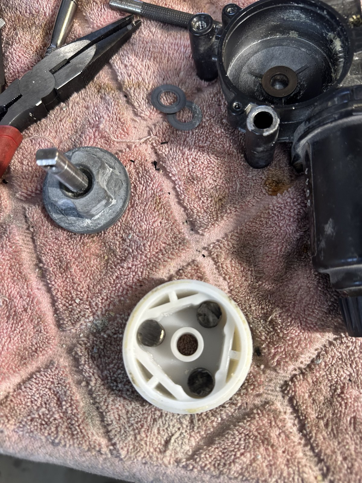

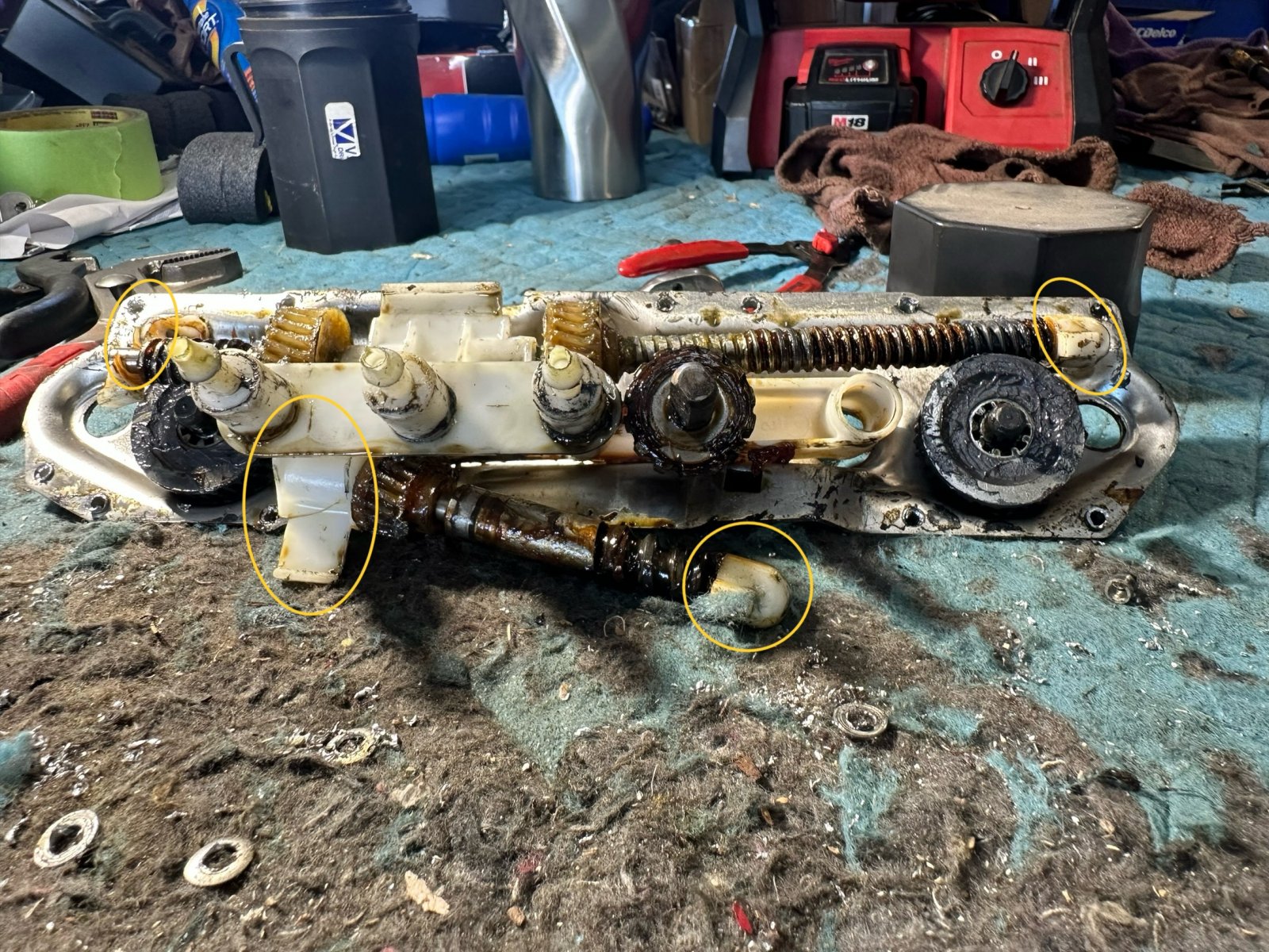

the headlights rotate, but clink noises until the headlight module times it out. There’s little 7/16” (basically) plastic dowel rods that turn to powder over time. It looks like this isn’t the first time it has been done, so I decided to cut some old 7/16” drill bits to use as the dowels, Since I’m cheap and all. Ain’t gonna turn to dust anymore.
View attachment 49748View attachment 49749View attachment 49750View attachment 49751View attachment 49752View attachment 49753
HAHAH that is the exact same setup as my Lincoln power window motors, with the same problem!I have been doing stuff here and there as time permits.
