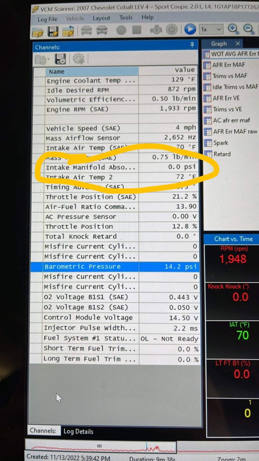

So I have one last DTC I'm sorting through; P0107 - "Manifold Absolute Pressure/BARO Sensor Low". I pulled a log with HPT and confirmed I don't have any readings from the MAP sensor, but I do have IAT2 sensor reading (which is on the same MAP sensor). So either my sensor is partially bad (still able to read IAT2 but not pressure), or I have a wiring issue. New sensor on ordered, but I have the engine harness out so want to double check continuity across the MAP sensor connector.

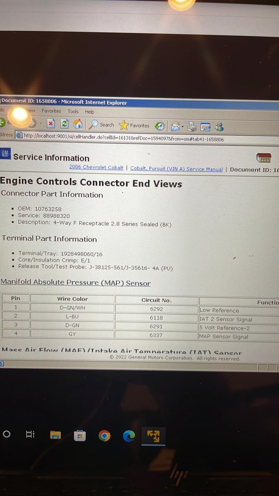

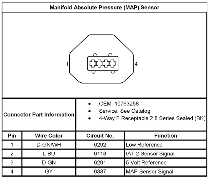

I was able to get a screenshot from GMSI for a 06 showing pinout of the MAP sensor:

All three of those wires test continuity just fine, so things should be good. However Pin 2, according to what I found for the 05 SS/SC, that goes to pin 14 on PCM C1; PCM C1 is the PCM connector on the body harness, so this makes no sense to me at all. PCM C2 and C3 are the 2 PCM connectors on the engine harness.
I previously taped up my engine harness with Tesa tape, so it's a pain in the butt to untape and trace that L-BU wire manually so I'm hoping to find a better diagram for my 07 that tells me where that should go so I can test it. According to the 06 SS/SC GMSI info I have, it's Circuit No. 6118, "IAT 2 Sensor Signal".
Like I said above, I am getting an IAT2 reading in HPT and it's the MAP reading I'm not getting -- Pin 4, Circuit No. 6337 is "MAP Sensor Signal" and I'm getting continuity on from pin 4 of the MAP to pin 37, PCM C2 as expected so I should be good but want to be absolutely positive.

Not exactly sure what sensor deviant is trying to trouble shoot but it looks like the baro sensor is working correctly from the HPT shot and I would trust alldata before a generic DTC decoder.

DTC I pulled came from HPT by the way. My baro, SCIP, and MAF are all reading as expected.

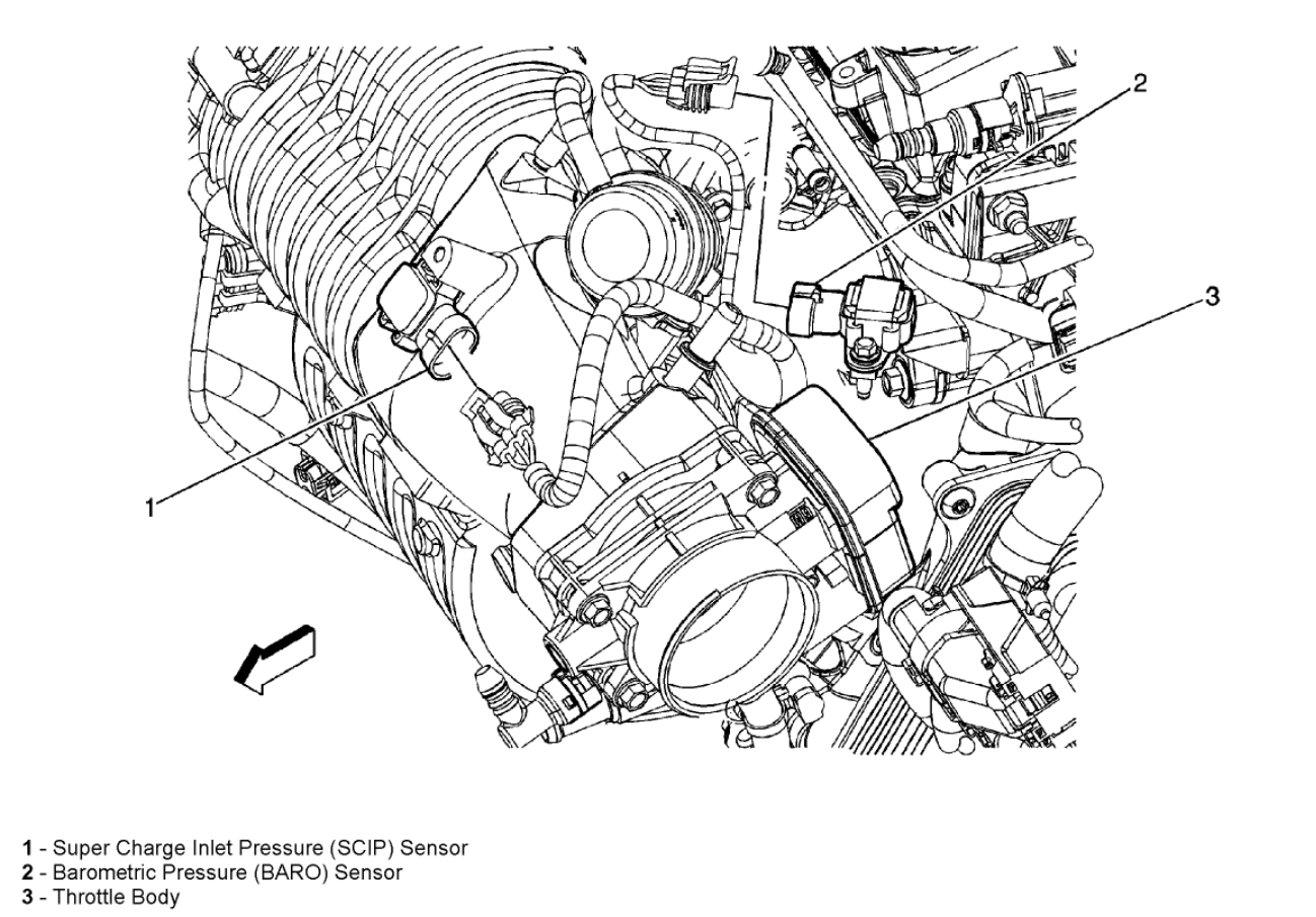

@Rttoys What other sensor has the same connector? Baro (mounted to the coolant overflow rail)? I’m 99.9% positive I have the right connectors connected; again, I’m getting a IAT2 reading and all other expected sensor reading, just not the MAP reading.
devianteng
I guess technically the SCIP is a MAP sensor, but it's not located on the intake manifold (it's before the manifold), so I don't see it as a MAP sensor but rather a "pressure" sensor; same as the Baro sensor located above the intake on the coolant overflow tube (above the intake area of cyl 4). Tomato, potato.
The sensor I'm talking about here is the 2.5 bar, 4-pin MAP sensor located on the intake manifold, GM part 213-3907. Not the SCIP (GM 213-796) or the Baro sensor (GM 213-1631).

Since your IAT2 sensor is working, I think you have a good 5V reference, and low reference. I'm guessing a bad TMAP sensor.
