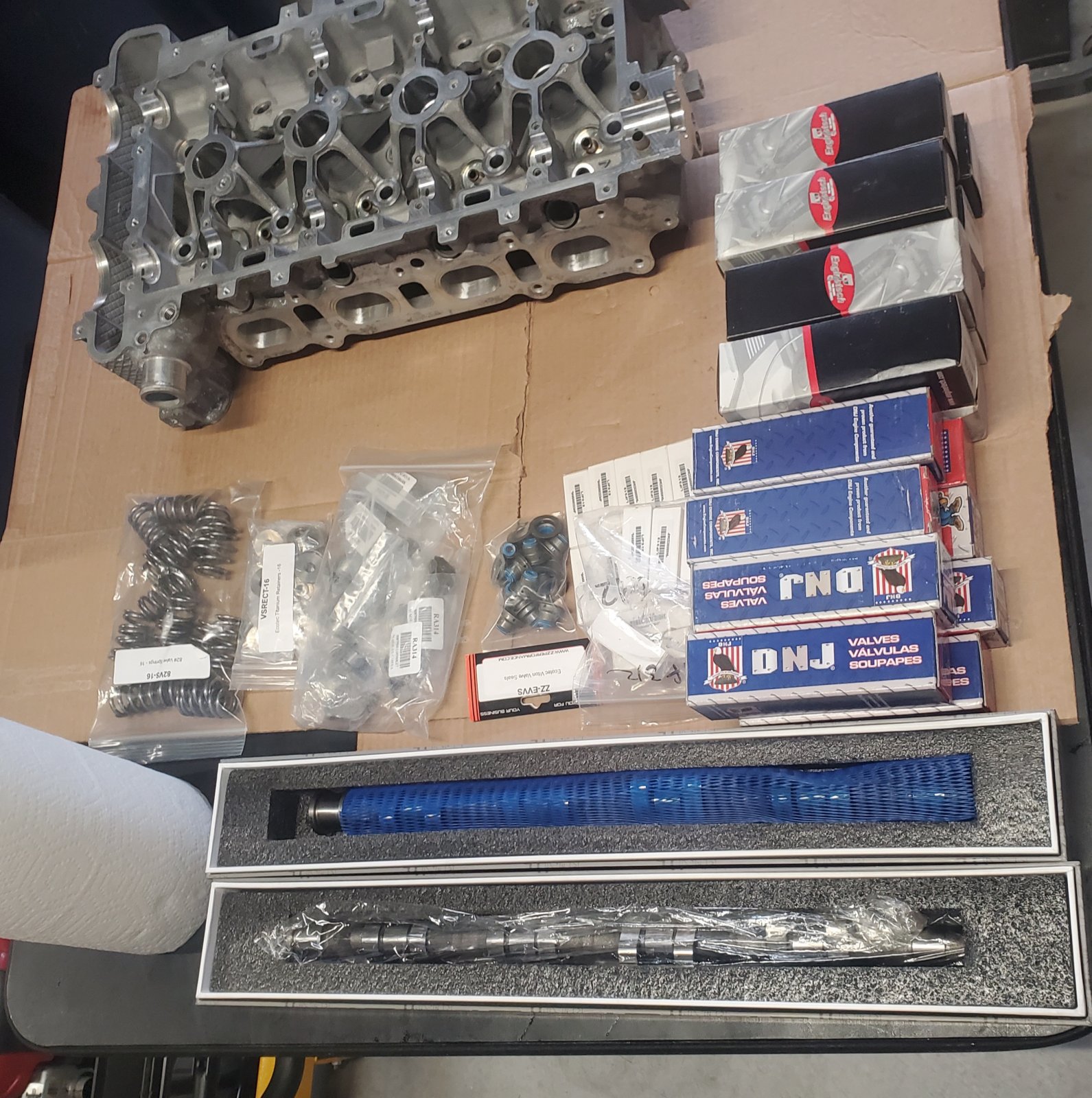

I did a complete engine teardown and rebuild of my LSJ but it had 200,000 miles. I replaced everything with exception to the crankshaft and connecting rods. Everything else was replaced, upgrades where possible. I did the ZZP Stage 2 cams, stage 2 tune kit, 82# springs with titanium retainers, balance shaft delete, Ported and polished head (did it myself), new pistons/rings, bearings, gaskets, 2.8 pulley, gutted the ac compressor so it's just an extra free spinning wheel, new valves, all new timing gear, all new bolts, oil pump, fuel pump, water pump, starter, shorty exhaust header, 60# injectors, and on and on. I figured if I was going to open it up I might as well do everything now, plus I enjoyed the process. I probably could have bought a new turbo crate engine for the same price. Oh well.

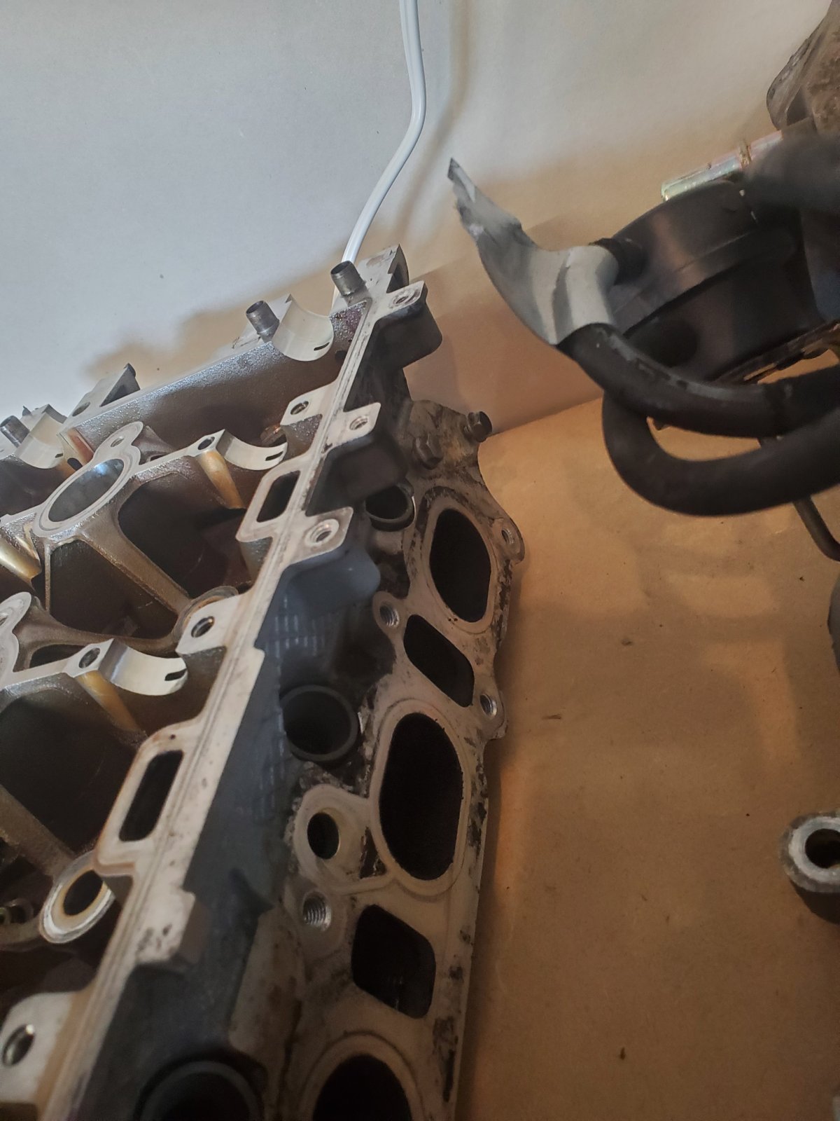

I'd be interested if you could share your port and polish experience. Bonus points if you have pictures.

I took about a month to port and polish, taking your time is key. I used a dremel with metal bits for aggressive removal and then varying levels of grit sandpaper bits for careful material removal and eventually polishing. It isn't difficult it just takes a long time. I don't really have and good pics but these are the only 2 I could find before and after.

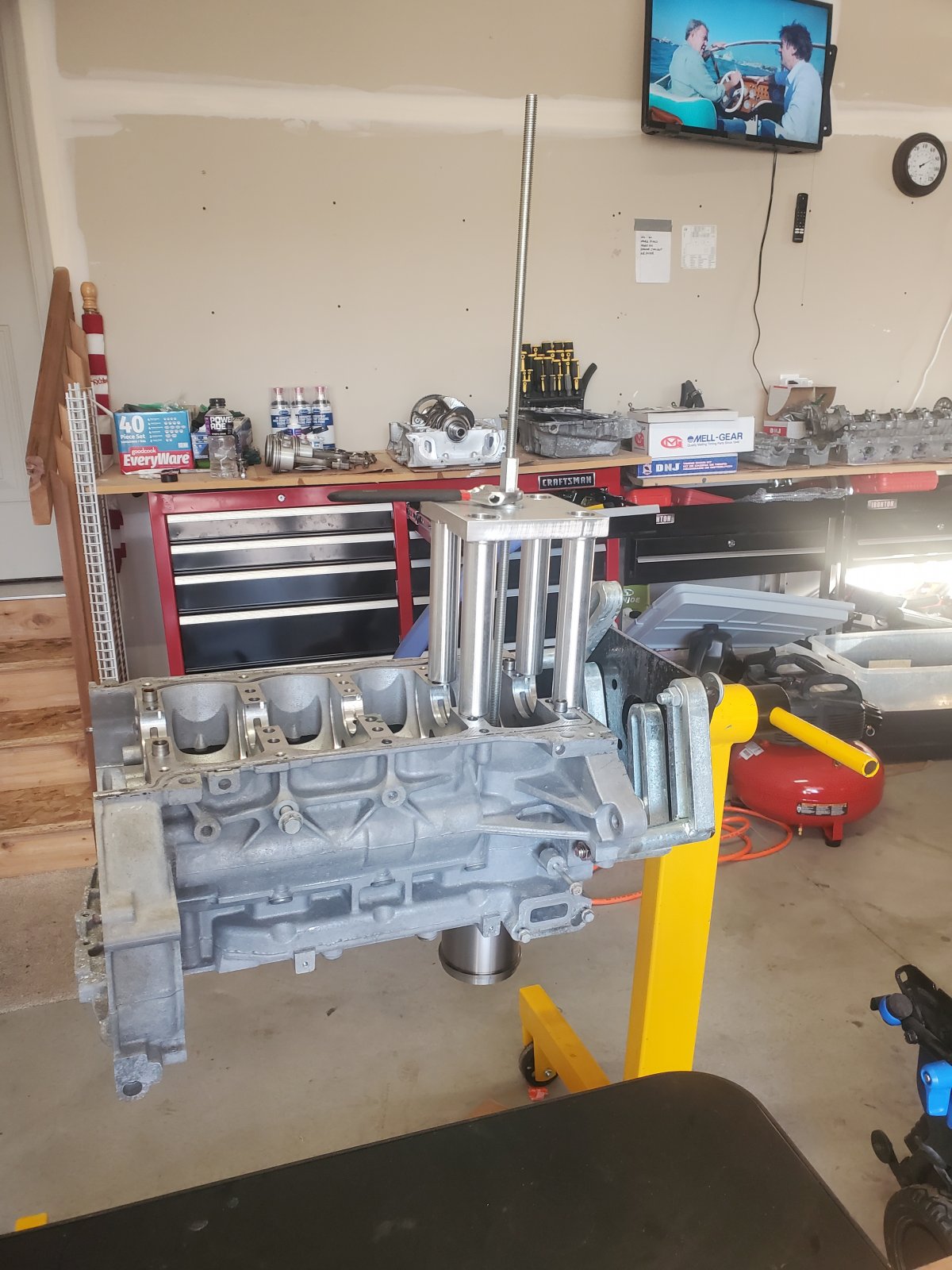

Oh, I also resleeved my block. I have the Kent Moore tool with some custom parts for the 2.0 cylinders if anyone is interested in buying it.
