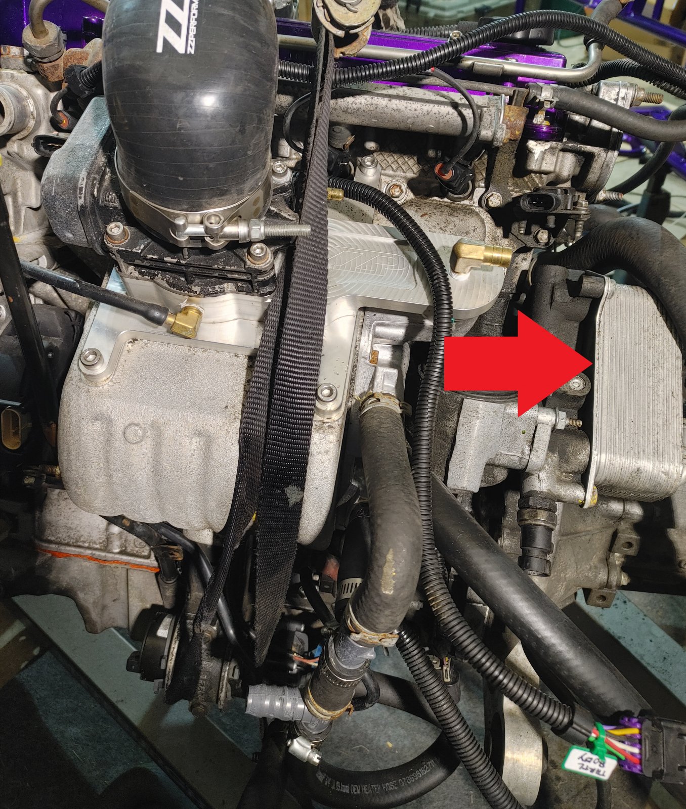

I see some "finned" things hanging on the block. Is this the factory oil cooler?
Yes, that is the factory oil cooler on the driver side in front of the thermostat housing:
