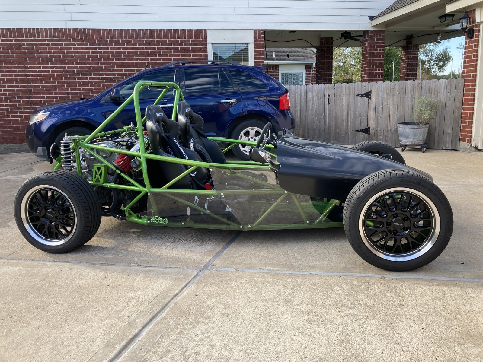

not clear but I am using smoked lexan inserts in the sides

They have been modified a bit from these, but gives you an idea of the shape and mounting that I did. I attached them with a mix of welded tabs and rivnuts into the tubing. Let me know if you need more info.

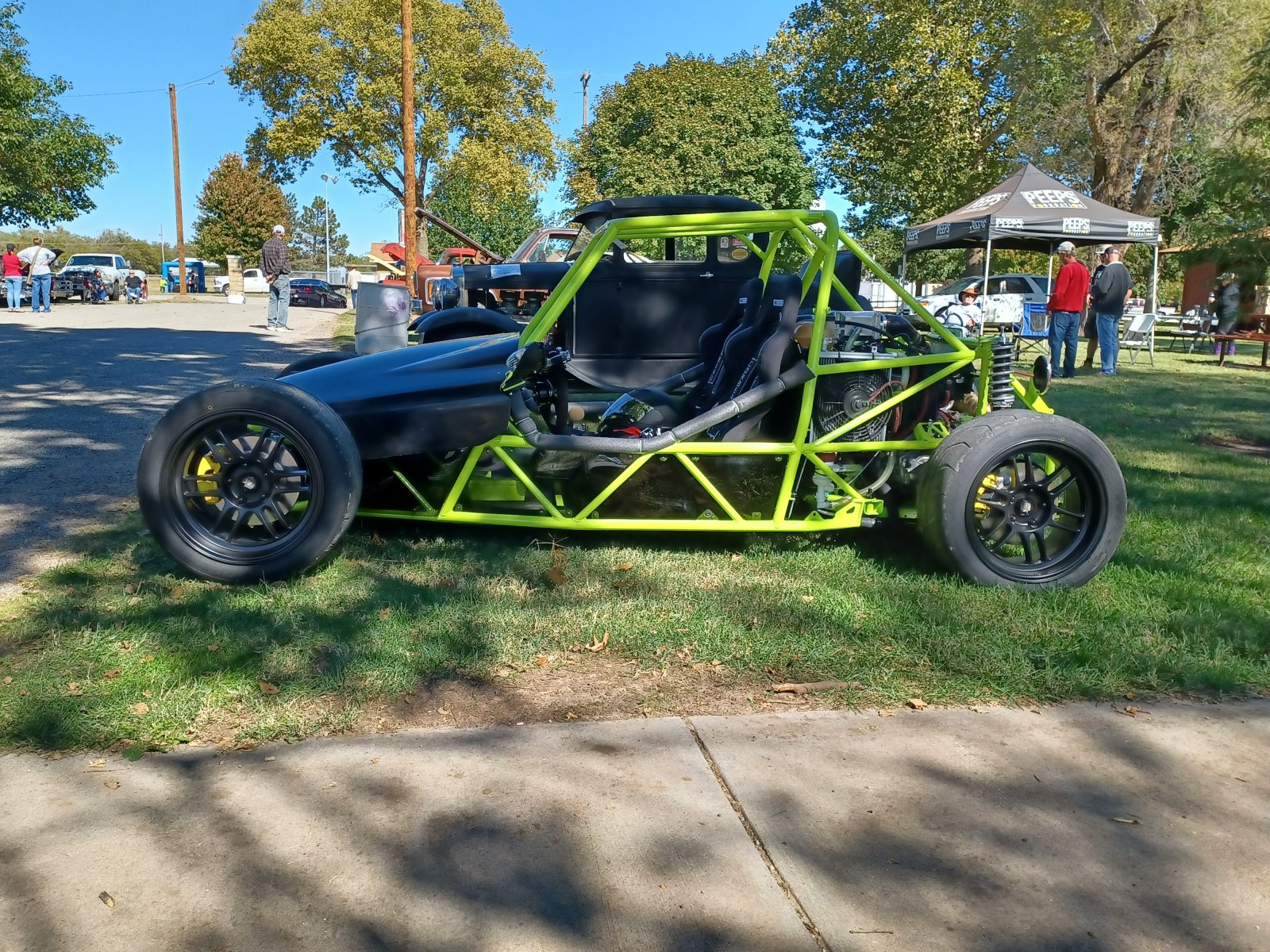

Does Lonny's Octoberfest builder Goblin look like it has see through side panels? You can see the DF logo on the drivers side in the picture he posted. Guess I need to ask Lonny - ??

I tried using it for mine, but found it to be expensive and difficult to thermoform. I ended up using a pvc plastic ceiling tile material from Lowes that was way cheaper also easier to heat/form into the shape I wanted. Highly recommended if you plan to wrap it.
