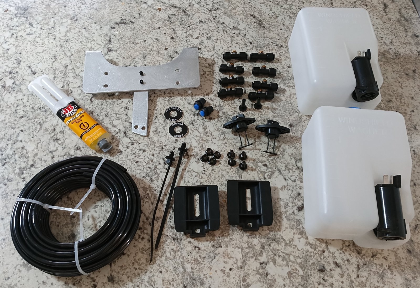

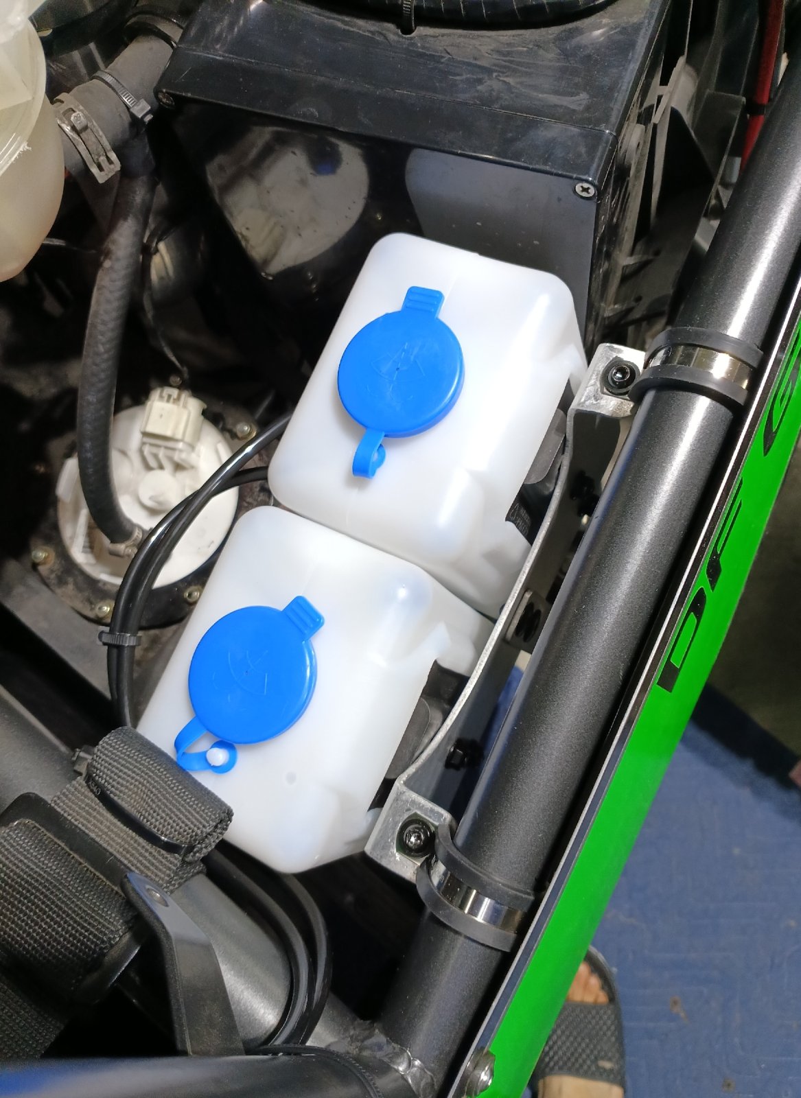

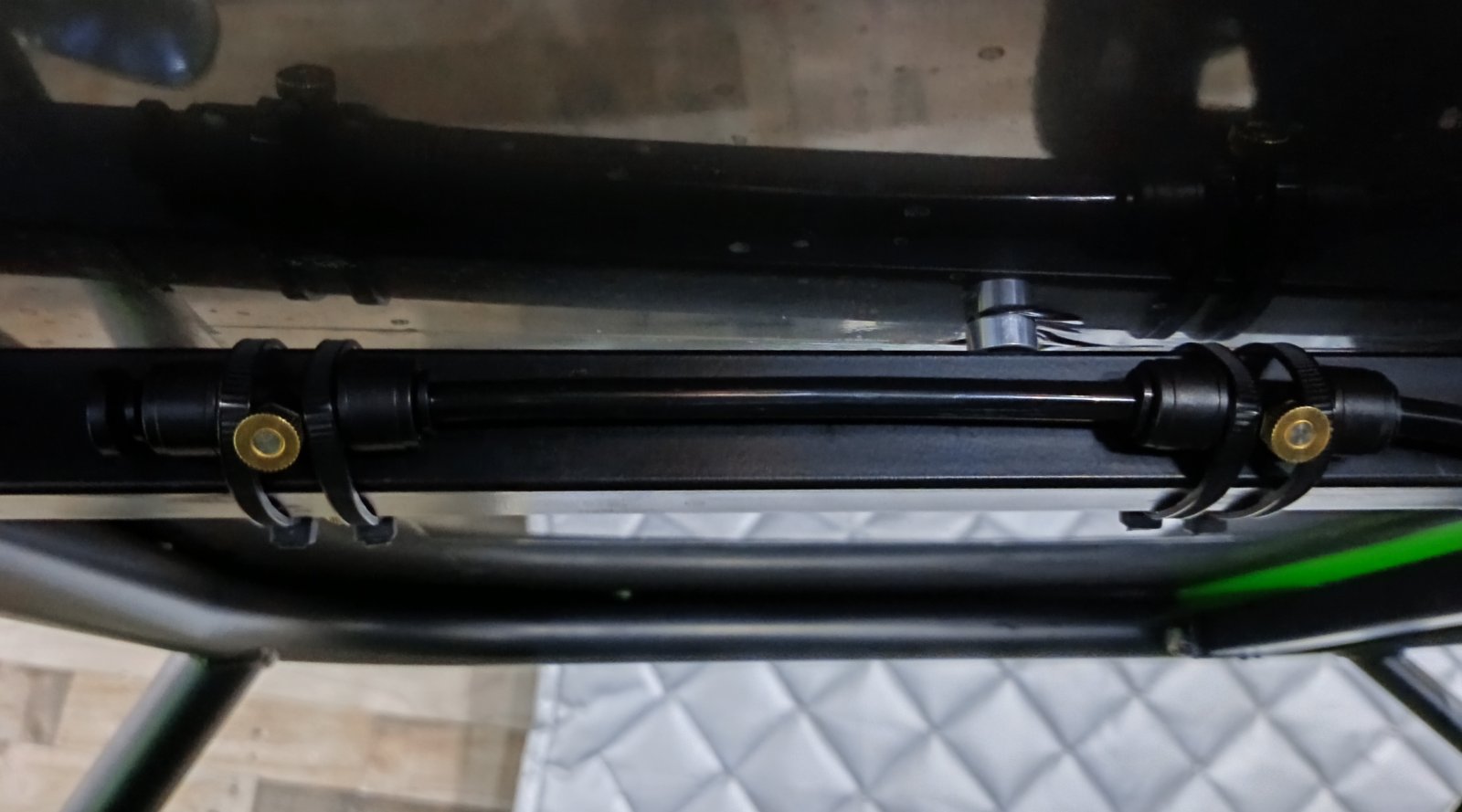

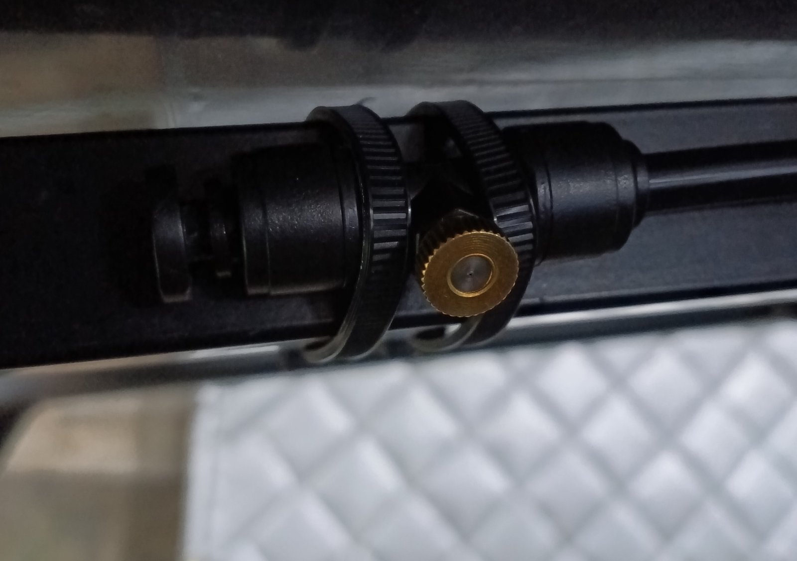

I made up these misters for driver/passenger using some washer fluid tanks and mist nozzle kit. Being in Denver HOT and DRY this works great, especially at red lights. aluminum bracket out of some scrap aluminum. kayak drains with o-rings epoxy into the bottom of the tanks so I can drain them without removing.
