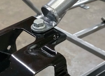

Is the top of the pedal assembly on top of the flange or below? I mistakenly had it above and had fitment problems.
36528
This is how it should be.

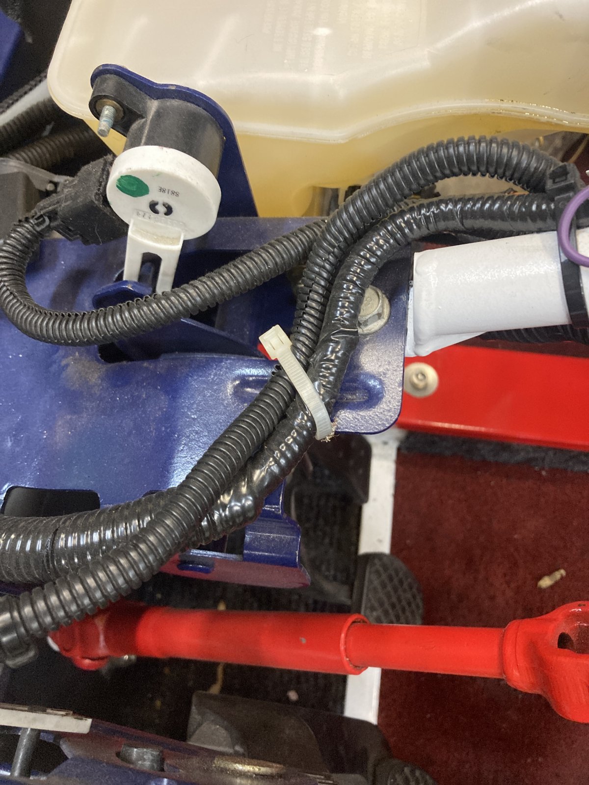

Looking at this thread, your pedals don’t look right. Gotta figure out why.

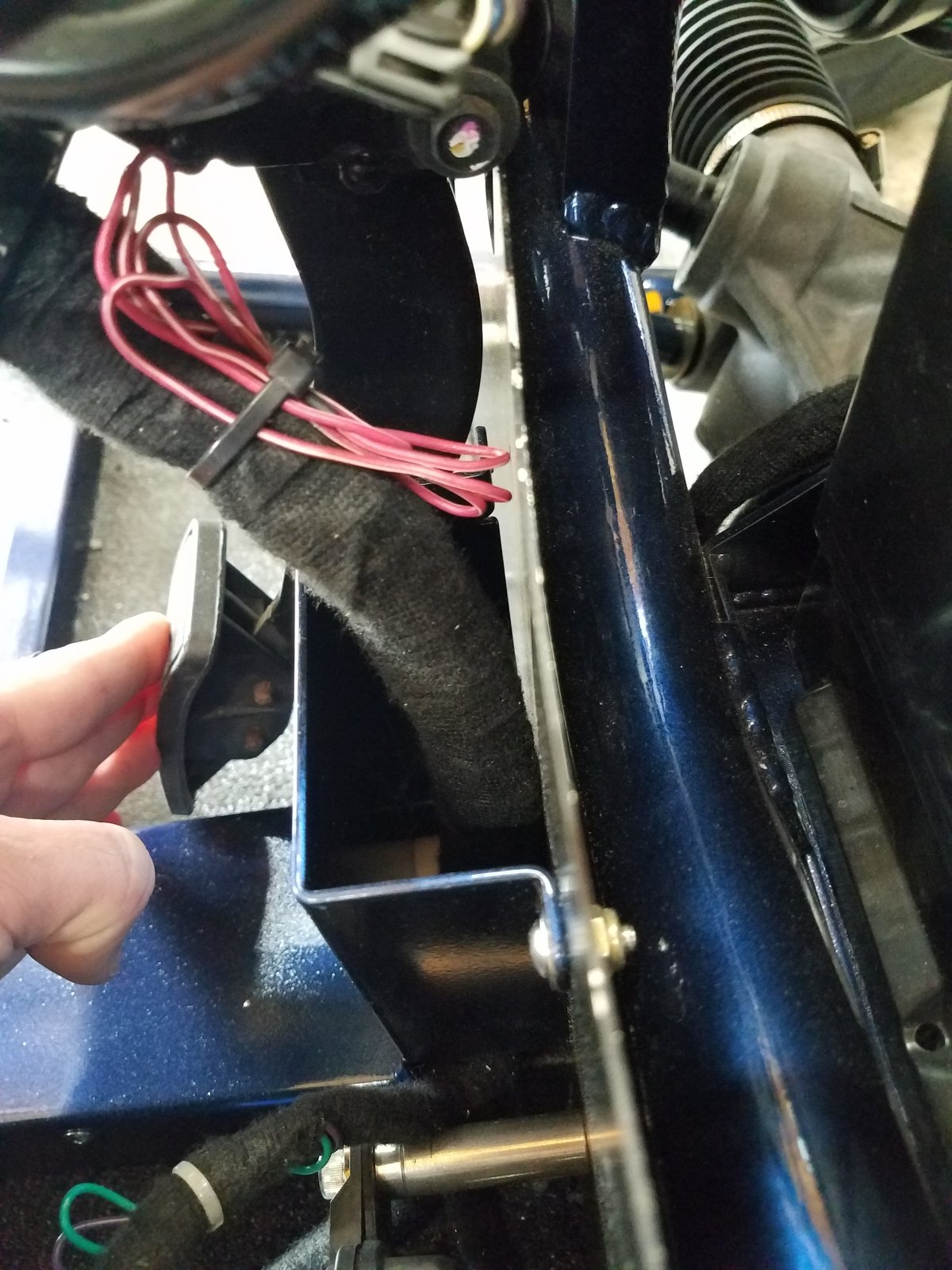

I have my footwell cover off this evening and it looks like I trimmed my bulkhead a little for the gas pedal. It also bottoms out on it but not before I get 100% on the pedal signal.
Sluggonaut
the lip is on top of the floor instead of under the floor,
I thought the last picture in post #5 above looked odd but couldn't put my finger on it. That bulkhead is going to be slightly higher with it sitting on top of the floor panel - not sure how much, but it will definitely move the bulkhead higher and could be just enough to cause the issues experienced so far.
