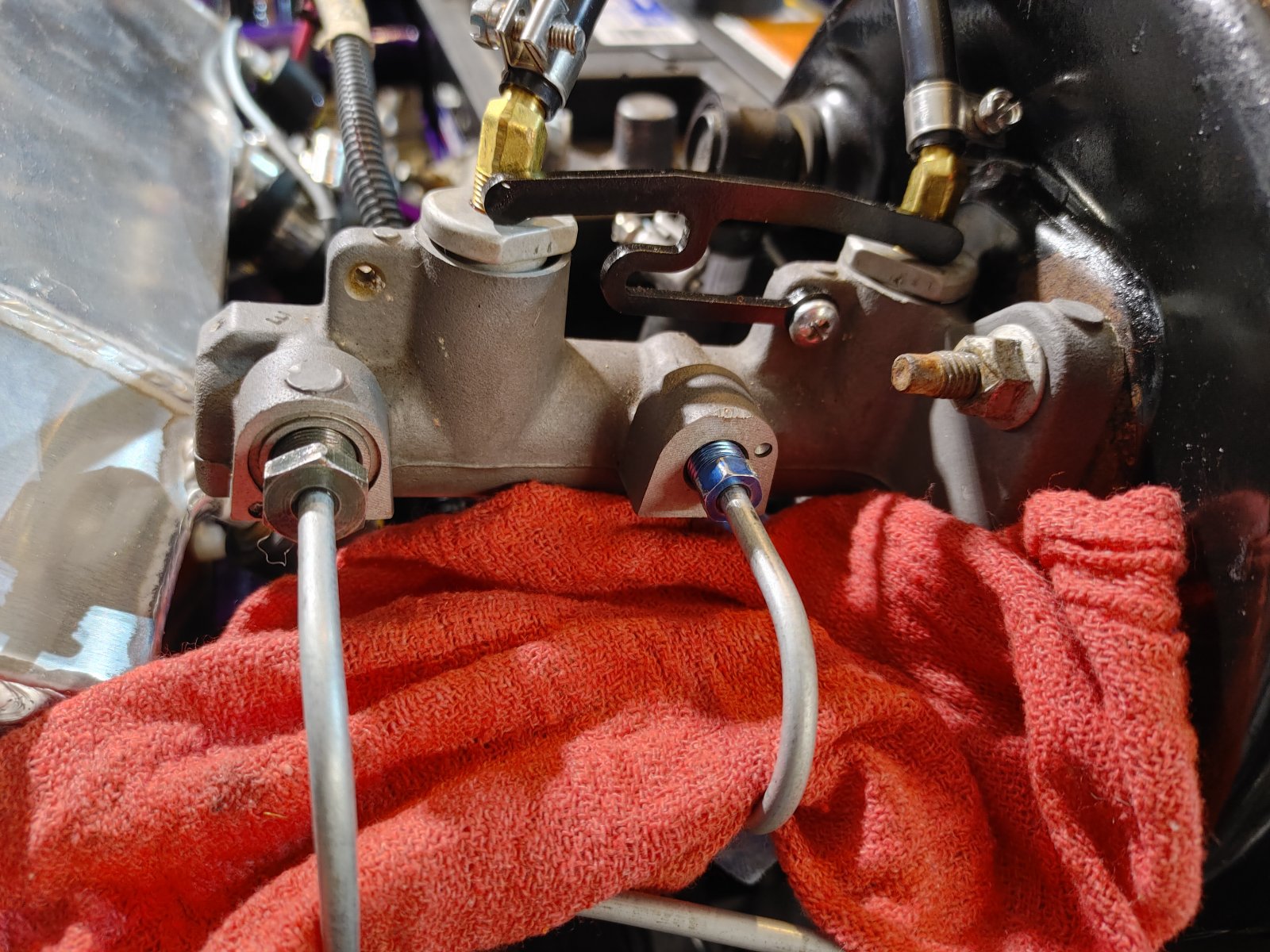

I have the early model brakes, so I used the photo album and asked about the coat hanger-shaped spring clip to ensure I installed it correctly.

Coat hanger piece installed on my 2007 SS early model brakes:

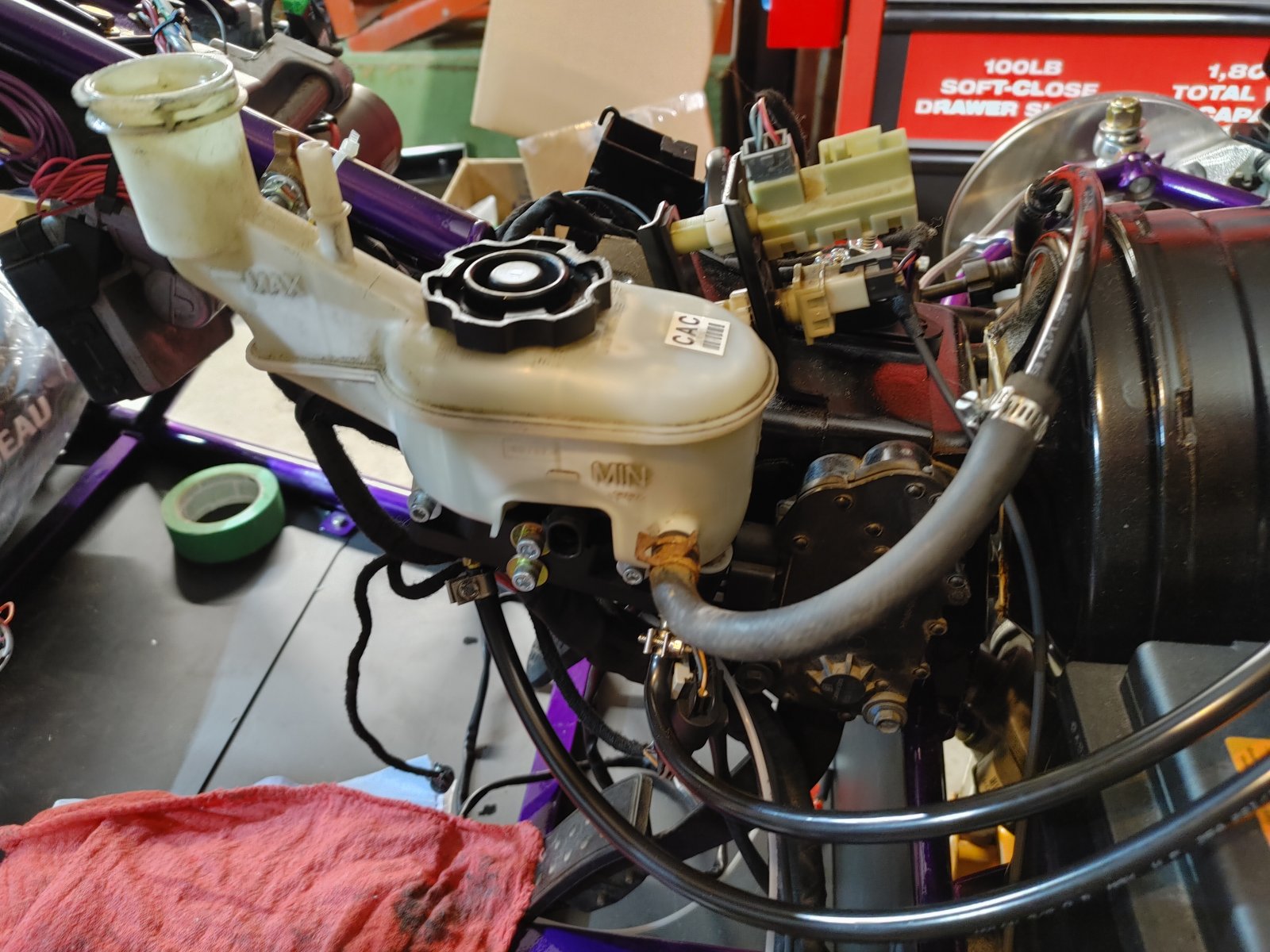

Reservoir relocation - bolt/washer on the outside and space between the block and pedal box IIRC:
