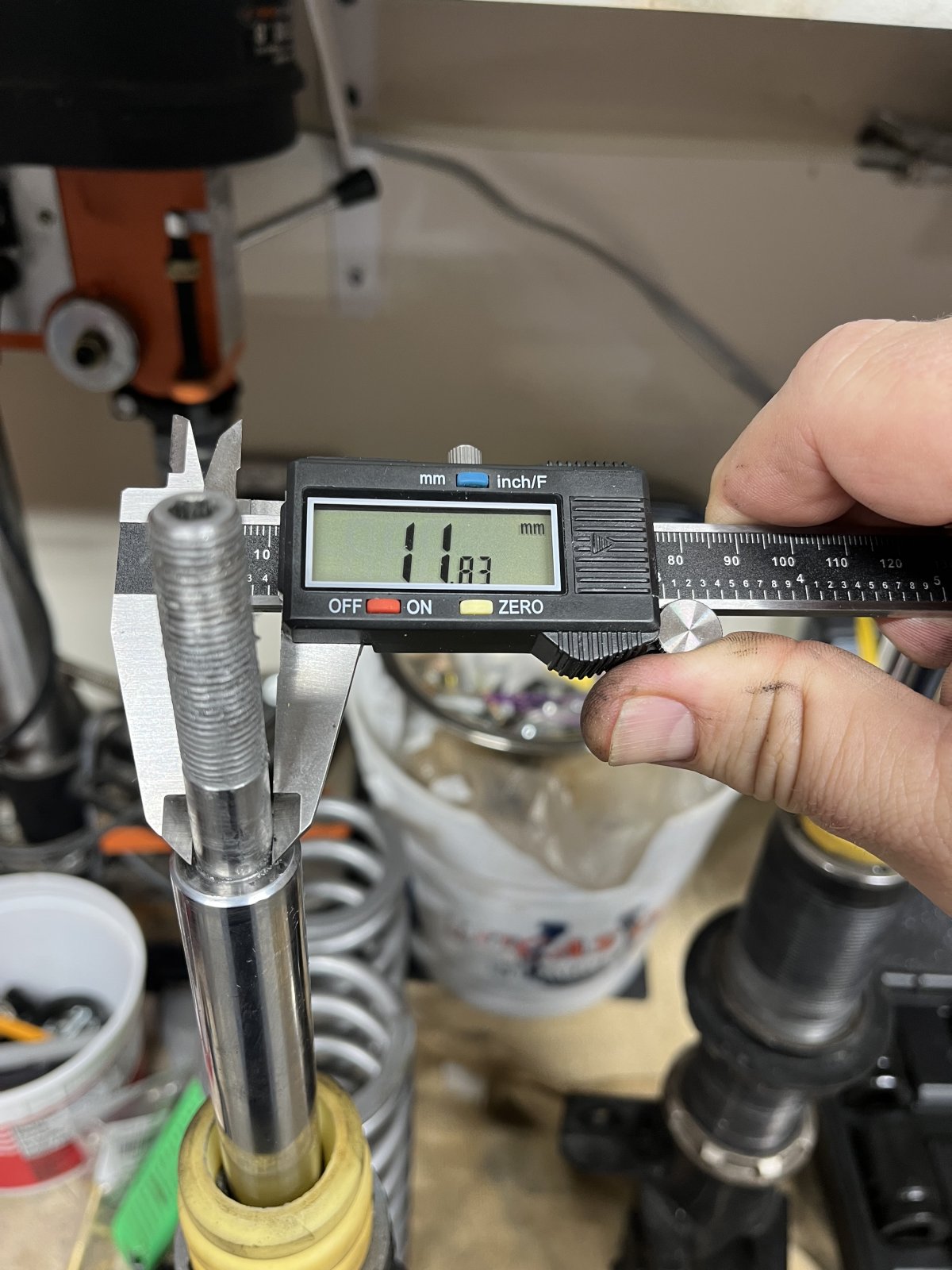

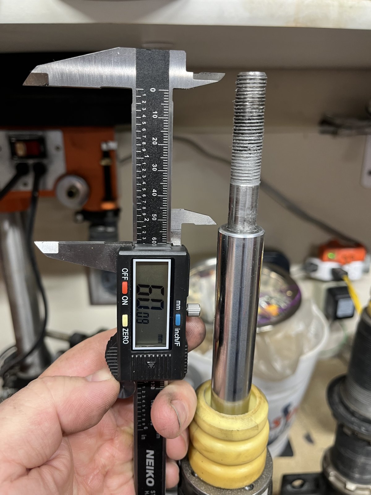

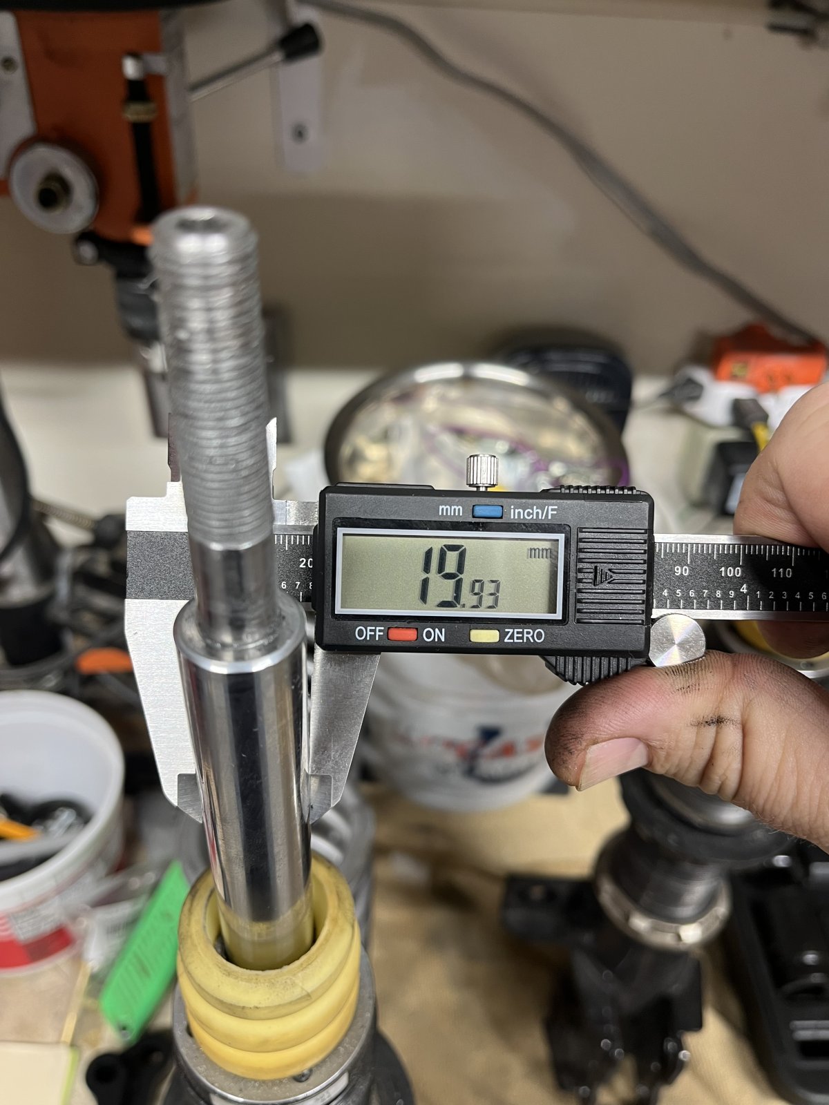

Hi All,
I'm working on designing some spherical mounts on our rear suspension for a group buy. Can someone do me a huge favor, and verify these dimensions off their BC coilover damper shaft? The differences are pretty minor between the Konis that I'm running and BC, but I'd like to make a mock BC damper just to make sure I'm covering all my bases. I have BC body dimensions, but I don't have the damper shaft dimensions. I'll need the following off a BC coilover:
- Threaded diameter A: I believe this is 12mm?
- Damper shaft diameter B: I believe this is 20mm?
- Threaded shaft length C: don't worry about the threaded/unthreaded lengths, I just need the overall length
- Shaft length D: I believe this is 130mm?
