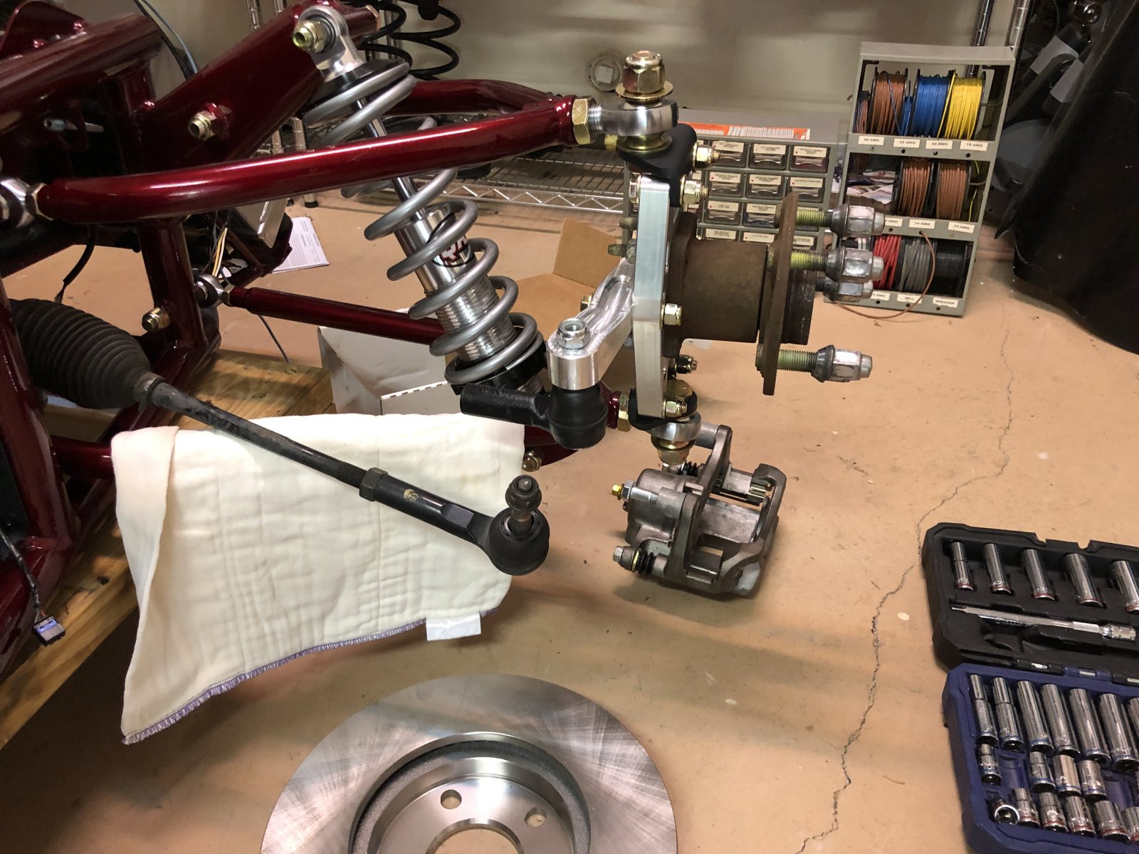

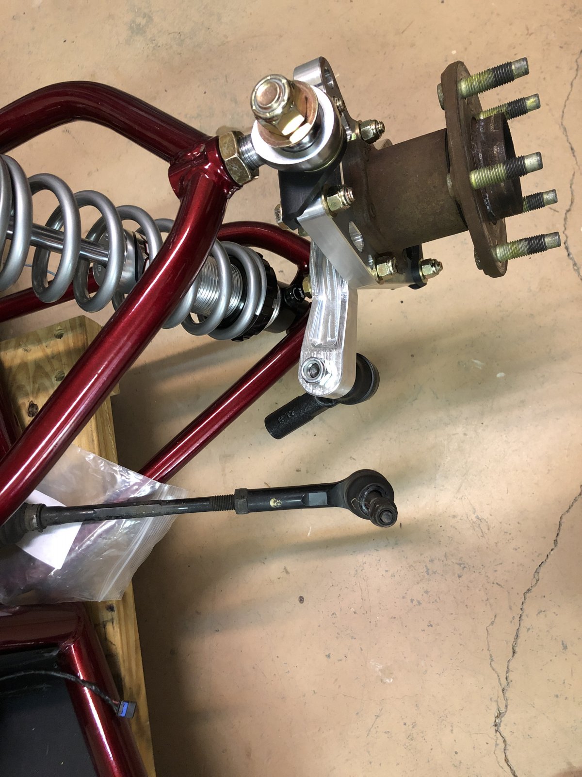

Just to be clear before I do this....
The small tie rod end (DF supplies) goes on the front and I’m supposed to remove the larger and move to the back? Any advice on removing the tie rod end?

You might try a lot of heat (not melting temp) on the aluminum to get it to expand and let go. Also hitting the outside aluminum with a dead blow will help to pop it loose but don’t hit too hard and damage the pretty CNC job. Pickle forks also work but I don’t care for them. Other wise a press can help them loose if it’s not in too tight.

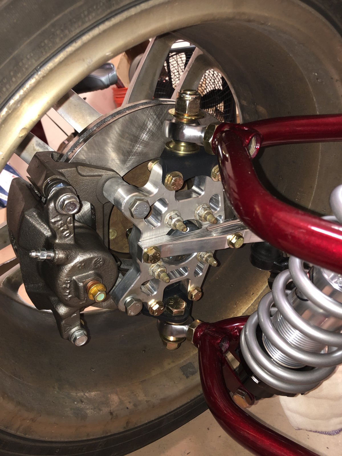

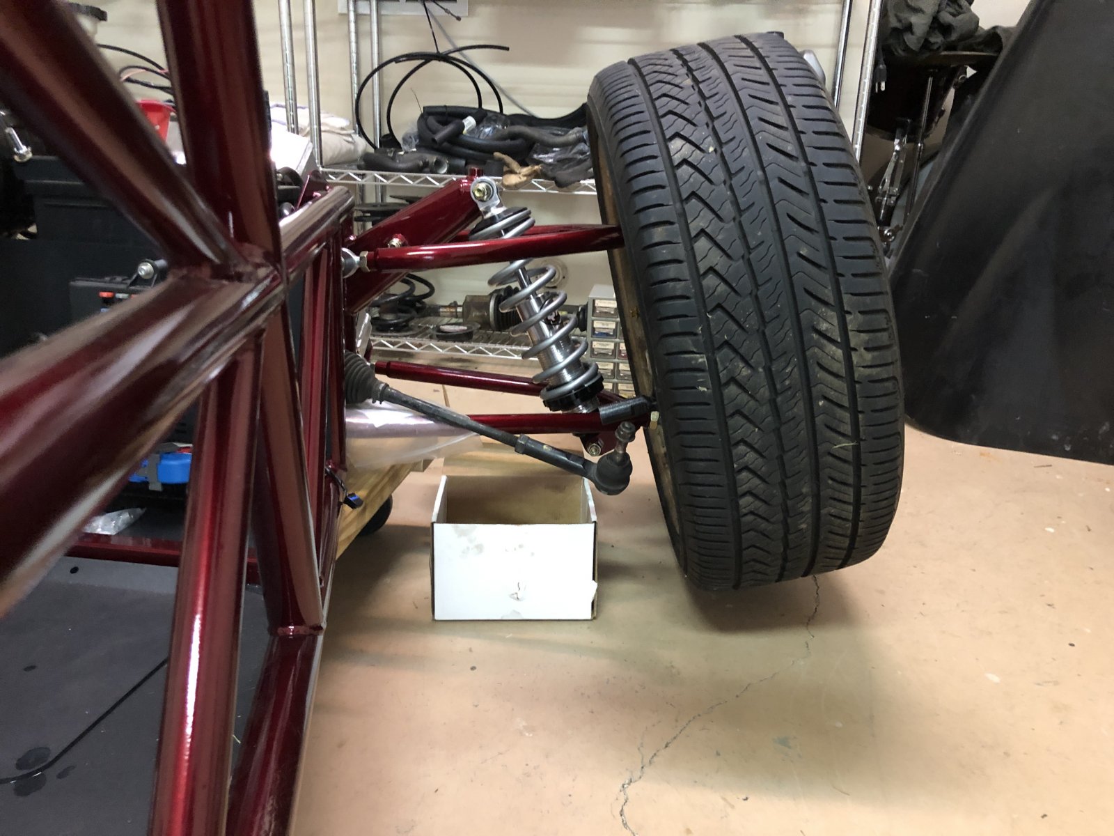

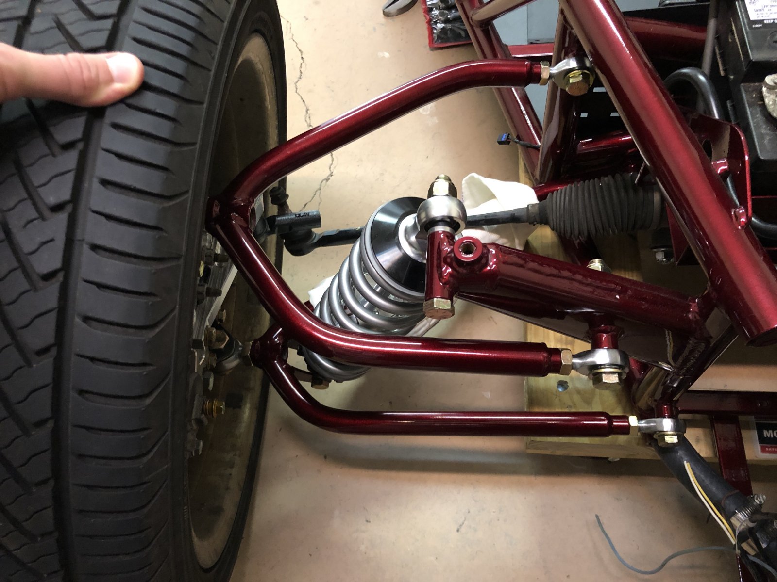

front wheels on!
are they supposed to have that level of camber when off the ground?
what brake pads did y'all order for the supplied calipers?

To remove the outer tie rod end from steering rack assembly, use a lot of heat. Get the jam nut orange, then use a pair of wrenches to loosen the jam nut then remove the tie rod end.

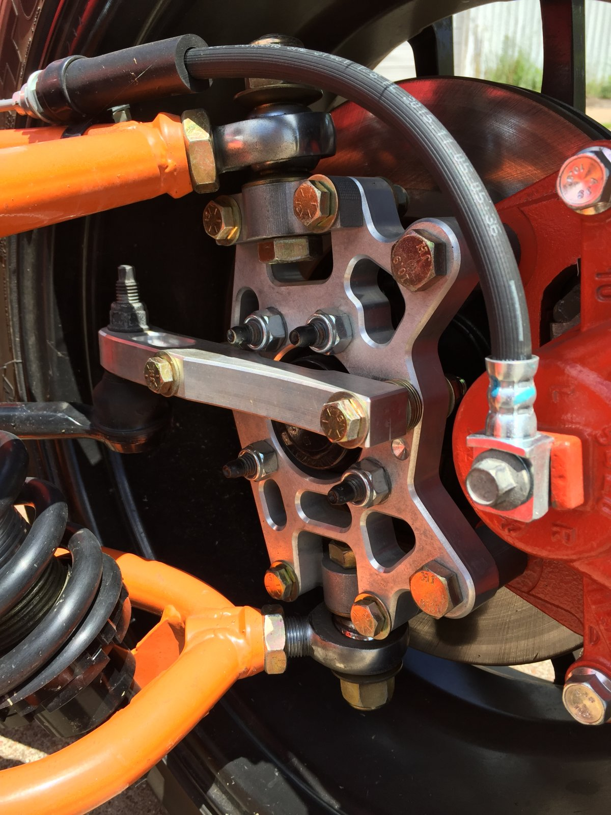

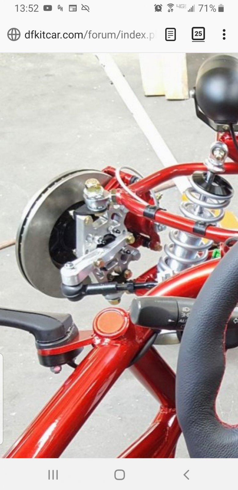

k.rollin
you're saying one of the control arms is flipped? i thought they both were supposed to have the single bend in the front, right?
The steel bits bolted to the front suspension uprights. The two hole flange is supposed to be on the outboard side of the upright at the top and on the inboard side at the bottom.

Got the front tie rods off very easily with some Liquid Wrench Penetrating Oil.

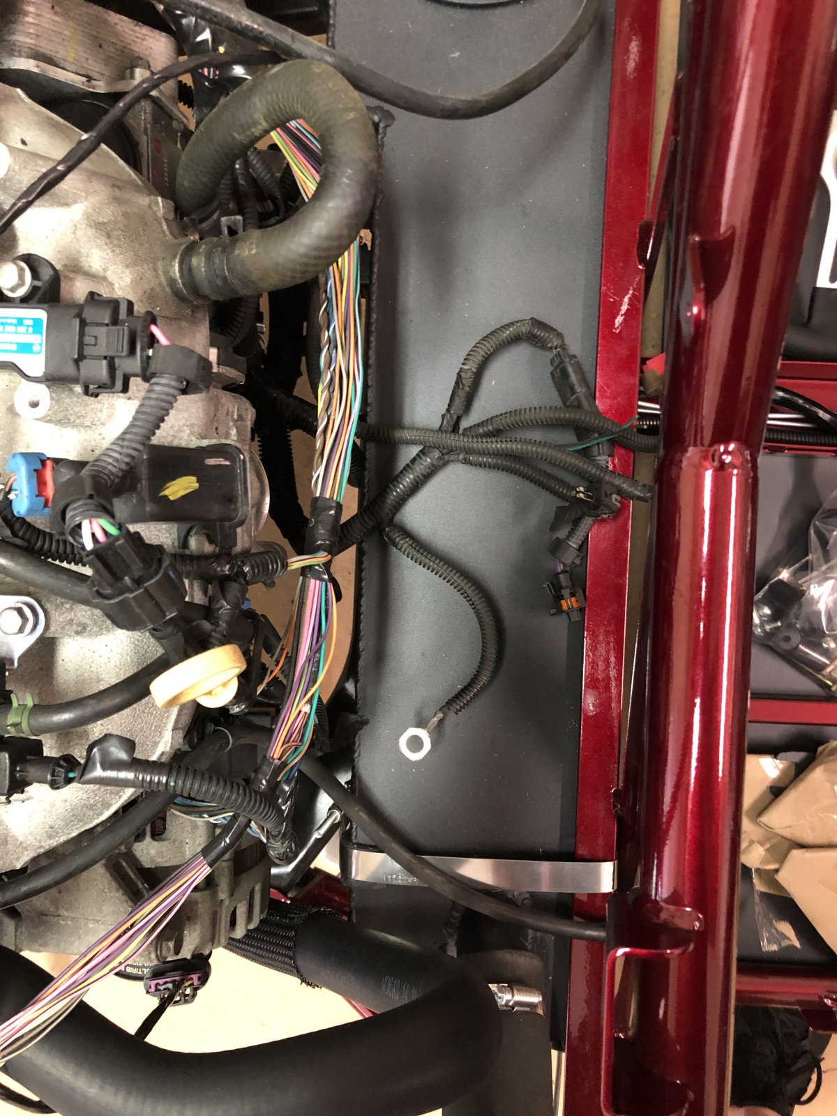

So, needing to make sure all my grounds are good (and will be checking the fuses) because I can’t get the engine to crank. Having the same security light pattern that Tony’s City 2010 TC was having.
Is this a ground wire?
