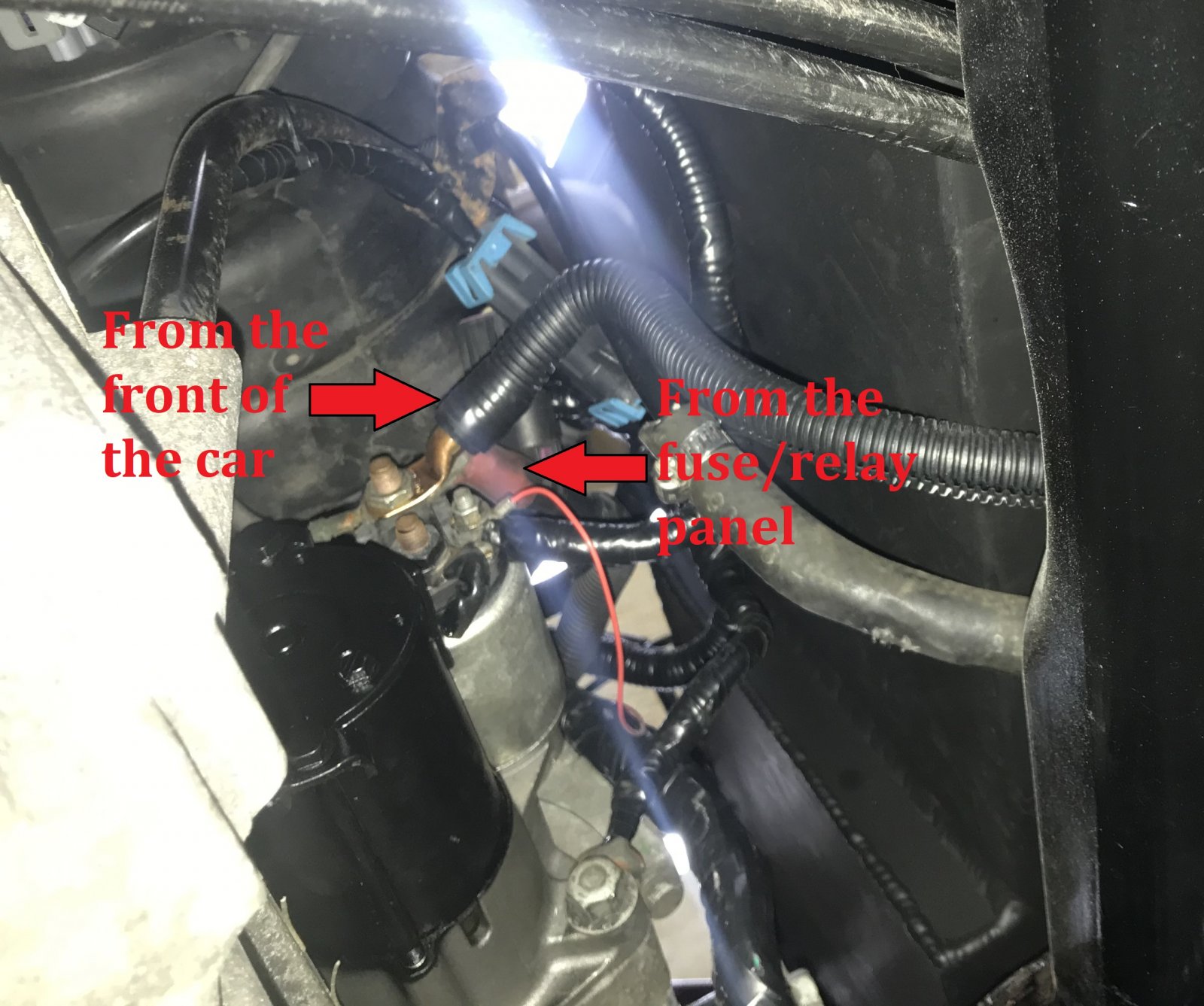

I have partial power! There is a very small connector on the ignition switch that I missed. Now the dashboard lights up! However when I turn the key all the way the starter does not turn. Progress!
CaptFrank2001
Reading what you have said. The cable running from the front of the car DOES NOT connect like you have shown in the first picture. In other words it DOES NOT connect to the fuse/relay box. That cable connects directly to the large post on the starter solenoid. A separate cable (about 4 feet long) goes from that point on the fuse/relay panel to the same post on the starter solenoid.

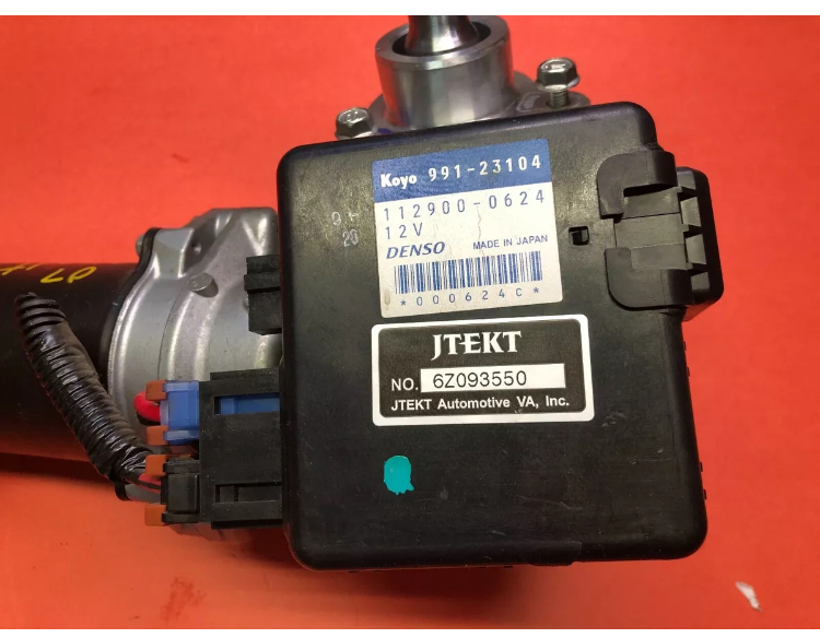

Awesome. Now hookup your power steering too get rid of another problem. The high speed data runs in and out of the power steering.

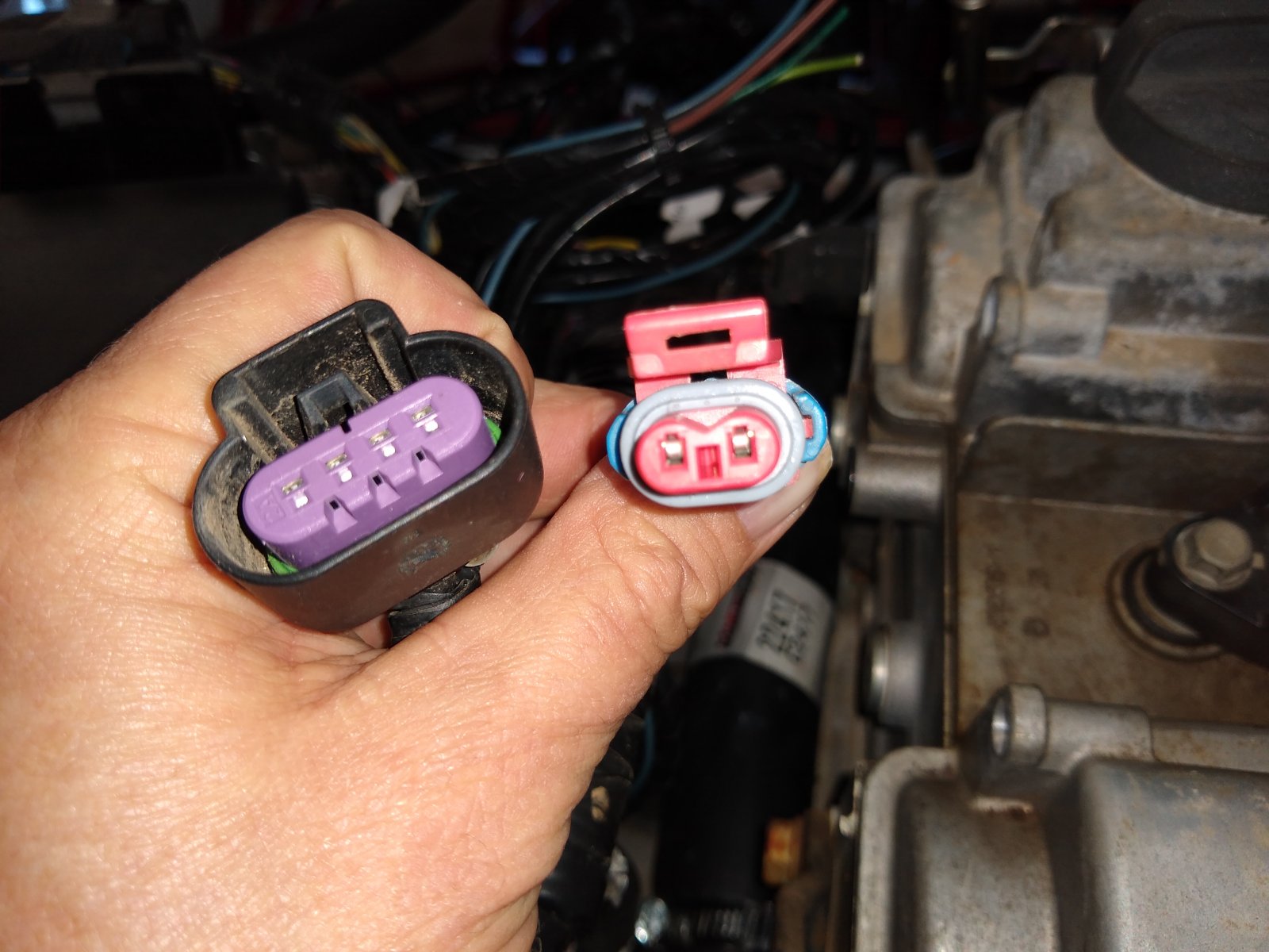

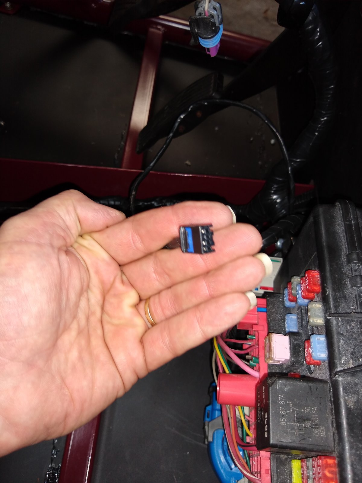

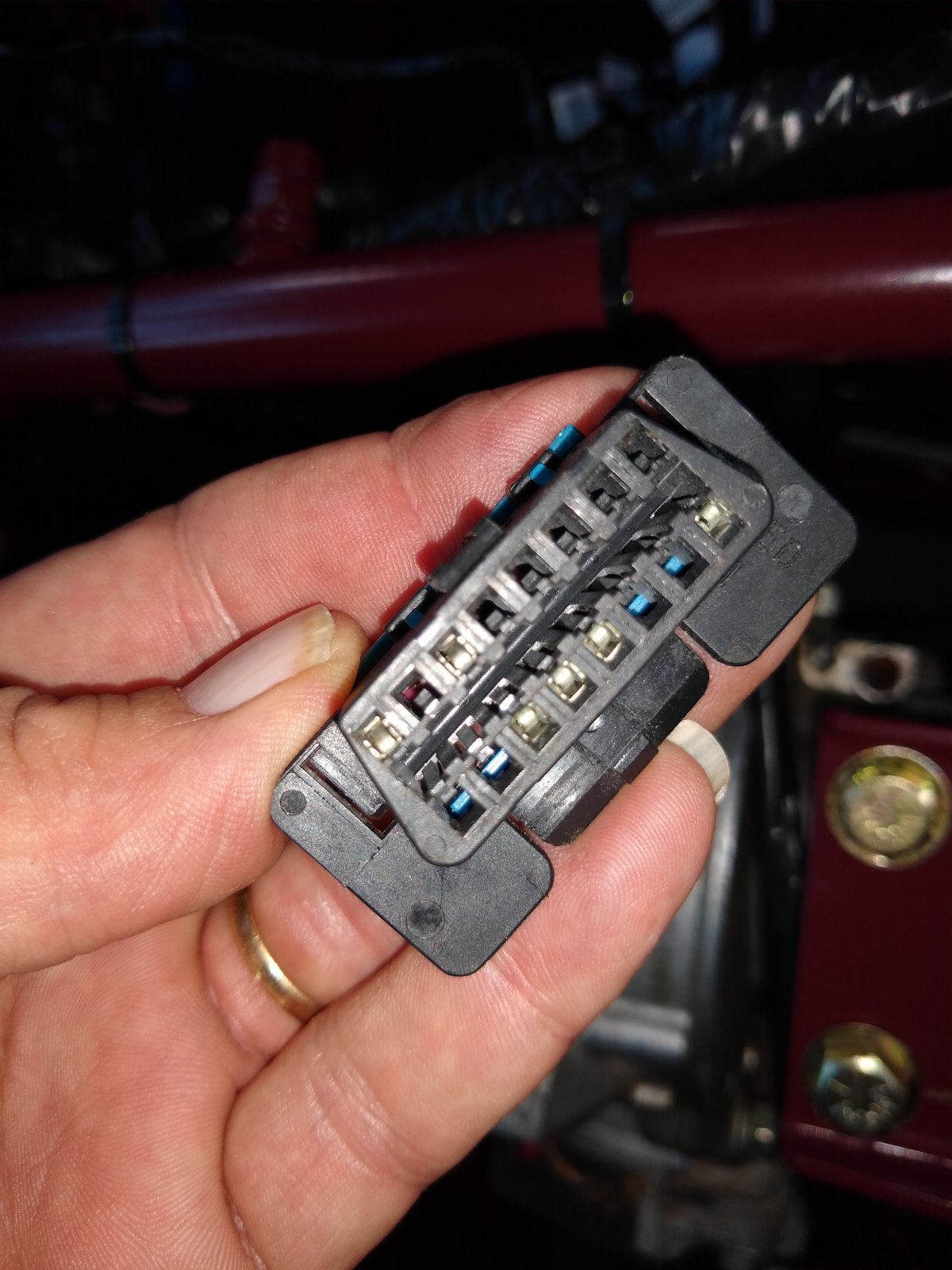

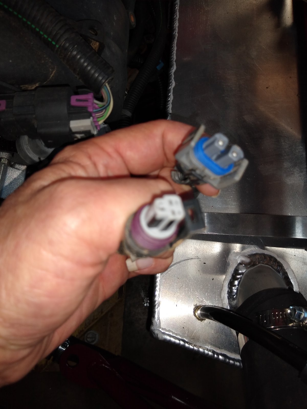

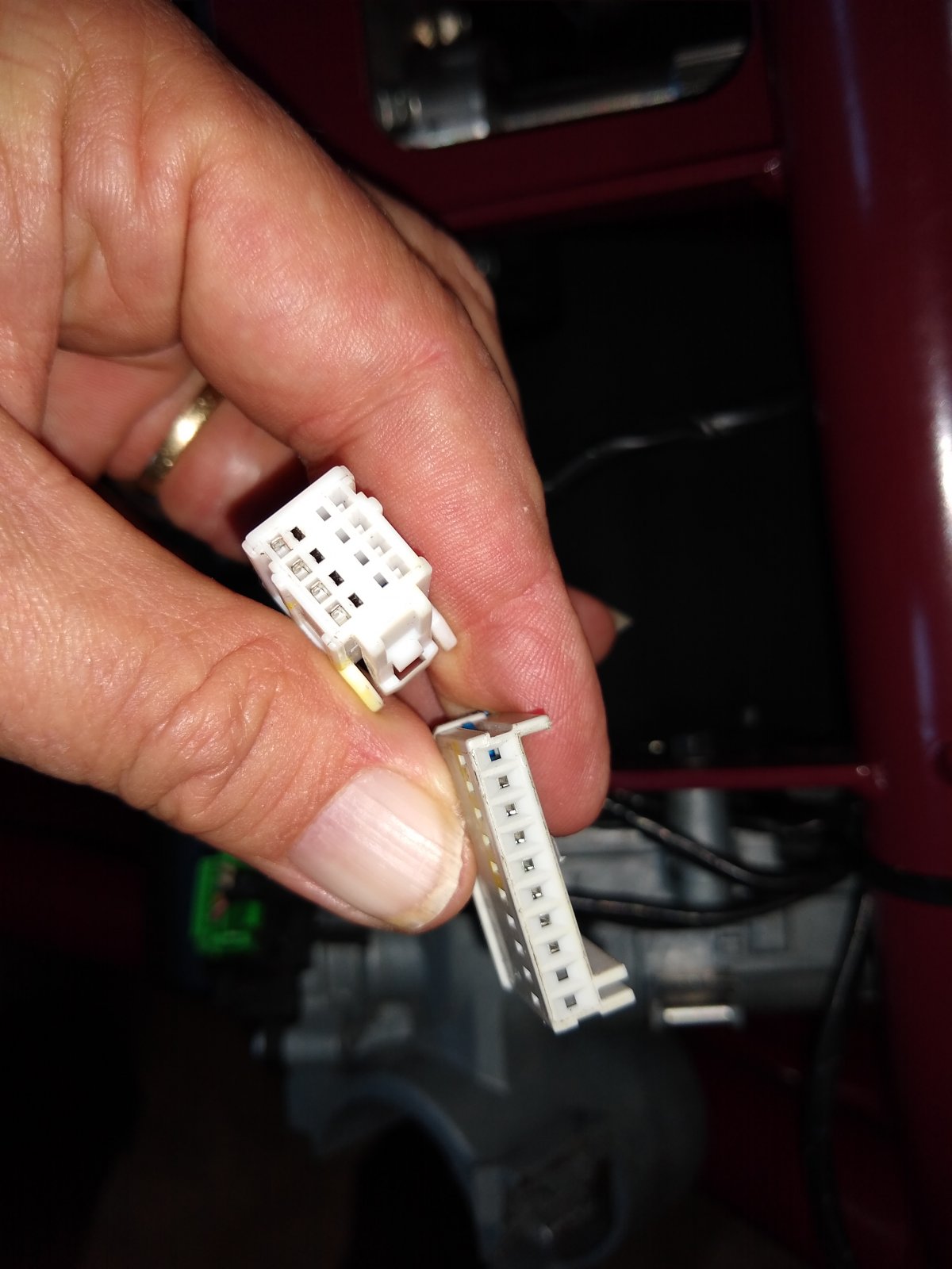

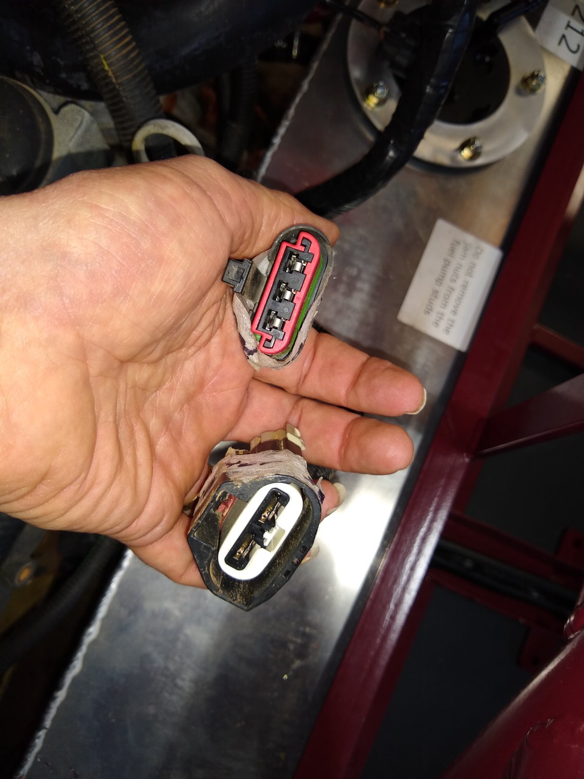

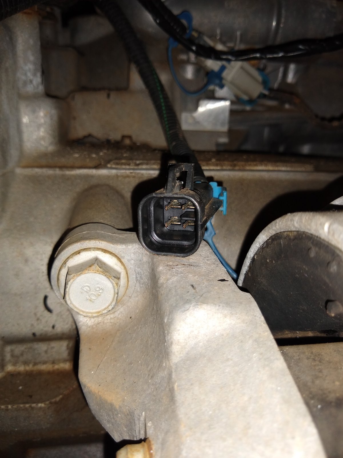

I can get the key out now, but I still can't turn it off. I found a connector that goes to the throttle sensor and plugged it in. I have what seems like dozens of connectors that I can't find where they go!

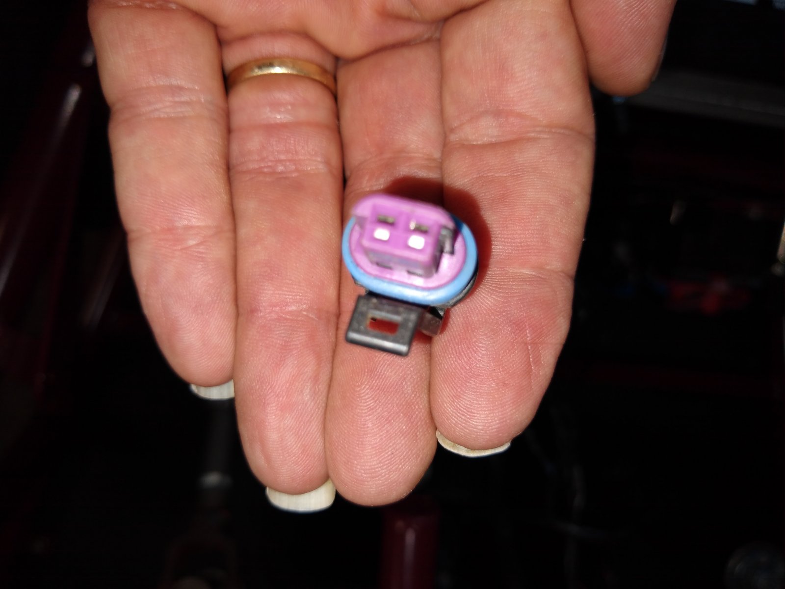

Take pictures of the unplugged connectors, and tell us (or picture) what the plug before and/or after it is.

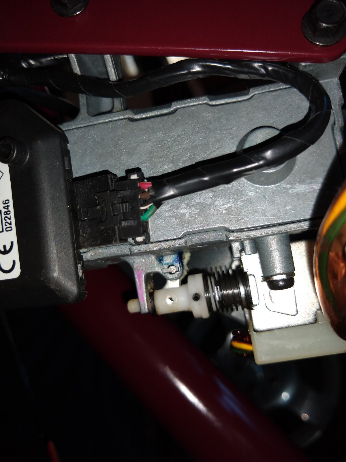

1. Two coming out of harness near ignition switch and power steering.
2. Out of harness behind dash.

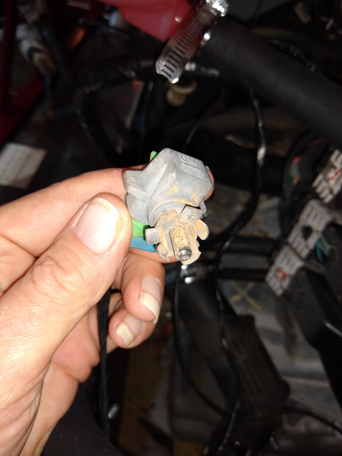

3. Out of harness tied in with throttle sensor.

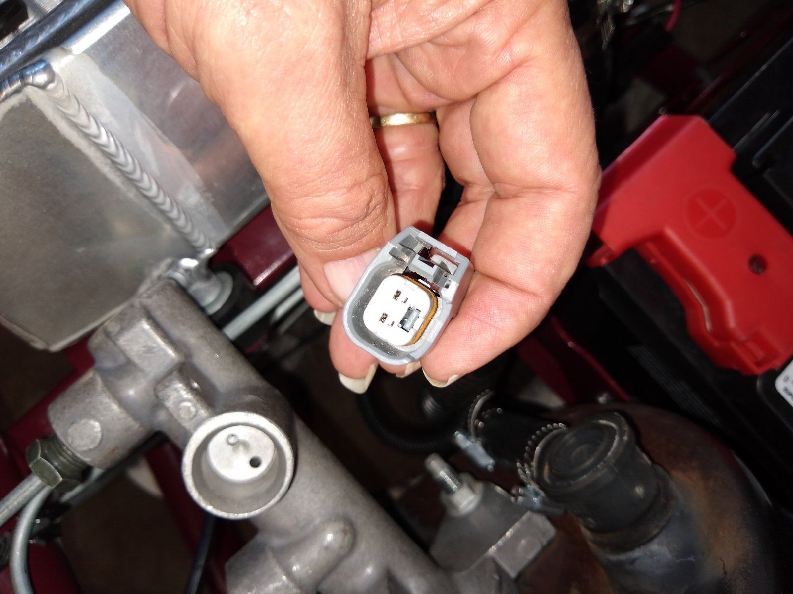

4. Out of harness near BCM.
5. Out of harness behind radiator near brake booster.
6. Back of car. Red is labeled radiator power and black is labeled radiator sensor.
7. Back of car tied into harness with fuel pump connector.
8. Two out of harness between engine and ECM.
9. This one is attached to the engine mount.

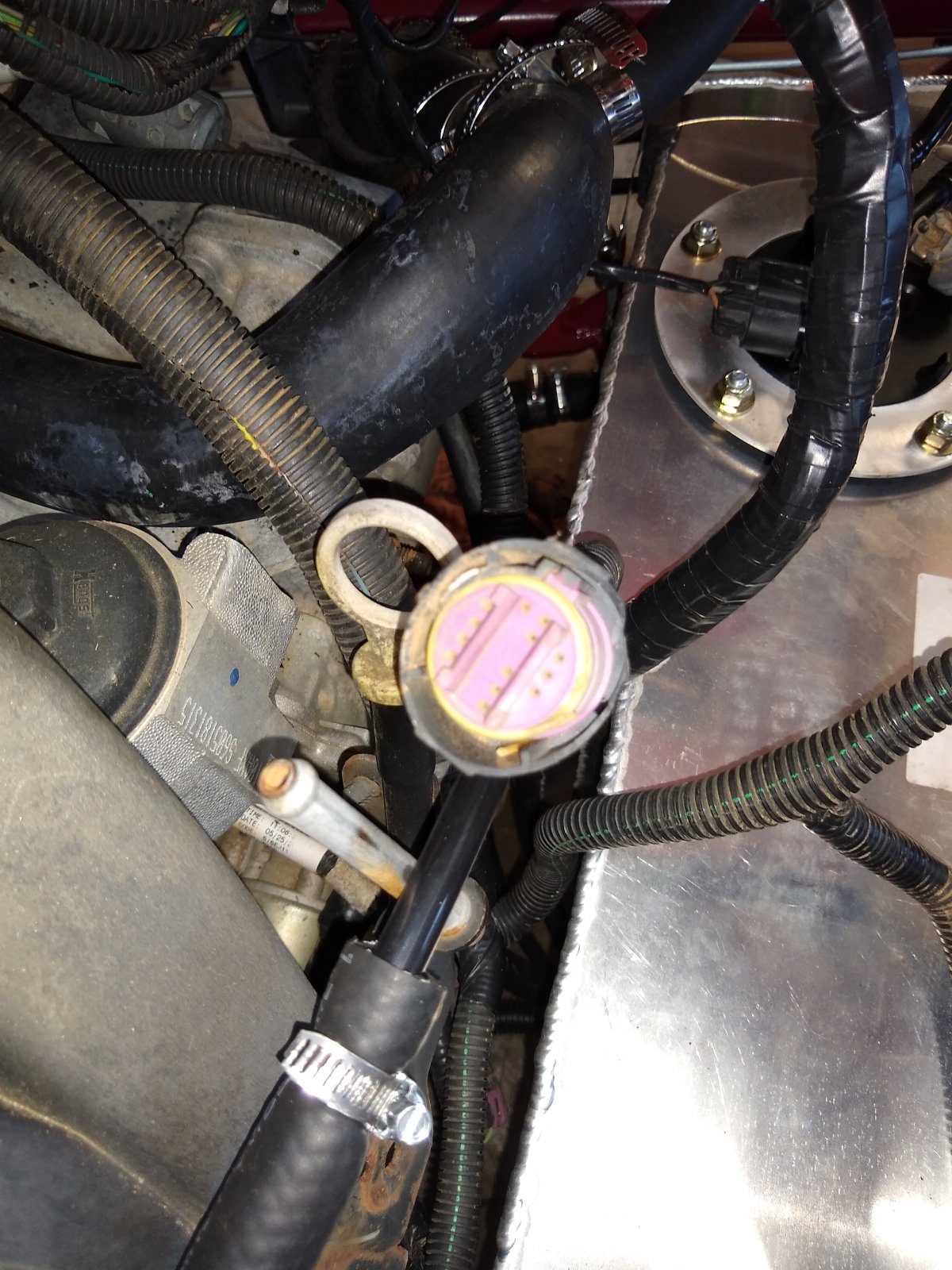

10. Out of harness between engine and fuel tank.
11. Out of harness between engine and fuel tank near #6.
The rest are labeled or I know where they go.

Goblin Graber
1 is for the turn signal switch
2 is the OBD2 port for diagnostics- nothing gets hooked to it
3 don’t know
4 I believe is for the ambient light sensor
5 should hook to the brake reservoir
6 went to the radiator and don’t get used now
7 ambient temp sensor. Clip that into one of the holes in the front of the subframe.
8 The purple one looks like a coil plug. The red one is the EVAP canister. Most likely won’t get hooked up
9. O2 sensor
10 & 11 Hmmmmm
1. also has the 10 pin single row connector that went to your clockspring - so your horn, cruise controls & audio controls on the steering wheel. Nothing that will stop the car from running if left unconnected.
