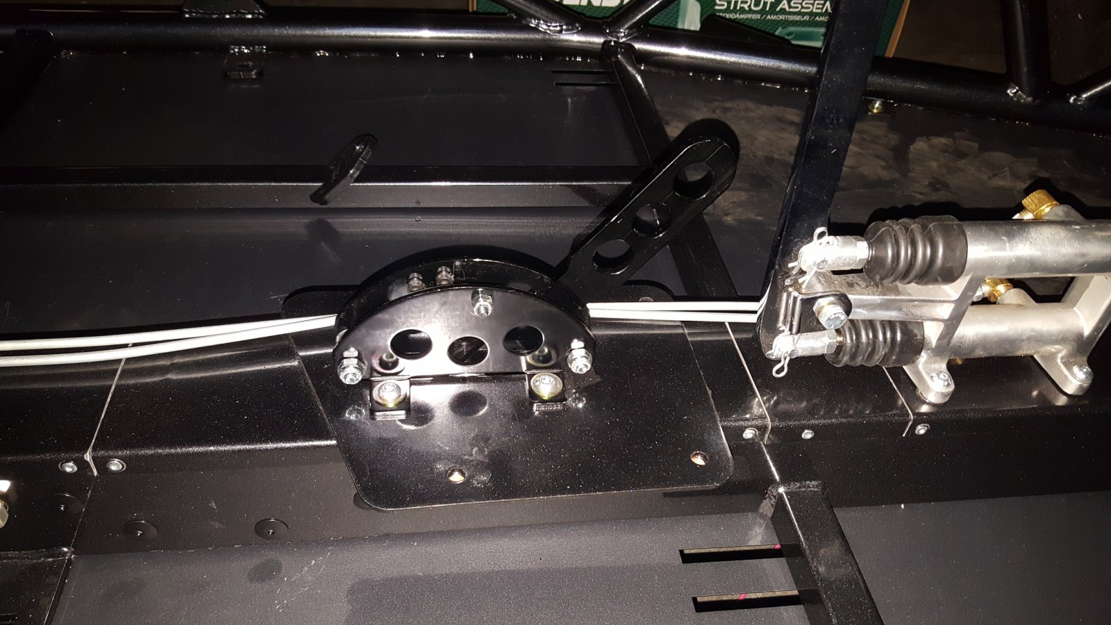

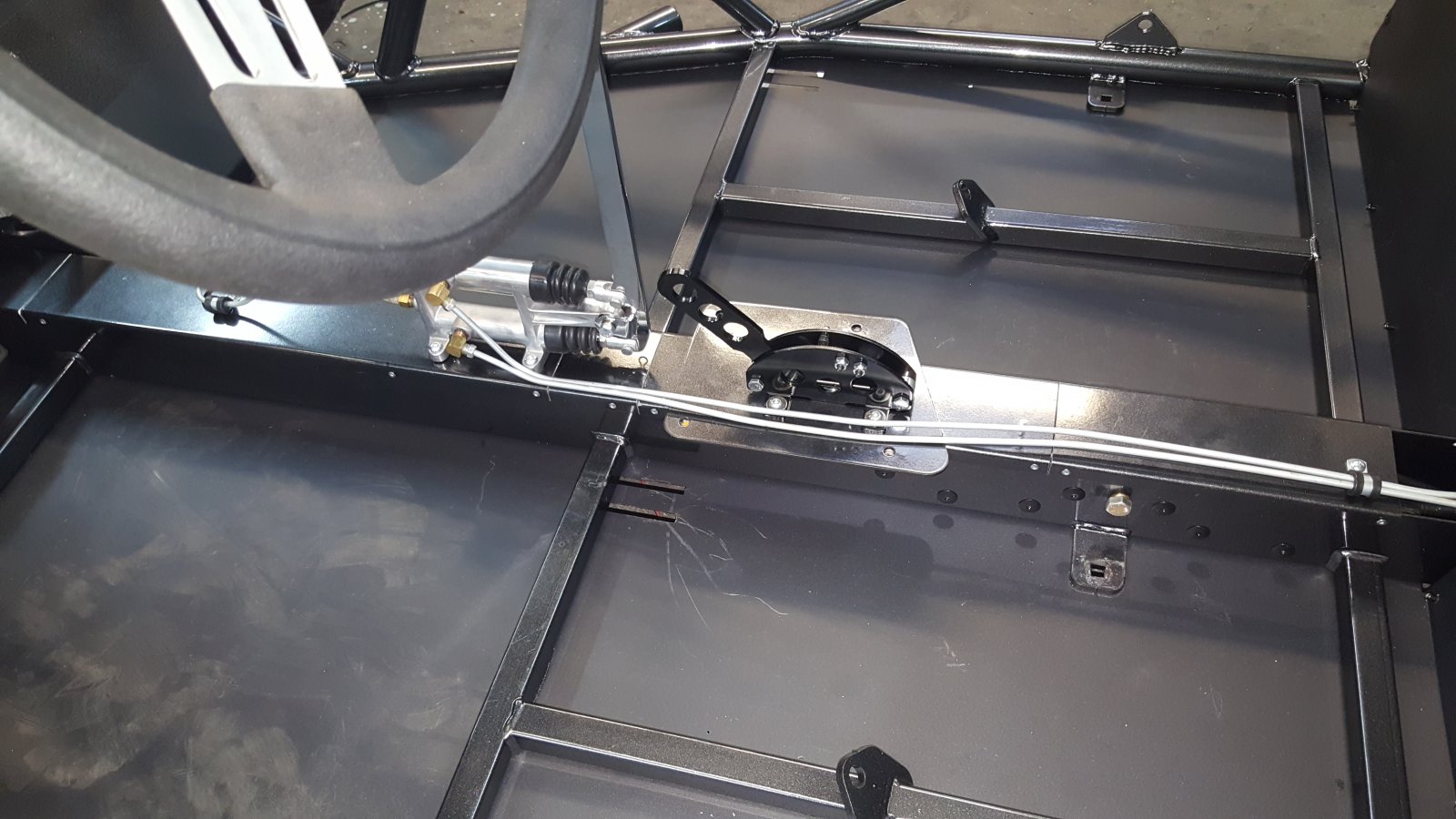

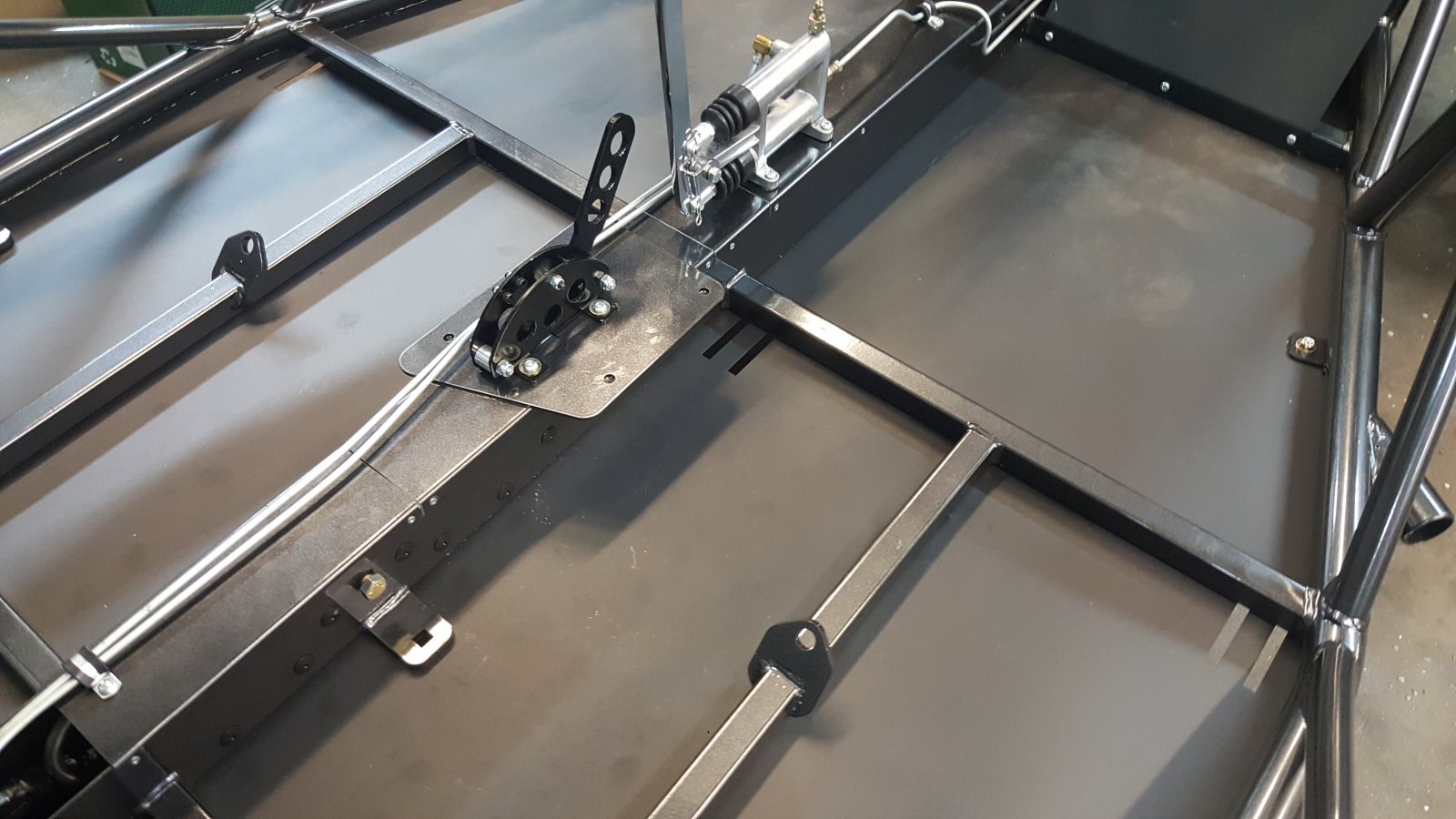

We are currently building an all terrain goblin that is an automatic. The OEM shifter interfered with the turning brake so we went with an aftermarket shifter that is used in dirt racing cars.
You will need to drill four holes in the tunnel cap to mount it.

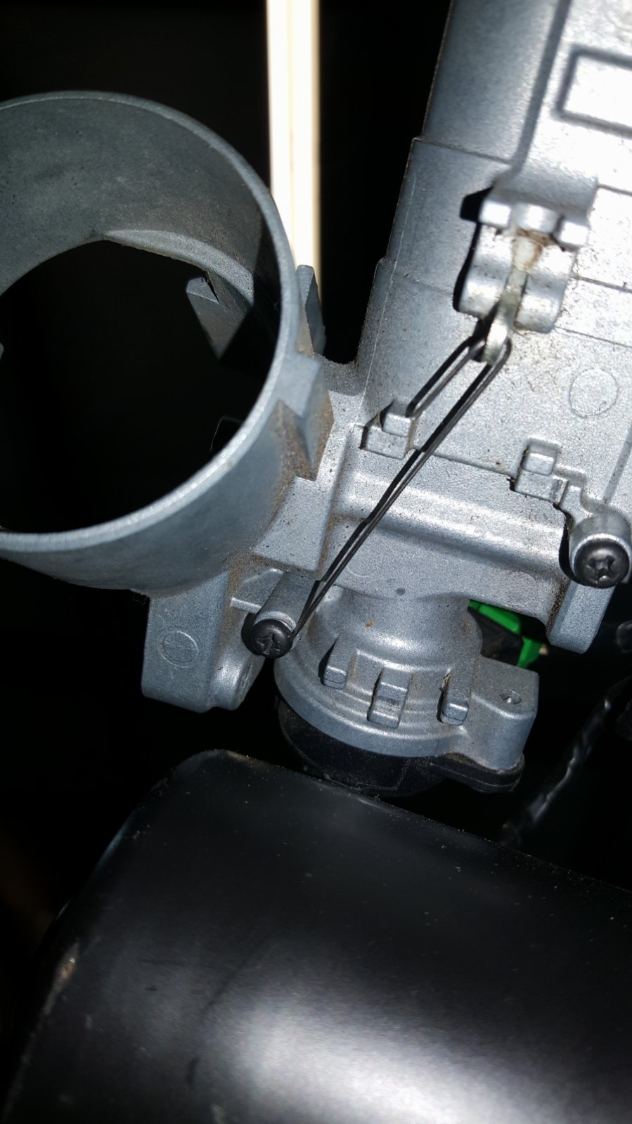

You can disable the key lock by removing the solenoid from the ignition switch (two phillip screws) and bend up a small paper clip to hold the small lever into the release position.
You will need to drill four holes in the tunnel cap to mount it.View attachment 5738

can’t answer the other question, but Lonny did say something you’ll need to hold back the key release. I’m assuming that’s the only electrical in the shifter? Other than lights. The trans will know what gear is being selected at the trans itself, not the shifter.
