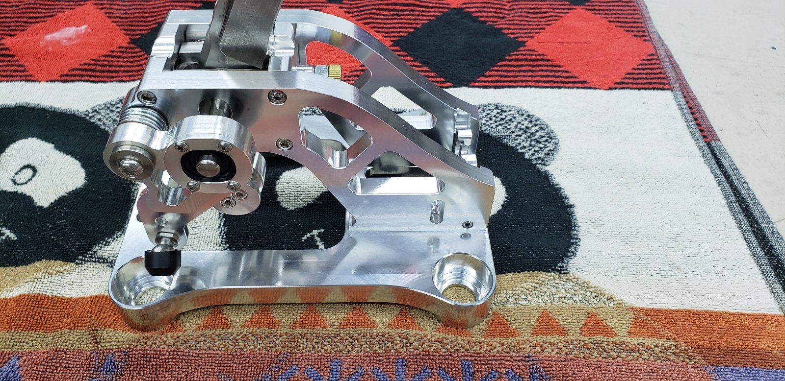

The attachment holes are 2 1/16 of an inch center to center. I believe that the extension that sticks out to the back is about 3 1/4 inches wide. About as narrow as I wanted to make it. I did give it twice the adjustment as the original piece had. If you put the holes all the way towards the right “back”, it would fit like the stock shifter by moving it a little over 2 inches back. Anything forward of that would of course be forward of the stock location.
Oh okay, so it's just perspective then from the picture, all good! Perfect, sounds ideal. Excited to see how it fits

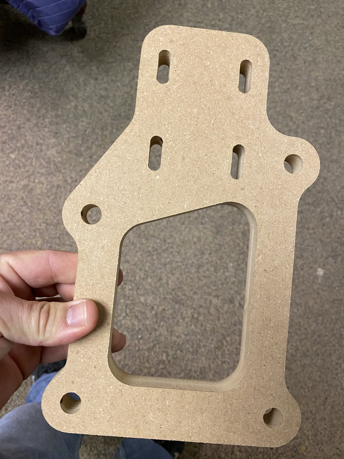

Working on a bottom plate for this guy. Rather than adapters to shift it backwards I might be able to get a new plate made that would match up to our cars and shift it back..
I’m going to cut out a test piece on Monday from MDF.
How did this work out, ever get your test piece done?
Got my shifter but havnt been to storage yet to see how it all lined up. Thing is beautiful though.
SACTX
I have the template for the base cut out. I made this one out of three-quarter inch thick MDF. I might have time this weekend or next week to work on it and see how well it lines up. I am working on my supercharger swap right now.
Looking at it, it looks like it may need a little bit of adjustment but I think it will work pretty well.

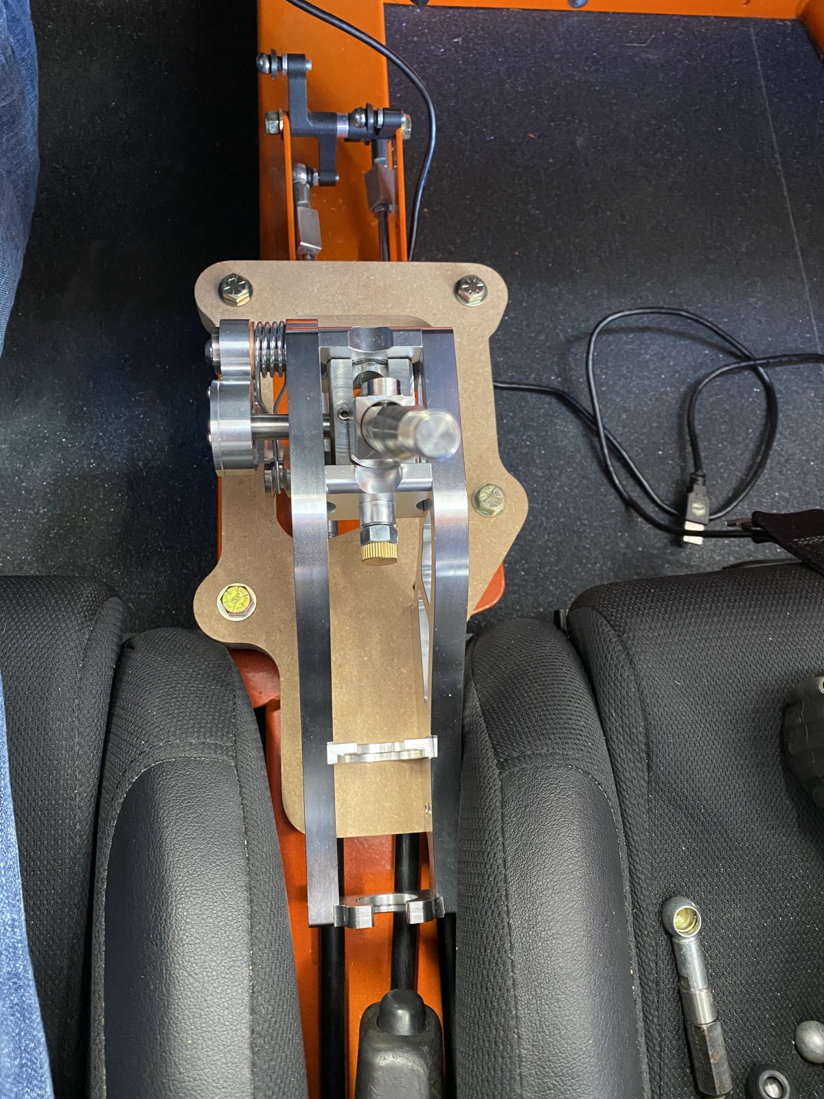

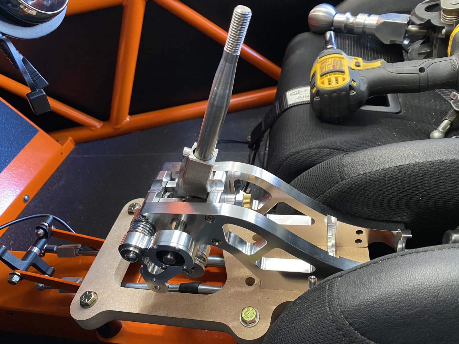

I had a good weekend. The shifter base actually attaches to the shifter. I had to make some small modifications to get it to work correctly. I am making a new mock up today and will work on it sometime this week and hopefully mount it to the car.
My goal is for it to be able to be mounted 1/2 inch closer to the driver and up to 1 1/2 inches forward. This would all be adjusted by mounting the shifter to the base and not moving the base in the car.

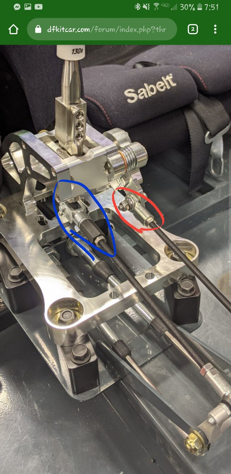

The red fitting came with my kit originally. So I have that one already. But where'd you get the circled in blue one? Looks like an easy hookup.
Fozda

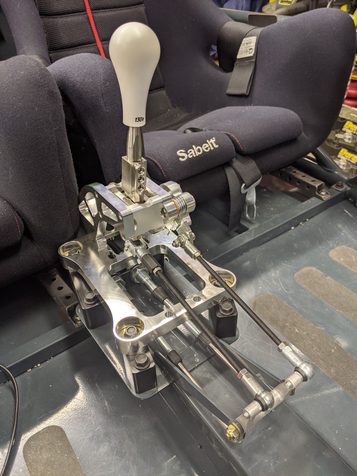

The one circled in red came with your shifter? Mine came with a ball attachment.
I used the following parts for the attachment circled in blue from McMaster-Carr:
3798K64 Fully Threaded Rod End Bolt, M8 x 1.25 mm Shank Thread, 50 mm Shank Center Length
2448K47 Easy-Adapt Clevis Rod End, M8 x 1.25mm Shank Thread, 31.75mm Shank Center Length
91409A116 Black-Oxide Steel Male-Female Hex Thread Adapter, M8 x 1.25 mm Thread to M6 x 1 mm Thread
The clevis rod end and the other rod end were too tight to just slide together so I had to file it down a bit and then I had to cut about a half inch off the threads to get it to thread all the way up in the bottom on the shifter.

Yessir, my kit is #0017 I bought it from the original buyer partially built. Early kits came with that part from df, but they had supply issues and switched it to something else later on.
Thanks for the part numbers and explanation, I'll get that all setup so come spring I can just bolt it on and go! Super excited the shifter was literally one of the only few main things about the kit I didn't like, so this is awesome for sure.

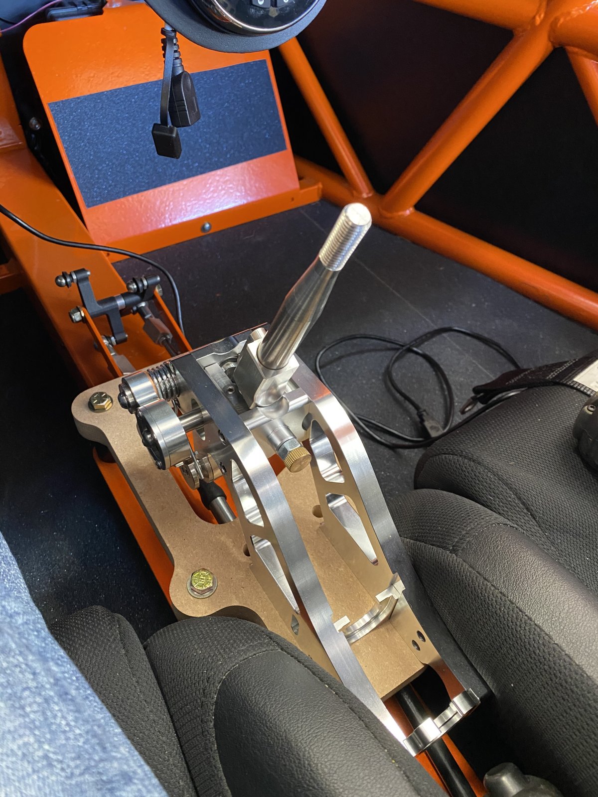

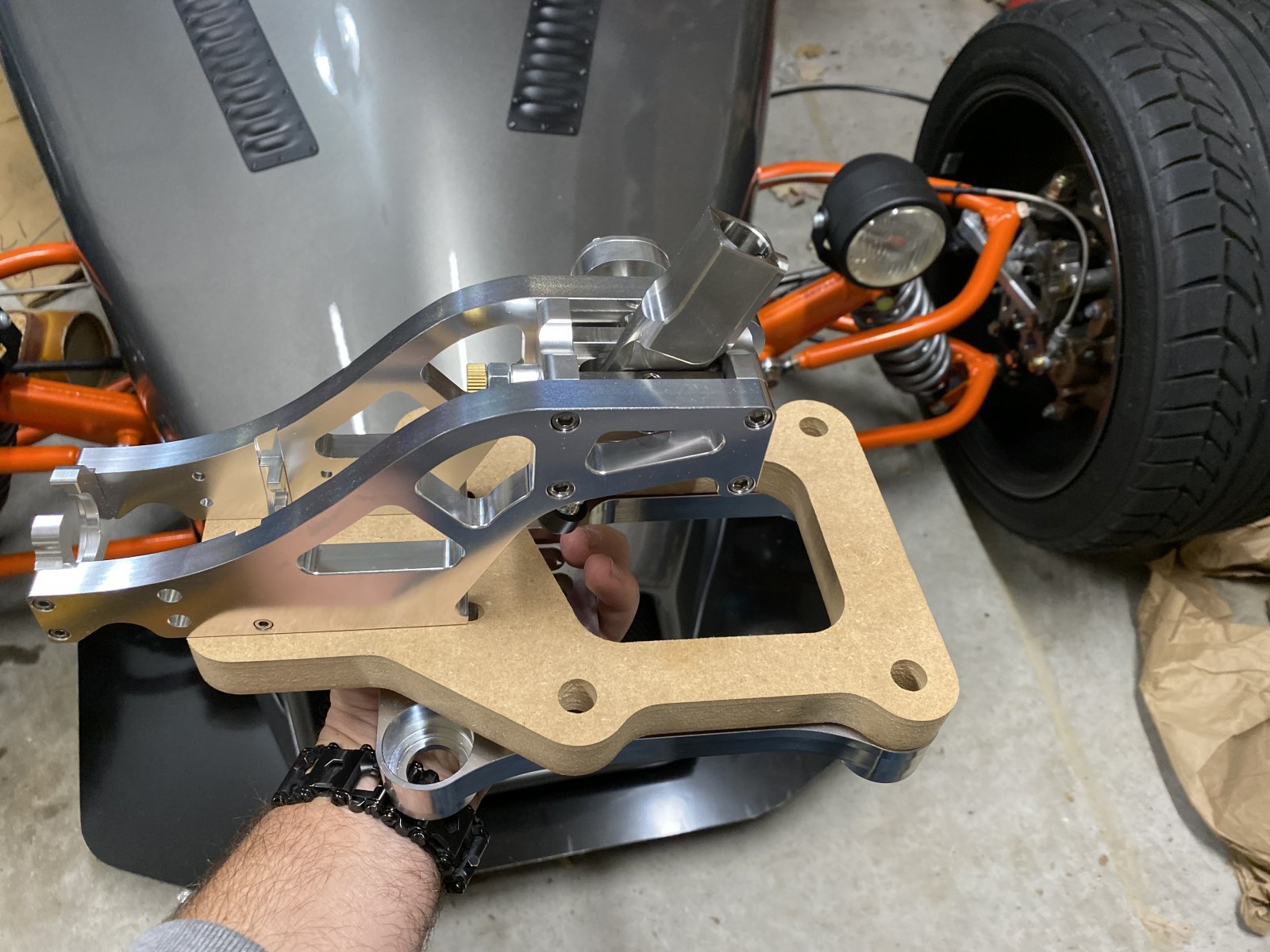

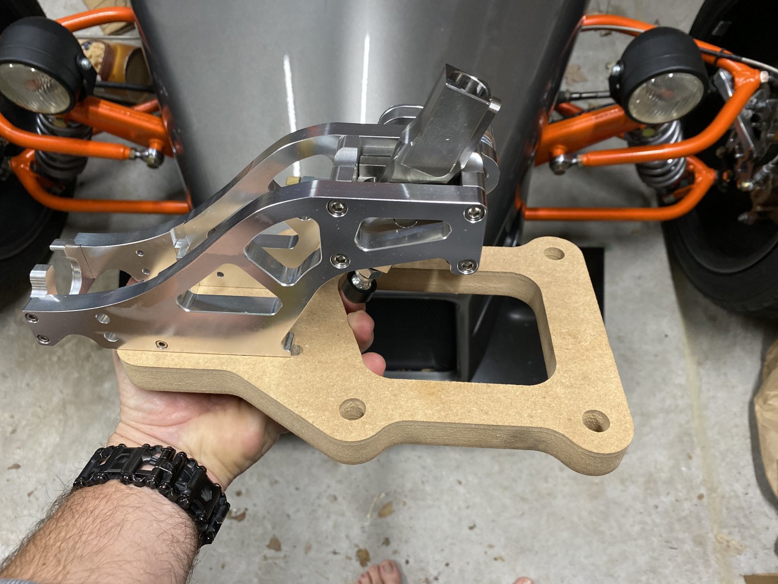

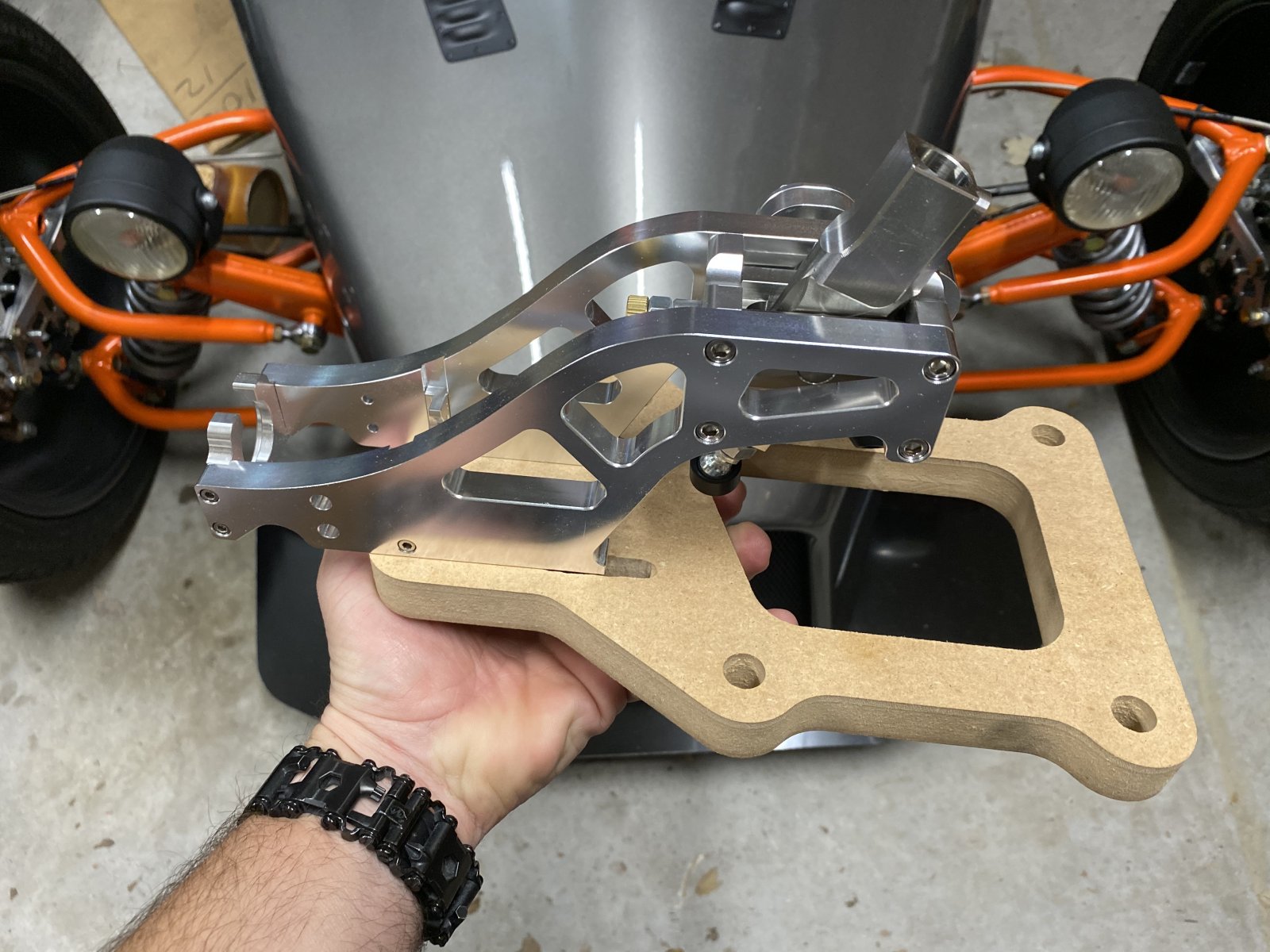

We have a plate that will attach to the stock mounting locations.
I still need to adjust it a little bit. About half an inch towards the driver and another inch rear words and it would be in the exact stock location.
Its looking good!
Is this a mount that you are going to make and sell us or will you have the DXF files for it?
