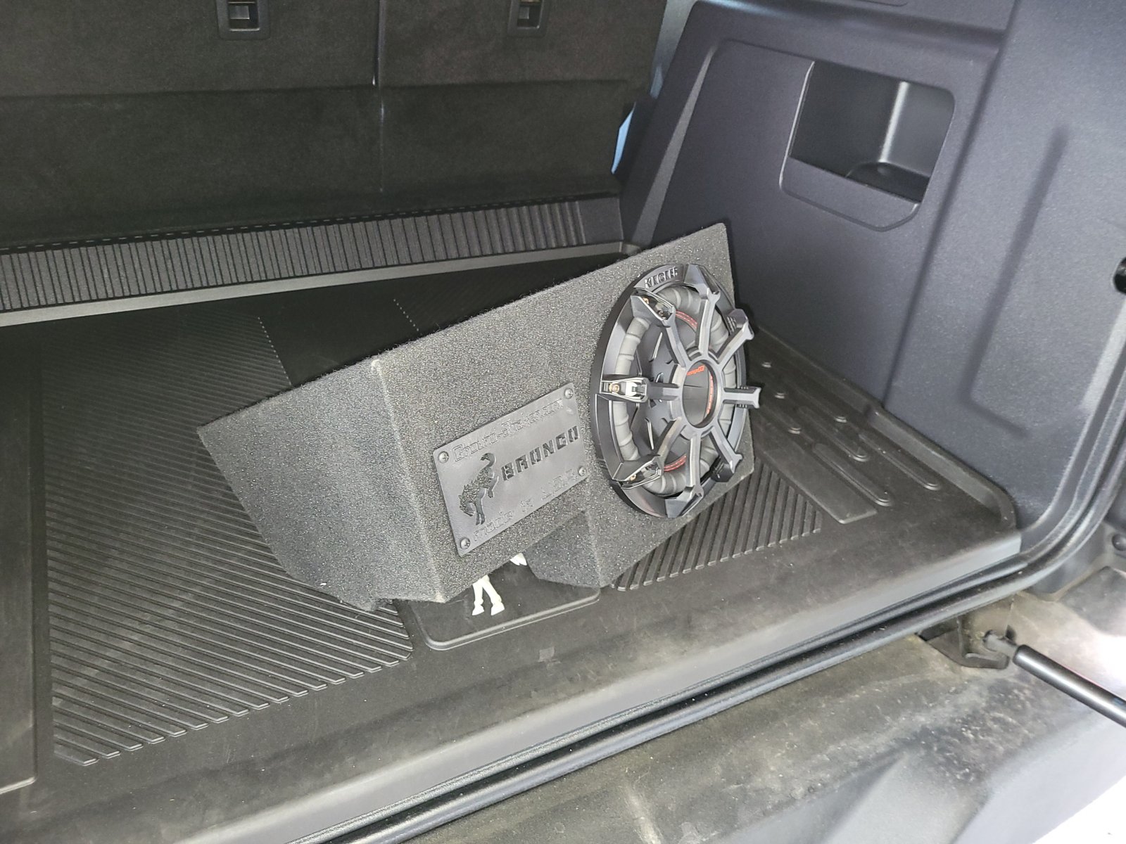

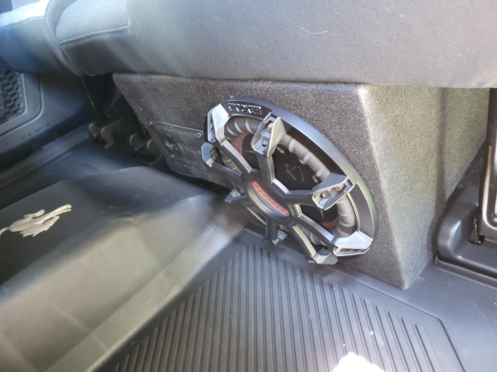

All my audio stuff was received at the end of this past week, so that's great. Unfortunately, I won't be able to get into it to do the install this weekend, due to needing the car for reasons and not having enough time to be able to rip the interior apart without regrets. That's ok though, I've already made some progress in that I took the interior apart somewhat this morning to plan things. I know where I'm mounting both amps and the capacitor (I decided to add a half-farad capacitor to the mix, last week). I have a few connectors and miscellaneous bits to buy, so I'll hopefully be ready for the actual install next weekend.

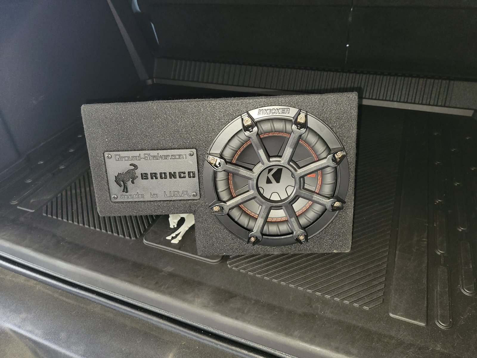

But for now, here's a couple pics of the sub box and where it will be mounted.
My grandfather had one of those. o_O
Decided to keep this tame, at 50w x 4 for the fronts and rears, and 300w x 1 for the 8", small-volume sealed subwoofer. I've aged out of the days of ridiculous trunk-consuming boxes with tuned ports, four 12"s, and 2000w.

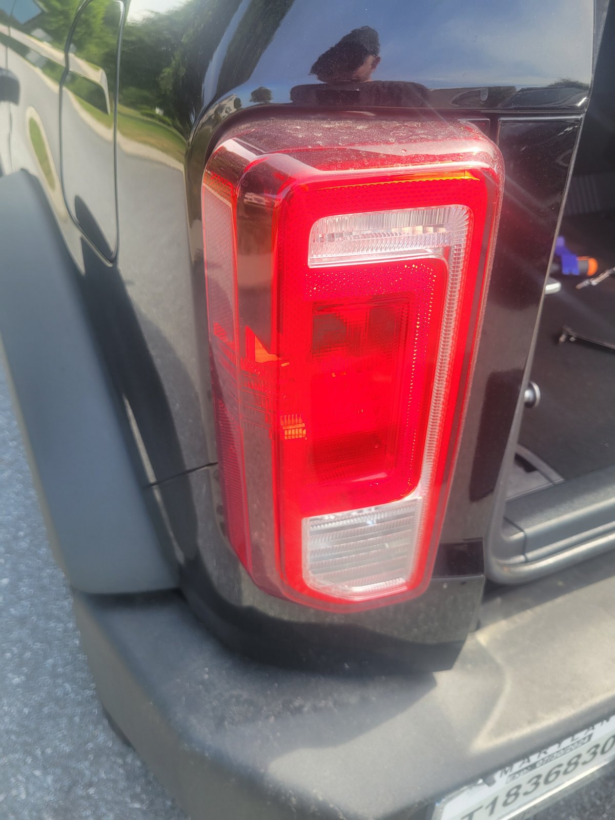

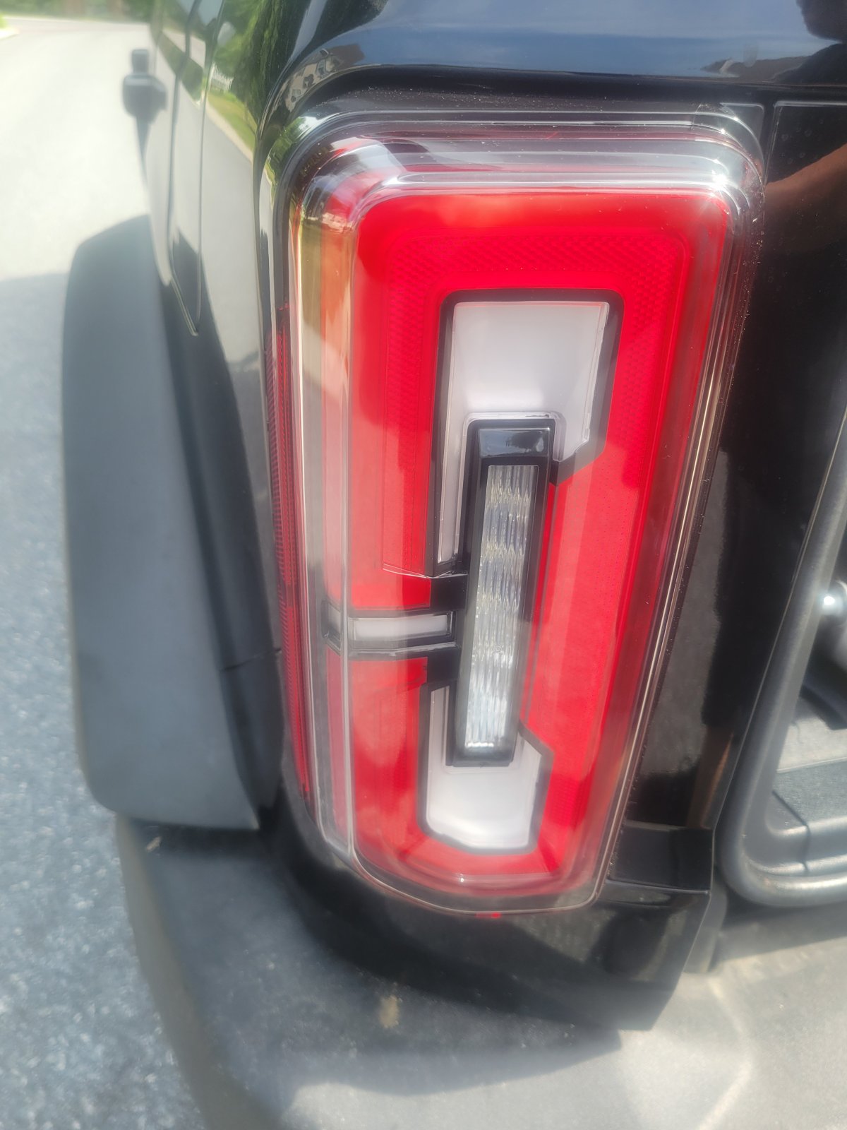

Taillights, before and after.

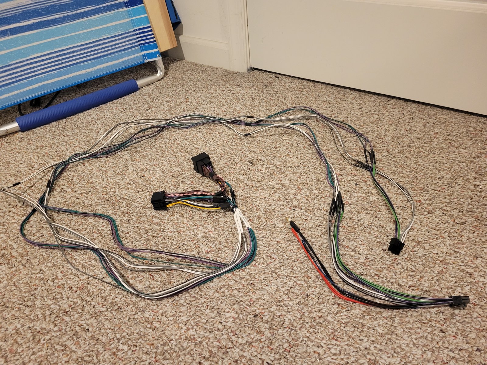

I spent about 45 minutes in my wonderful, air-conditioned basement tonight, prepping the wiring harness for the Bronco. This only covers the front and rear channels, not the subwoofer channels. My plan is to tap into the two rear channels to grab signal for the sub, but I am not sure how that will affect audio quality. Once I use some temporary wire taps and determine the signal is fine, I'll do it more permanently.

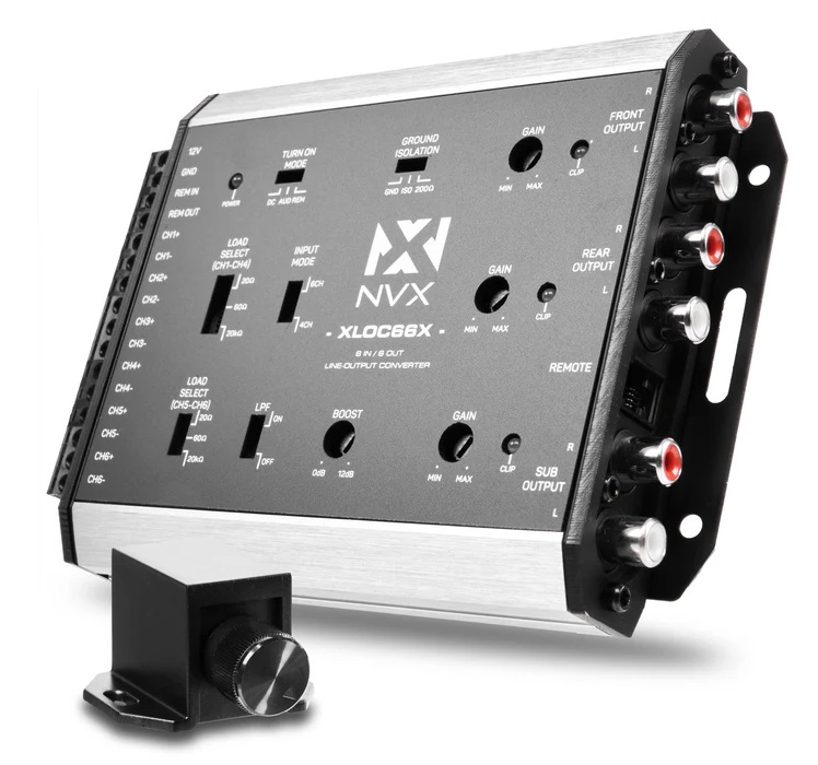

First, I decided to add a capacitor to the system because, well, I can. Car audio capacitors are designed to provide high levels of current on-demand, as your amplifiers call for it. This reduces dimming headlights at night, and other "brownout" type problems. I went with a half-farad cap because I'm not running a lot of power.
Secondly, I decided I didn't like my plan to tap into the rear speakers to get the subwoofer signal. The Ford factory radio does some undesirable equalization and frequency elimination and, while the Kicker Key 200.4 amp I am using does fix that issue, I didn't want to tap into the signal after the amp, and use it with the high-level inputs on the subwoofer amp.. So, I installed a LOC from NVX. A LOC allows you to throw the high-level signal directly from the factory radio/amplifier to the LOC, which can then apply lots of shaping to the signal (HPF/LPF, bass boost, etc), before sending the signal out to your amplifiers at line-level. I didn't use any of the processing features though, the two Kicker Key amps do a lot of that themselves. I only installed the LOC for two reasons:
  1. You can feed 4 channels in (front left/right, rear left/right) and get 6 channels out (front left/right, rear left/right, and two channels of subwoofer signal). The frequencies in the signal are summed across all channels, which fixes the factory radio equalization issues.
  2. The LOC is able to use DC offset to sense when to turn on, and then will provide a remote out 12V signal to turn on your other amps. Both my amps also have DC offset, so I didn't technically need this feature, but I used it anyway, in case I ever want to change the subwoofer amp or something.

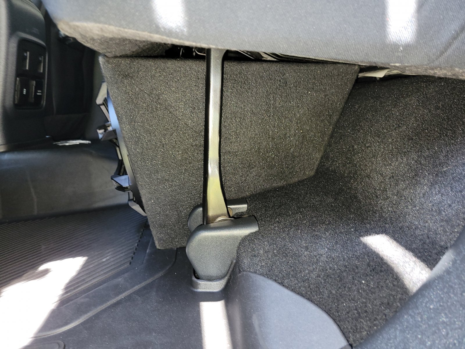

  2. During the install, I was annoyed to find out that, if you fold down the rear seats, the part you sit on moves forward as well. This means that I can't fold the seats down without removing the sub box from under them, making my whole decision to go with that box, pointless. If I need to remove the box for hauling capacity, I'd rather install a bigger box/bigger subwoofer(s) in the trunk. I don't know if I'll change this or not; it depends on how well I can dial in the existing box and subwoofer to complement the rest of the system.

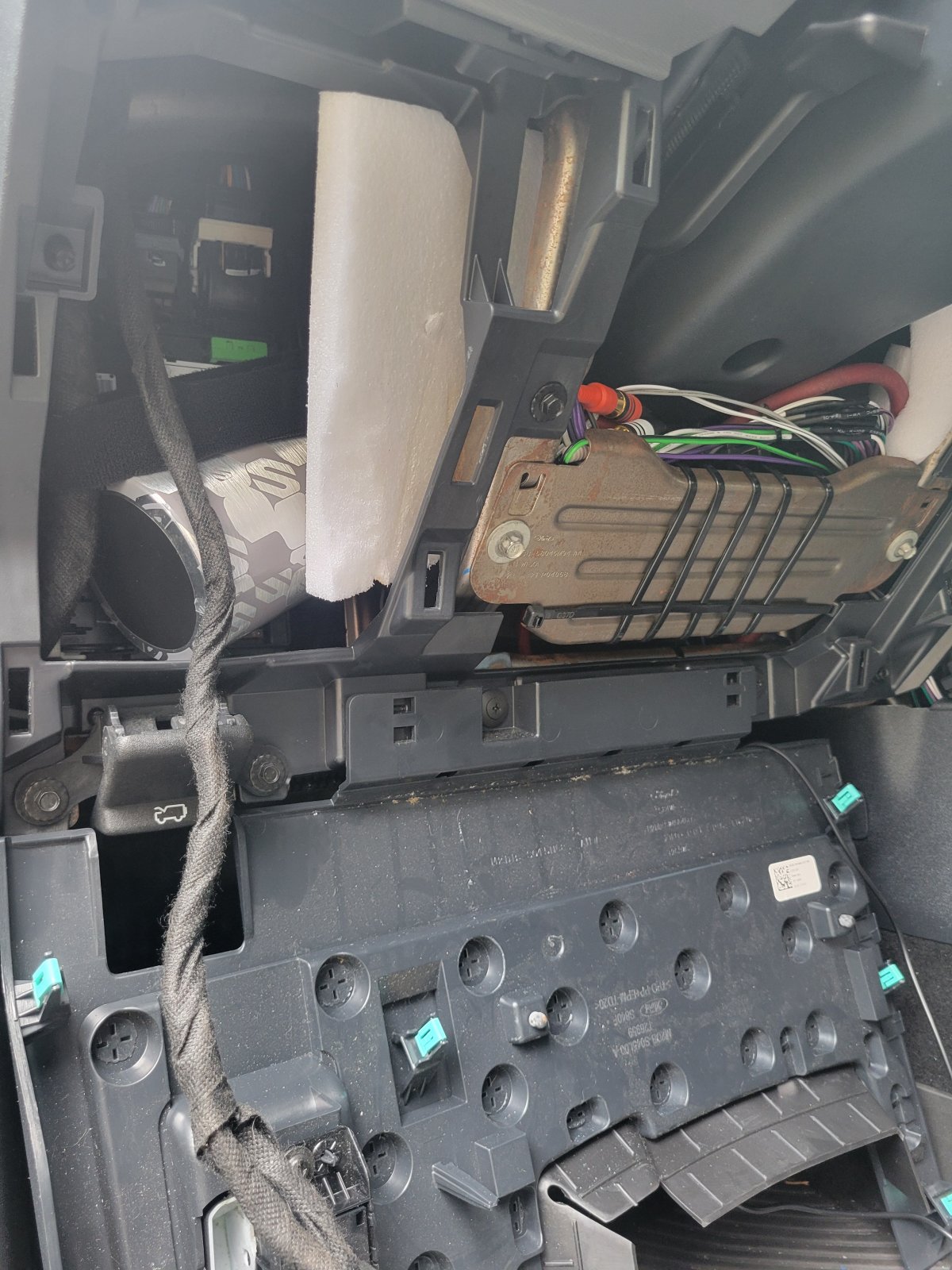

Pro tip: Velcro straps and zip ties work amazing for installing gear in cars where you don't want to drill holes. Here's the capacitor and the Kicker Key 200.4 amp (zip tied to the other side of the kick plate), plus some closed-cell foam padding I wedged in on the metal edges to protect the cap and the wiring.

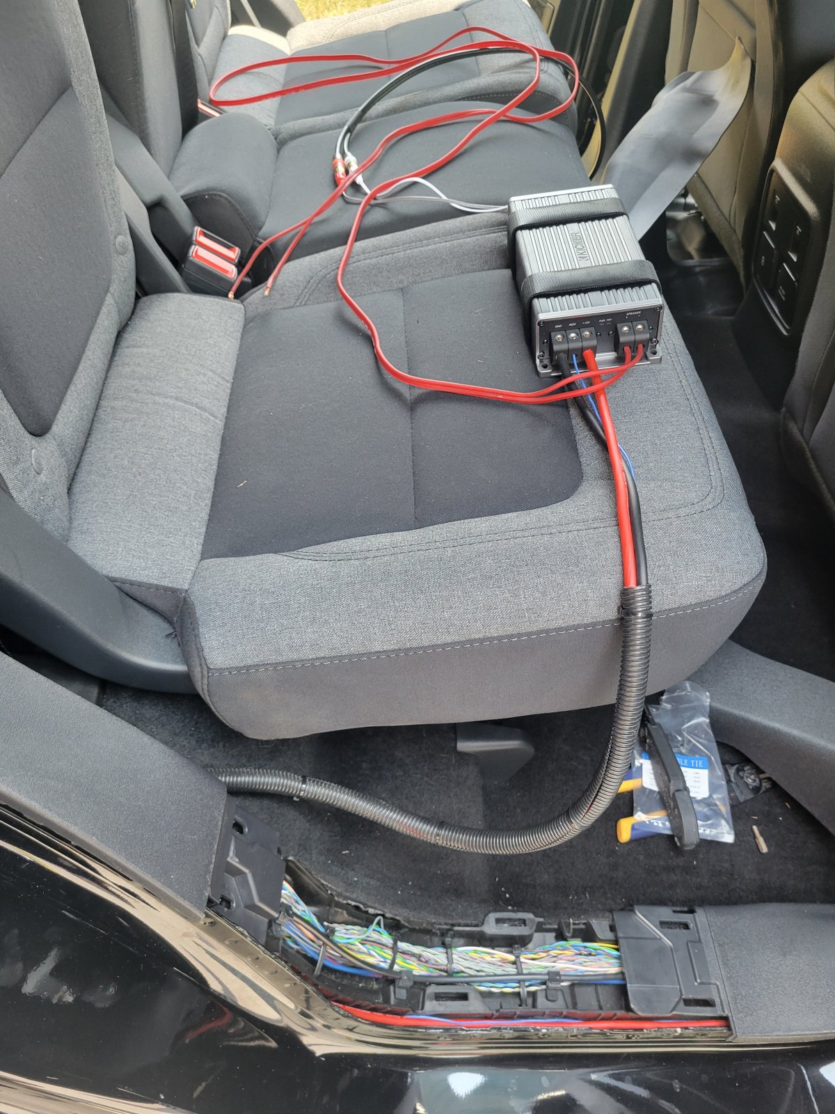

Testing the Kicker Key 500.1 sub amp. The Velcro straps around it will stick to the carpet under the backseat, it's not going to go anywhere.

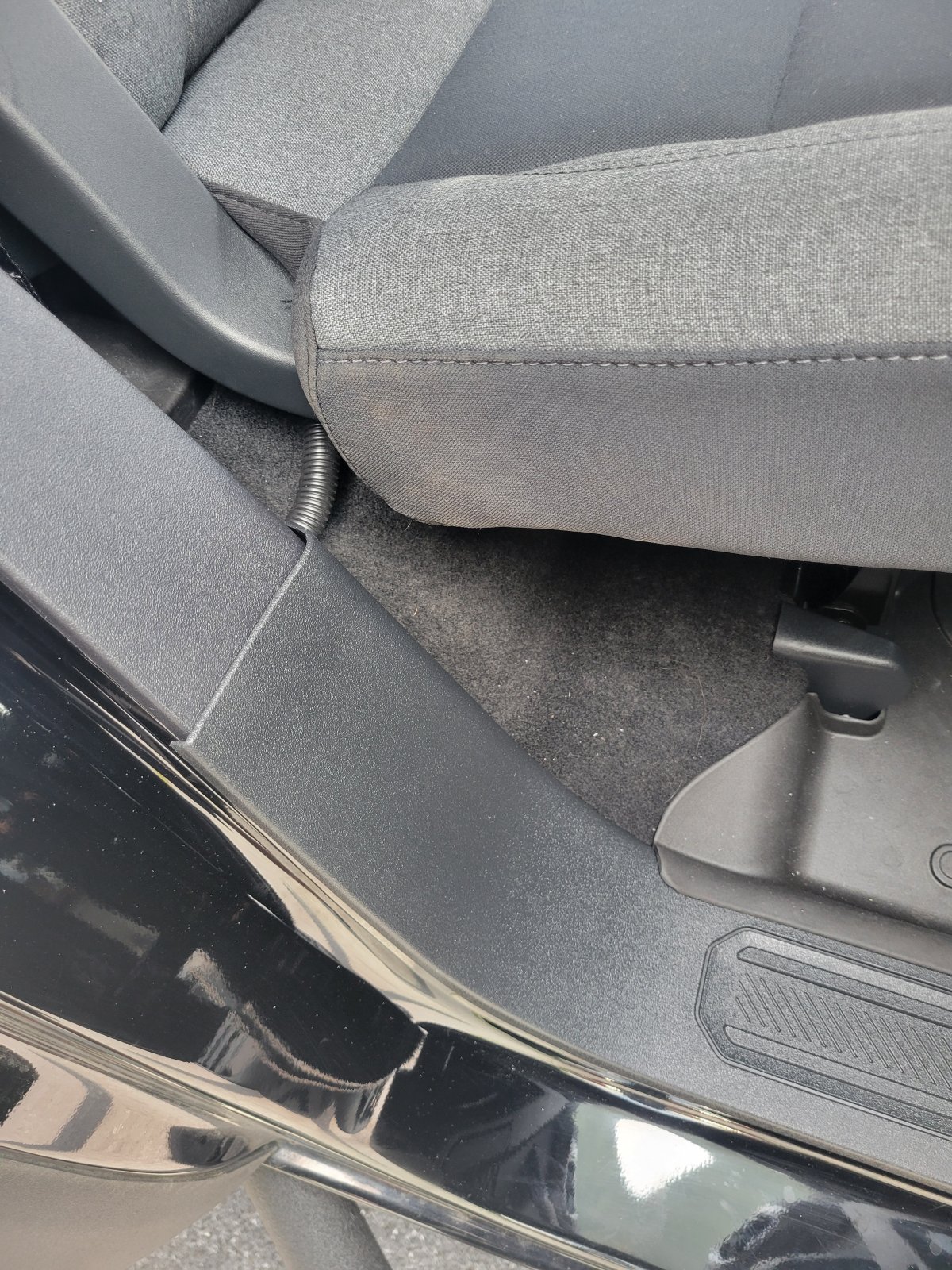

Finished off the rear install. The entire install is next to unnoticeable, I did a really good and thorough job with it.

  • Added a NVX XLOC66X to the factory radio for easy addition of extra channels for the subwoofer - this can do equalization, gain control, and HPF/LPF, but I did not use it for any of that - $80
